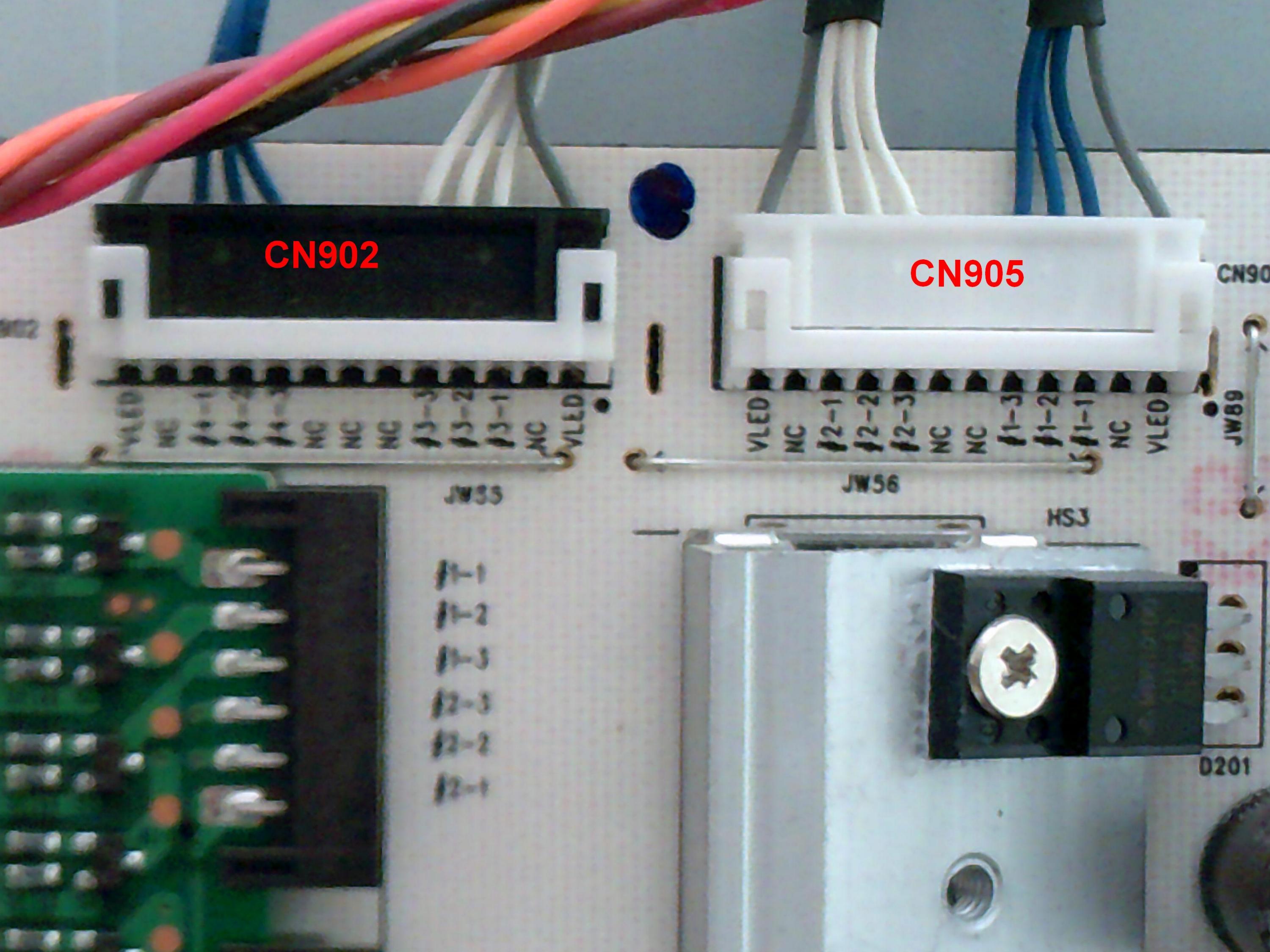

    Here is what I checked(dc).
    CN902
    Vled = 235.6mV
    #4-1 = 10.69V
    #4-2 = 10.27V
    #4-3 = 10.67V
    #3-3 = 10.65V
    #3-2 = 10.66V
    #3-1 = 10.64V
    Vled = 236.2mV
    Cn905
    Vled = 237mV
    #2-1 = 10.25V
    #2-2 = 10.63V
    #2-3 = 10.64V
    #1-3 = 10.66V
    #1-2 = 10.27V
    #1-1 = 10.67V
    Vled = 237.0mV

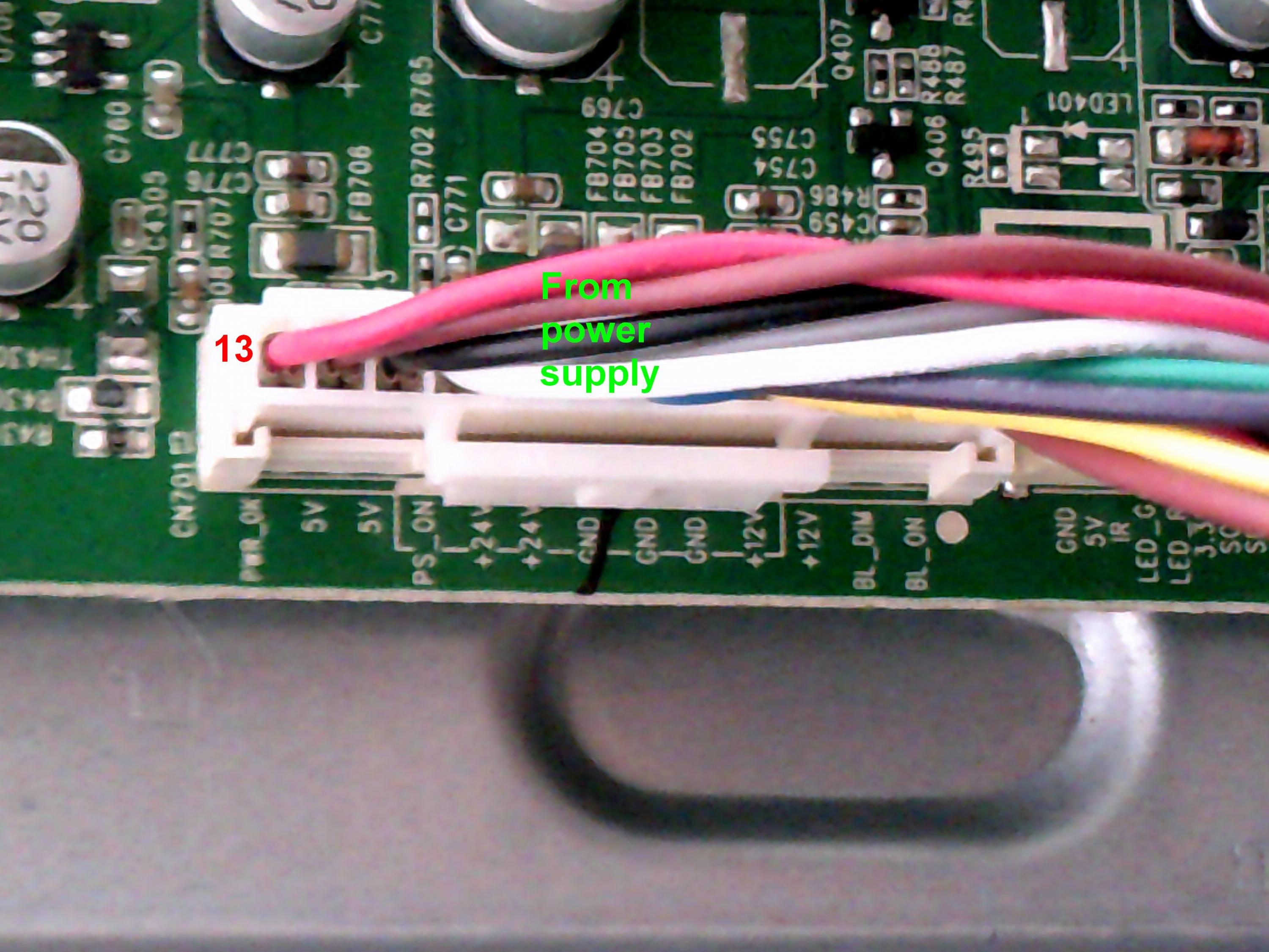

    CN904 connects to main board and had some voltages listed so I relisted it.
    Im still not sure but shouldn't Vled(power supply) and pwr_ok(main board) have voltage?
    Cn904
    1)BL_on = 4.91V
    2)BL_DIM = 2.93V
    3)12V. = 12V
    4)12V. = 12V
    5)G = 20mV
    6)G = 20mV
    7)G = 20mV
    8)24V. = 24.73V
    9)24V. = 24.73V
    10)BS_on = 3.09V
    11)5V. = 5.09V
    12)5V. = 5.09V
    13)PWR_ok = 2.8mV
    main board # is TXACB5K05304(barcode sticker)

      Re: Vizio M421VT LED no display
      After reseating plugs and playing with inputs I get a display, menu, and sound but no backlight.
      So the only issue is no backlight at all.
      I don't know if it is power supply inverter issue to led backlight or a bad led backlight.
      CN902 and CN905 go to backlight. I assume 10v is ok but I have no clue about VLED.
        If you got 24V and BLON going to backlight inverter, check the output going to the LED strips (around 90V or so, probably.)
          The power output to led strips I think is CN902 and CN905 on power supply (see above post).
          Nowhere neer 90v.
          So it must be inverter/power board or im confused?

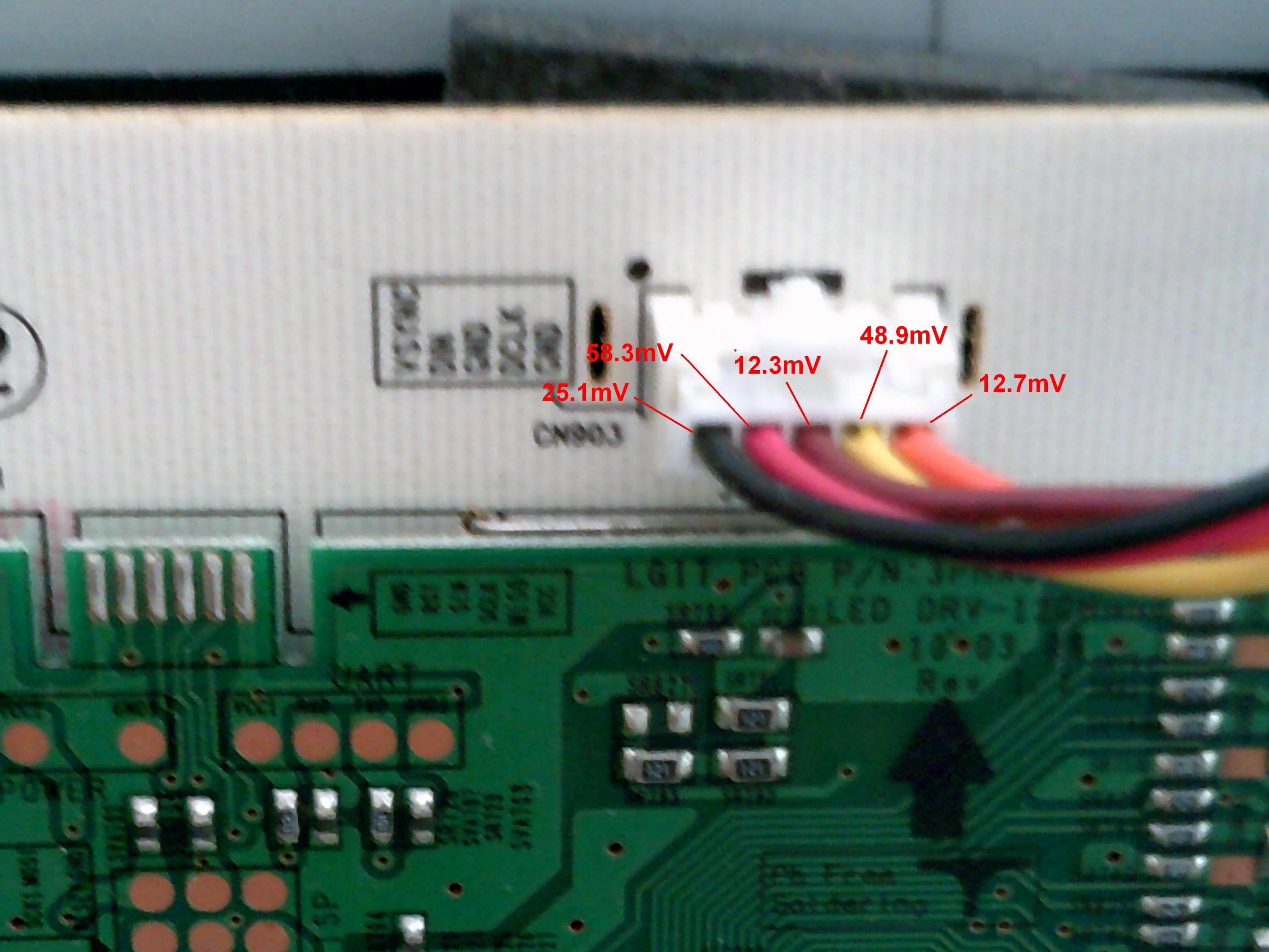

              with led wires disconnected I still get 10v on all the # pins.
              vled showed 15mV (connected it was 235mV)
              Looking at the back of power board all the # pins lead to the board atached to top side
              -top side board is labeled:
              LGIT PCB P/N: 3PHAC20004A-R
              LED DRV-12CH
              Barcode # FF4610BPV20L12304
              Could there be 12 led strips(12CH) each being supplied 10v?

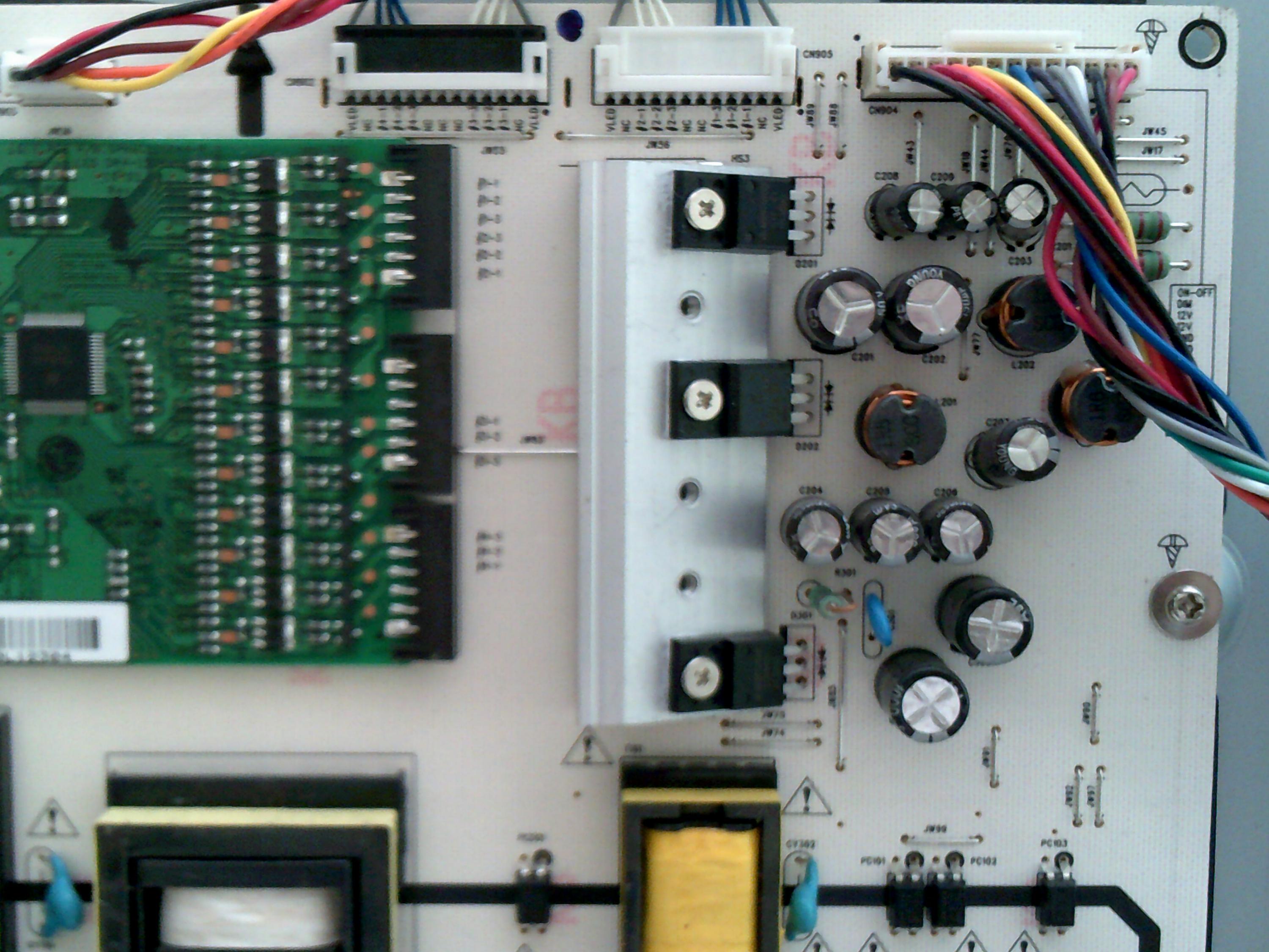

                            Probably somewhere in range of 40~90V.
                            Each strip is basically lots of LEDs in series, usually with a resistor to balance the current (and limit fault current.)
                            The controller (green "addon" board) monitors the current overall and regulates the voltage to compensate for small changes in LED operating voltage as the set warms up.
                            That's at least how I think it works.
                              It does have 12 strings of LEDs, the LED's brightness is also controlled by the T-CON board for the dynamic contrast so they can say it has high contrast ratio. You can try disconnecting the cable between the T-CON and the power supply board by that big green board for the LED power supply to see if the LEDs will come on.

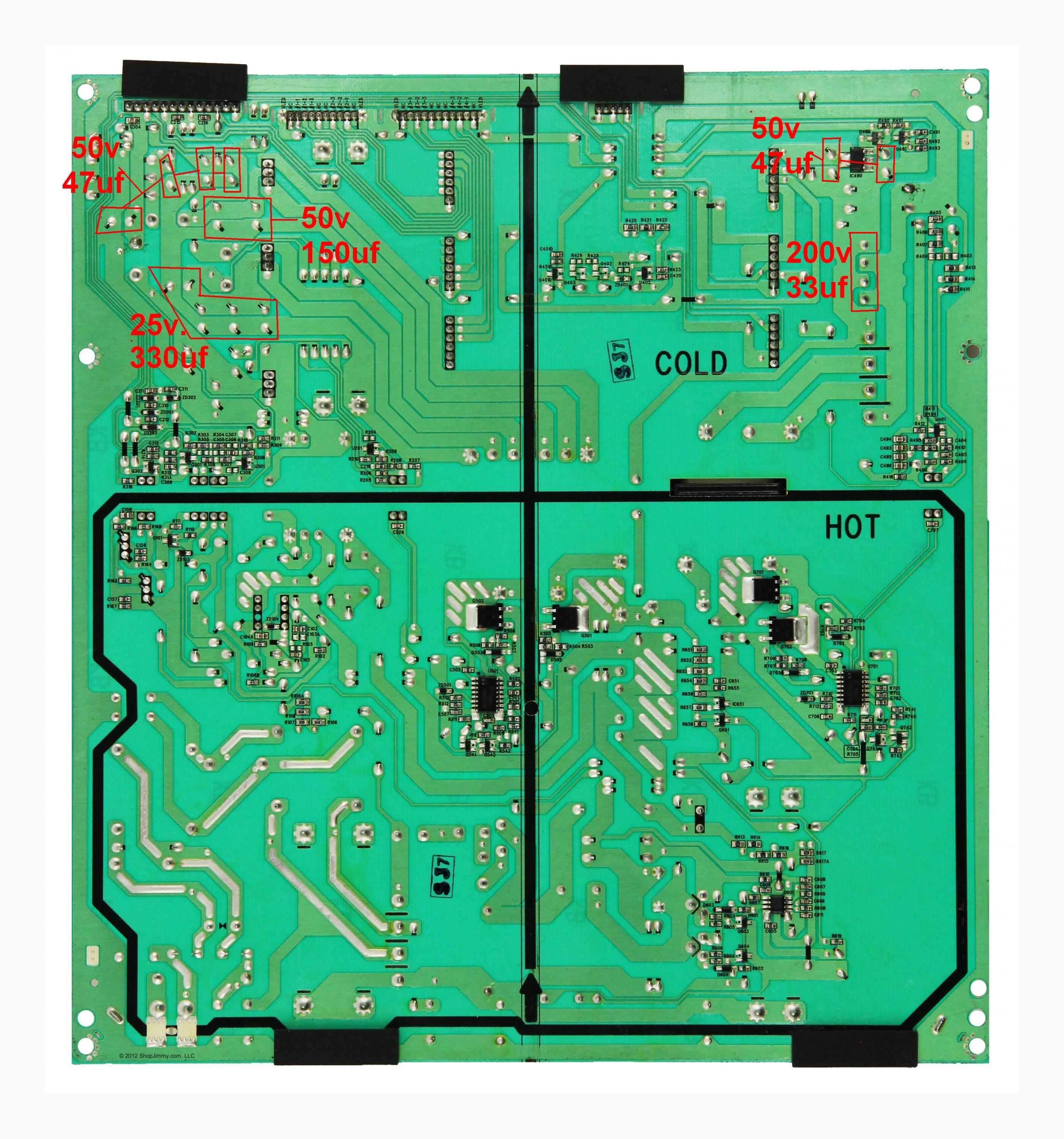

                                Thought I would list caps on cold side of board. Maybe it will help confirm voltages I should have.
                                upper left side:
                                2-Samwha BL 200v 33uf
                                2-Samwha ZS 50v 47uf
                                upper right side:
                                2-Samwha MK 10v 1000uf
                                4-Samyoung NXB 25v 330uf
                                2-Samyoung NXB 50v 150uf
                                4-Smawha MK 50v 47uf
                                  It looks like the output (maybe up to 200V) is on VLED. Not sure what the individual points are, then. Have you tested that bridge rectifier on the secondary for shorts?
                                    Those 33uf 200v Caps are for the LED power supply primaRy drive circuits which is fed by the bridge rectifier, they are not for the LED power supply out put side.
                                    Those 50V caps in the leaft side where the output connectors for the LEDs are for the LED power supply output voltages. So I expect the LEDs to be driven by less than 50V.
