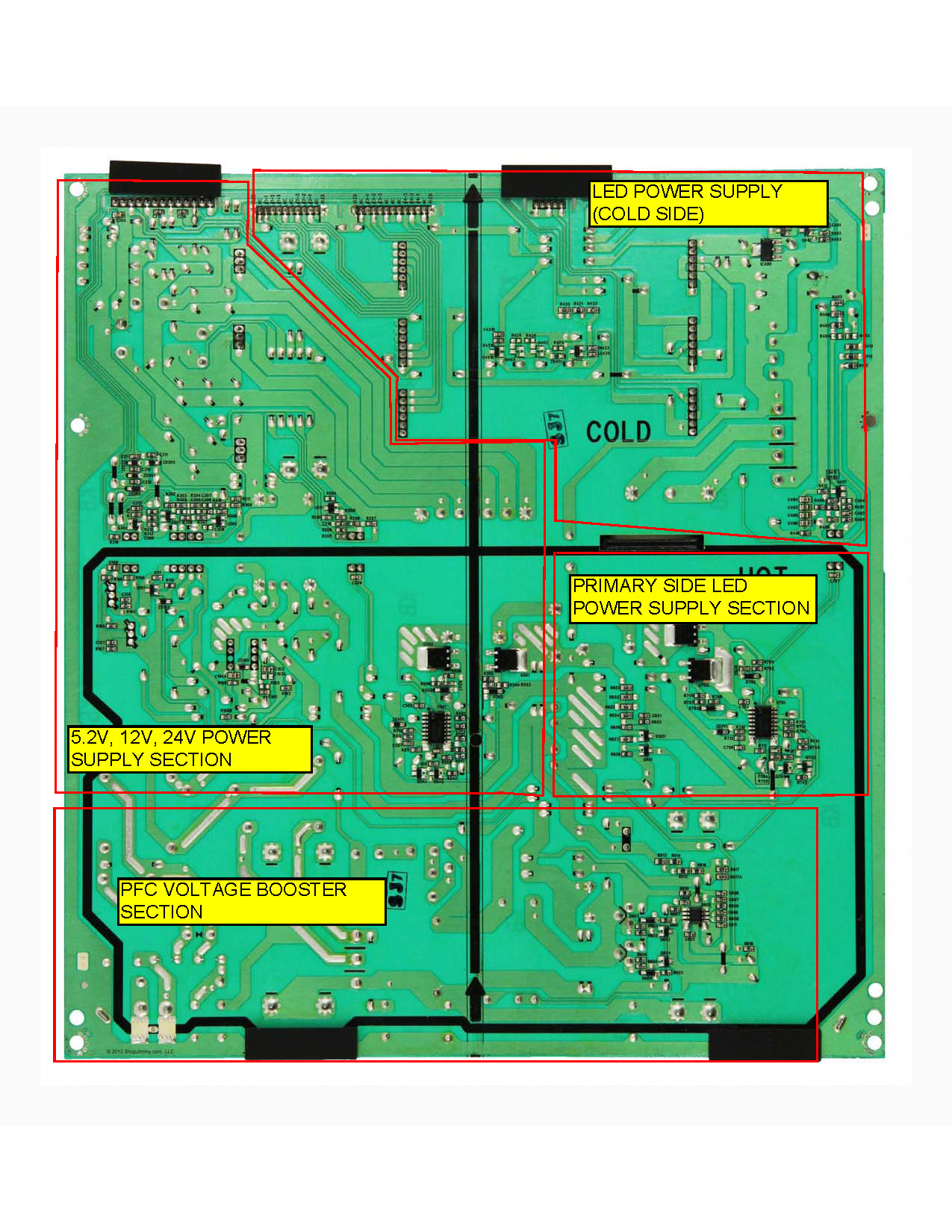

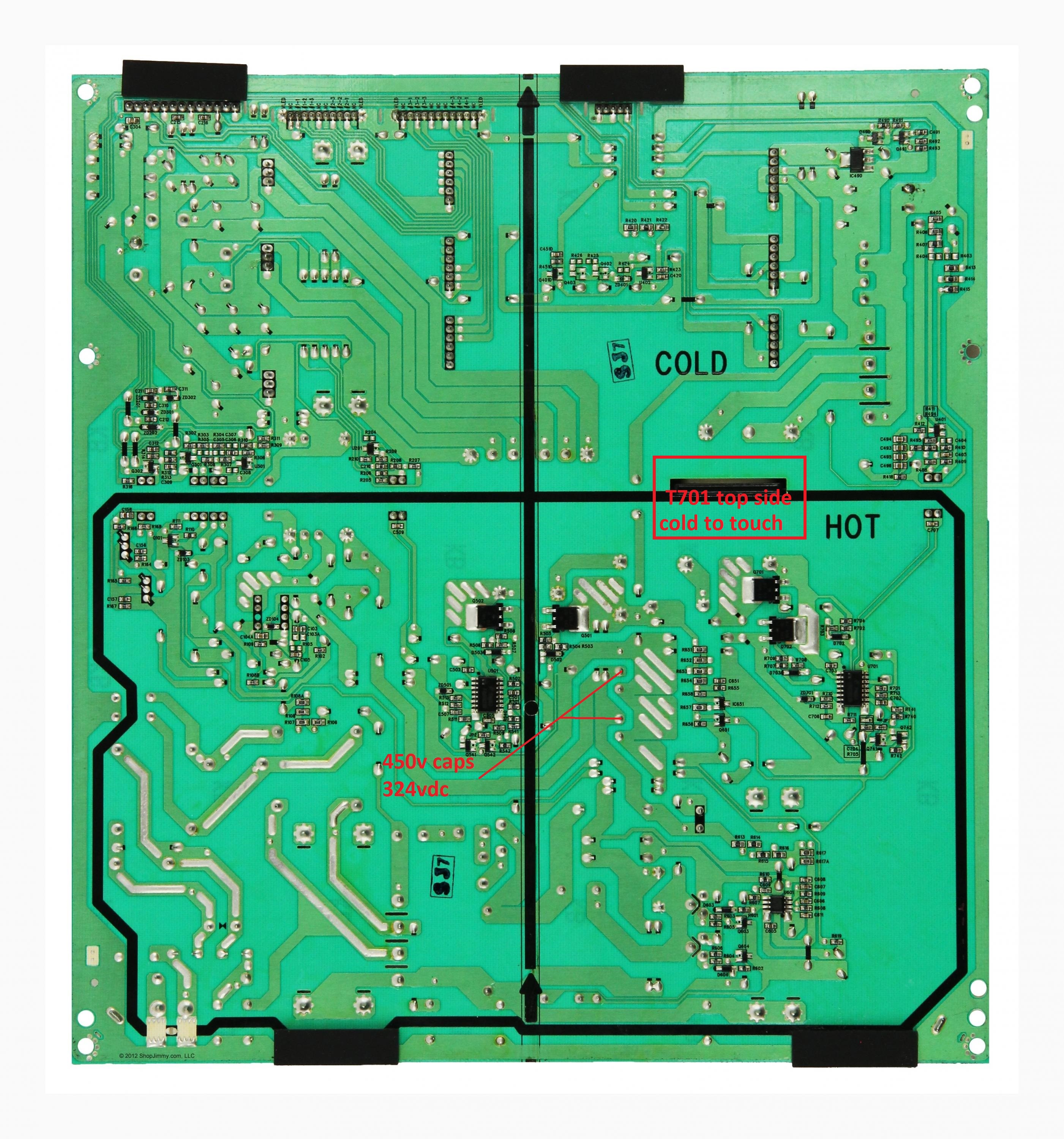

    Those two caps are the primary side of the LED power supply.

        Re: Vizio M421VT LED no display
        I do not think that the LEDs driving voltage is that high at all, you can see 12 MOSFETs for the 12-string LEDs. I see black blob on the IC, is that a blown top?
        Q601, Q602 are for the PFC voltage booster circuit, if you are getting about 380vdc on the two 450vdc main caps, then the circuits are working.

            ok so VLed must not be getting any voltage.
            324.5vdc on the 2 450v caps. should be good.

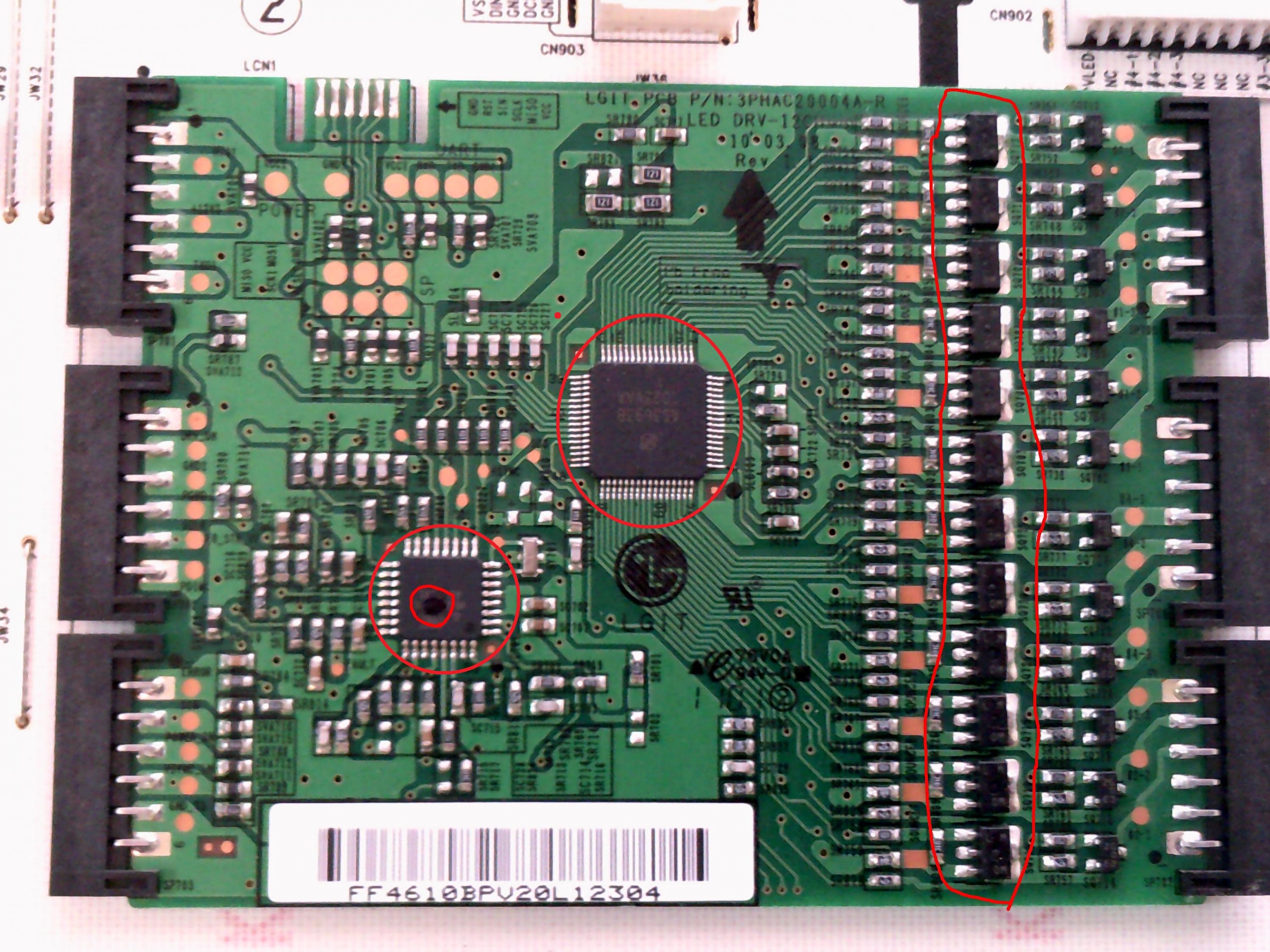

              I am tracing out the board to see how it is done, in the mean time, can you get the P/N on the ICs on the LED power supply board where the 12 MOSFETs are.
              @hienton2: your board is not the same as this board, it is PLDF-001. I have to look further to see what voltage for driving the LED in this TV is.
                the larger one:
                ae
                AS3693B
                1023VAA
                smaller one: difficult to read, hope I got it right.
                MEGA48FA
                AU1C41

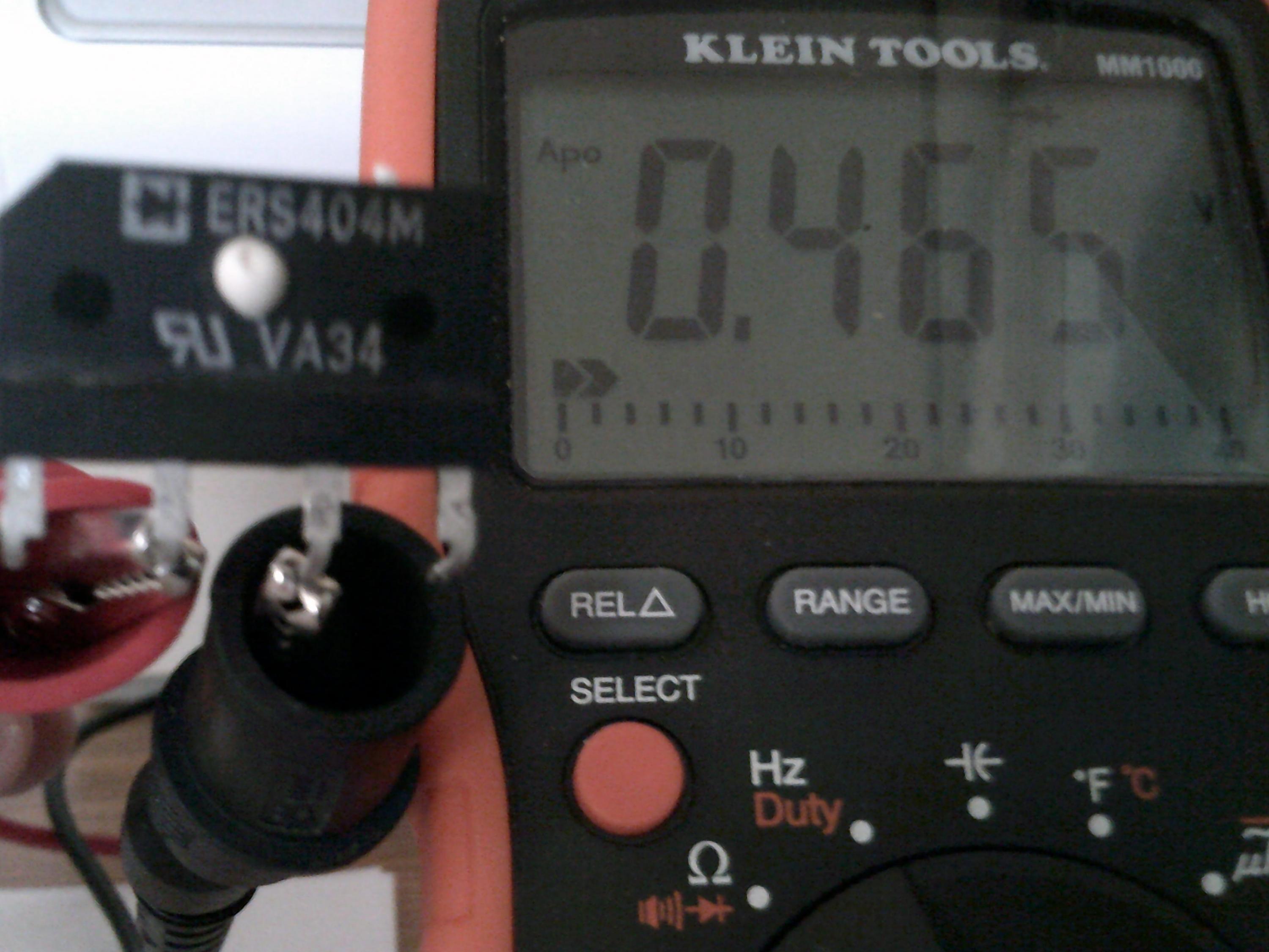

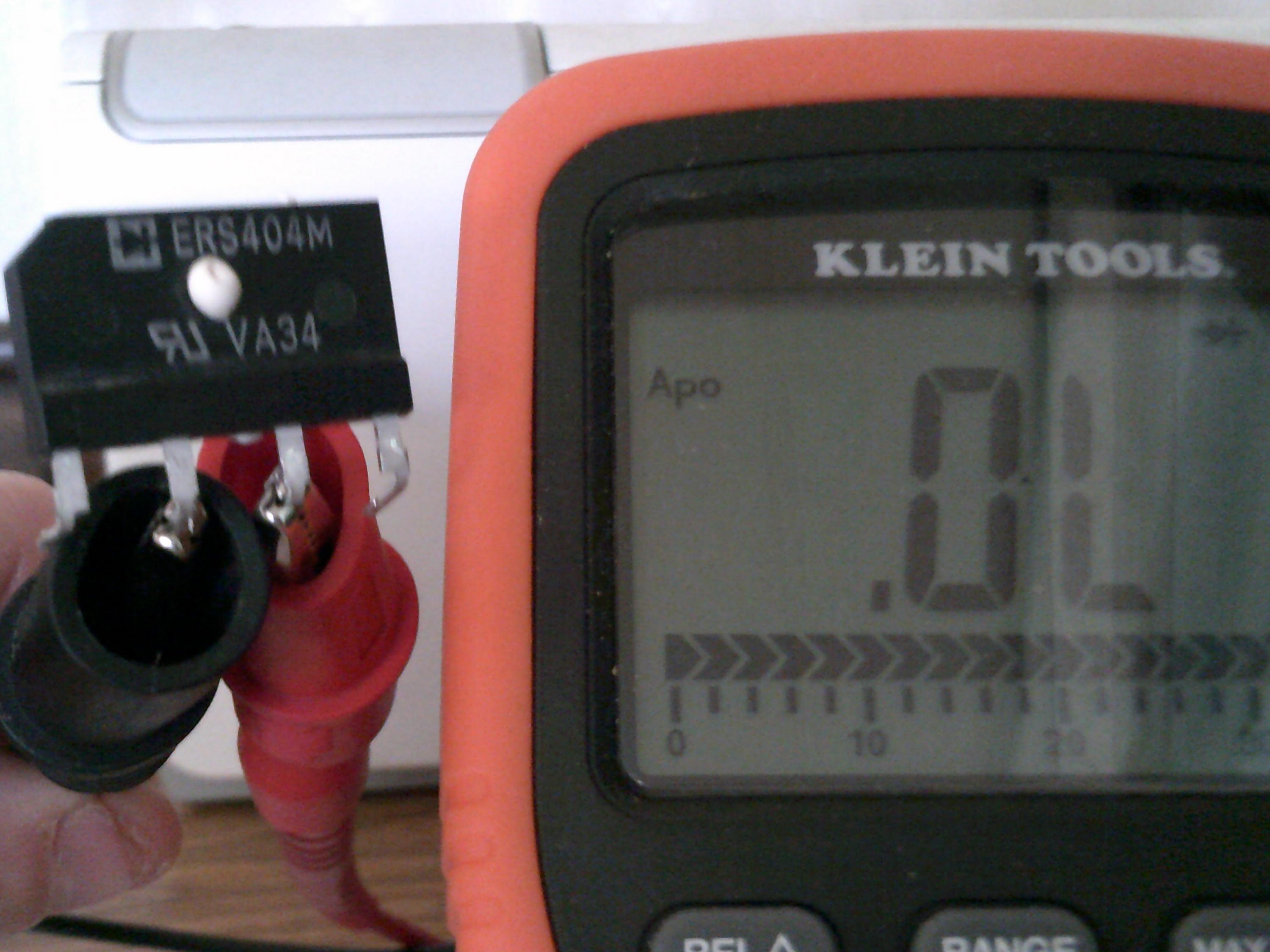

                  I pulled the bridge rectifier after tracing Vled from CN902 and CN905 back to it.
                  I used this method on video for testing:
                  http://www.youtube.com/watch?feature...&v=dqkT6hF0O3E
                  If I tested it correctly it fails in one direction. see pics
                  I guess I will start by ordering 2
                    The 33u/200V are definitely on the cold side. 145V sounds plausible, but quite high! The use of the bridge rectifier is rare though, but it's possibly because the transformer is full bridge switched (which means it can be smaller, essential in thin LED set.)
                      #30
                      That bridge reading is suspicious, looks like one diode drop across AC terminals, possibly there is a shorted diode inside it. Checked all pins for shorts?
                          So, testing the bridge: Looking at device from top label side pin 1 is +, 2 and 3 are ~ and 4 is -.
                          Meter probes in order (red) (black)
                          Pin 2 to 1 you should see ~0.4V
                          Pin 3 to 1 you should see ~0.4V
                          Pin 1 to 2 you should see OL
                          Pin 1 to 3 you should see OL
                          Pin 4 to 1 you should see ~0.4V
                          Pin 1 to 4 you should see OL
                          Pin 2 to 3 you should see OL
                          Pin 3 to 2 you should see OL
                          Good? Bad?
                          Any standard bridge e.g. GBU406 should work
                            (R) (B) probes
                            Pin
                            2 to 1= .462v
                            3 to 1= .001v
                            1 to 2= .OL
                            1 to 3= .001v
                            4 to 1= .455v
                            1 to 4= .OL
                            2 to 3= .463v
                            3 to 2= .OL
                            Yeah it's bad

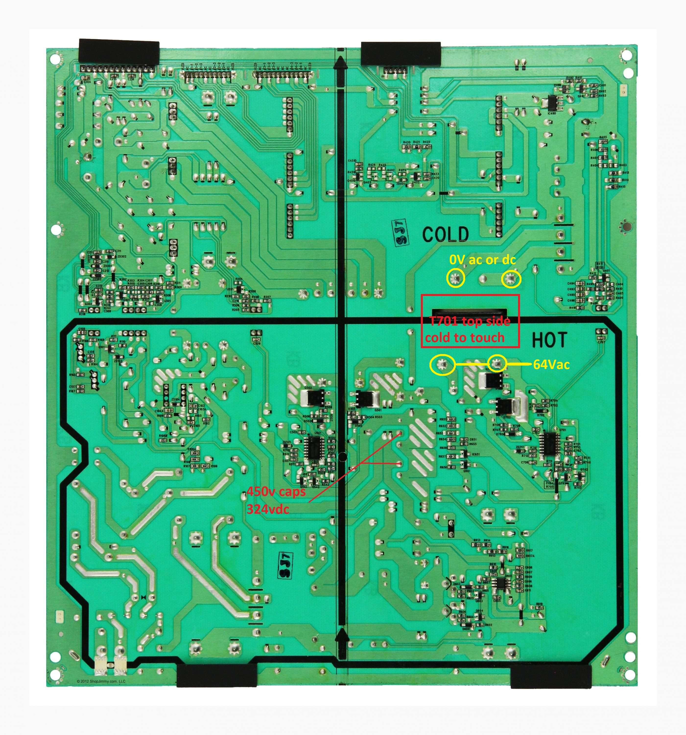

                                #35
                                226mVdc. nothing
                                I dont get a volt reading on any of the 4 bridge rectifier pins either.
                                The left transformer(wrapped in yellow) that bridges hot and cold sides is cold to the touch.
                                Right one is warm
                                On this pic I marked where the 450v caps are and I had 324v.
                                also marked where it felt cold.
                                  #36
                                  We just have to wait until you get the new bridge installed then, good job finding it by the way.

                                      #38
                                      I am surprised that your meter can read the AC voltage on those test points since that transformer is driven at 50KHz to 80 KHz range, most cheap meter does not have the bandwidth to measure those high frequency on that switching power supply transformer.
                                      I would wait for the new rectifier first.
                                        AS3693B LED BACKLIGHTS controller:
                                        MEGA48FA is the micro controller: Notes: not 100% sure
                                        https://cdn.badcaps-static.com/pdfs/...e5441e060e.pdf
                                        From the way it looks from the IC spec of the LEDs driver IC, I think once the bridge rectifier is replaced to get the voltage for the LEDs you will be OK unless the circuts that drive the transformer also failed due to shorted out bridge.

                                          #40
                                          Originally posted by ryan74
                                          (R) (B) probes
                                          Pin
                                          2 to 1= .462v
                                          3 to 1= .001v
                                          1 to 2= .OL
                                          1 to 3= .001v
                                          4 to 1= .455v
                                          1 to 4= .OL
                                          2 to 3= .463v
                                          3 to 2= .OL
                                          Yeah it's bad
                                          this should be good
                                          http://www.digikey.com/product-detai...6DI-ND/1935033
                                          Why you sad? You just found the failed part!
                                          The bridge acts like a short across the SMPS transformer, so I'd expect the SMPS on there to simply go into protection mode. No damage done.
