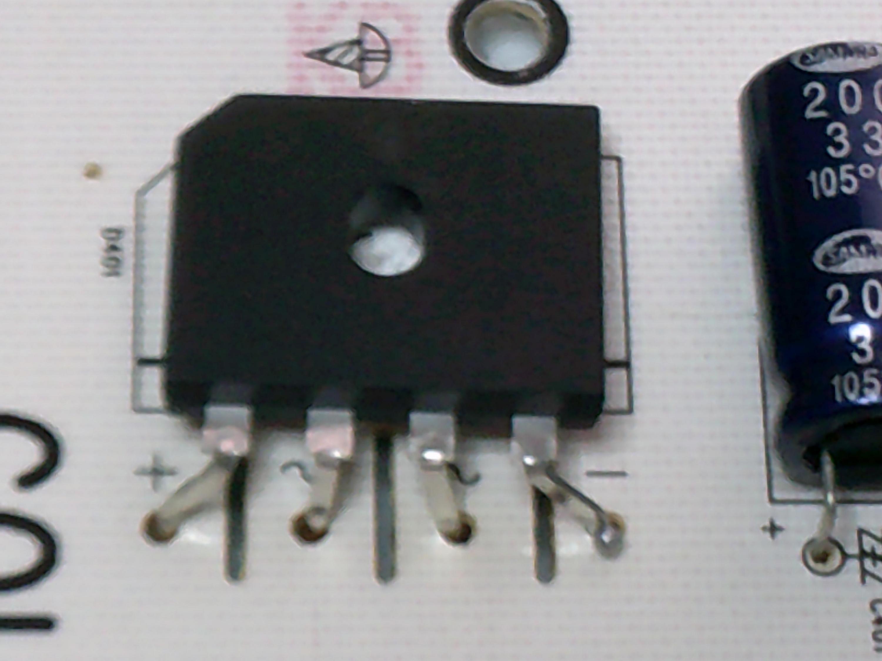

      Re: Vizio M421VT LED no display
      I just got part put in but while doing it I noticed I didnt verify spacing of leads when I ordered.
      Besides the spacing I had to install it upside down so pos. and neg. matched.
      See pic
      I hope it will be ok. I will update results after I test it.

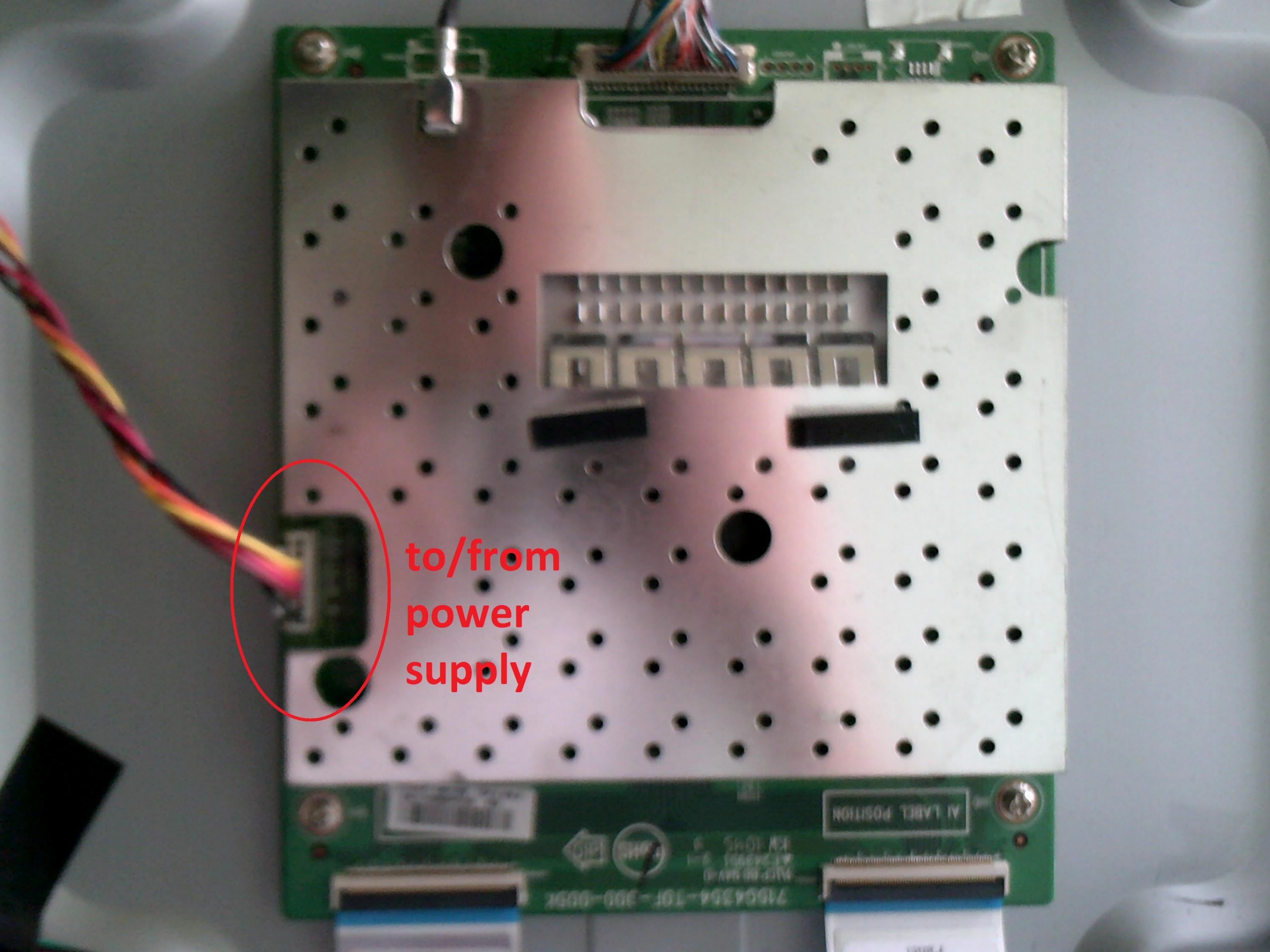

                                    ok I guess I am starting from scratch again. I purchased a power supply board and still have the same problem.
                                    • ryan74
                                      • Oct 2012
                                      • 471
                                      • usa
                                      #58

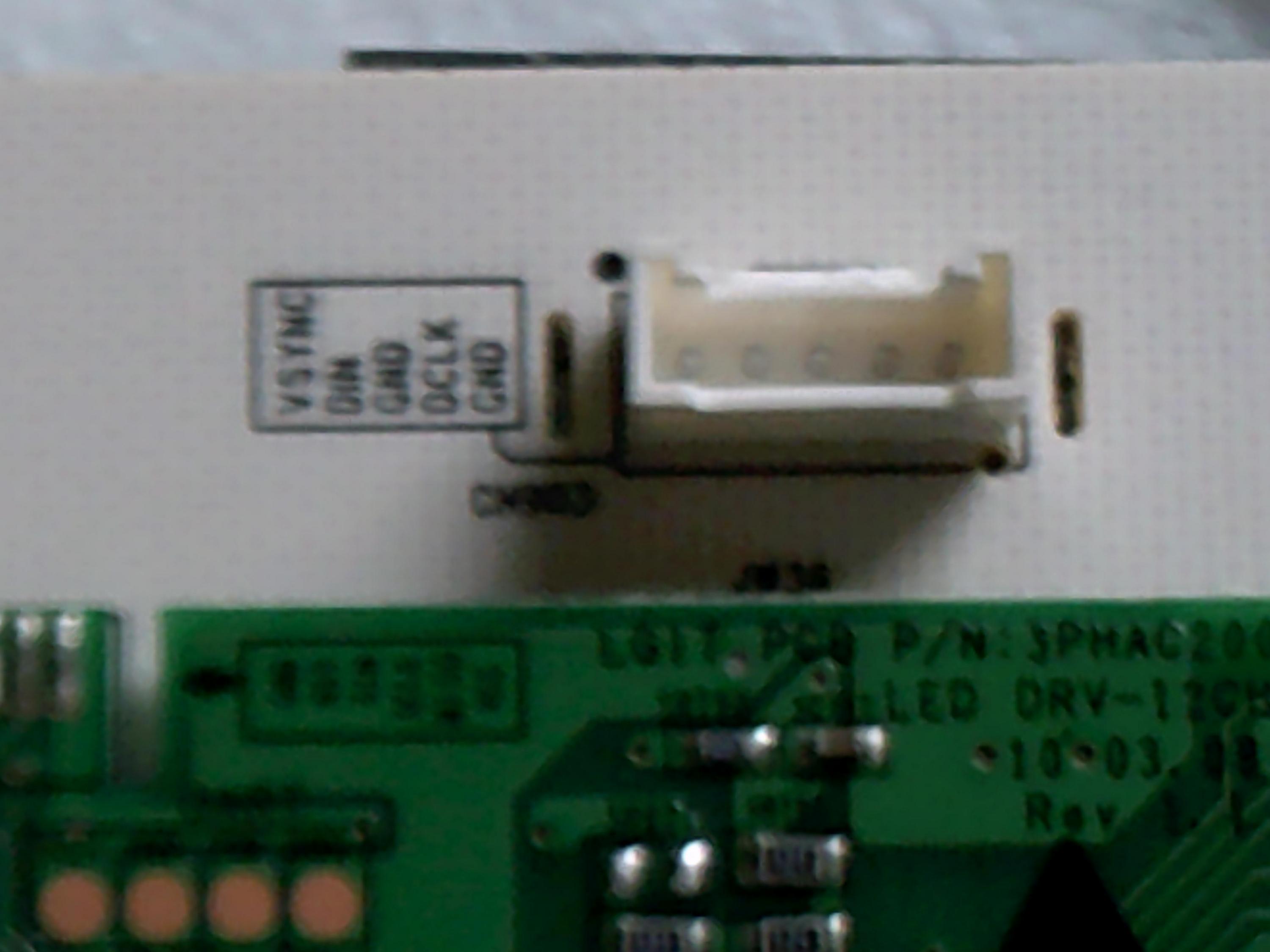

                                      I rechecked voltages:
                                      on/off-4.91v
                                      dim - 2.93v
                                      12v - 11.91v
                                      12v - 11.91v
                                      G
                                      G
                                      G
                                      24v - 24.67v
                                      24v - 24.67v
                                      ps_on-3.09v
                                      5.2v - 5.11v
                                      5.2v - 5.11v
                                      acd -
                                      Vled-194.7mV
                                      all #- 10.65v
                                      Vsync- 25mV
                                      DIM- 58.5mV
                                      G
                                      DCLK- 49.1mV
                                      G
                                      I assume vsync and dim should be giving a reading and im not sure about ACD.
                                      Now im thinking it is the middle board(pc/tcon?) or possibly main board.

                                      Any idea how to test pc board? Theres a connector from main board but nothing listed by it.
