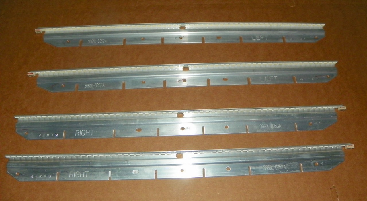

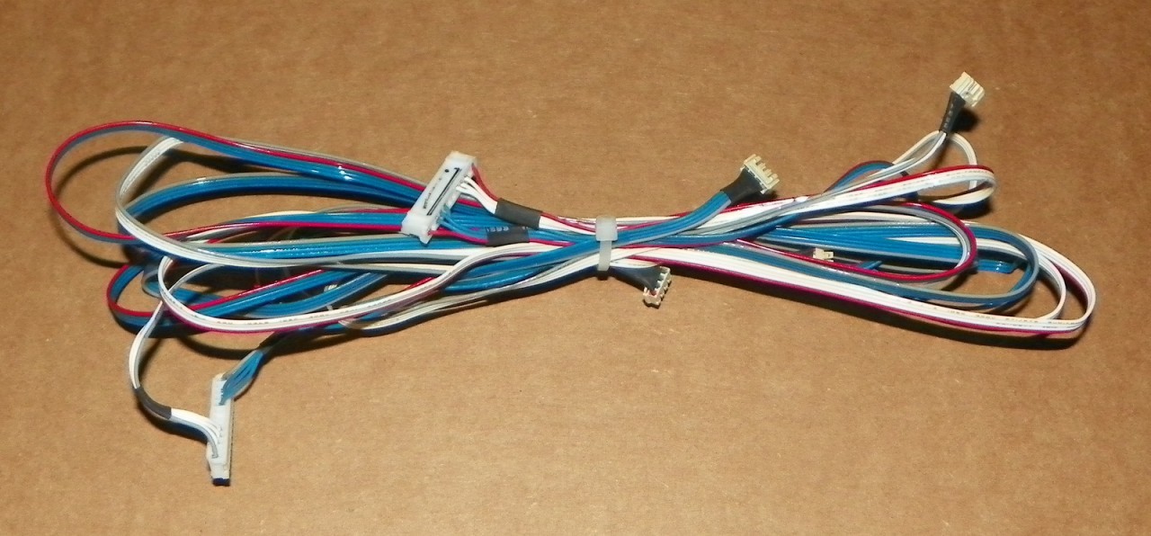

            This is the only board I can find in stock and I think there based in china and affiliated with aliexpress. I dont know if these guys are reputable.
            http://www.buyqual.com/3pcgc10021a-r...27lt-lips.html
            The pics below are of the led and cables for backlight. The site I got the pics from listed the same panel but a different model tv(M421NV).

                I may buy the used led kit I found for $45 just to plug into power supply and try.
                They list a different model tv but the panel number LC420EUH match.
                I assume this will work but
                Do the numbers in brackets matter? such as (SC)(A1)?
                The reason I ask is the wires in pic above are different colored(red,blue,white,grey) than mine(blue,white,grey). The connections look correct. I think everything is the same except their red wire is grey on my panel.
                It is alot more work to open panel to check. Im hopeing this can be used to bypass led's in my panel. If the tv powers on and the new led's go on, then I know I have to open panel and replace led lights.
                Or should I just try another power board first.
                Opinions?
