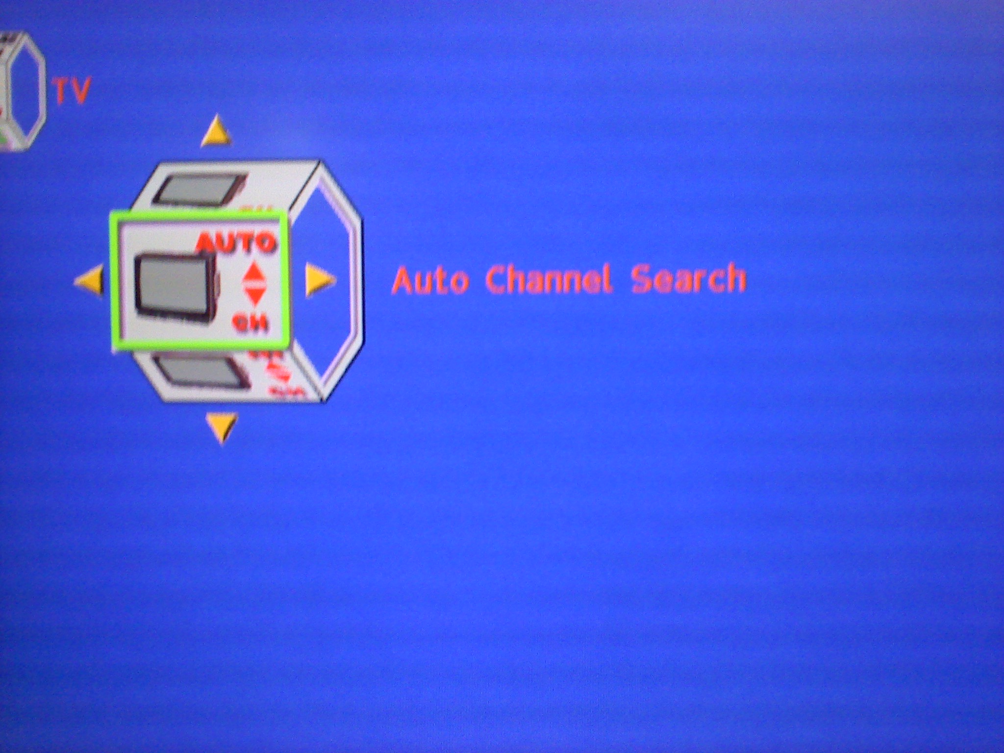

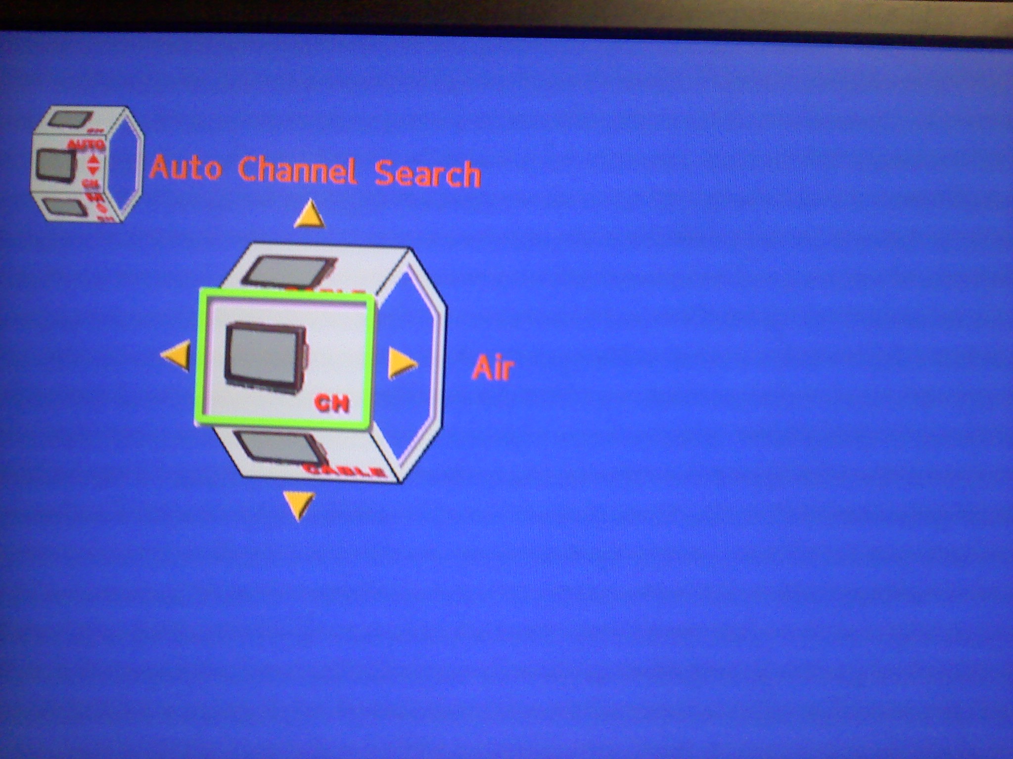

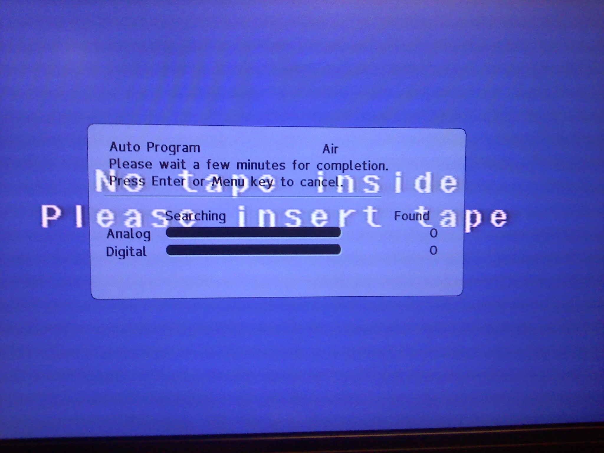

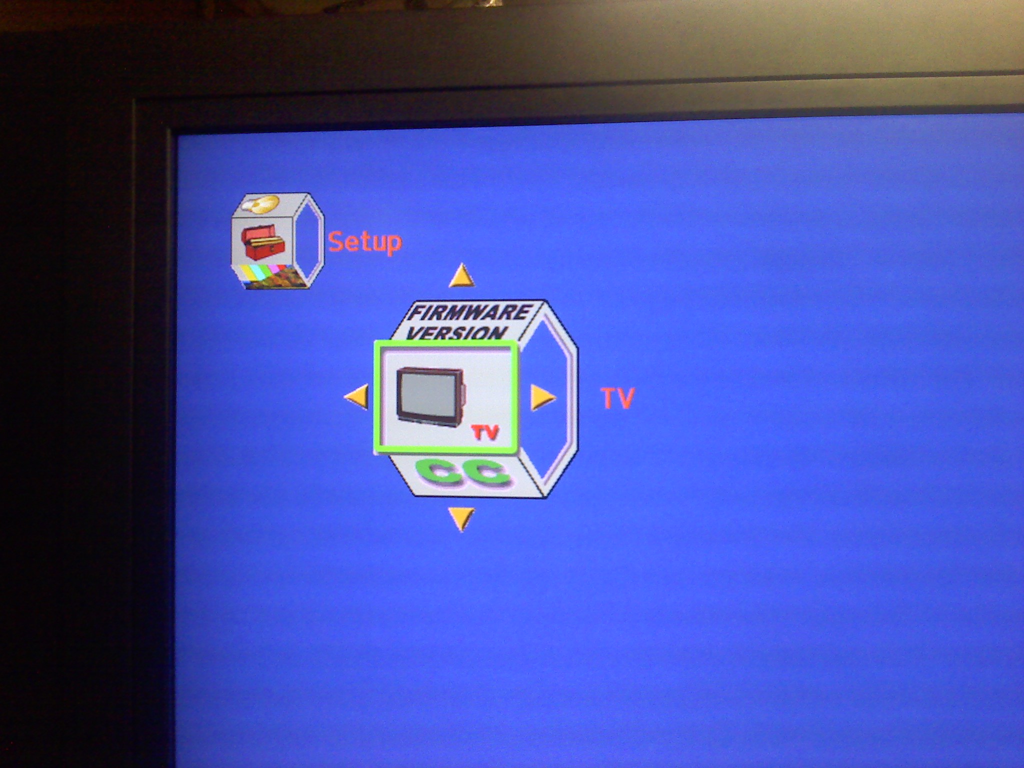

    I got this used set up and running, Works good except the tuner won't auto scan. It will take direct entry of analog channels. It is in the (home) mode. Does anybody know of a source for firmware? Or is it something else? thanks

    Is there nothing on that menu for factory reset?
    Try digging around with this - maybe a reset option - googling it does seem a common problem but didnt spot a solution

      Yea , I has a factory reset, And an input source settings reset, Tried both they don't affect the tuner function. The tuner tunes analog stations as you can see in the last pix that shows the set in scan mode with the output of an old VCR in the background I found an olevia website that claimed it had firmware, It set off my computer anti virus software. I know the company is out of the business. Can't even find a used board. Thanks
