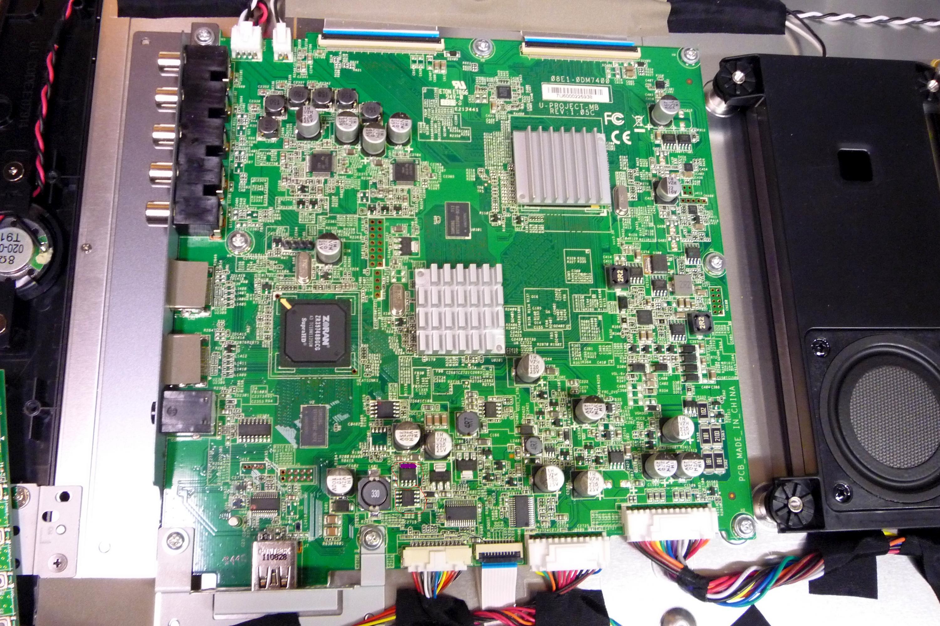

                  I picked up one of these to mess with I read somewhere that the issue is because there
                  Not detecting the hdmi
                  But after some testing im getting all supposed of voltages
                  But there not showing up on the led ribbon
                  Could one of the led driver chips crapped out and not aending the power to the led's so the monitor is giving the 2 blinks

                    Re: Sony CECH-ZED1U Playstation 3D LED TV - Two Red Flash
                    look at the image and heres some things
                    the black line represents the connecvtion with the 100 volt cap and the main power to the led's on power there is no voltage present i would imagine it would be 90+ volts
                    now look at the red circles theres also no voltages there except on the purple side it has 24 volts
                    thats the section im leaning towards as where the problem is the chip is not being told to turn on the chip to boost the voltage or those 2 chips are bad
                        yes its led theres power going into the led driver circuit but its stopping there and never making it to the led ribbon cable
                          im going to dig out my busted sreen vizio e420vse and snag the dc to dc converter
                          http://www.ebay.com/itm/100W-DC-DC-b...item27c901e470
                          and supply that 100 volt cap with 90 volts to try to power the screen i have 2 of these monitors so if i blow something up oh well plug it into a wall switched outlet and swing a broom at the switch i have a ps3 remote so i can power that way
                              Its detecting the fault in the system
                              Ive frozen the driver chips and have heated them but will not turn on ill search for the documents for the chips
                                      https://www.monolithicpower.com/List...orm.aspx?ID=30
                                      There are two of these on the board
                                        According do the data sheet im not getting any voltage on vcc, vin or pin 4
