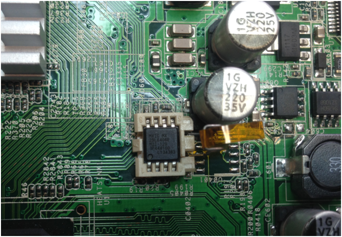

Another success story to report! Thanks for this forum and especially to zhaojun297 for the BINs and rostomchik (followed his shopping list, although I think one of his links for the adapter sends you to the wrong one. You need the SOIC 208 mil to dip8 adapter for this).
My only two cents is that I did manage to put a socket (I live in the UK so got it from http://www.bios-repair.com/Products/SMD-Sockets.html the SOIC8 pin 208mil one of course). It was a bit difficult (a couple of tense moments) but doable (see pic enclosed) and I am happy now because it if happens again - no more soldering just will put another flashed IC!

OK MiguelUK, what soldering iron did you use to solder the socket. From looking at the socket the legs are under the socket, not exposed like the original. I to like the idea of the socket for the same reason stated. I have 4 of these units, all seemly with the same problem. And one that has been working for the last year with no problems. Bought it from some one off a classified ad site, said the unit had been refurbished by Sony.
Now to the person who suggested lifting #3 leg, WP so that the code couldn't be corrupted? What if we wired a switch so that when we do make changes we are able to save them. Once saved then turn switch "off" to eliminate it writting again, does that sound feasible??Comment

I just used a normal soldering iron station (http://uk.rs-online.com/web/p/solder...tions/0186719/ I think with 0.8mm tip). Use lots of Flux.OK MiguelUK, what soldering iron did you use to solder the socket. From looking at the socket the legs are under the socket, not exposed like the original. I to like the idea of the socket for the same reason stated. I have 4 of these units, all seemly with the same problem. And one that has been working for the last year with no problems. Bought it from some one off a classified ad site, said the unit had been refurbished by Sony.
Yes the socket legs are under the socket which might seem a bit difficult but I think removing the original IC was harder. You do need a good magnifier lamp. The angle is not so bad with the magnification. Fix one of the corners first and then center the socket and do the rest of the legs. I had to remove some excess solder from the contacts at some point as the sockets needs to sit flat. I think the trick is to use plenty of flux and you should be fine.Comment
