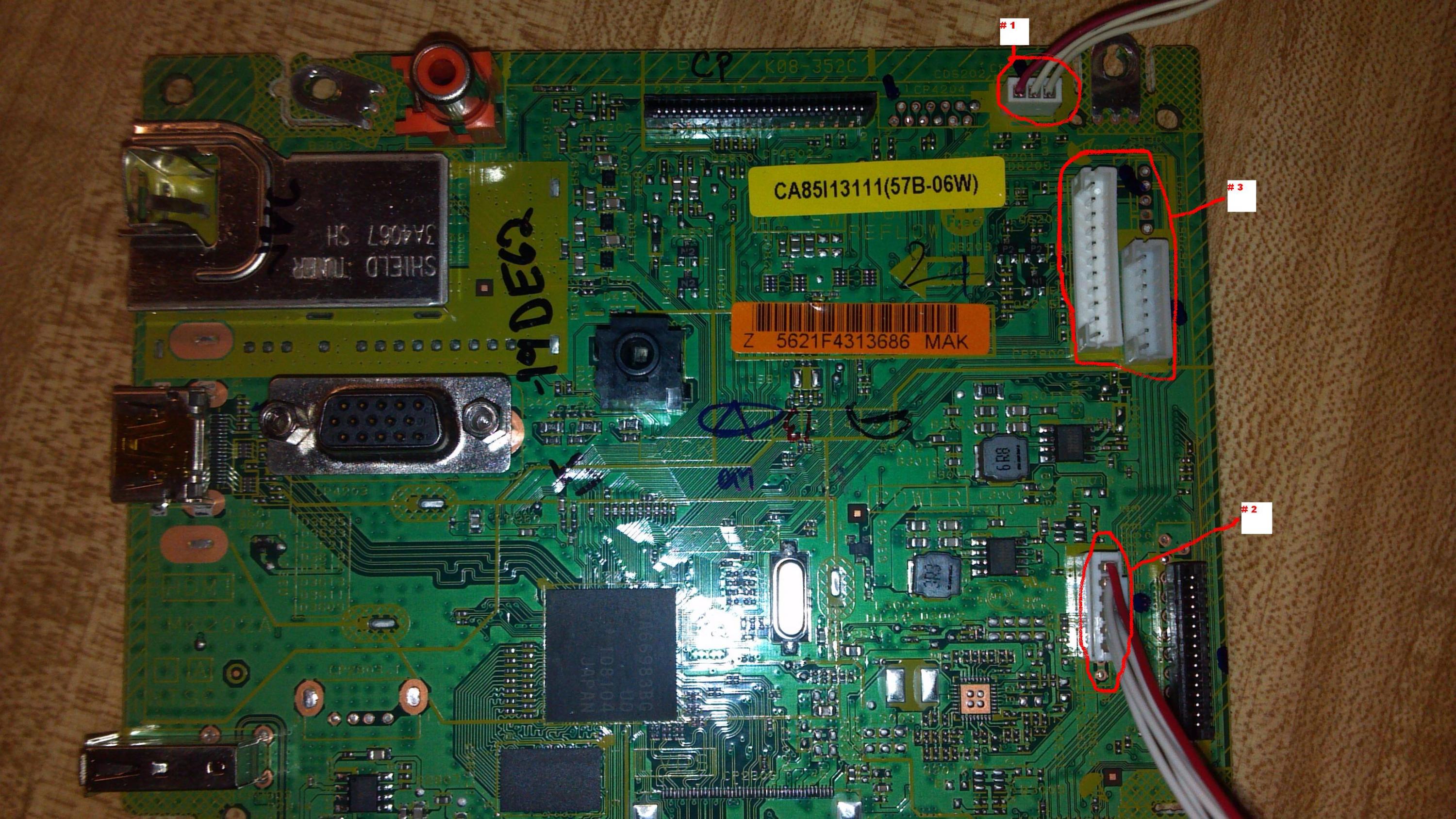

    Hello I need some help. I picked up a JVC LT-22EM72 that has been taken apart. I need some help with the connectors on the CA85I1311 Digital Main Board. See attached picture connectors are labeled # 1 and #2. I believe #1 connector goes to the power button but can't see where #2 connector goes. The only open connectors are # 3,but connector # 2 doesn't match any of the two connectors labeled #3.# 2 connector has 6 wires connectors #3 have more than 6 prongs to plug into. Does anyone know where connector would connect?

    Can we see all the boards?

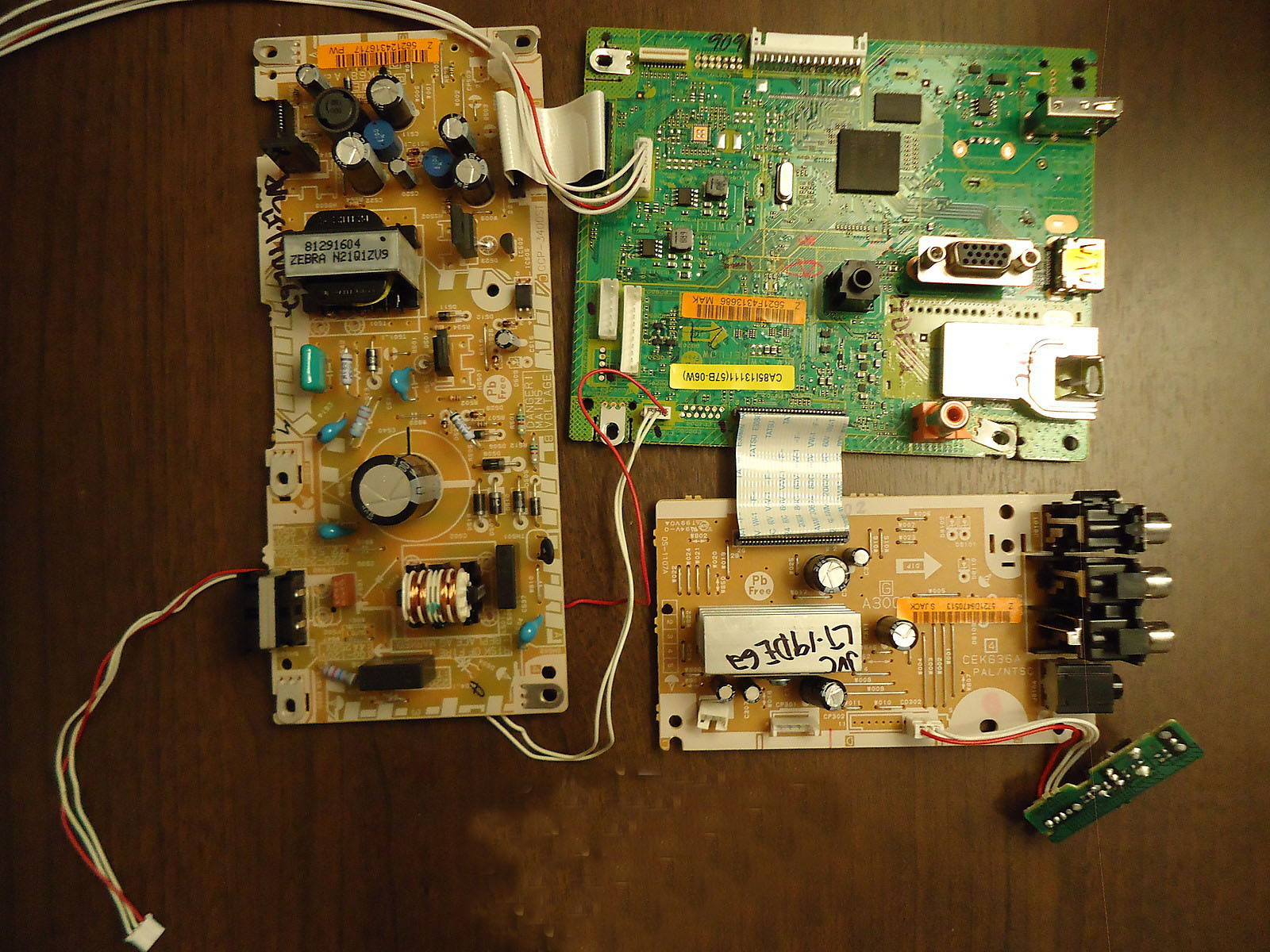

      Re: Connector help JVC LT-22EM72
      Yes here are all the boards except the power button.
        Are you sure these fit a LT-22EM72 - someone has labeled them LT-19DE62 so might also fit a LT-22DE72

            Well I am still not convinced - here is some info in no particular order which may help you.
            CA85I1311 Is wrong should read CA85I13111
            Speakers have 4 pins and fit both possibly into CP301
            DE signfies DVD player cable 6/7 pins
            http://i.ebayimg.com/t/CEK636A-A-V-Input-Audio-Amp-Board-JVC-LT-19DE62-LT-22DE72-with-IR-Board-/00/s/MTIwMFgxNjAw/$(KGrHqV,!hME-Y,Gil)3BPvN4,ID1g~~60_57.JPG
            Shows connectors to two small boards IR & LED? on CEK636A
            What is on the other end of the cable plugged into socket#2
            (or is that what you are asking?
            http://i.ebayimg.com/t/Sanyo-A55Z01K650-DVD-Assembly-DP26671DP32671JVC-LT-32DM22-LT-19DE62-/00/s/MTQxN1gxNjAw/$(KGrHqF,!hEFBy+0JLMnBQf)9VR-l!~~60_57.JPG
            Shows the picture of the cables at the dvd end so you should be able to seee which flat cable socket is the dvd one by counting the pins
            The main board for a LT-22EM72 is s CMK202A and it does not have the dvd socket which you have called socket #3
            Tuner board for a LT-22EM72 is a CACBI22031 CML231B
              What is on the other end of the cable plugged into socket#2 yes this is what i was asking.So it looks to be the wrong board?
                I dont know for certain - do you have a dvd drive?
                It may not matter - you may be able to still use the board
                the one without the dvd socket looks basically the same.
                Not all sockets HAVE to be populated those labelled 2 may be to connect
                some de-bugging service equipment.
                Not much about in the way of service manuals - even the parts list doesnt list the parts and just refers to Orion a service co?
                    No don't have a dvd.Yeah the connector needs to be fixed just a little solder.But just looked at shopjimmy.You are right this board doesn't go to a model LT-22EM72.I didn't think to look at that since all boards where with the tv just no connectors where connected.I need a model # CAAFI19081.Thanks
                      you may be better to start with the panel you have -(most expensive part)
                      Find the make model part number for that.
                      Find which main board you can use with that panel
                      Find which Power supply you can use with that main board.
