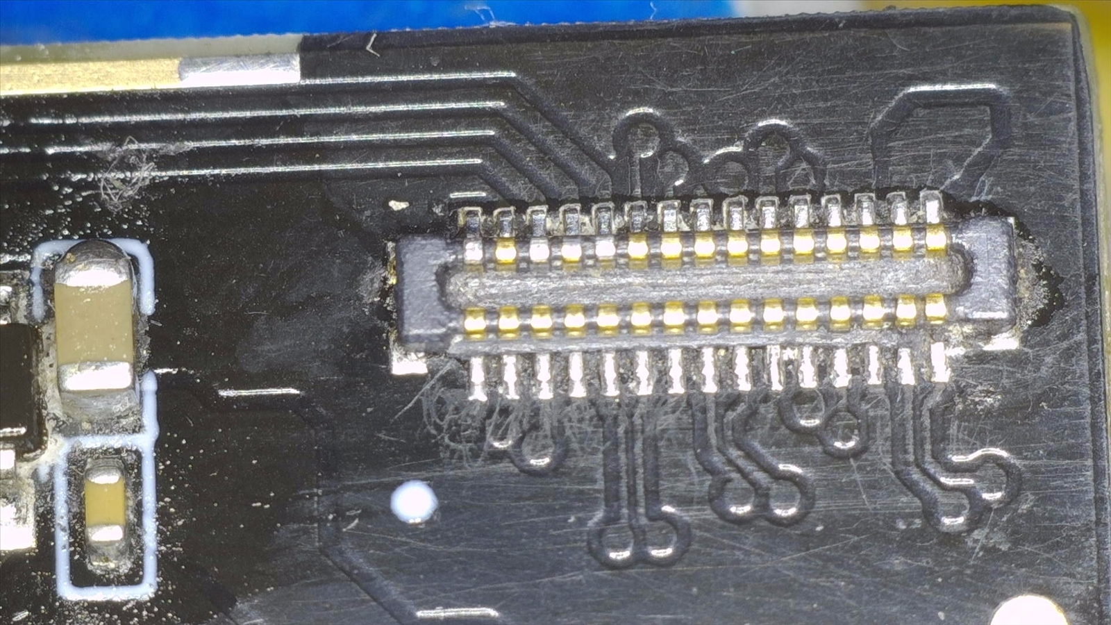

    Hi everyone
    I have a 70mai Dash Cam A510 which failed after about 3 months of being installed in my car, likely due to heat, i got it from aliexpress so no point in trying to return it for warranty (and shipping it back would cost me almost the same as a new one from ali)
    The camera would boot loop showing 70mai logo on the screen, sometimes it would boot fine then the live view would freeze or display purple lines

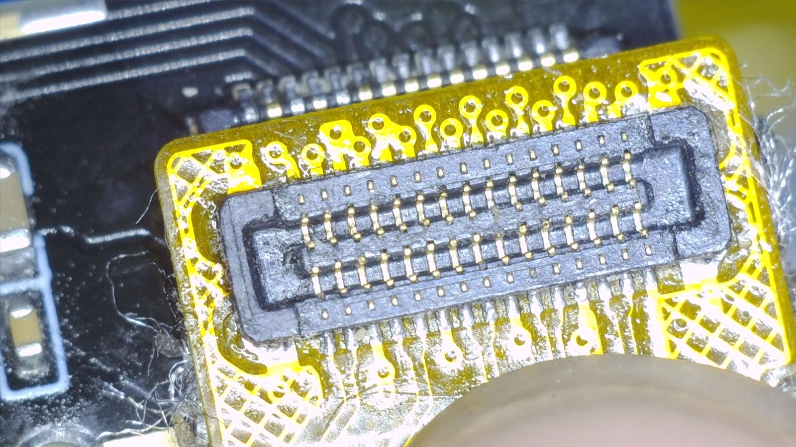

    I already took it apart, and found out that the camera boots fine if i unplug the camera module from the main PCB, sometimes "playing" with the connector on the camera module side, or adding pressure with a piece of tape on the flex cable and fitting the camera module into its housing would make it work, but it's unreliable, it would work for few seconds (i once got it to work for hours) then the image would freeze, sometimes the image gets back but when that happens, the recording on the micro SD stops at the point where the video froze
    I need help identifying this connector, pin pitch is 0.4mm, 30 contacts, likely Hirose or another manufacturer
    Maybe it's similar to one used in cell phones, but i can't find an exact part
    I already tried resoldering the connector, the residue is flux
    Added pictures of the connector at the camera module, and the flex cable
    Not sure if it belongs in this forum section (as it says "weird devices"), or on the TV/video sources
    Any help is appreciated

    Some sort of a 30 pin FPC / FFC connector for flex cables and small main boards like phones, etc.
    I suppose you could get rid of the connector and solder small wires between the board and flex.

          I think i found it after looking a lot of pictures on ali
          YXT-BB10-30S-02 for the female socket (on flex), YXT-BB10-30P-02 for the male plug (on the board)
          https://www.aliexpress.com/item/1005005571026167.html
          Or this one OK-23GM030-04 and OK-23GF030-04
          https://www.aliexpress.com/item/1005008342022492.html
          I measured the connector with a vernier caliper and these ones are the closest match

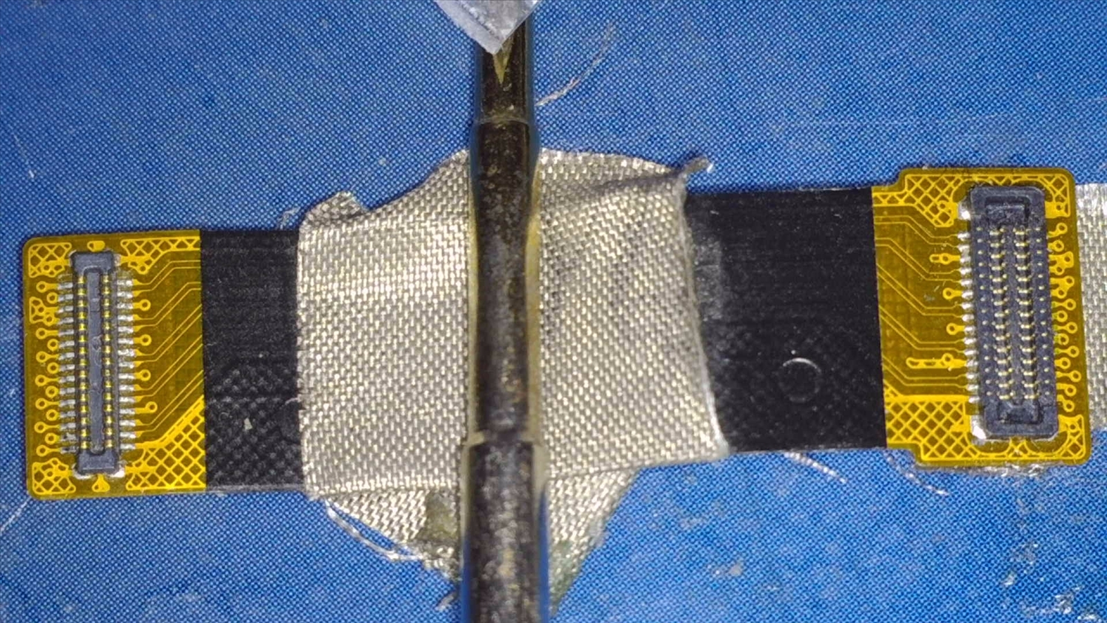

          Actually the flex cable has both male and female ends, attached picture for reference, now to find a source for that gray conductive cloth tape, the glue doesn't stick anymore (maybe it's not critical, used for grounding)
          Datasheet attached for the connectors
          2409302203_YXT-YXT-BB10-30P-02_C2763974.pdf
          Spec_Draw_OK-23.pdf
