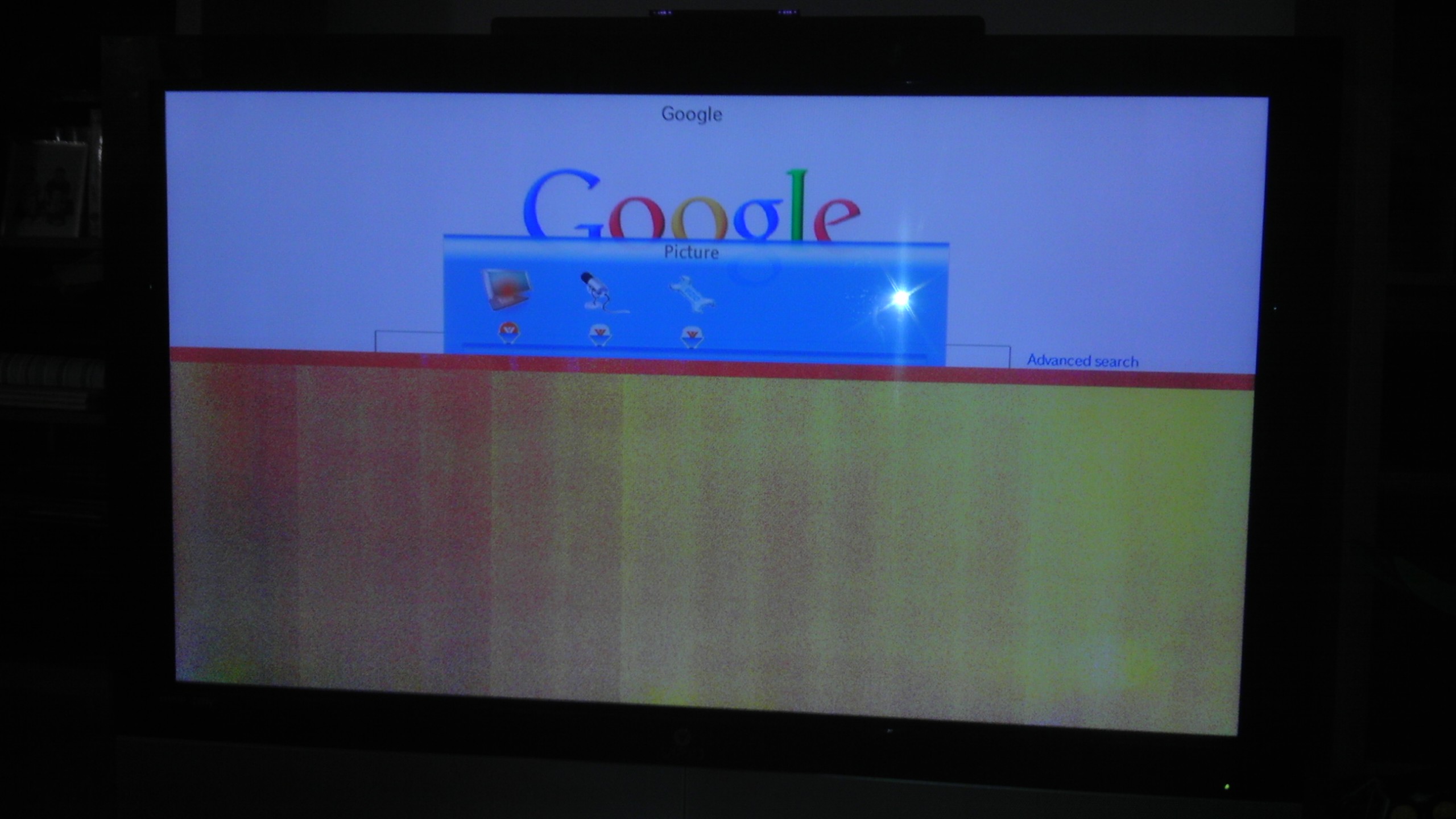

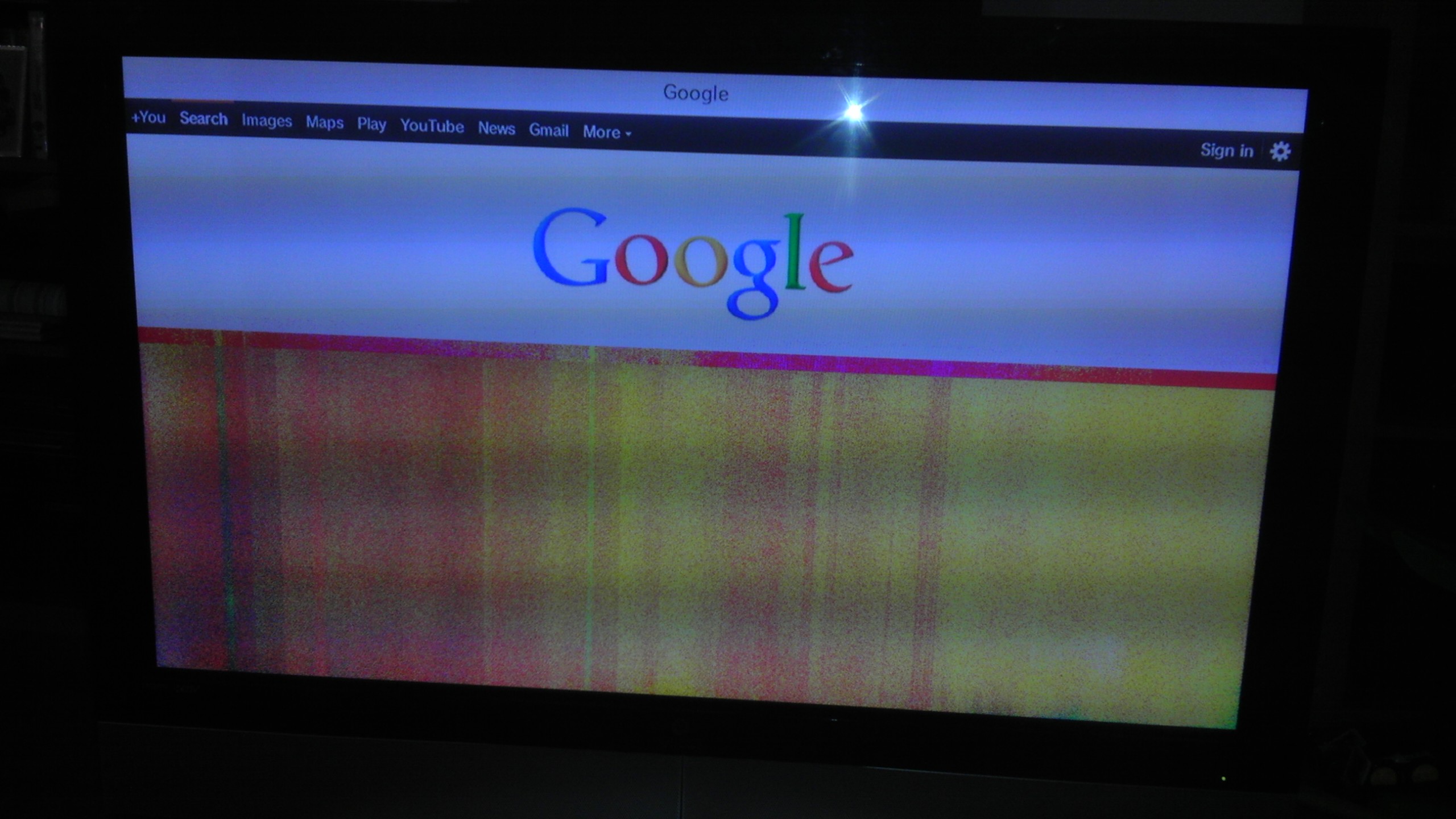

    hello, I have a Visio p50 HDTV20A and the bottom half of picture is yellow red with pink lines floating is my tv shot?? or can I replace a board of some sort?? any help would be amazing.

    I'm going with lower Y buffer board.

          You should be able to test the buffers for shorts. This article deals with samsung but I would imagine the procedure is same. Pictures will help you get more assistance.

              I'm going to disagree. The picture doesn't go crazy at exactly half of the screen. Probably the upper buffer -- one lower IC failed -- meaning the chained signal is getting lost for the rest.

                Now that you mention it, I do see it's not exactly half the screen, and I would agree with your diagnosis.

                  i have the p50 hdtv20a. one of the buffer chips on the upper buffer board was noticeably burnt out, but i couldn't see anything wrong with the ysus board. i replaced the bad buffer chip, now the tv powers on, but only the top 1/4 of the picture comes on. ideas?
                    Re: vizio p50 hdtv20a half screen pic if problem attached
                    Could be other buffer chips bad. The signal between each is chained, so if one goes bad the signal can get lost.
