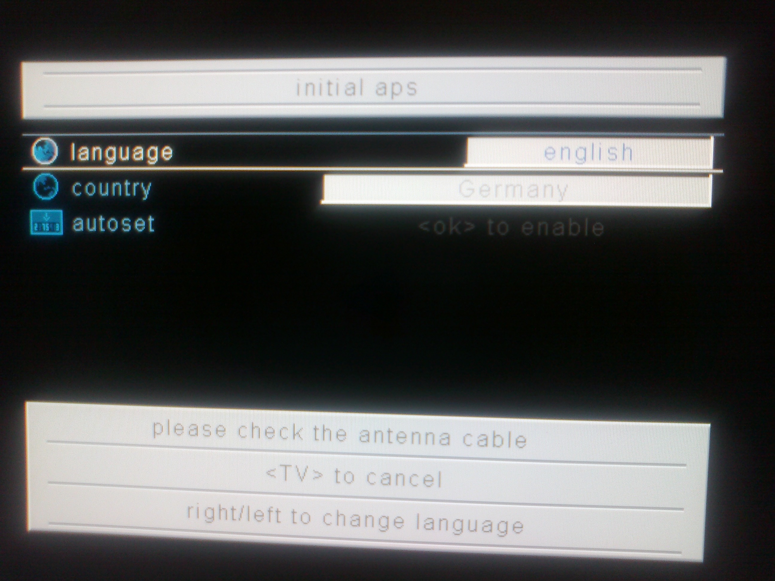

                                Re: DEG LCD TV(no model number) WITH BACKLIGHT WORKING BUT NO PICTURE, NO SOUND
                                I tried it Tom, and this is what i saw on the screen-image below-. I made the necessary adjustments but it still did not produce any picture or sound like you earlier said. But does this little change prove that if i replace the eeprom it will work?
                                  #36
                                  Just proceed through the setup stages - select country, tune TV, etc. I think you'll need a blank eeprom to test it properly.
                                  Or did you try that and it did not work?
                                  I would try a blank eeprom but if not then the main board may need a replacement or repair depending on price.
