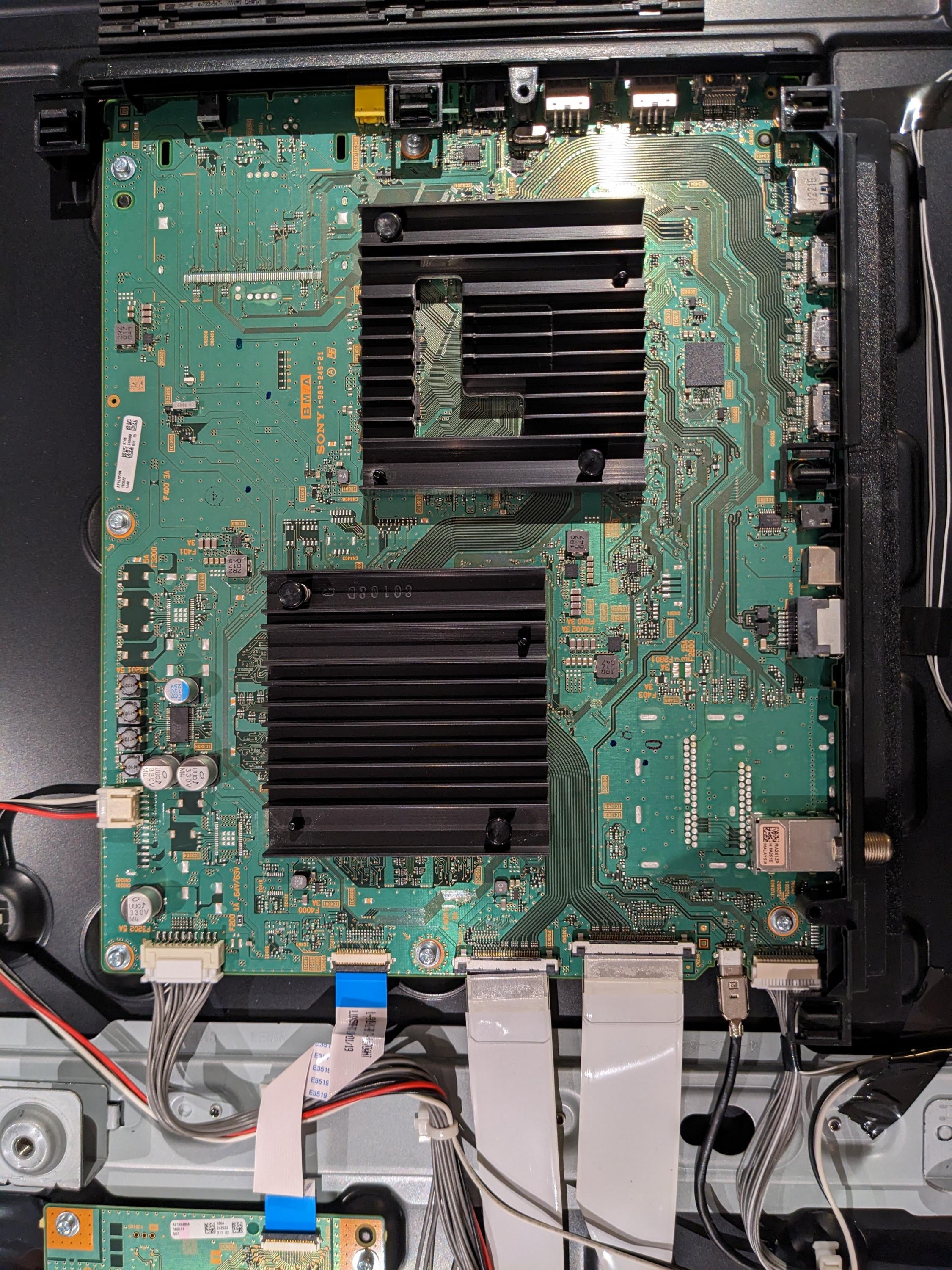

    Hey,
    I have this subject TV and when I plug it in I don't get a picture, backlight or sound. The remote and power buttons don't seem to do anything. I've metered the signals on the following after plugging in the TV;
    Power Supply Board Connector CN6401 between PSU, MB, TCON
    PIN 1 - BL_ERR - 0VDC
    PIN 2 - BL-ON - 0VDC
    PIN 3 - POWER_ON - 3.47VDC

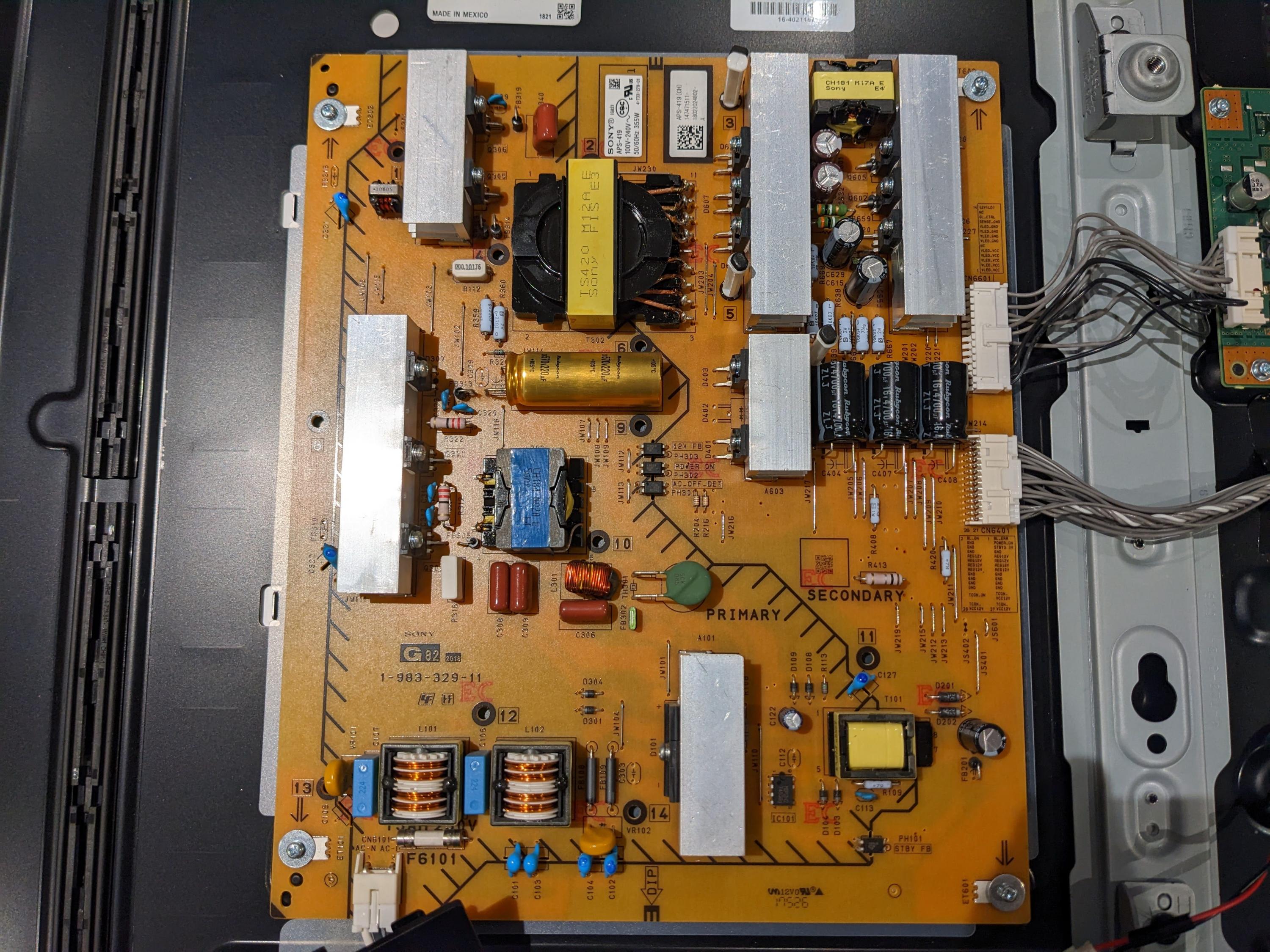

    Power Supply Board Connector CN6601 between PSU, LED Driver
    PIN 1 - VLED_VCC - 26.04VDC
    PIN 2 - VLED_VCC - 26.04VDC
    PIN 3 - VLED_VCC - 26.04VDC
    PIN 4 - VLED_VCC - 26.04VDC
    PIN 5 - N/C
    PIN 6 - N/C
    PIN 7 - VLED_GND - 0VDC
    PIN 8 - VLED_GND - 0VDC
    PIN 9 - VLED_GND - 0VDC
    PIN 10 - VLED_GND - 0VDC
    PIN 11 - SENSE_GND - 0VDC
    PIN 12 - BL_CTRL - 0VDC
    PIN 13 - N/C
    PIN 14 - 12VLD - 12.69VDC
    From my limited understanding, the MB has provided the Power On command to the PSU to bring up all supply voltages, but then.....nothing. No backlight command, no tcon command. Safe to say the MB is the issue and to replace it? Is there anything else I should check before I just replace the MB?
    I read in another post with similar issues that BGA re-work might be required?

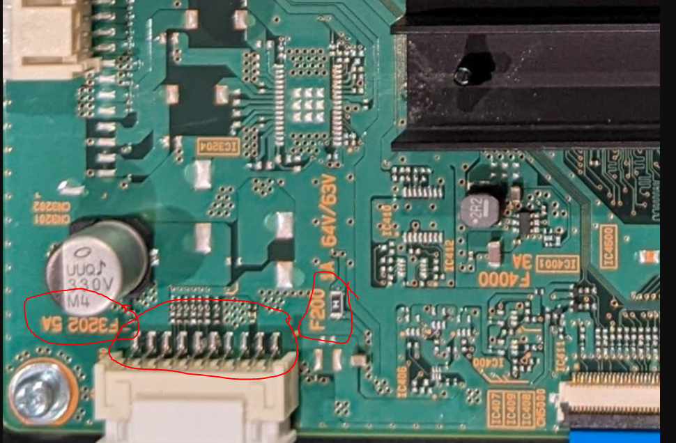

    There may be several very small fuses on the mainboard, check them for continuity.

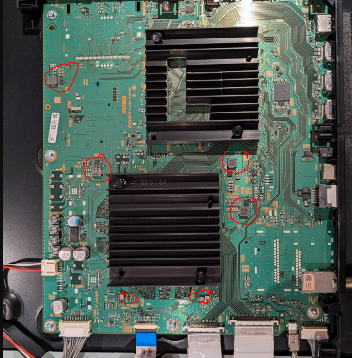

      Can do a quick check on main's internal power rails
      • SPDIF light on?
      • USB has power?
      • All big inductors on main show some typical voltages? ~1V for CPU. ~1.5 DRAM, ~1.8 + 3.3 eMMC, 5V near USB
      I actually have this board from a cracked screen salvage from a couple of years ago. Too bad you are in CA haha ($$$ shipping from US)

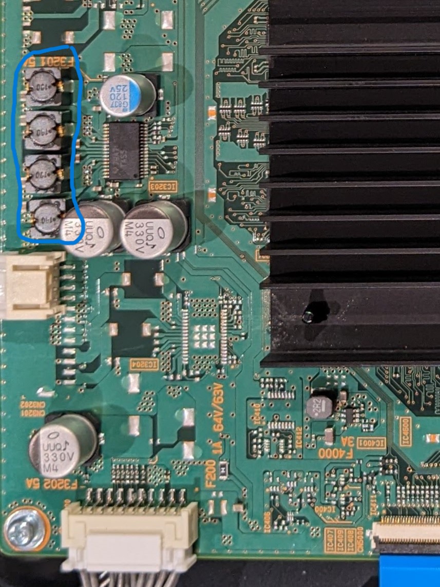

        0V on all circled inductors. 0V at USB. No light on the board at all.
          I checked as many as i could find and they were good. Gonna take a closer look tomorrow under the microscope at work though.
          Also, the big caps in the previous picture all had 12V on them.
            You don't measure voltage there at all, these coils for an audio frequency power amplifier (output for speakers), you need to measure them on these coils.

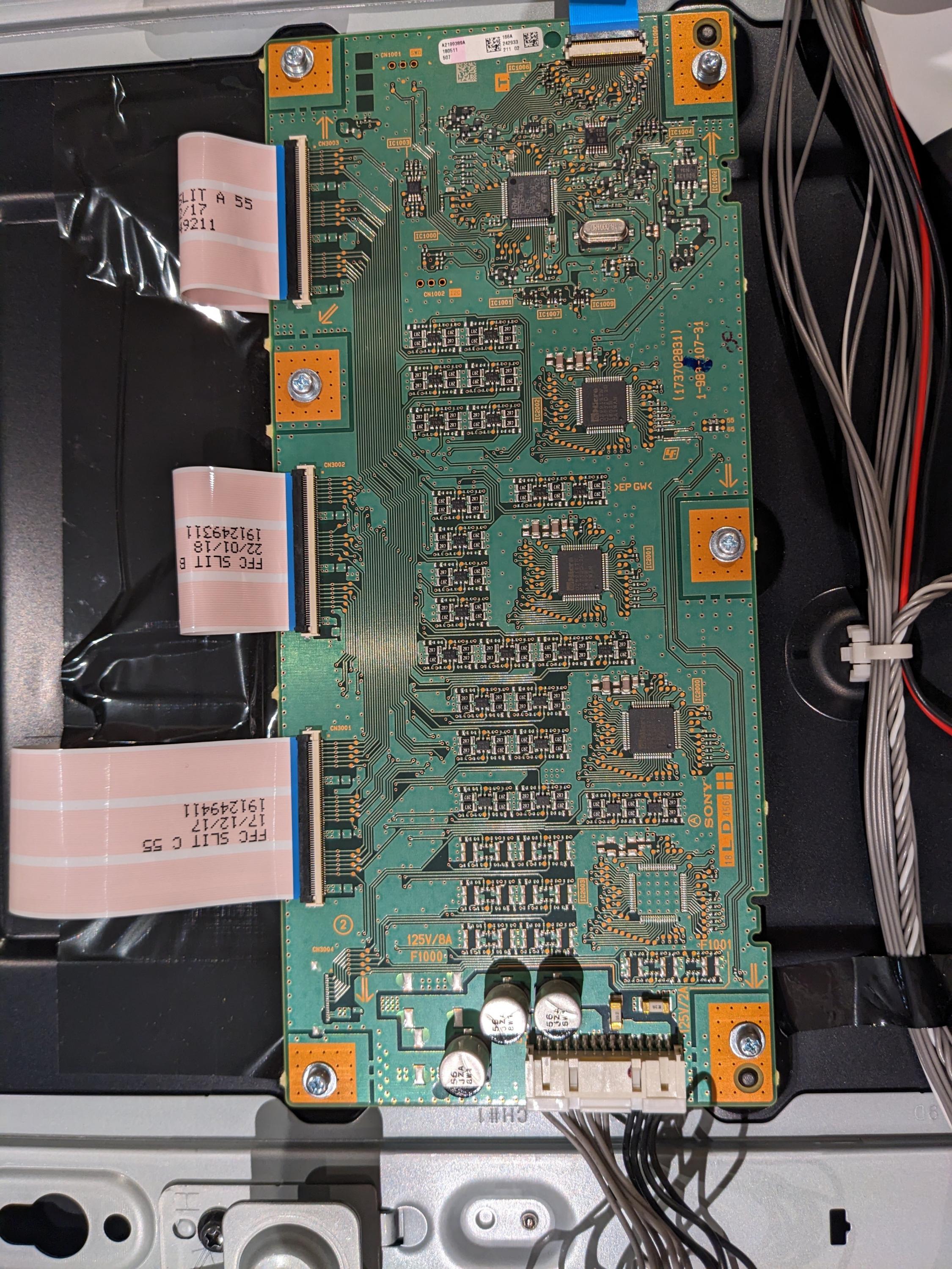

              Do you have voltage anywhere on the backlight driver/LD board? maybe check some of the round test points or the little mlc caps, I see you have voltage going to it, wondering if it's getting thru it.

                Maybe also check the round test pads by the connectors going from LD board to the backlights.
                      0V on all the inductors you indicated.
                        Fuses are good, 26VDC on the caps, very low V (~0.5VDC) on the various test points around the cables leaving the LD board to the backlights.
                              CPU, RAM, eMMC not powered up so have to see where the PSU's REG12V DCDC conversion to lower voltage path failed. Or can buy main board if confident enough its the failure source.

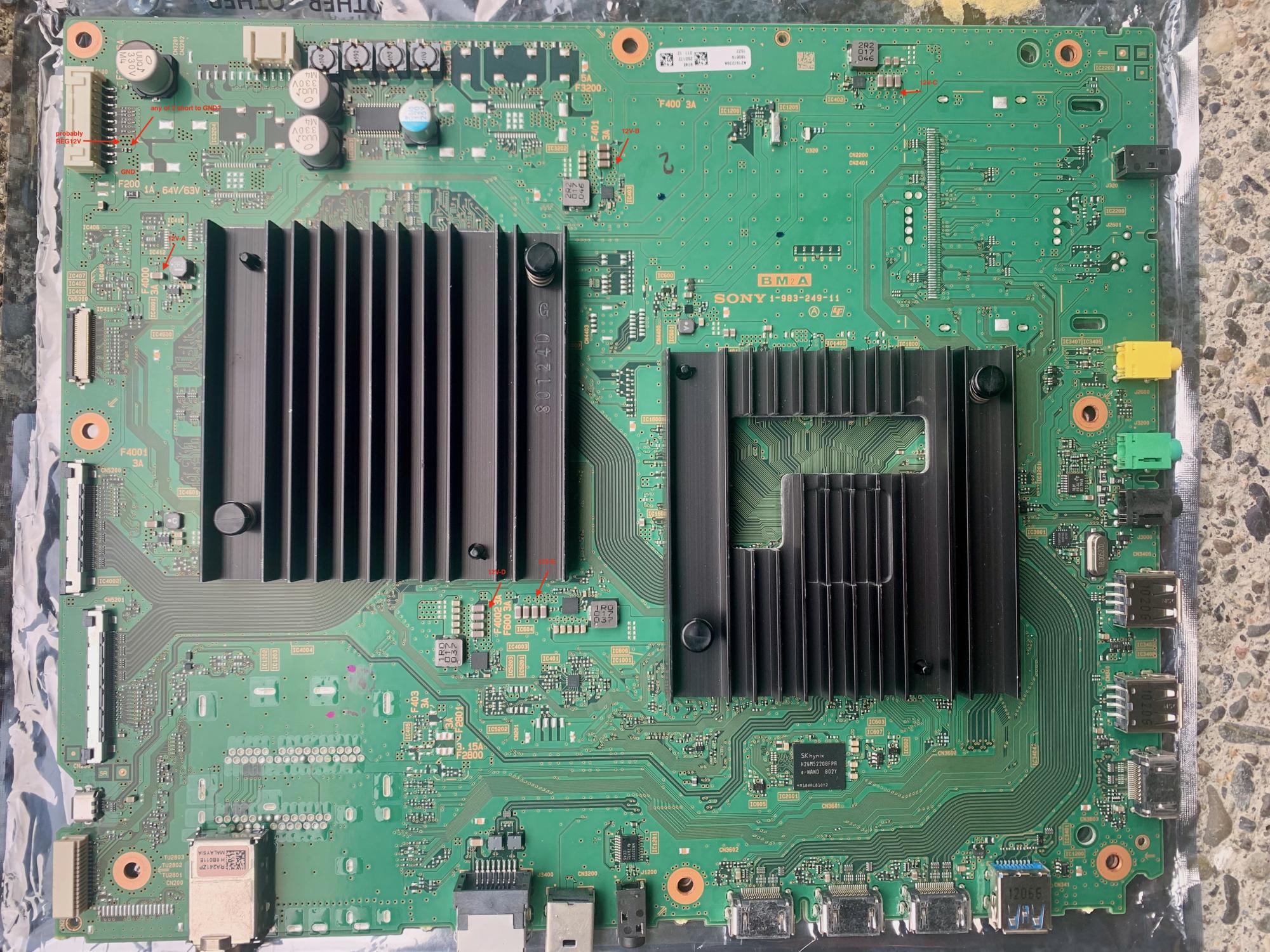

                                      Need schematic or some reverse engineering. Luckily I have the exact board in hand haha...
                                      • Traced REG12V to 5x DCDC for reduced voltages. Check voltage at all 5 points labeled 12V-A->E. Probably all 0V.
                                      • Check the 3 components between where REG12V comes into main and the GND plane right below it. See if any are shorted.
                                      BTW SONY boards are nice... lots of holes on voltage rails and have exposed copper for easy test
