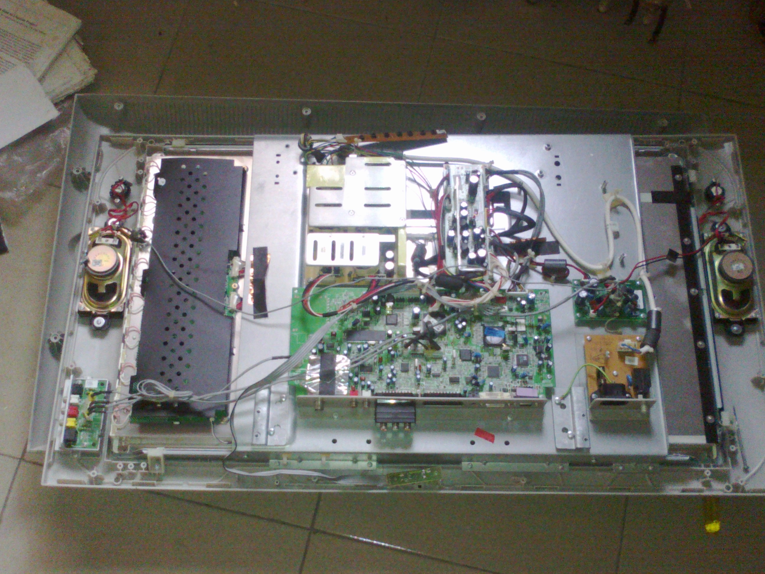

      Re: DEG LCD TV(no model number) WITH BACKLIGHT WORKING BUT NO PICTURE, NO SOUND
      Thank you very much Tom66 for your prompt reply. Like what components should i text in the main board. I have attached a picture of the tv panel. Please, kindly indicate the main board to me and the areas to check.thanks.
        Looks to be some Vestel variant -- the main board is that largest green one in the middle of the TV.

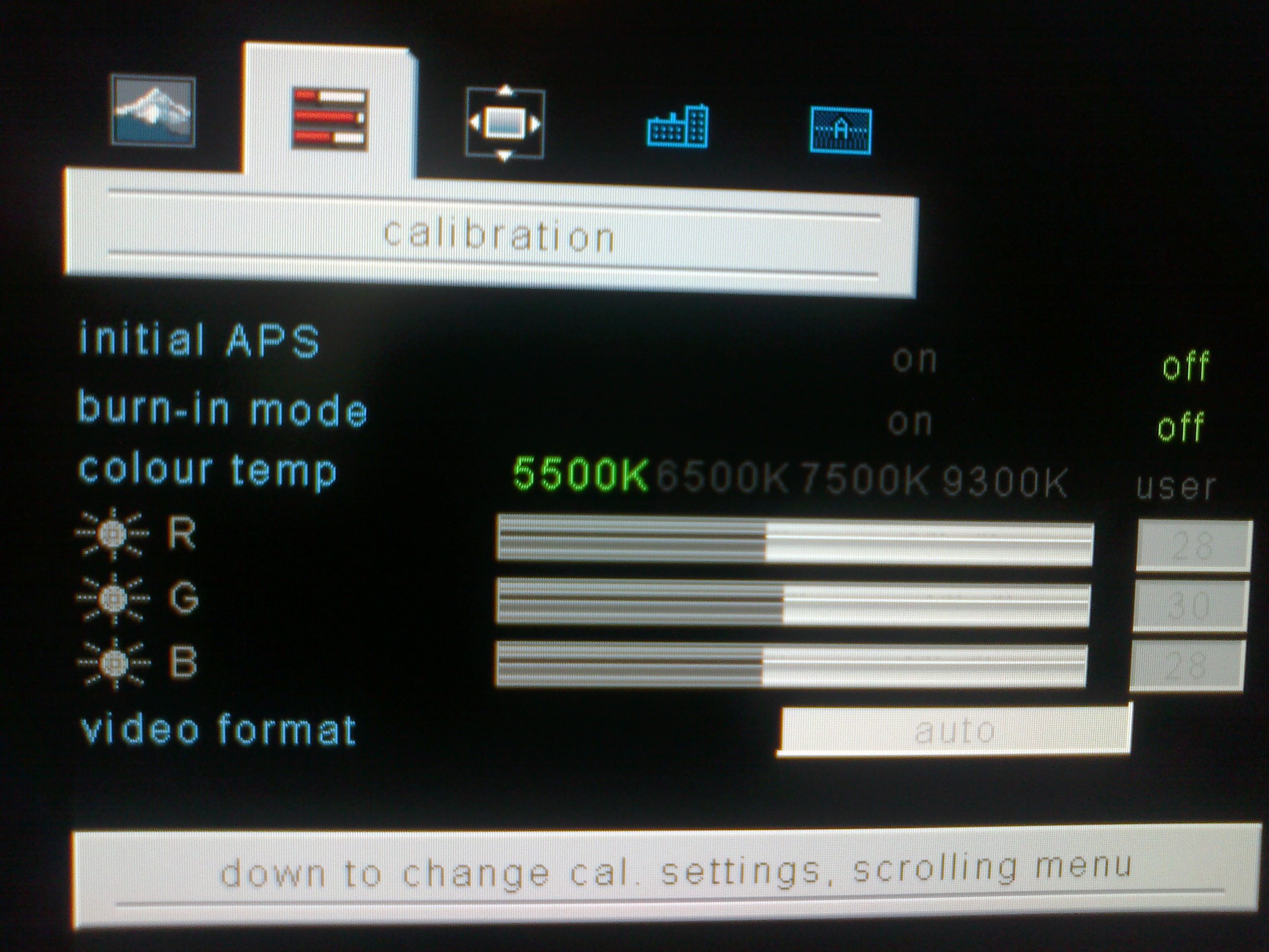

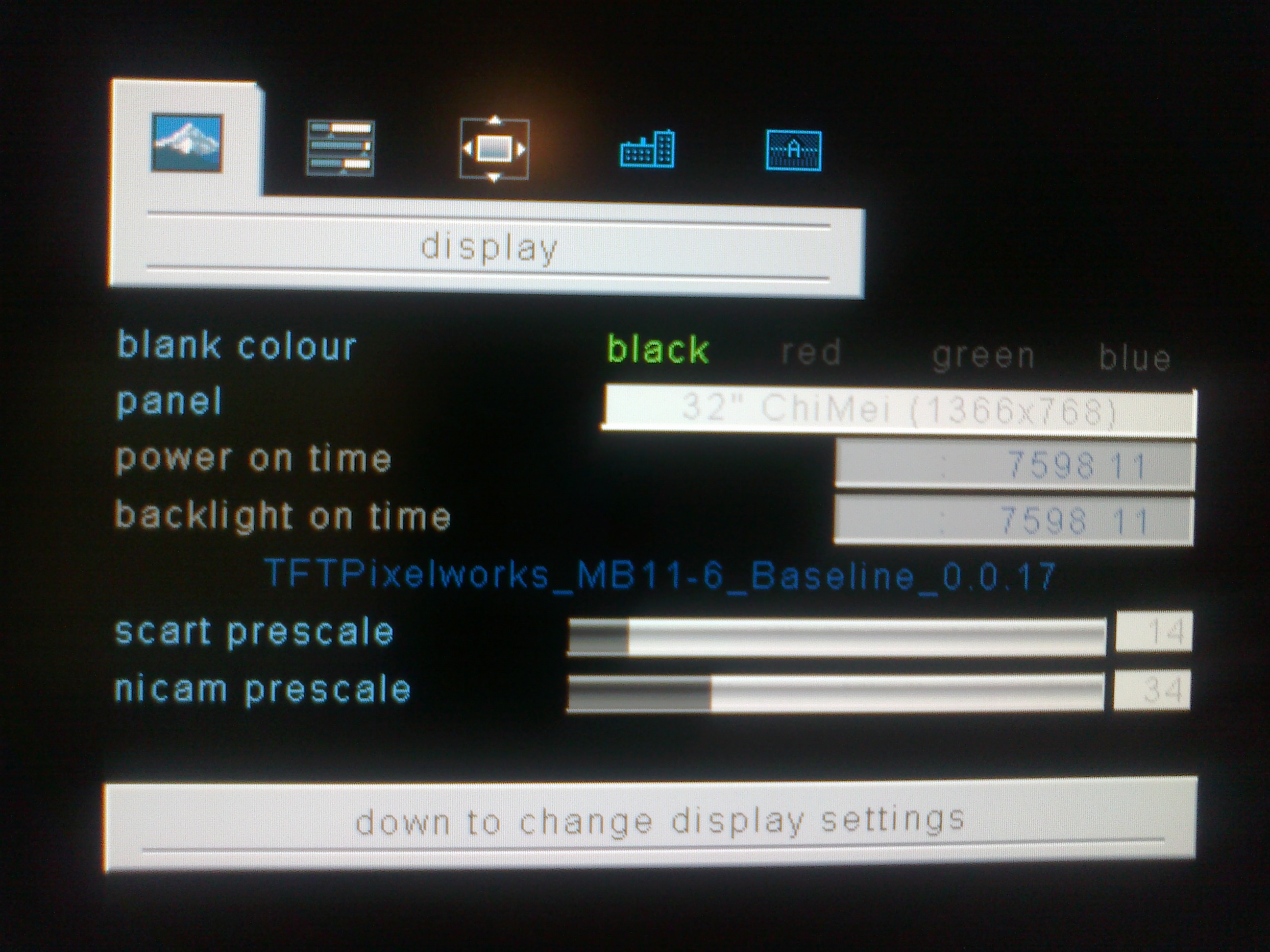

                    OK, so turn the TV on to an analogue channel (where you would normally see snow if the TV was working properly.) Then press MENU on the remote, followed by 4, 7, 2, 5 in quick succession. If all goes well, a secret option menu should appear. Can you show us a picture of this?

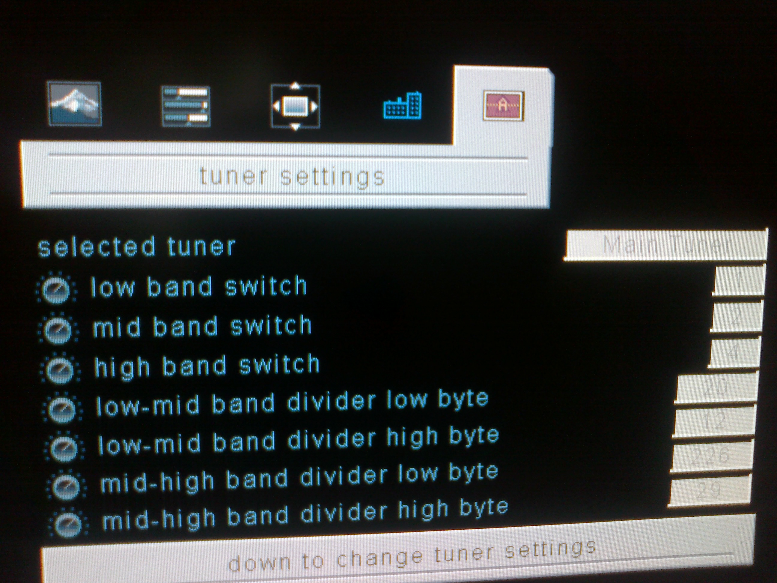

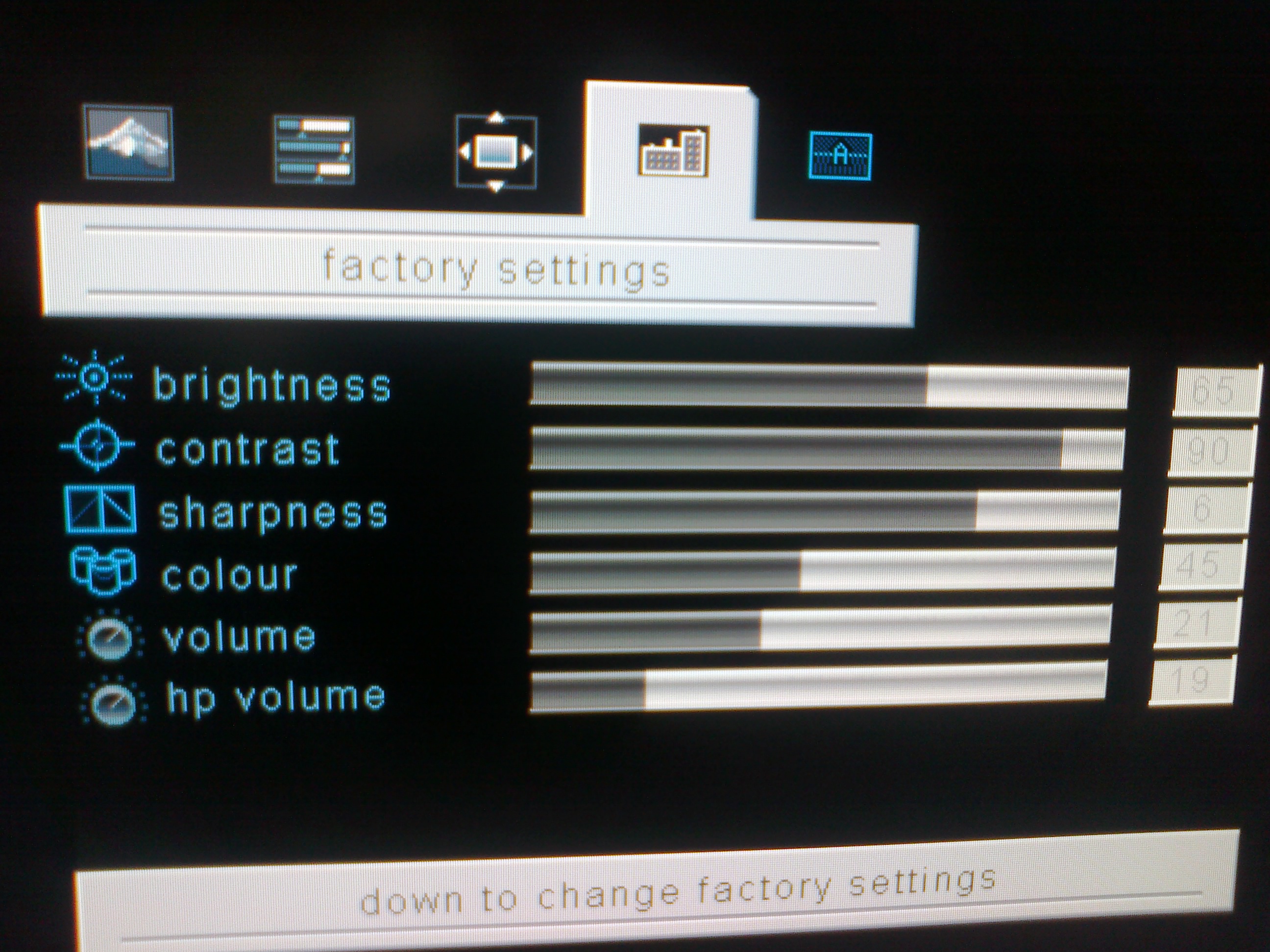

                      Please, i am sorry for the delay, it was due to power outage. I had to borrow a generator as mine is faulty. I have done as you instructed and i have attached the picture. Thanks for your help.
                        OK, what is under the other menus (use left-right I think to select the menus -- the icons at the top.) A picture of each would be helpful. Sorry to hear about the black out. Are they very common? I have a friend in South Africa who gets them every day :/.
                          Here there are Tom66. Thanks a lot. As for black outs, it's natural in Nigeria, we experience it very often. sometimes, ten times a day.

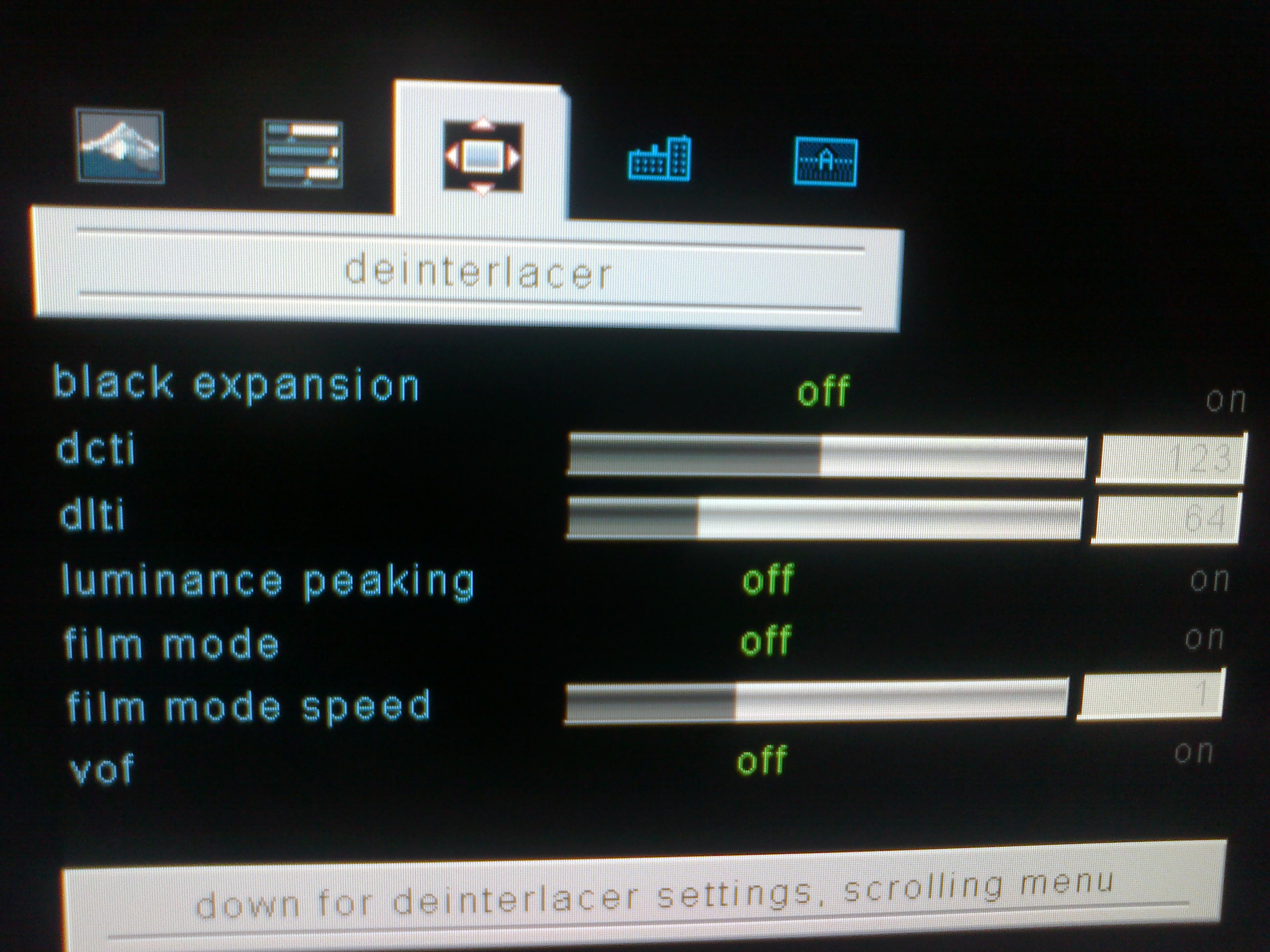

                            If you use the down arrow on this menu:
                            https://www.badcaps.net/forum/attach...6&d=1364055075
                            are any other options available?
                            I'm looking for a "factory reset" option, if one is available.
                            If not, we will have to look at the EEPROM on the board.
                            Worst case, look up prices for 17MB11-6 main boards. You may have to order them from Europe. There's plentiful supply here, so the price is generally quite low, but I don't know if they will ship to Nigeria....
                              I have scrolled down with the down arrow but there are no other options. Do we now look at the EEPROM on the board?
                                  I wouldn't think the second test is necessary, after all the user is getting an OSD (menus etc.)

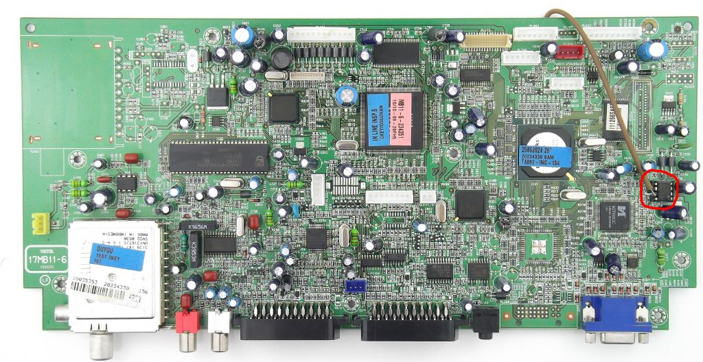

                                  Regarding the EEPROM, I think it is this device, can you confirm the marking printed on it?
                                  Also I am thinking that "initial aps" may be worth considering.
                                      Yes! i can see it. how did you get that board? I thought it is not common. What do you mean by "initial aps"?
