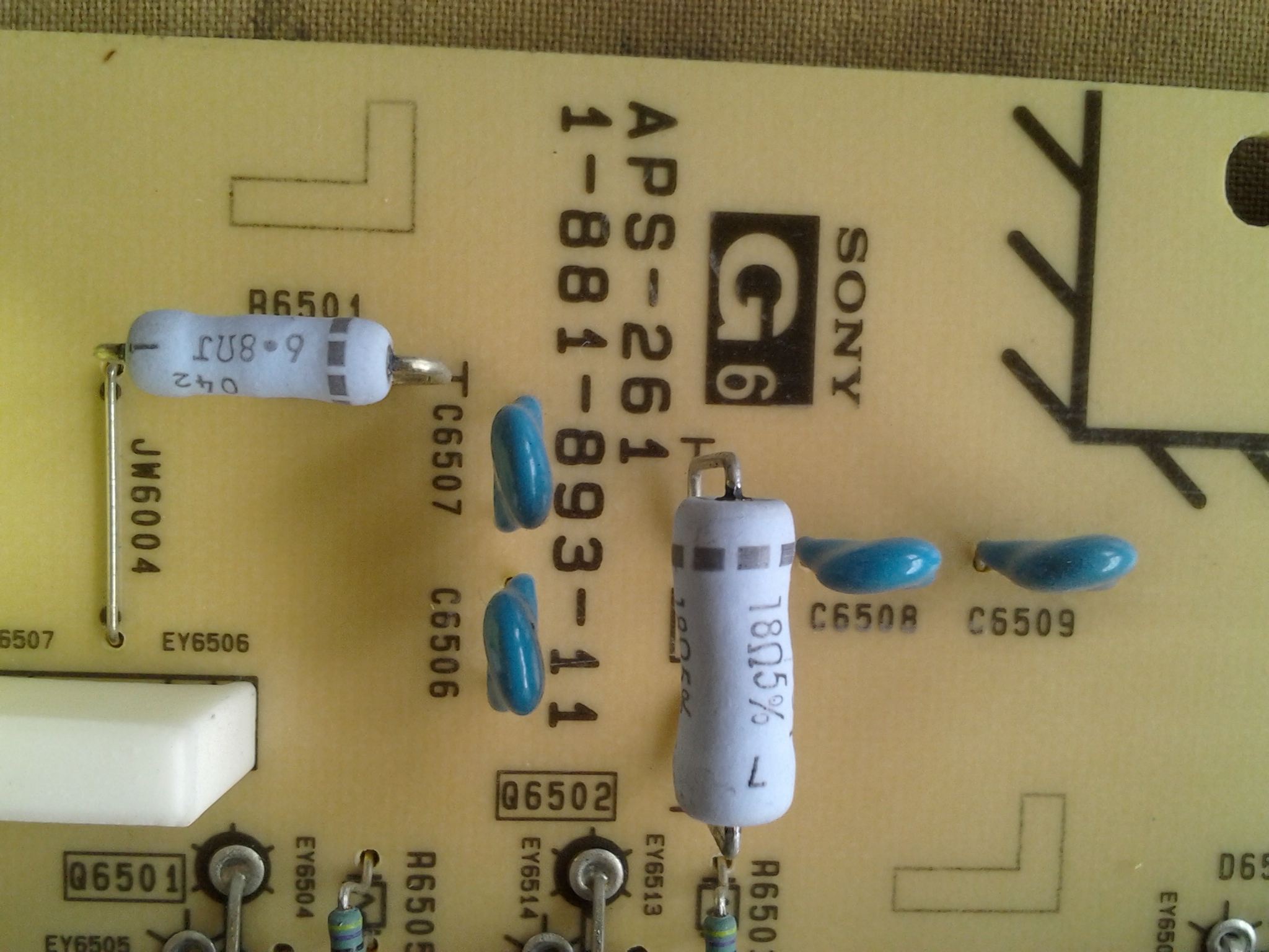

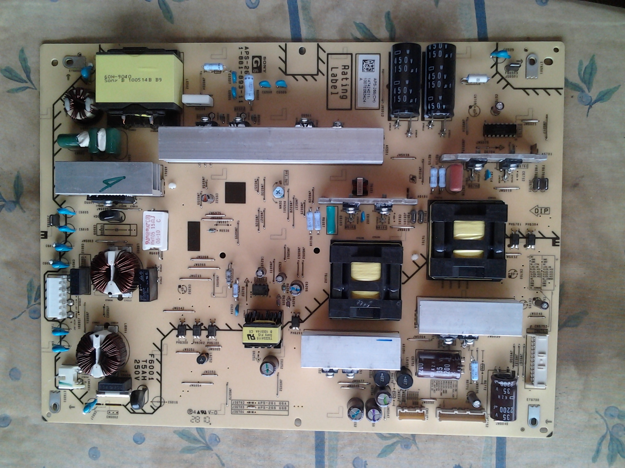

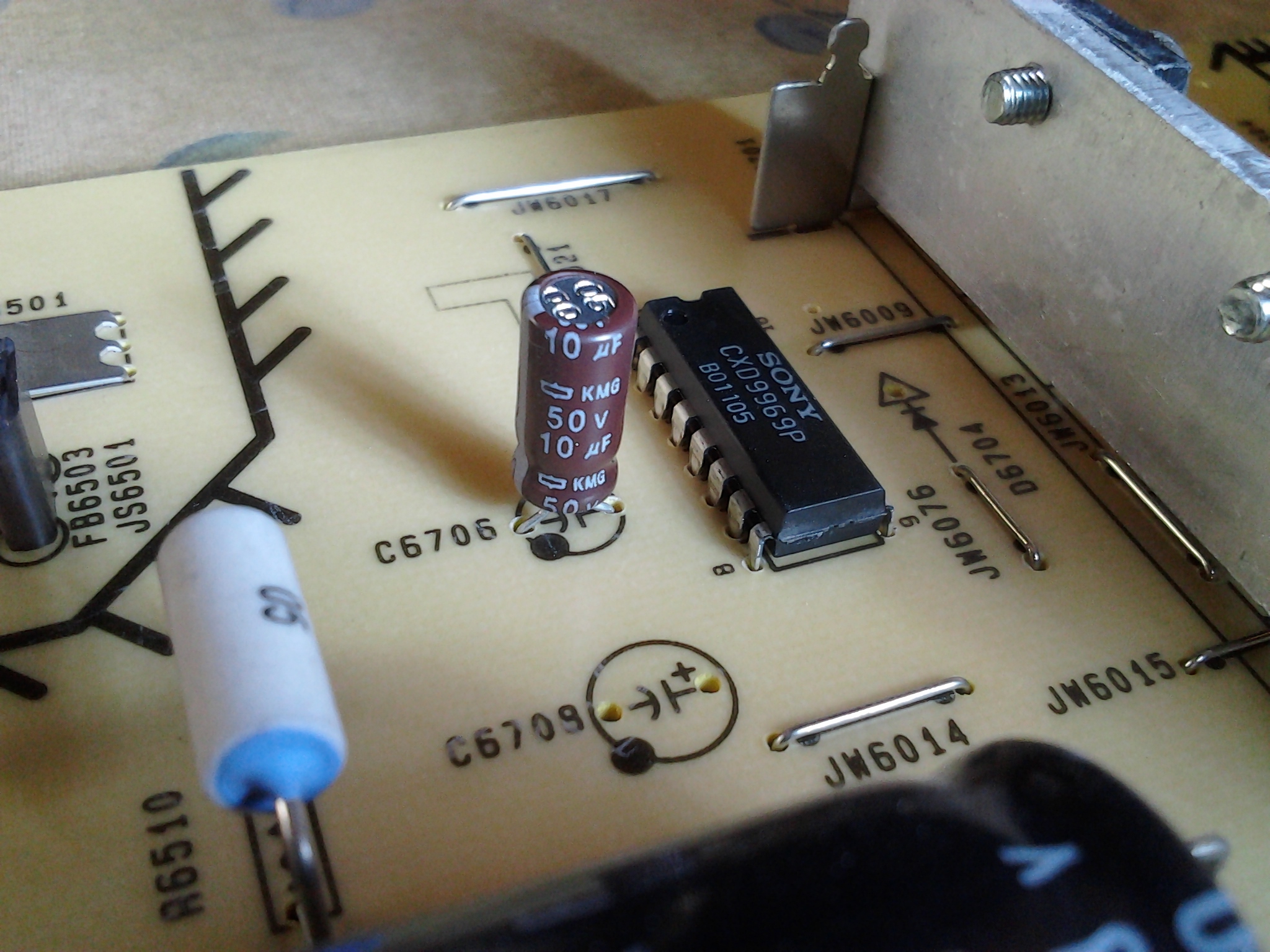

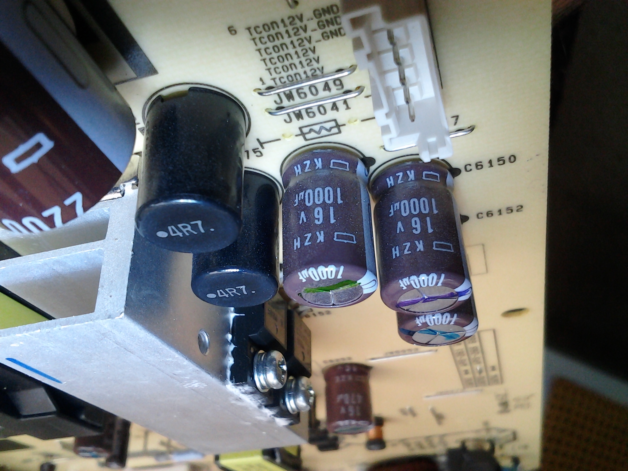

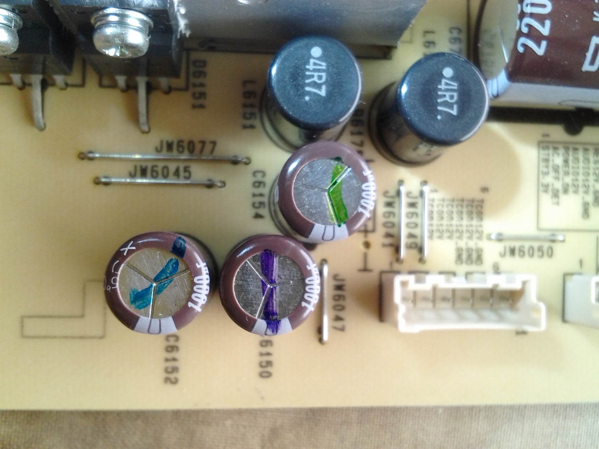

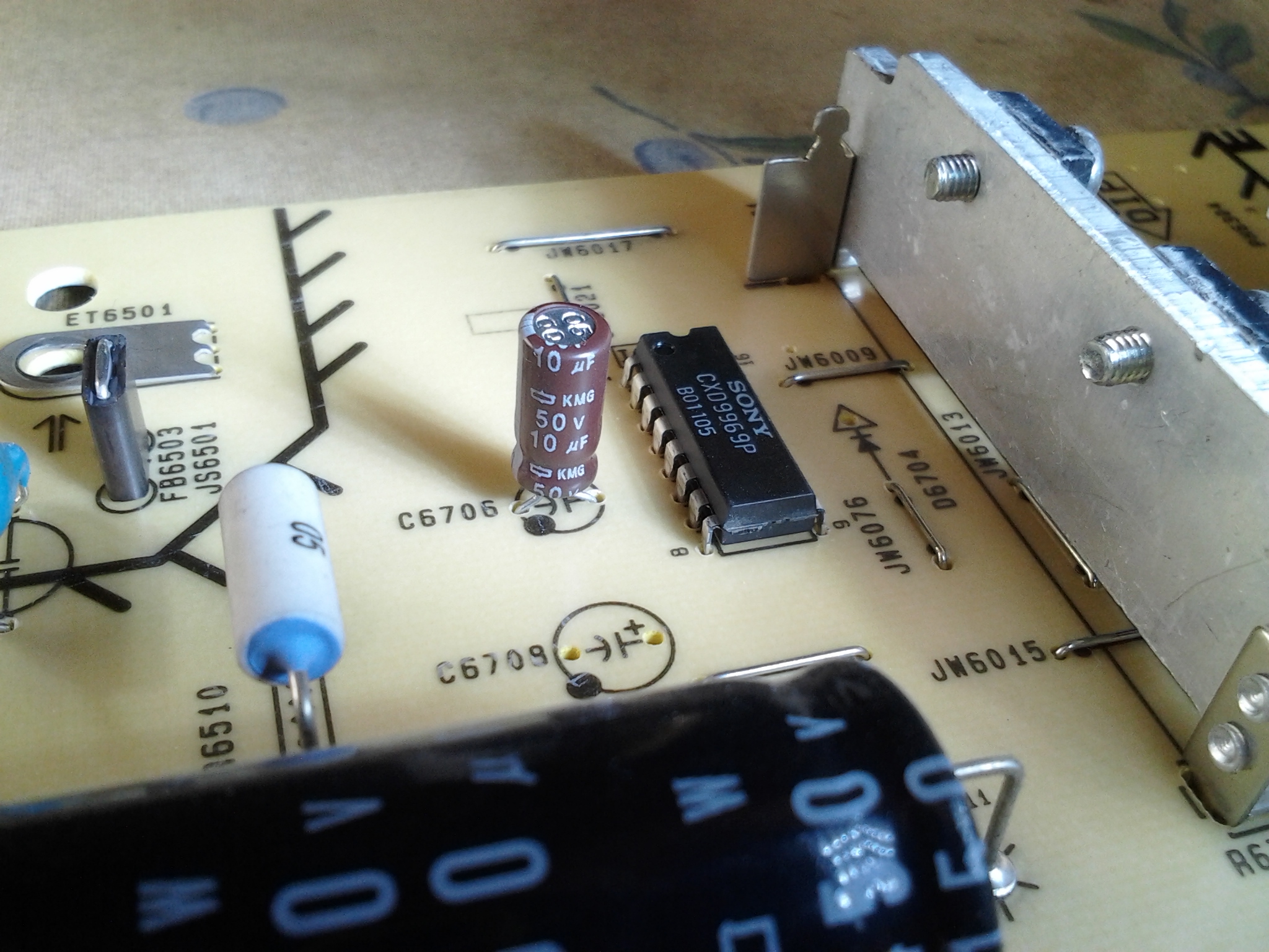

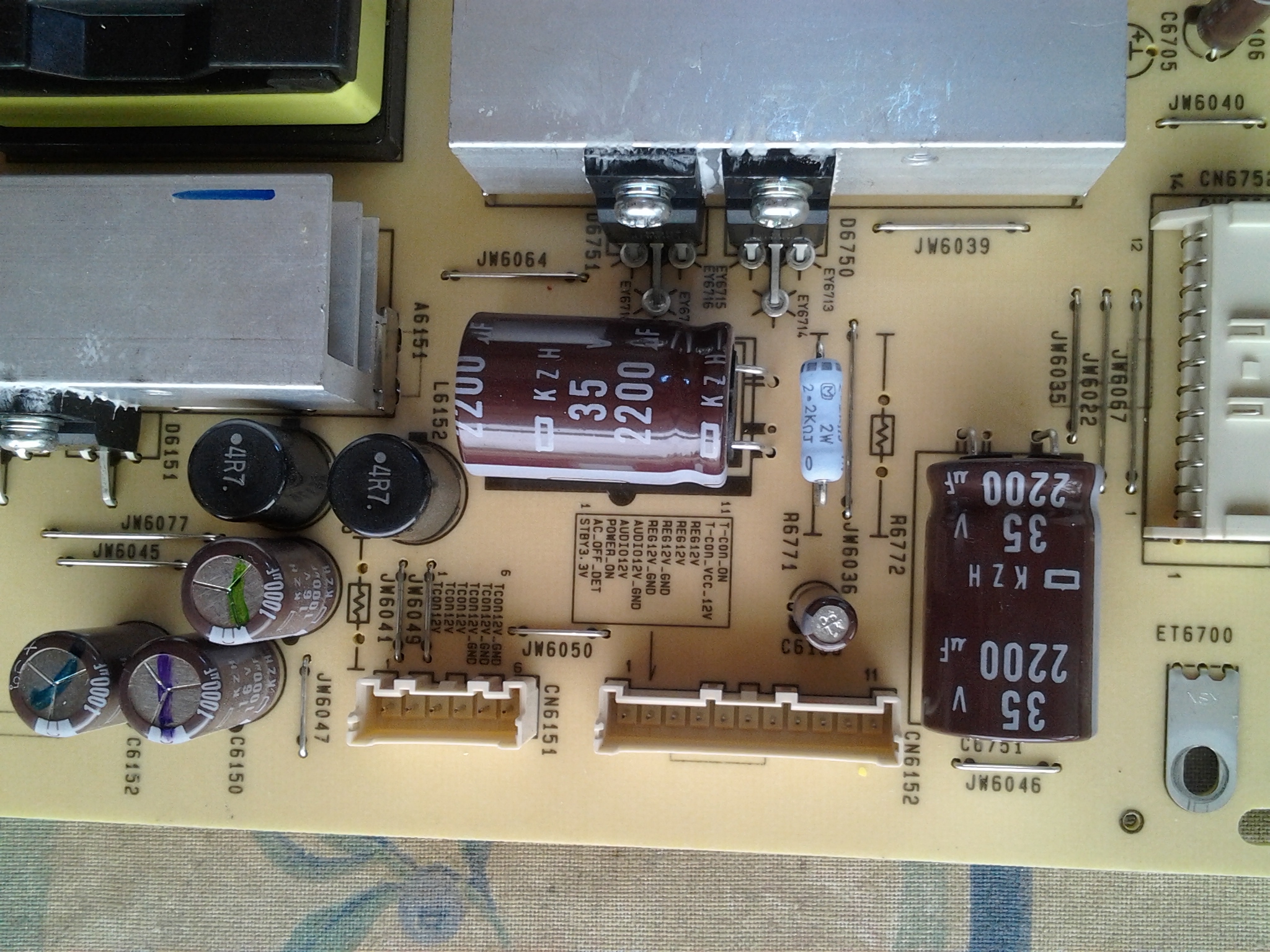

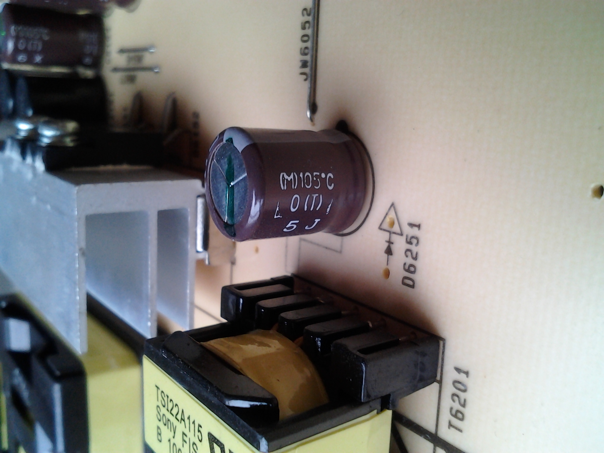

    My TV works greet, but recently has developed an intermittent problem. When I go to turn on, light goes from red to green, hear a click, then lights red, 3 blinks.
    I've tried resetting when it has the problem doesn't help. If I unplug and wait awhile, most of the time will do the same, but after about 20 tries (and a few days of praying/cussing), it will fire back up normally showing the Sony logo and the red button staying on. When this happens TV comes on as usual.
    So now, when I get it on, I just leave it on.
    I suspect bad caps. But I have looked at the board twice, and see no signs of any bad caps. (no bulging or leaking). I have read that they can go bad without showing, or I guess they may be getting ready to bulge.
    I read through 18 pages of Sony issues here, and don't see any similar problems. I have limited electronics experience. Have a cheap multi-meter, and have fixed a couple of TVs and monitors by replacing caps. I've planned on ordering all the caps and replacing them.
    What do you guys think?
    I'm attaching some photos.

    I doubt the caps are at fault if they don't seem bulged at all. In small cases it is possible they may be bad but its more likely their not and sometimes its just a waste of time to check them all and find out theyre all good (which is always usually what happens).
    If its intermittent it could be a cold solder joint somewhere? Even on the main board.

          I would suggest a thermal issue: something is temperature intermittent.
          Try waiting a day then seeing if from cold the TV will turn on. If not, get a hairdryer or other heating appliance and heat up parts of the TV. Then see if it turns on.

                Re: Sony KDL46HX800 Sometimes wont power on 3 blinks
                Focus on the power board and the main board for now.
