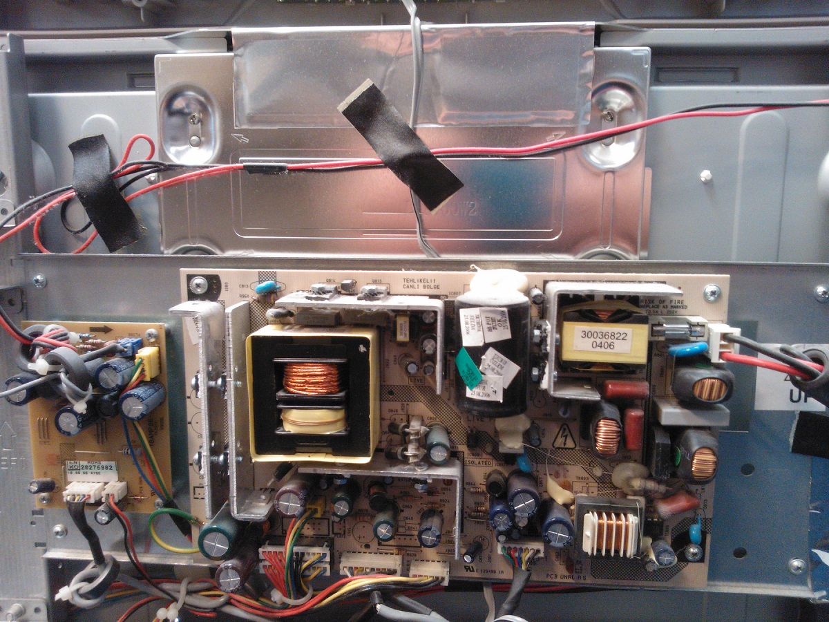

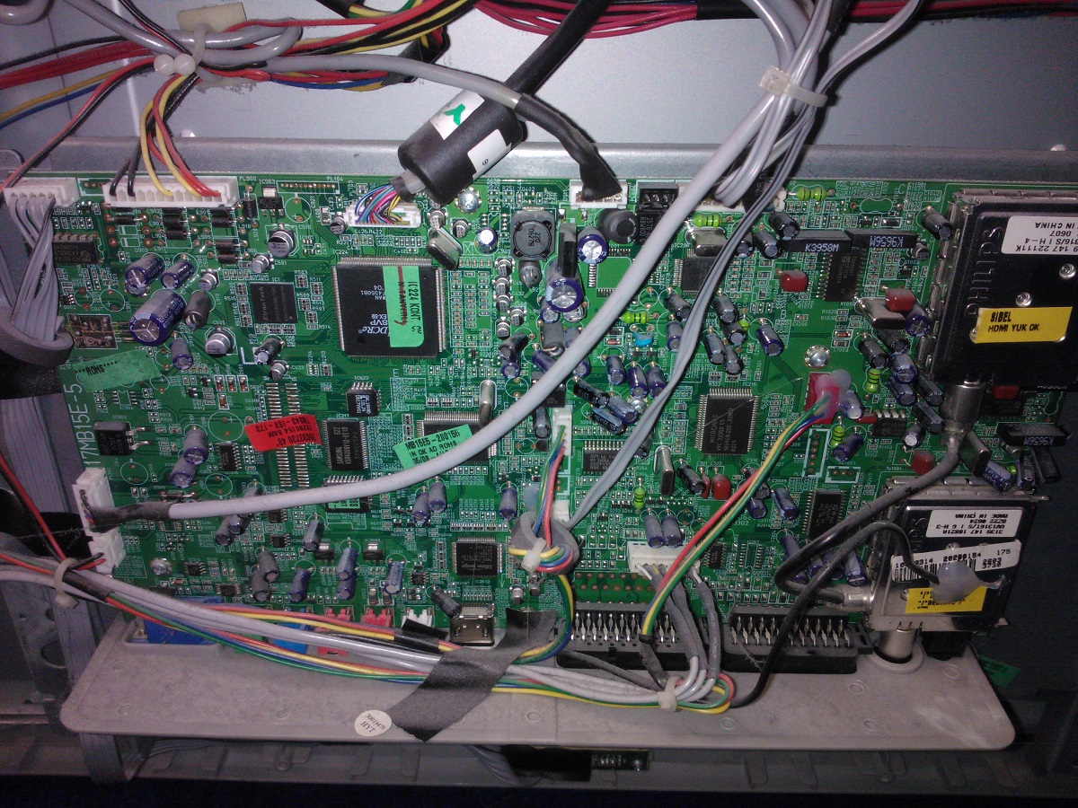

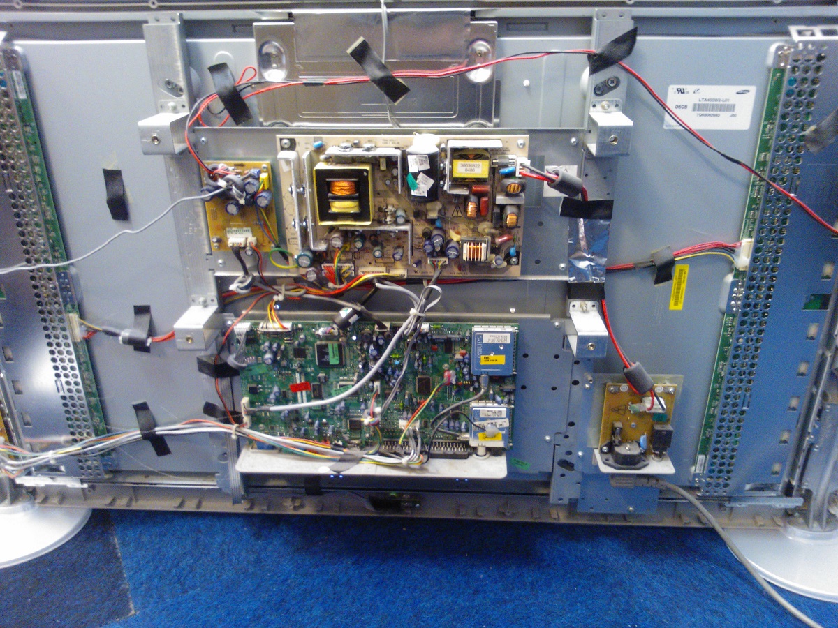

    Yet another Vestel TV problem.
    This is made under the brand "Andersson" and problem is no picture is shown. Sound is working OK.
    Backlight turns on, the obvious PSU outputs OK (+24V, +5V, +3.3V)
    But there are no image at all.
    A brief check of the onboard voltage regulators on mainboard revealed nothing abnormal. Picture processing IC's normal heat during operation.
    Could this be a T-CON failure?
    Please check the attached pictures.

    Probably not the issue but is that a bulged cap I see near the connectors?
    Also, could you upload a shot of the t-con?

        Re: Andersson "Vestel" LCD no picture
        Bottom of the power board. There are connectors, from the left over three connectors and up there are two capacitors, the one on the left looks like a bulged cap.
          Yeah, you're right. It sure looks bulged. I thought I was carefully check the caps on the psu board, but still missed one of them.
          Will check if this might solve the problem. Still, the output voltages are correct from the psu.

                    Got a picture of the T-con?
                                  Bad luck, found a blown SMD fuse on logic board. Changed this, but then screen goes white, so obviously this T-con is bad...
                                  The left part of the screen is all white and the right part is like bright gray.
                                      As Garry stated so clearly there was a bulged cap on the powersupply. I was so focused on the T-con so I actually forgot to replace that
                                      When it's replaced, the set is back in life again!
                                      Guess the excessive supply ripple killed the T-con fuse.
