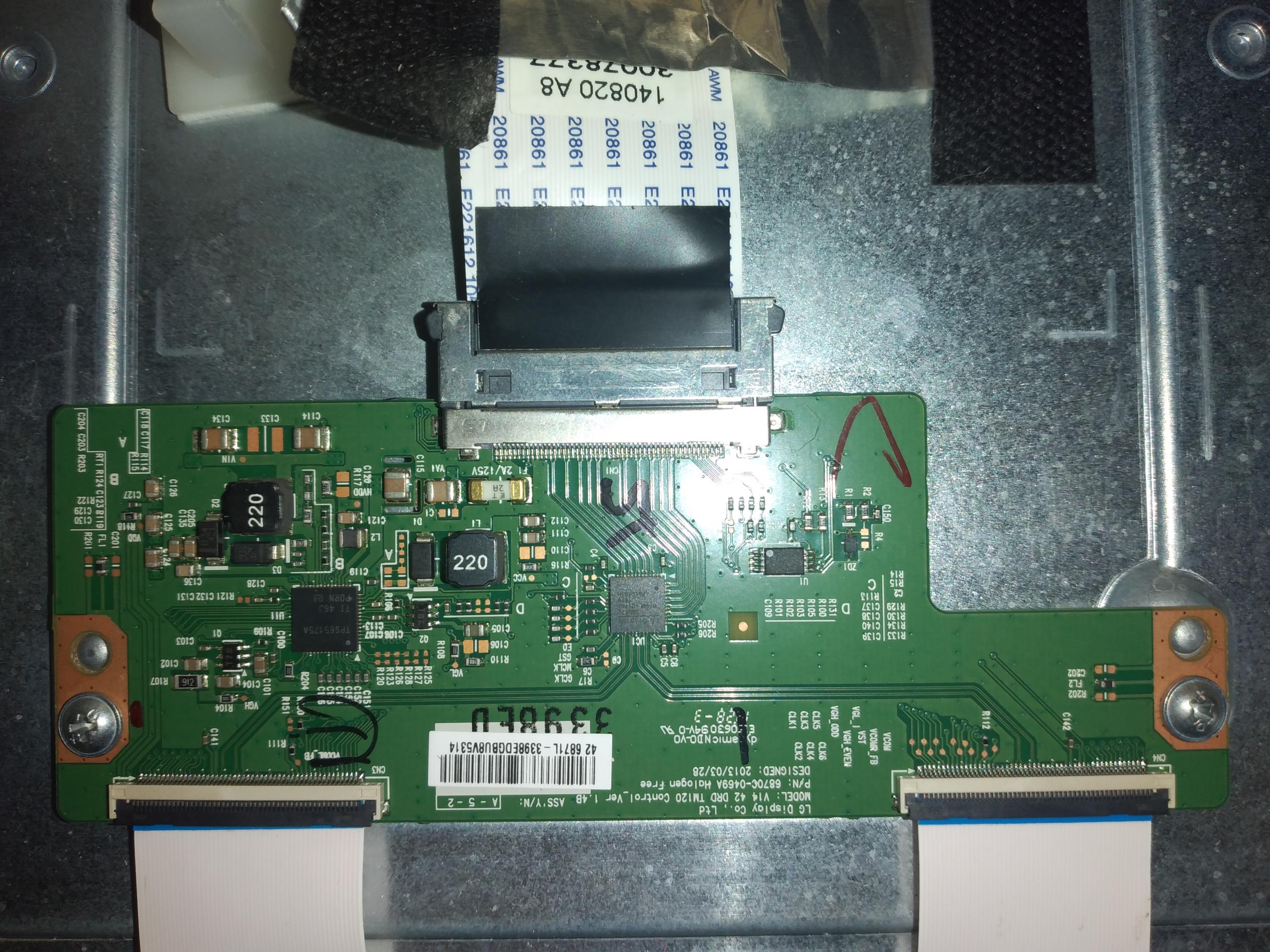

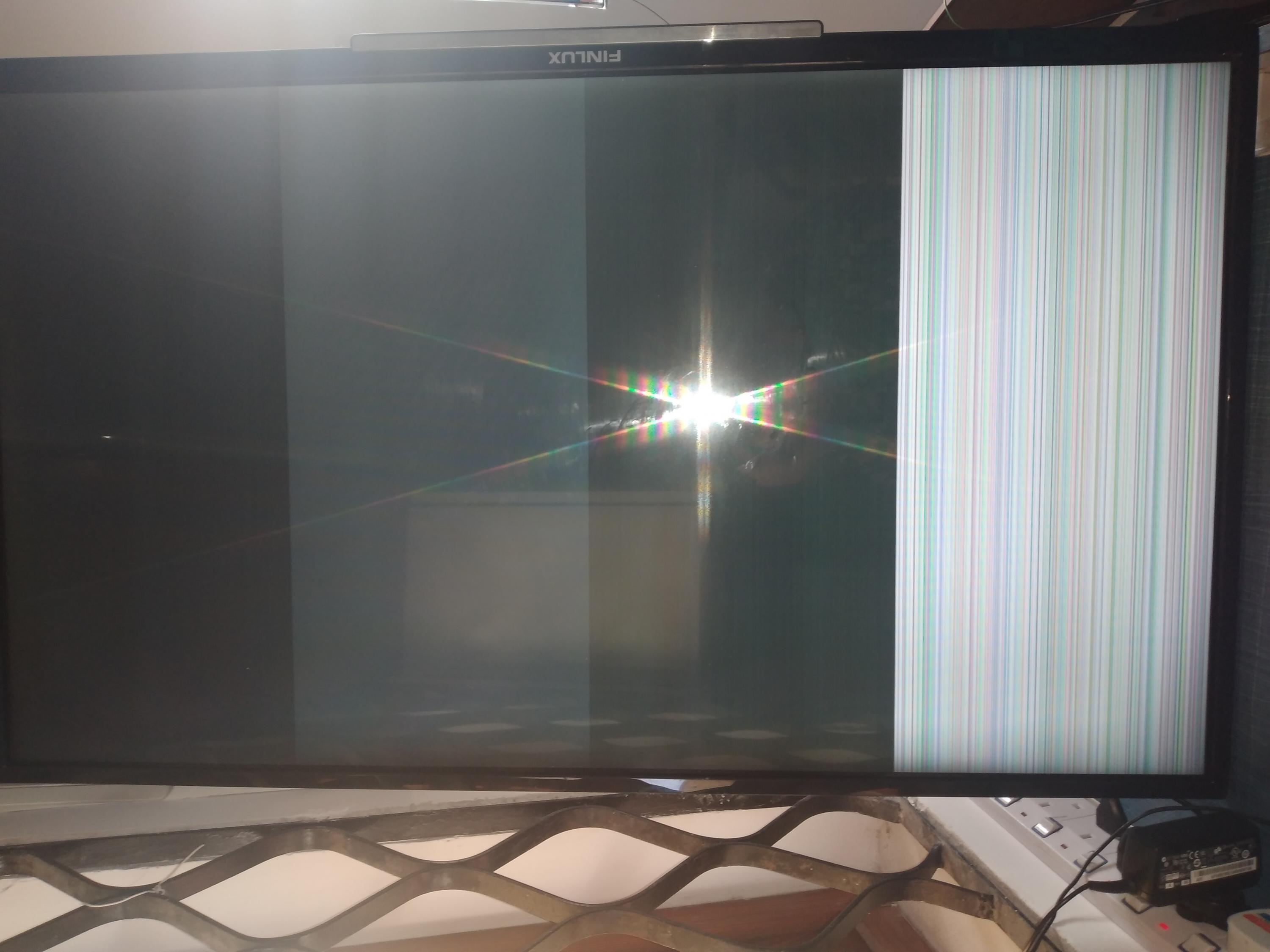

    I have a Finlux/Vestel Led Tv with the following fault and cannot reason from where the fault is. Fault is:
    Sound ok, Backlight ok, Picture nothing but colour vertical lines. power supply vestel 17 IPS 71, main board 17MB82S
    Checked 12V on tcon on fuse ok.
    Checked 12v and 24v on power supply ok.
    Volume works. removed l left ribbon cable no picture white on half, and same with right one.
    Any idea from where I can start please?
    Any help appreciated please.

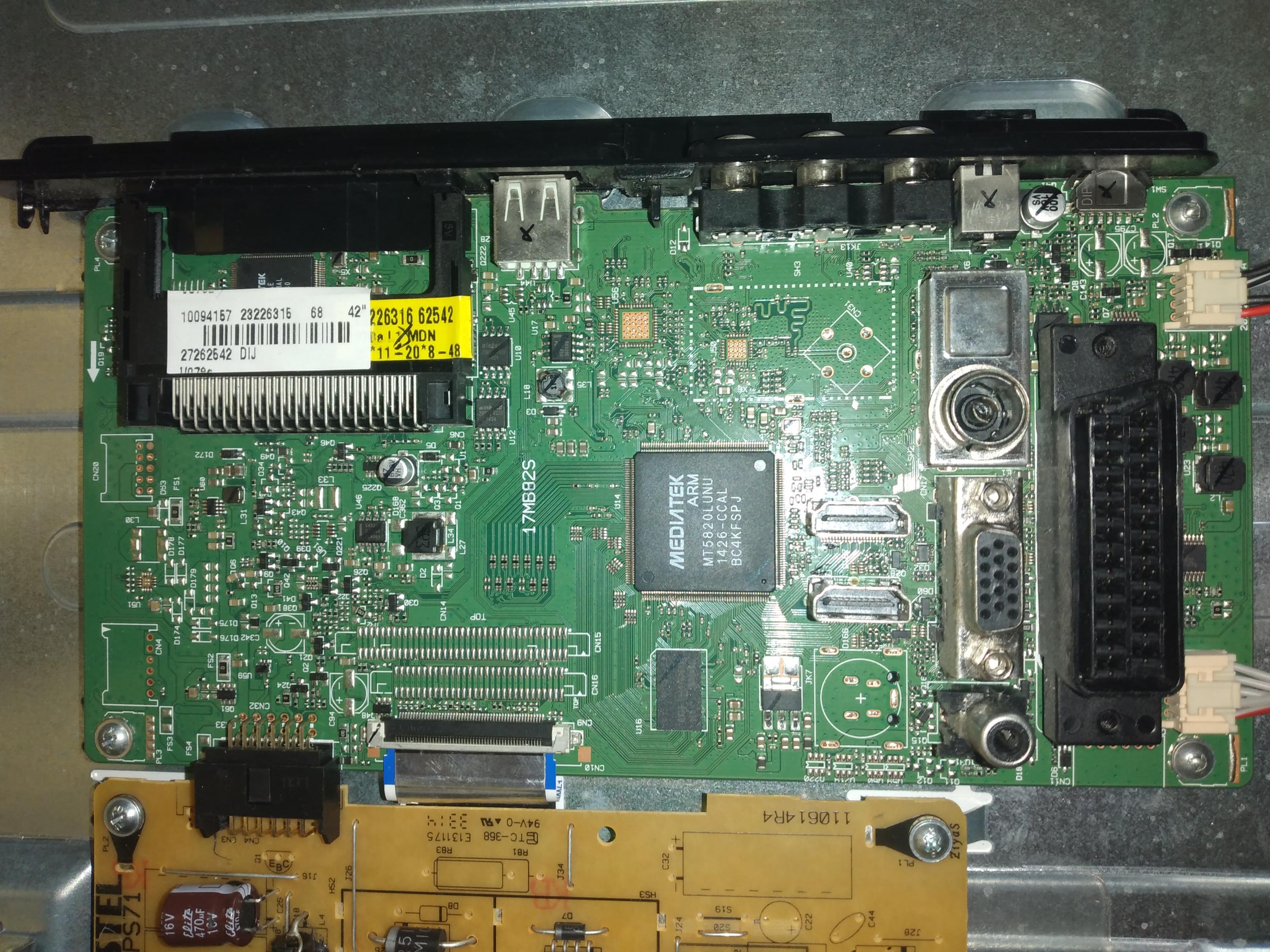

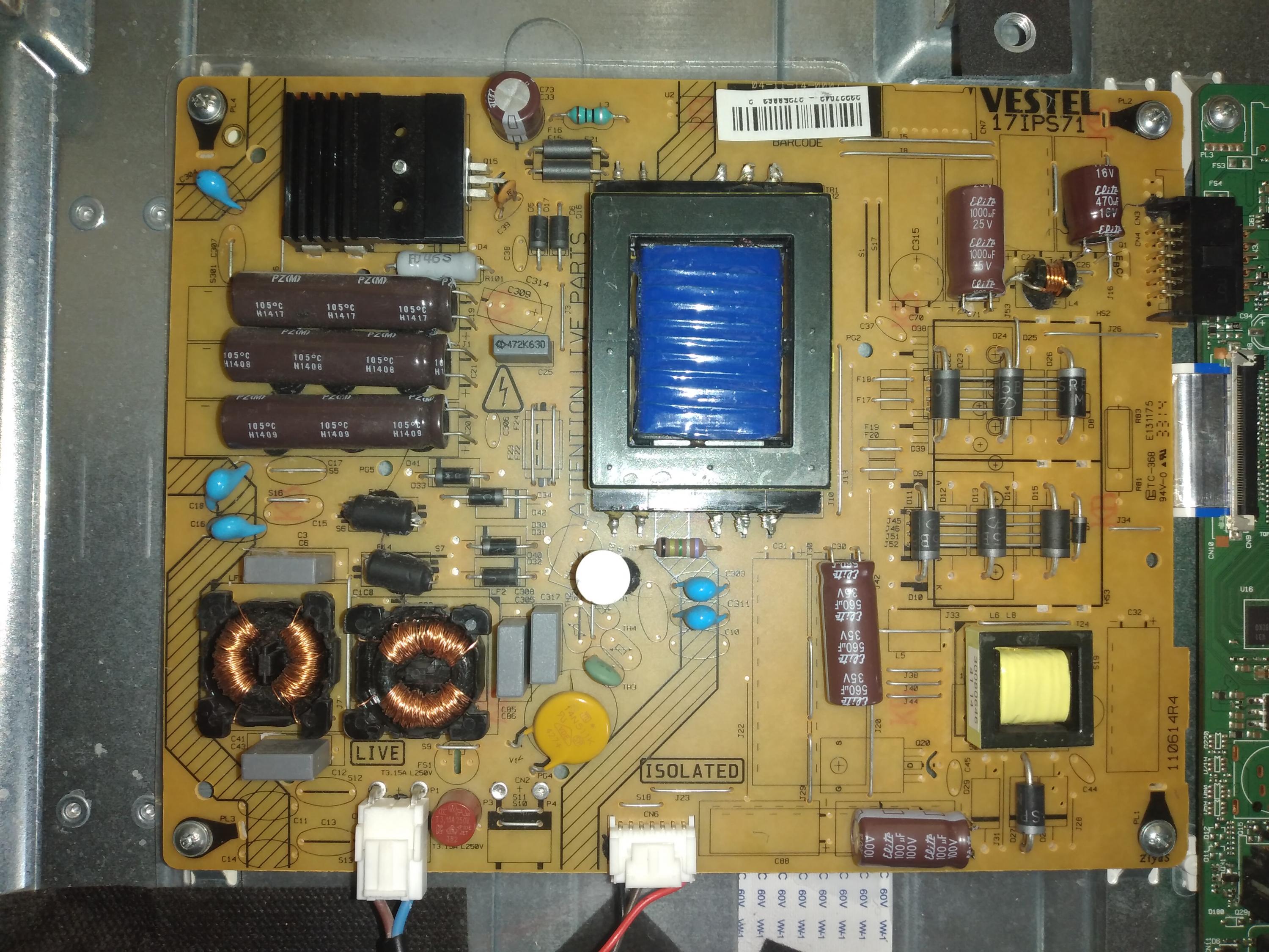

    Re: Vestel 42 inch VES420UNDL no picture, backlight ok, sound ok
    About the photo take, please note that that is the flash not a broken display. Also volume works as sound not on scrren display.
    24v measured on a capacitor on the secondary of the power supply.
    Photo is taken with both tcon ribbon cables connected.
    Also please find a photo of all the boards on this TV.
      Doubt if this is your problem but need to check connector between power and main board for cracked solder joints. Then you need to take some voltage checks on t-con. Lower right corner for starts.
        Hi. thanks for your reply. Willcheck the solder joints between the main board and power supply. Will also measure the voltages at the test points on the right and come back with the readings.
          Ok. Here are the voltages from the t-con right test points:
          VCOM 6.4V
          VCOMR_FB 6.4V
          VST -4.8V
          VGL_1 -4.8V
          VGH_EVEN 27.5V
          VGH_ODD 27.5V
          CLK1-CLK6 ALL 5.6V
          Do you see anthing wrong or abnormal in these voltages please?
            Measured more voltages on Tcon
            VCC 4.3V
            VGL -4.8V
            VGH 27.6V
            VCOML_FB 6.4V
            VA1 12V
            HVDD 8.3V
            VIN 12V
            VDD 16.7V
            Are these normal please?
                Originally posted by freccia
                I am stuck on this. Any help would be greatly appreciated please.
                yours photo.. if you press menu or change source signal did you see some effect on those lines and color ?

                  VDD 16.7V
                  These look OK.
                    If I connect a dvd player on scart, I can hear the sound, but picture remains the same, no menus or volume is shown on screen. Volume loudness works though, just not showing on the screen.
                      VCOM 6.4V
                      VCOMR_FB 6.4V
                      VST -4.8V
                      VGL_1 -4.8V
                      VGH_EVEN 27.5V
                      VGH_ODD 27.5V
                      CLK1-CLK6 ALL 5.6V
                      @DSKALL, do these other readings seem right to you?
                      Do you think that t-con is good?
                      I have no other boards to test with.
                        I would say they are all OK. Try partially removing cable to t-con and moving it around to see if you get any picture. You may have bad cable or connection between main and t-con.
                            One of the first and least expensive things you can do when you have an issue is take the powerboard out of the tv, flip it over and look the solder joints over with a magnifying glass if needed, add a little flux to make the solder flow well and add solder to any joints that look even a little suspect. You can practice on a scrap pcb board if needed, careful not to bridge any joints, and always let the board sit for quite a while or discharge the big caps with an appropriate resister before working on it (safety first) to try to keep from getting shocked, it doesn't take 1000 volts to KILL, a lot less can kill, so be careful, it's only a tv.
                              Thanks for your message. I have checked for dry joints on the power supply. I have ordered the ffc cable. It will take a while to arrive. Will replace it and let you know if it is from that cable. All voltages look ok, at least from my previous posts, it may also be the tcon but voltages look ok in the exit side, maybe it has an issue when connecting to the main board, no osd though. Will let you know when the part arrives, seller posted it today, THanks
