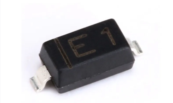

    I'm looking at a JVC LT-39c790 - a vestel based unit.
    So, the remote turns it on, led's light up but no picture at all.
    I have a spare mainboard, so I know its not that. The PSU seems ok too.
    On the AUO T-Con I've got 16v on HAVDD_H but nothing on HAVDD_L - which I'm assuming should also be 16v ?
    So, Ive resorted to testing eveything I can on the board as I can't find any schemas for it (AUO 39T15 C04 Ctrl Bd) and I think I've found a diode gone short. it marked D005 on the board and E1 on the package but I've no clue as to whether this is a standard diode or a zener etc.

    Regarding the diode maybe remove it or lift one side and re test it for a short.

      E1 - MMSZ5231B (Zener diode at 5.1v)

        Thanks for the responses. Although I think Ive been "off the tools" too long. It wasn't the diode, I forgot to unplug the logic board before testing !
