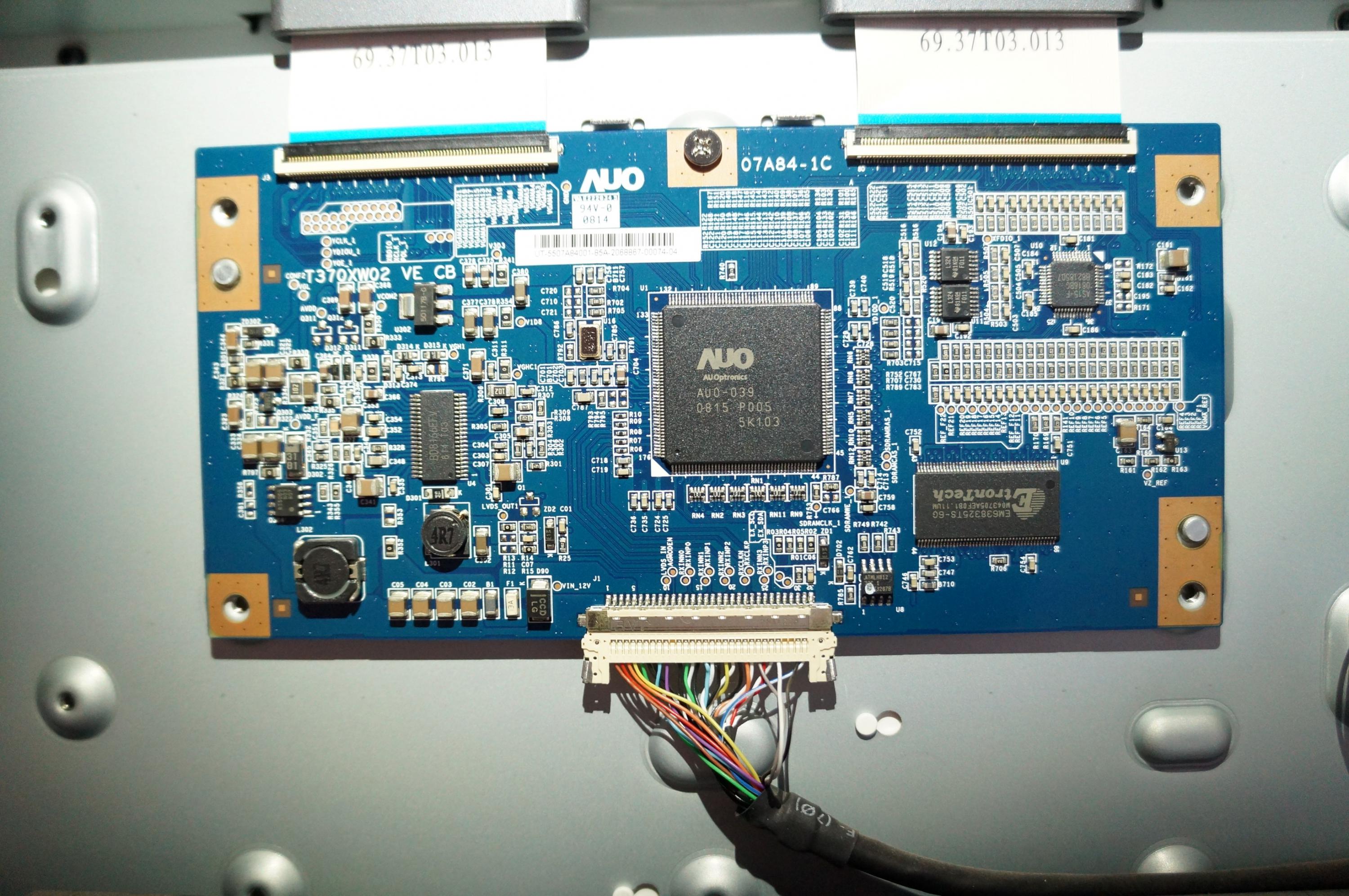

    It has solarized picutres like this one:
    https://www.badcaps.net/forum/showth...ng+LN37A550P3F
    See of it uses AUOPTO LCD panel.
    Voltage checking will tell you as Tom has suggested.

      Re: Sony Bravia KLV-32-400A - negative picture with white haze
      Hello budm!
      It really seems to be the same problem! I'm going to try to test the voltages.

        I took some measurements of my T-CON board Voltages :
        VGMA1: 15.42
        VGMA2: 15.19
        VGMA3: 12.77
        VGMA4: 11.74
        VGMA5: 10.98
        VGMA6: 10.42
        VGMA7: 10.05
        VGMA8: 9.77
        VGMA9: 9.61
        VGMA10: 14.78
        VGMA11: 7.35
        VGMA12: 6.93
        VGMA13: 14.5
        VGMA14: 5.21
        VGMA15: 6.73
        VGMA16: 4.48
        VGMA17: 3.91
        VGMA18: 3.63
        VGMA19: 3.16
        VGMA20: 2.43
        VGMA21: 0.39
        VGMA22: 0.28
        VCOM2: 6.33
        CONF2: 6.28
        VGL: -6
        AVDD: 16.04
        VIN_12V: 12.05
        V3D3: 3.30
        V1D8: 1.79
        VGHC1: 25.8
        LVDS_OUT1: 3.29
        AVDD_F: 16.06
        With this information it is possible to see anything wrong ? I attached a picture of the board too.
        Thank you!

          #44
          So yep, another gamma fault right there. You can see that spike in the middle causing a world of hurt. You should replace the t-con or the gamma chip, replacing the gamma chip will require good SMD soldering skills.
          So that's quite a few this week, amazing how many are failing.

            My Sony Bravia KDL-40Z4100 failed a few weeks ago with this same problem. I replaced the AS15G this past weekend and it solved the problem. My set was manufactured in July of 2008 and the failed AS15 had a 2008 date code, the same as the one in guilhermemt's TCON photo.
            It would be interesting to know how many of the AS15 chips that are failing now were manufactured in 2008.
              The chip that you replaced is the one on the top-right of the board ? (AS15-F)
              Thank you!

                Yes the AS15-F chip at the top-right of the board is the same one that failed on my board. The voltage readings on my TCON board were very similar to yours.
                My board had an AS15-G chip which is functionally equivalent to the AS15-F.
                Good luck with the repair. Let us know how it turns out.

                  Ok!
                  i will have to find someone to do it for me. After that I 'll tell you.
                  But, one more question: how do I know that the measurements/voltages that I took aren't fine ? Is there any place where I can find the correct patterns ?
                  Thank you all!

                                  Problem solved after replacement of AS15-G at Sony Bravia LCD KLV-37M400A !
                                  Thank you guys !
