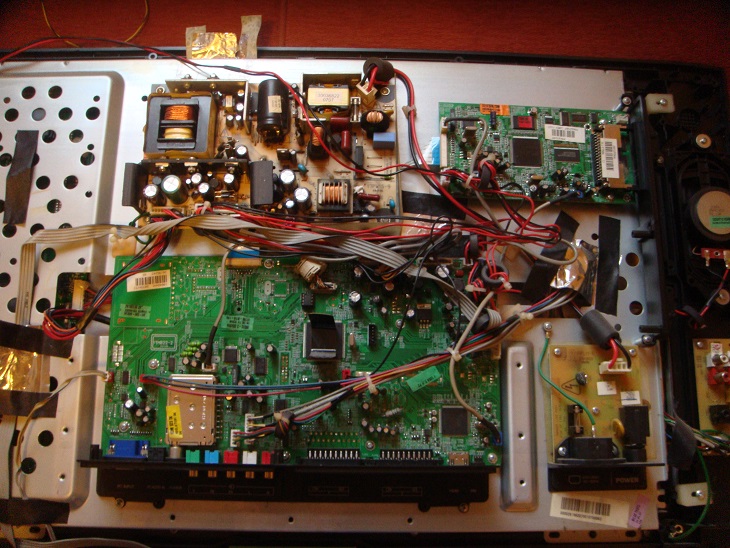

    Need some help with this, fault is tv powers on then 2 seconds to standby image is displayed for 2 seconds then led goes to red.
    good 24v to inverter, if I unplug supply to inverter set stays on, also tried plugging each of the tubes in one at a time each one flashes up ok for the 2 seconds but with only one tube connected it does not put the set into standby!

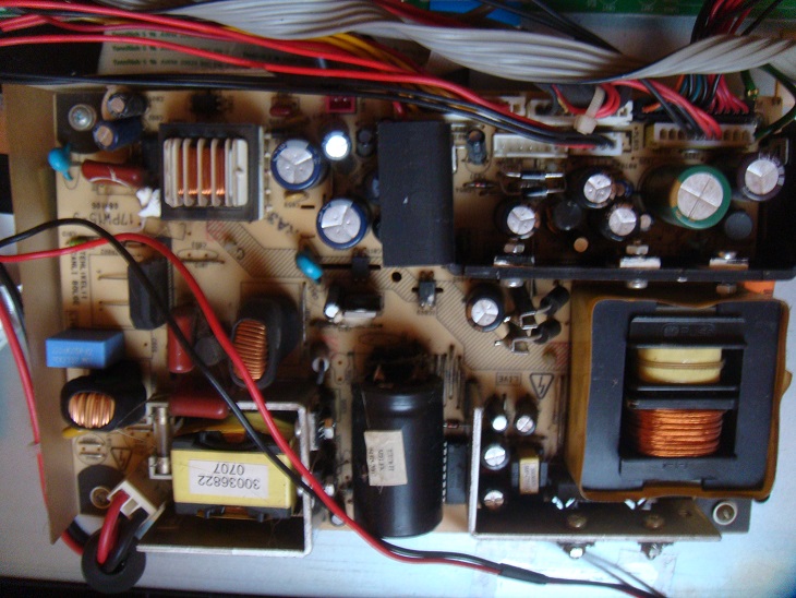

    The psu is vestel 17PW15-9 I know there are many kits for these boards but I'm not sure if the fault lies with the psu or inverter
    thanks Ronnie

        The two 15n/630V caps at top of PSU are bad.

          Hi Tom, that's what I was thinking but not sure the symptoms fitted, in the past with these psu's and those caps the sets were stuck in standby?
          cheers Ronnie
          sigpic
            Re: Goodmans LD266HD backlight issue
            If rails collapse they are usually the issue. Check the main board STBY signal for activity as well though.

              It will always come out of standy everytime and will stay on if no load on the 24v?
              sigpic
                That sounds a lot like bad 15n's to me.

                  cheers Tom will go for that, kit on ebay for a fiver will save ordering caps for now but probably need to think about having a supply to hand

                    Had same problem as you have on your tv. Must have been over two years ago. It did turn out to be those 15n caps. Had replaced many 15n caps on that psu,but didn't suspect them at all in this case. Wasted a lot of time, I remember that all right.I think it was from previous experience, that I thought 24v rail was ok.However when I finally checked those 15n caps, one was ok, the other slightly low. Much better condition than other caps I had replaced. I do know that the inverter shut down, but can't remember if power on voltage changed from .6v to 1.7v to put the set into standby.Have feeling 24v remained, why I thought psu was ok.
                    If your set same fault as mine, Tom has got it right again. Don't know how he does it. Had this set in front of me and took quite a while to find the problem.
                    I think my set was 32 inch. Ron.
