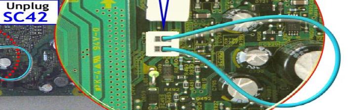

                            Re: Panasonic TC-P50G10, 7 & 6 blinks
                            Just another idea.
                            If you want to be 100% certain it's the SC board, i believe that this model has the factory test option at SC50 onthe SC board. It's a small 2pin socket which you short and power on the set with the SC connected, buffers disconnected. If the board is good then it should power on with no SOS at the front. If it still blinks, most likeley SOS6 then that confirms it as a bad SC. If no then the SC passed and the true fault is the SOS7 and bad buffer board/s.
                            It also mentions not to power on for more than 30secs.
                            It does mention SOS6 could also be SS but I'm thinking since you started SOS7 if it then went SOS6 with buffer disconnection and SC50 jumpered it would be SC.
                            As far as I know any buffer board disconnected be it one or two will cause SOS7 with out that jumper.

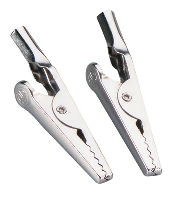

                              Im not sure I know how to short the 2 pin socket but I know it has one. Can you explain it better to someone who knows nothing about TV's! I'm honestly learning as I go so forgive me if I dont understand. I would like to test it though! I did however find an SC board for $69!!
                              • tw2005
                                • Oct 2011
                                • 6458
                                The 2 pins need to be shorted together or electrically connected to complete the circuit and create the bypass. Alligator cip, hard drive jumper connector may work. I have used both.
