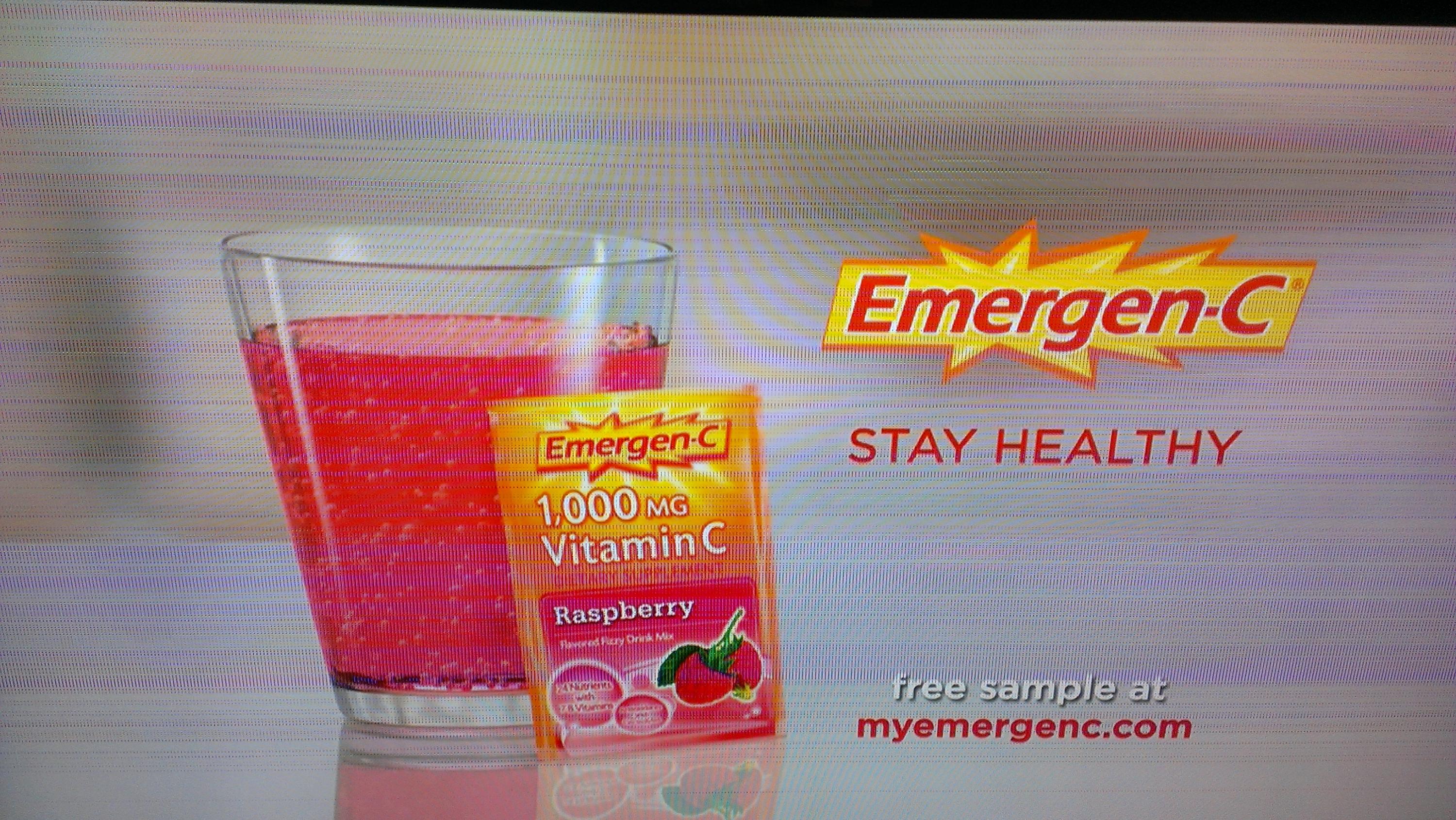

    Hi!!!! Im new here with a question about a 55'' vizio. This is whats going on when i turn it on after a sometime, i get horizontal color pin stripes threw the picture...then it clears up after sometime and The picture remains clear after that. So what do you think it could be... t-con board about to go up? Any help would be grateful.
    Re: Vizio vf550m picture ????
    Could you show us a picture of the defect?
      When it does it again i will take a picture.....tks.
        Ok here is a pic.
          Do you get the problem on any other inputs (hdmi, component...)? Does the problem affect the menu , if you open the menu while the error is happening?
            looks to me like the horizontal tab drivers are swaying.
            as said ,does it affect the menu?if it does it could be the panel fault
            try flexing the screen slightly if it alters the picture then that could confirm it
            if the menu isnt affected it could be the t-con board
            check voltage to t-con around 5v dc
            check voltages from psu outputs against there respective legends written on psu
            reseat lvds cable
            any signs of visable bloating or leakage from any capacitors?
              No problem with all other inputs except tv button a little. AV,COMP was good. HDMI 1 which i have hooked up is showing the problem when watching tv but i cycle threw the other 4 hdmi no problem, Menu looks fine. I have the back off all lights are lit board looked fine no bulging caps. When i twist the panel it doesn't clear up but it will go away after about a hour.
                  No had it on hdmi 2 yesterday than i tryed it on 1 last night.... does the same thing, It doesn`t remain like that it will go away after sometime. All options with the remote work fine. When tv is off orange vizio light, when on white vizio light.

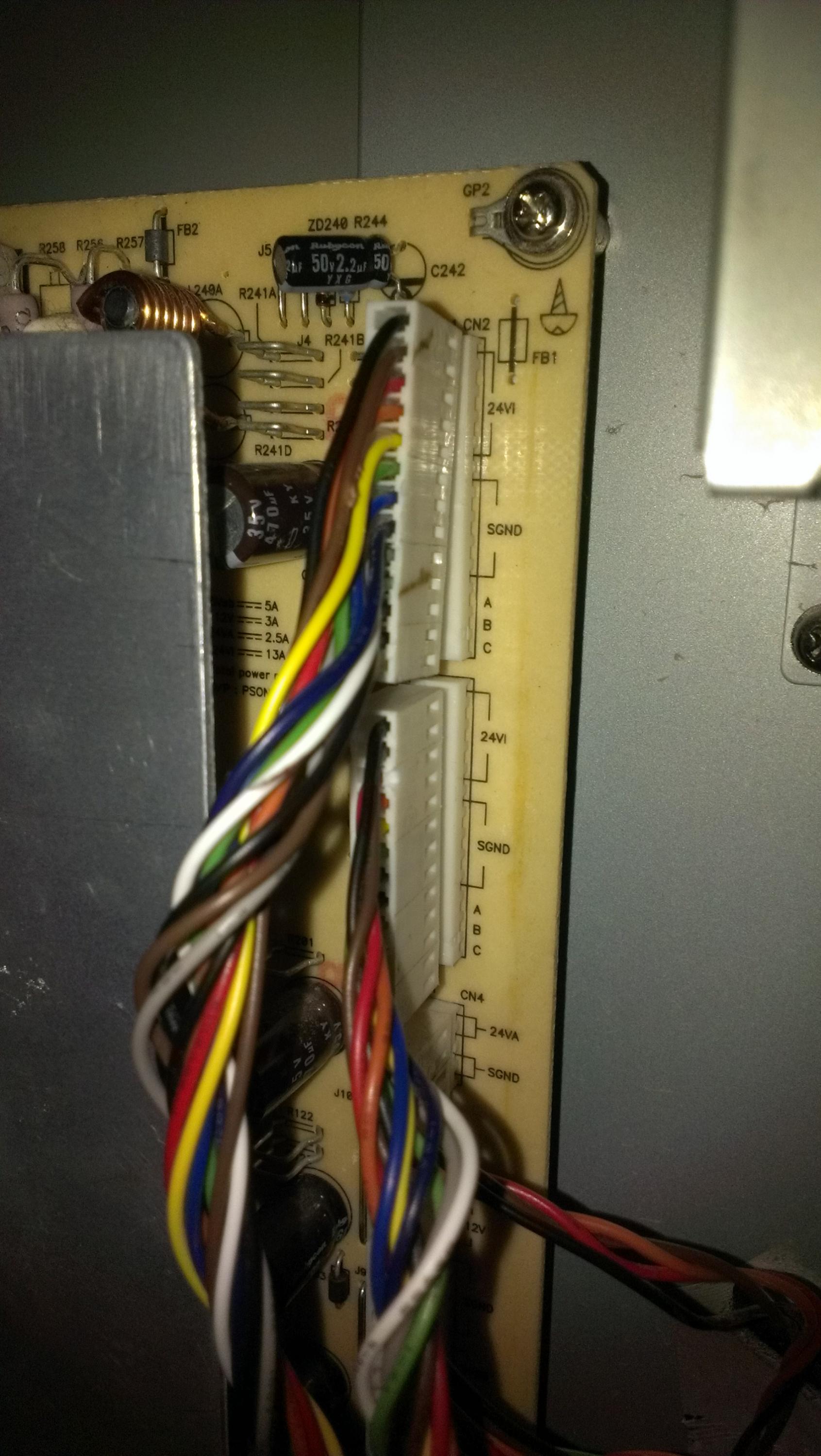

                              Originally posted by wileycat
                              No bulging caps on main board.
                              The top connector is going to the far left of tv and the next one is going the left near the main board. Or is suppose to be the other way around?
                                i mean right to the main board. Any help with my last pic is that wrong?
                                  Check all of the PSU outputs match their labels within about 5%.
                                    I have now way of testing the out puts but if i un plug the tv for a hour or more the lines will not come back for about 2 days. everthing else functions well, Do you think it can be a t-com board or the panel. The other day when the lines came up i swithed to another hdmi source which gave me the blue screen to see if the line showed up. They showed up following the signal up and down the screen thats it. I have directv so you know how the signal rotates all around the screen.....the lines follow that image thats it.
