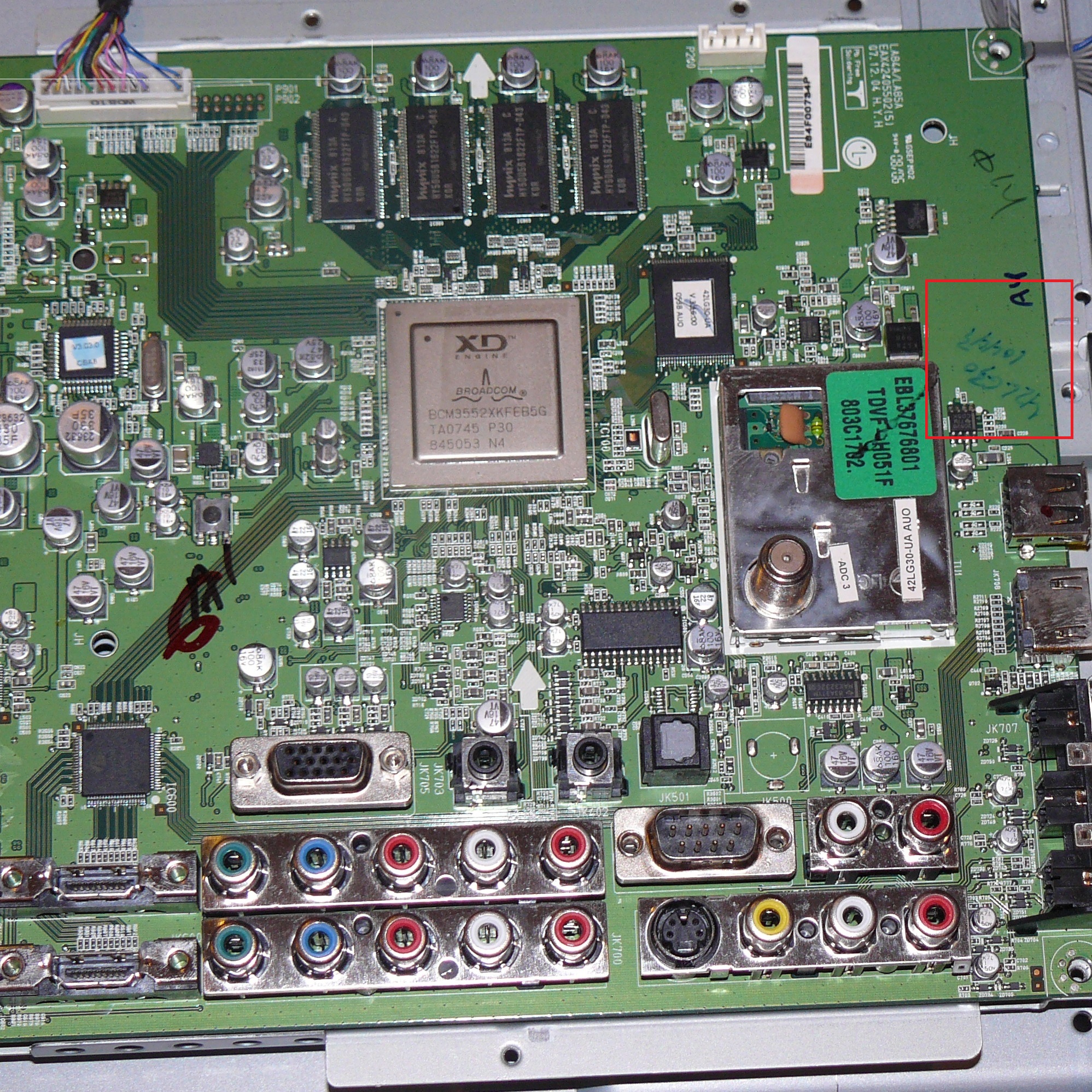

            Here is an update.
            I still can't change sources to see if audio is present whether with the RS232 cable or the OEM remote. I was looking at the main board wanting to throw it when i noticed something. There were a few markings made in ink over on the right side of the board. I've seen this type of writing on boards that mainly come from ebay or any tv chop shop. It made me wonder.........
            The main board that is in this tv right now is for a 42LG30.AUSTLJM.
            The Tv itself is a 42LG30.BUSTLJM.
            So it would appear the main board has been swapped for whatever reason and done with the wrong board. Now i've seen incompatible main boards do a negative image. Could it be a plausible explination for the washed out bars and no control over the keyboard except for the on/off which btw takes longer than one would expect to power on?

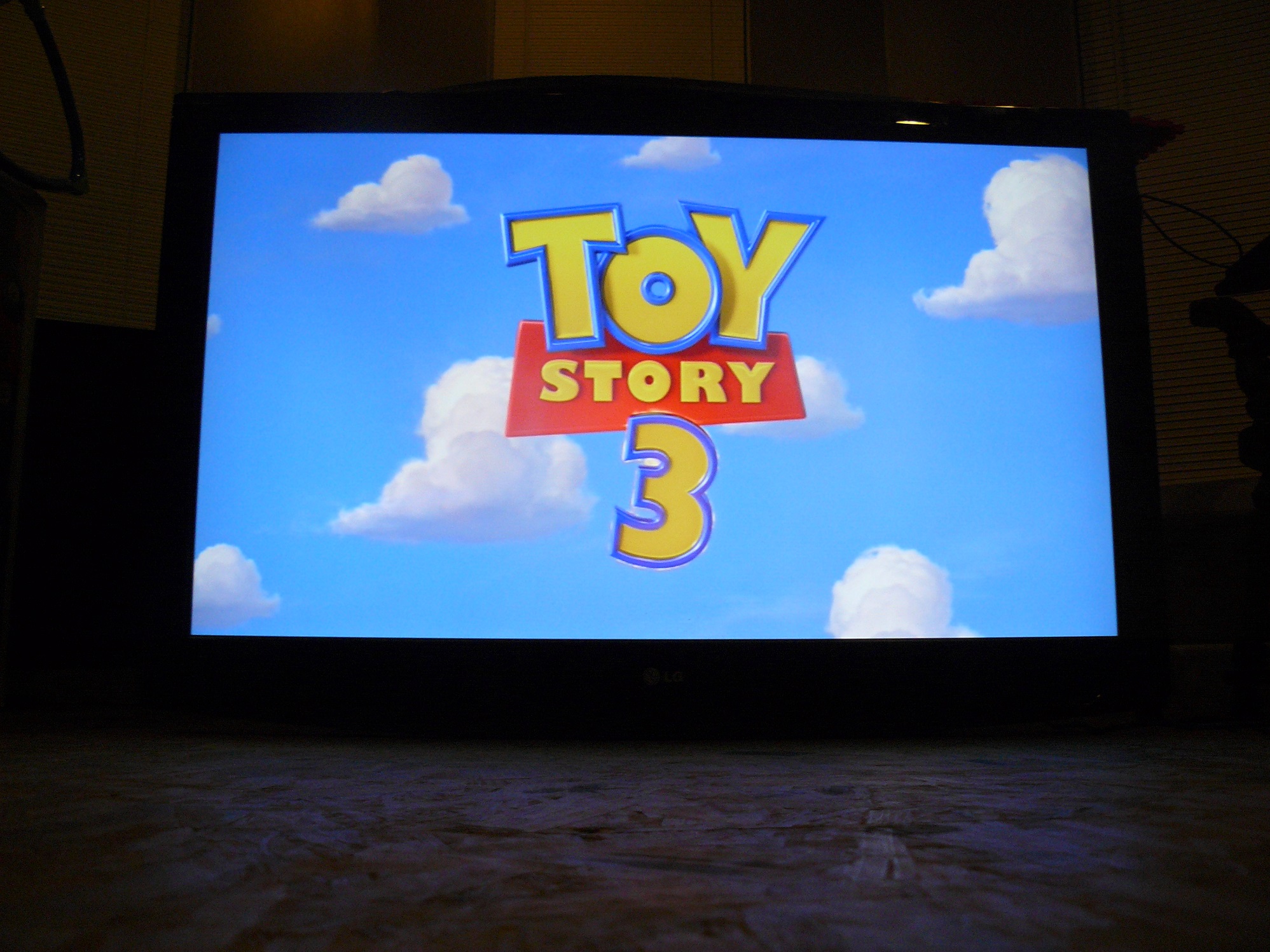

                  Well i manned up and bought the correct main board. I am happy to announce the tv is working correctly. The standby led only blinks 1-2 times then the backlights come on. My friend scrapped this project a couple weeks ago since he didn't want to gamble the $90 for the main board. This will be wall mounted in my dining room since it has no base.
                  Thanks to all for your opinions.
                  I got very lucky on this one.
