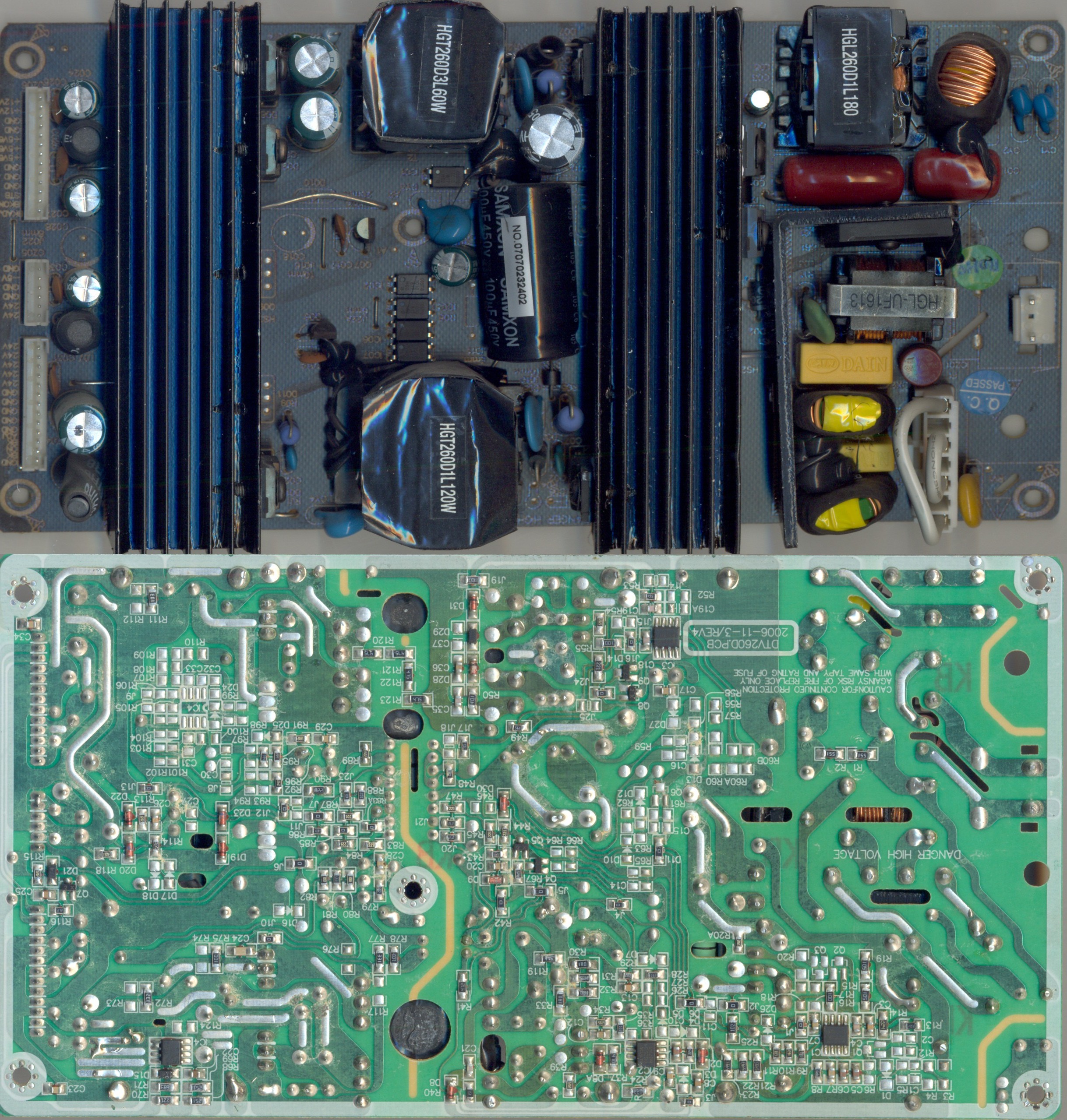

    I have acquired a Insignia NS-LTDVD26
    It works fine for 10 minutes then the video shuts off, the audio continues to work. Sometimes you can turn the TV off then back on and it will work for another minute maybe two max and then the video shuts off again. Other times after the video goes off then shutting the TV off then right back on I only get audio. Letting it sit for a while before turning it back on will allow it to work again also.
    The outputs from the PSU all check out good when the tv is on. After the 10 minutes and video shuts off the all the 24V outputs go to 0 the rest are still good.
    I though heat could be an issue so I used an infrared thermometer to take temperatures around the board but mainly on the components attached to the heat sinks. I noticed there was a spot in the middle on the bottom of the right-hand heat sink in the picture that was around 20 degrees warmer than the others.
    Under the heat sink in that area is a resistor and a capacitor. On the bottom of the board in that location, IC3, is a 230D6, PWM controller. I put a fan blowing directly at the heat sink and the problem was still occurred. Then I positioned the fan with a shroud blowing directly under the heat sink where the elevated temperature was coming from and then it worked for over an hour.
    Attached to that heat sink on the bottom left is a P9NK70ZFP Zener-Protected Power MOSFET. As I tried to specifically target under the heat sink I think the the MOSFET is not the problem, its temperature did not fluctuate very much at all with or without the fan present.
    I do not know if this is a red herring or there is another problem. Also I do not know if one of those components is the problem or something else is causing the problem to potentially be exhibited there. Or maybe(probably) I am way off.
    Any thoughts that you all may have to rehab this TV are appreciated.

    1) I count 9 electrolytic caps not including the big one. If this were my TV, I would replace them all as they look like Samxon GF series (a known bad series).

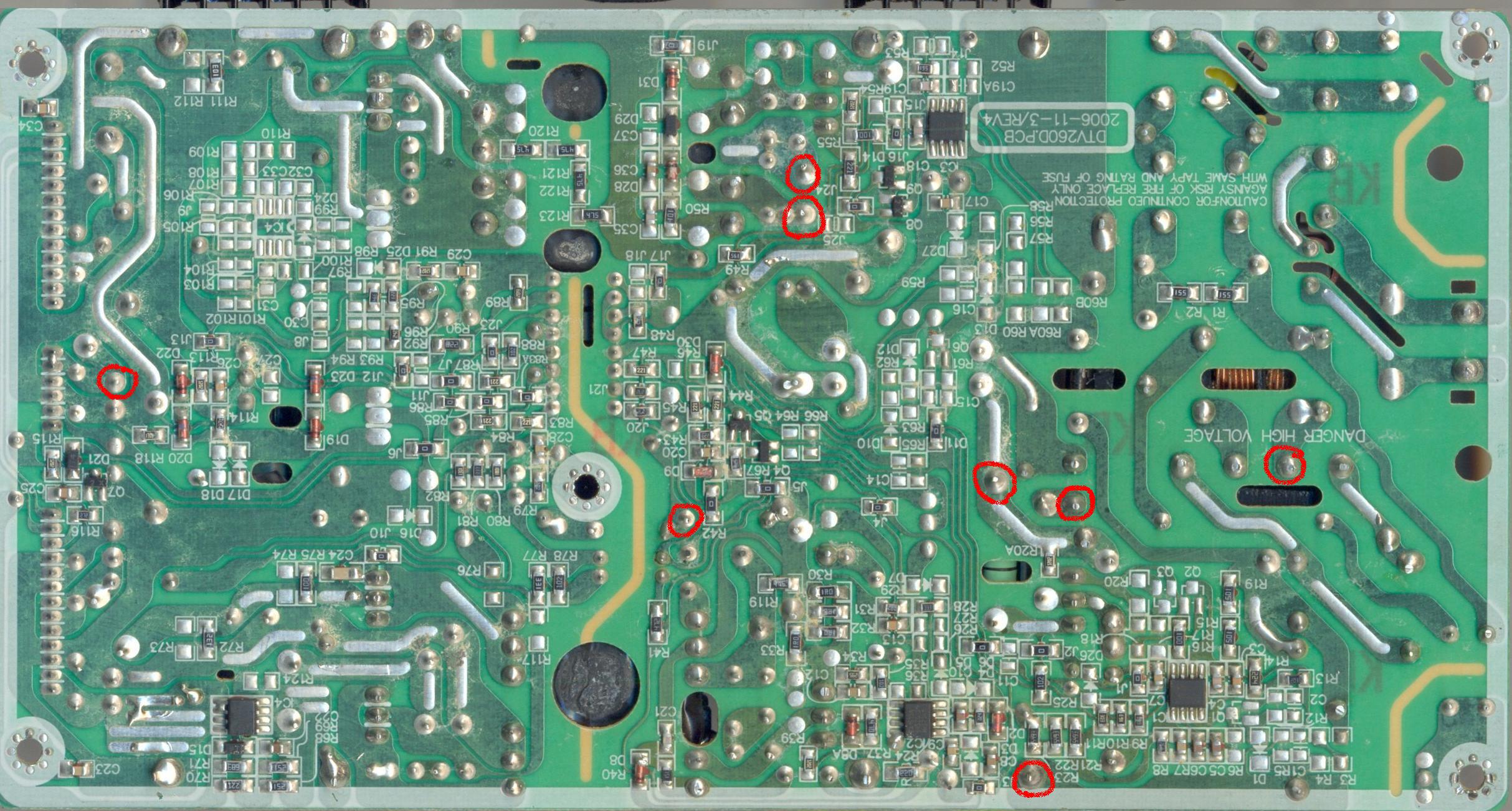

    2) I also see some solder ring cracks (selldoor is the eagle eyes). I just circled some that were obvious to me, but there may be more. I suggest reflowing/resoldering them with 60/40.
    3) You may want to change the main board as well for bad caps, poor soldering, etc.
    4) When the 24V goes to 0V, what is the DC voltage on the BKON pin? I'm assuming it is around 3V DC when 24V is present. If BKON is 0 when the voltages disappear, then your problem is on the main board.

      I reflowed the joints you pointed out and a few others that also looked suspect. The problem persisted.

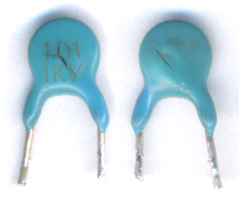

                          I resoldered all the through hole items and the 4 main ICs on the bottom of the board and still no change.
                          Which one is the PFC ic?
                          In the same area as the MOSFET near the bottom of the right hand heat sink is a ceramic capacitor. This is where I had been targeting the cooling. Upon further inspection it seems to be bad, see attached. There is a light brown discoloration as well that is hard to see in the scan.
                          Does this have the appearance of a bad disc capacitor? In its condition would this explain it working for a set time then shutting off and also continuing to work when cooling is applied?
                          It is a 101 1KV, so far I have only been able to find a 151 1KV capacitor in my parts inventory. Would this be acceptable to substitute or is it to far of a jump in capacitance?
                          Also just found from a CRT monitor board a 101 2KV and a LB 101K 1KV. Not sure what the LB signifies but seeing as the original does not have a tolerance value and this one is 10% would it be ok to use or would going with the higher voltage, 101 2KV be better?
                            Re: Insignia NS-LTDVD26 Video shuts off after 10 minutes
                            100pf 1kv. You can use higher voltage which will be better if it fits the board.

                              I replaced the capacitor with the 101K 1KV that I had and after a series of 30 minute tests everything seems to be working. Hopefully everything stays that way.
                              I guess that means I should look a little harder at each component next time.
