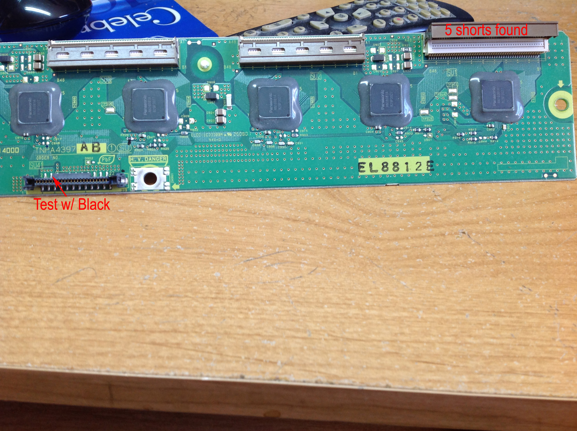

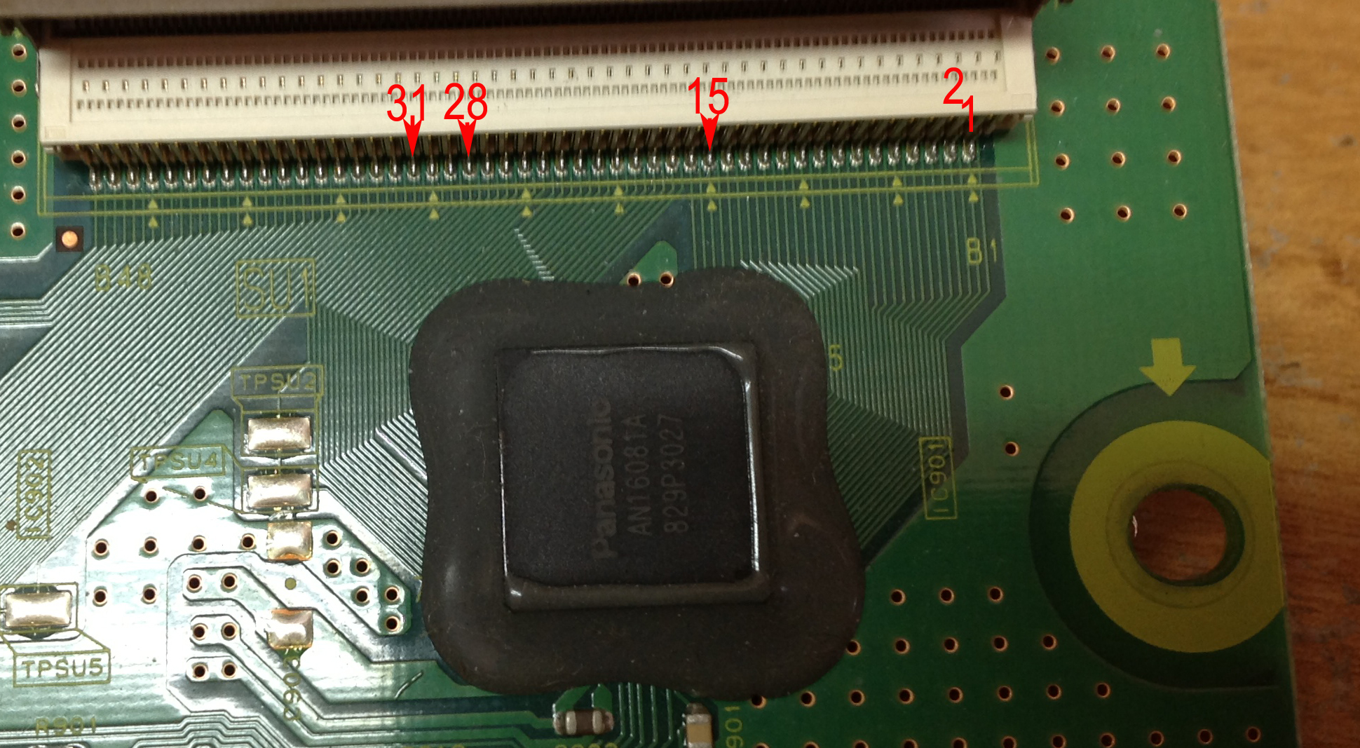

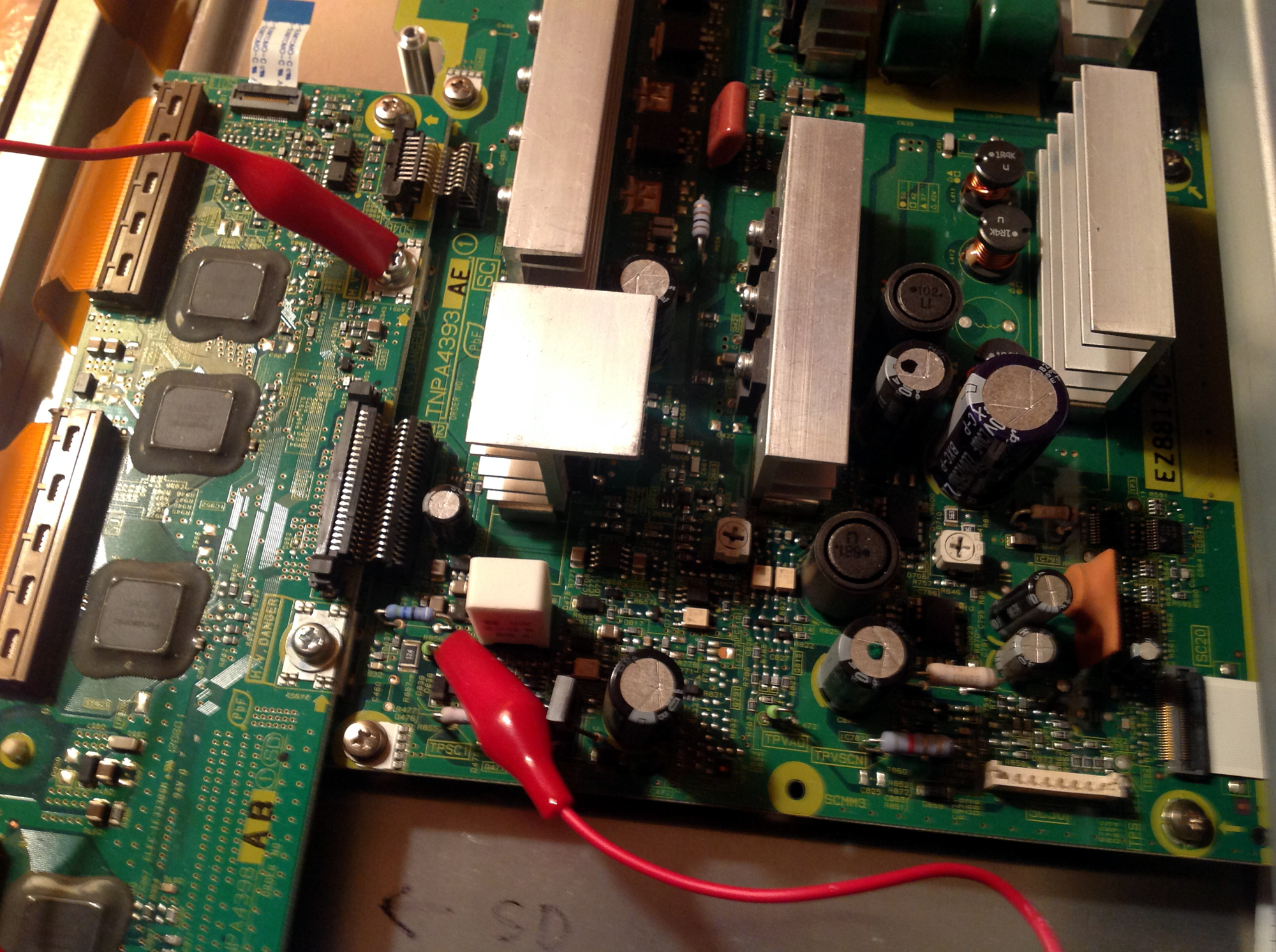

                Tom66, using your video about testing buffer boards I tested the SU upper buffer and found five shorts. I set the meter to beep and set the black on post 2 of SU41 and found the shorts at 1, 2, 15, 28 and 31. See photos.
                My questions are:
                1. Can this be a reason that the whole screen is black, or maybe in conjunction with another board?
                2. Can this be the source of the LEDs on both Y and X boards fading out after 20 seconds and the TV shutting down after 30 seconds?
                The lower buffer checked out OK. Anyway, I'm in no hurry to fix this unit. Thanks for your time.
                Regards,
                Gary

                      You should be testing from the "HV DANGER" point on this picture:
                      https://www.badcaps.net/forum/attach...9&d=1361203934
                      • MyHD120
                        • Jan 2013
                        • 79
                        #71
                        Re: Vizio VP503 HDTV10a Black Screen
                        Same shorts testing with HV Danger.
                          #72
                          It may be defective then. I believe on this set you can run it with just SD or SU and get half a picture.

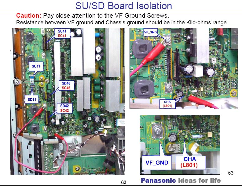

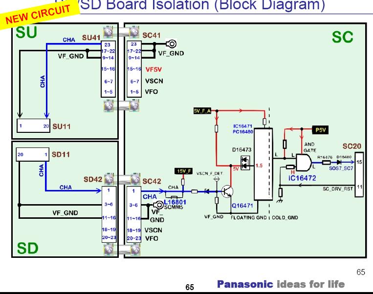

                            #73
                            11th gen training manual has this for isolation if it helps at all which includes the 50PX80 models. It needs a jumper to bypass the shutdowdown detection for any SU/SD board disconnection.
                            • MyHD120

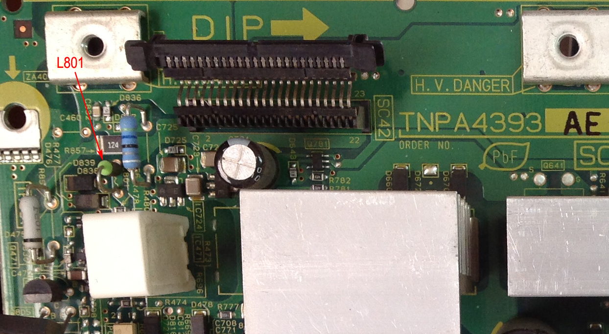

                                My board is slightly different as you can see in the photo. Is this the L801 which you mention? I'm waiting for the mail and then I will finish putting this together to do that test.
                                tom66; It's only 10am here. I will do the 'Glow Test' when it gets dark.
                                • tw2005
                                  • Oct 2011
                                  • 6458
                                  #76
                                  yep, although I have assumed this has carried over from the Panasonic, I posted it up just in case you try running a single buffer board without the jumper and see no change. Then try it.

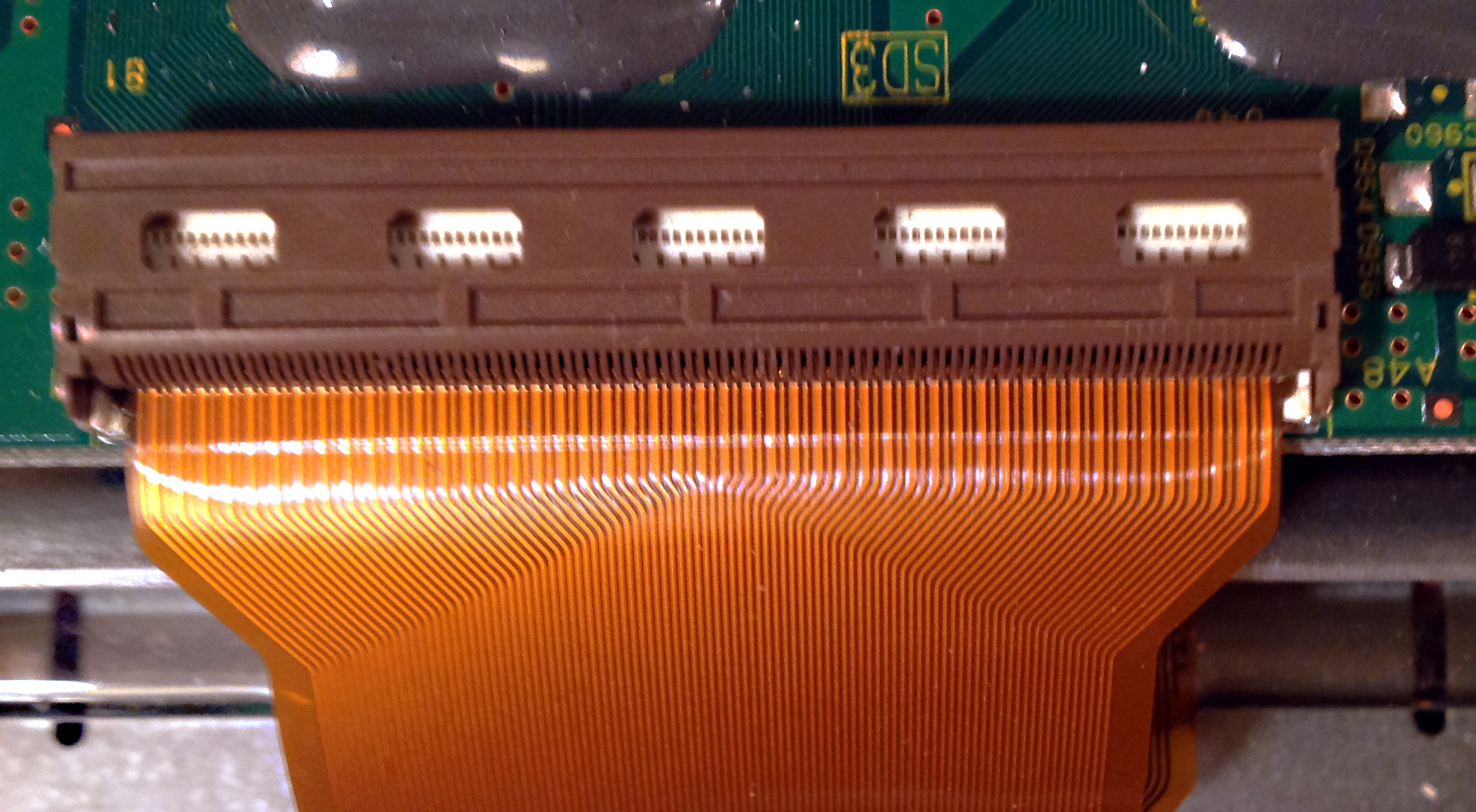

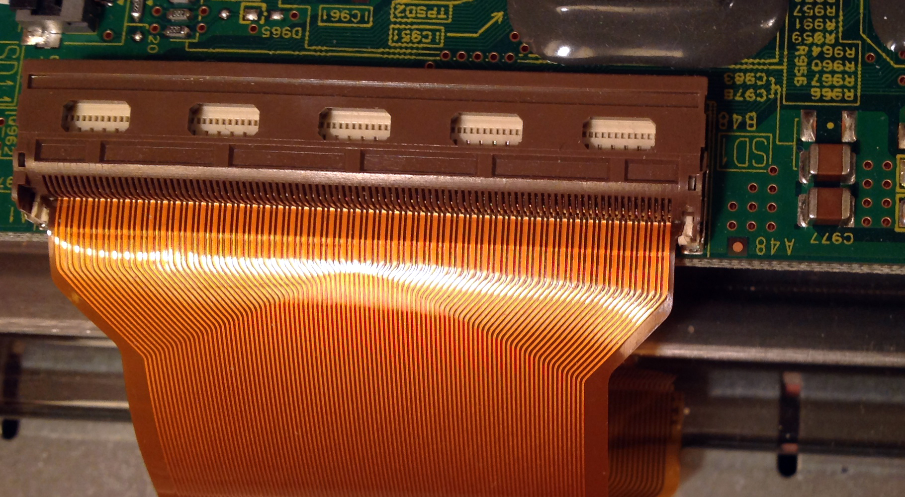

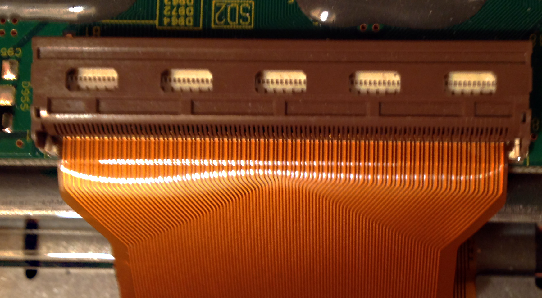

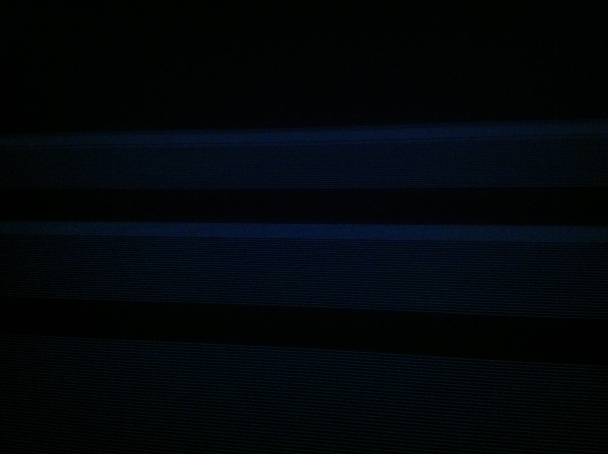

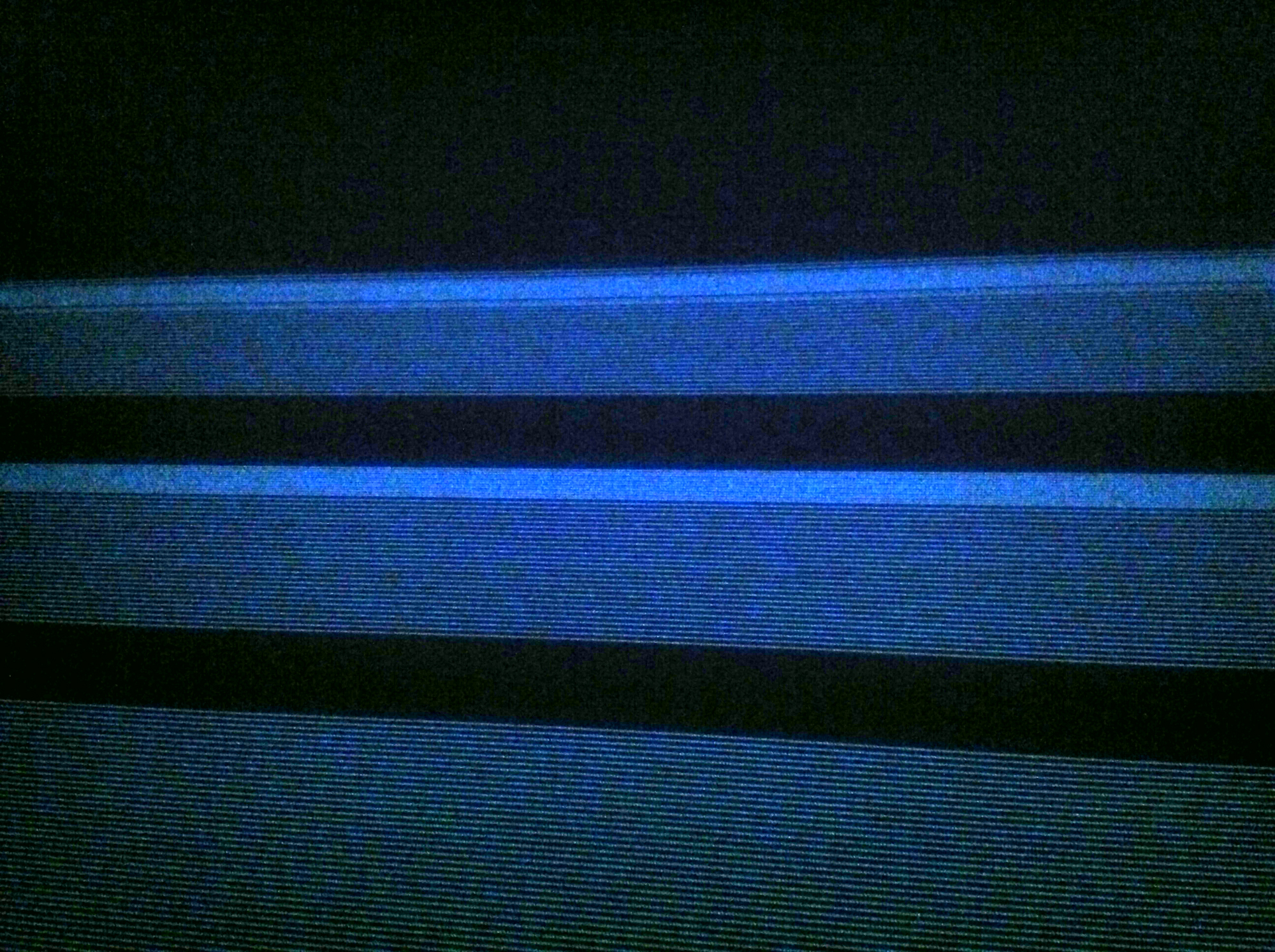

                                    Tw, I did it with the jumper in place and got the glow(?), I think. Half the panel(lower) seems to glow with the lower buffer installed. My upper buffer has a short on the upper chip. But there are some horizonal bars. Took some photos. Will upload tomorrow. Only have my iPad running right now.
                                      #78
                                      If you removed the lower board, reseating it properly is very difficult, which will often cause horizontal bars in the image.
                                      • MyHD120
                                        • Jan 2013
                                        • 79
                                        #79

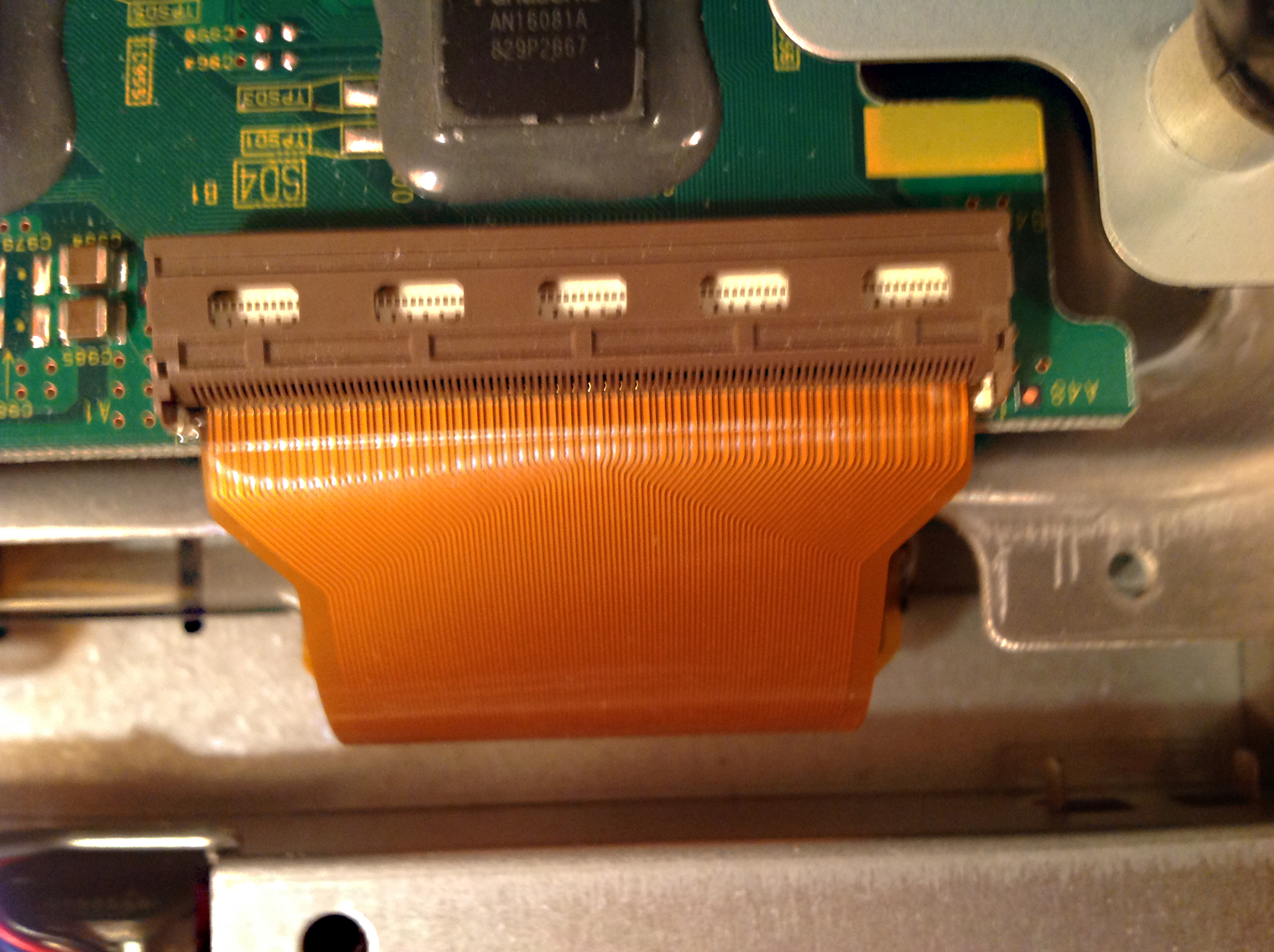

                                        I reseated and the situation is unchanged (you do mean the tabs, correct?). I'll try it again. I'll also try cleaning the tabs. I'm working with this panel flat down and it's difficult to raise it up to take photos. Heavy! See the photos. I've labeled them. L=lower. RAW=unretouched. The screen shots were taken in total darkness with an iPad. Also some shots of the tabs.
                                        Facts:
                                        1. It still shuts down after 30 seconds or so.
                                        2. The LED's on the SC and SS board now stay lit until auto shutdown. Good sign?
                                        Is this now pointing more to the Main board? What tests should I try next? And I must get the tabs straightened out.
                                          #80
                                          That is a classic sign of improperly seated connections. Getting them lined up is really really tricky. But essentially you can push them in and when you get it right you will hear a "click" sound and it will go all the way in.
