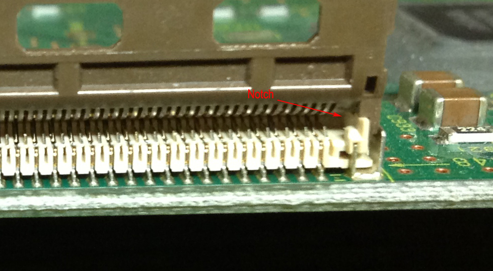

    Sorry, tom66, but I might be a little thick. When you're talking "Click", you can't be talking about SD1-4. Those tabs don't click. I assume you're talking about SC/SD42 and SC/SD46 (see pic). I believe these are seated correctly with the click. If I'm confused, please clarify.

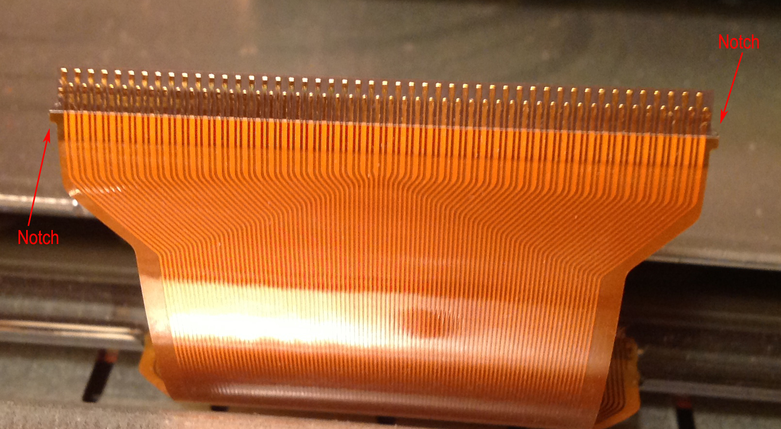

      I'm tallking of the orange connectors going to the plasma panel itself. I can clearly see in the above photo they are not correctly connected.

        Re: Vizio VP503 HDTV10a Black Screen
        Originally posted by tom66
        That is a classic sign of improperly seated connections. Getting them lined up is really really tricky. But essentially you can push them in and when you get it right you will hear a "click" sound and it will go all the way in.
        "Really Tricky"? That's the understatement of the year!! I've got it down to a few, smaller bars. I will continue to work on it. When seating these connectors I never once heard a "click". Look at the pics, there is an alignment (?) notch I'm using.
          It's hard to describe locking those tabs in but not quite a click.From memory you can push them in and think they're right but sometimes you feel a little resistance and then a little more pressure and it goes a little further and you know it's home.
          The markers are handy to compare to give a guide that it's home and parallel.
          Once home, obviously that locking latch has a nice positive clicking action. If they're not quite right sometimes that latch will not click home and sit up a whisker. Maybe that is what Tom is referring to?
          It's a touchy feely job , all about keeping it nice and square and good even pressure. The last thing you want is to be rough and kink those ribbons.

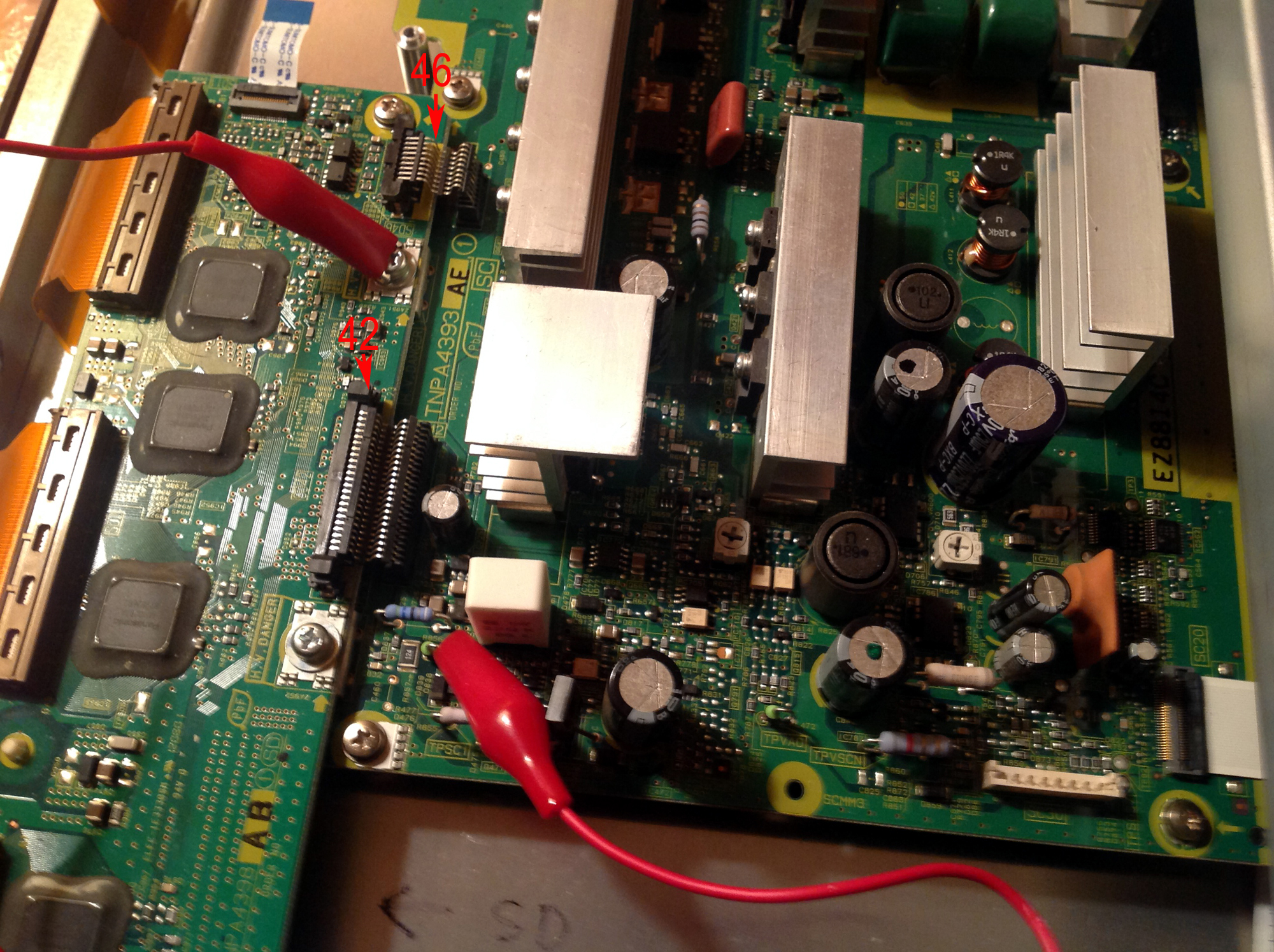

            tw, I'm not sure what you mean in you're last sentence. Where would I hook the jumper if the buffers were removed? In the same screw pod? I'M willing to try it. Are you thinking the set my stay powered up? Should I be worried about the caveat of running the system more than 30 secs without the boards?
              #86
              It appears this set chains the signal from the upper buffer to the lower buffer. No upper buffer, no picture (just primed.)
                I can't make out the connectors on the buffers but I'd disconnect sd46,sd42,su41 if they just pop out. that would leave nothing going into the buffers and still use the screw posts to jumper to L801. I've only ever tried that on the next series when they introduced the 2 pin sc50 which is jumpered to do the same as what we are doing on this. The idea is to help determine when you get 7 blinks whether it's buffers or SC board.
                I have tried it with a good SC to see what happens and basically it'll fire up normal (no picture)with no fault code. If it went 6 blink then it also means a bad SC, but this is not a full panasonic but may fire up and stay on.
                I'd have it on only long enough to see if it went past the time it currently stays on. 30secs does seem a long time for it to decide something is wrong to me so maybe ther's more than one fault here. I have nothing really to base any real judgement on this.
                                  SD46 and SD42 disconnected. No SU installed. Jumper in place. Power on to shut down still at 40 seconds. However, I could hear a slight hum from the lower part of the SC board. I'm waiting for an answer about an SU board.
                                    #97
                                    Does the LED stay lit on the SC?
                                      Yes. On both the SC and SS. They only fade out after the shut down. Before, when I had the 30 second shut down, they faded out after 20 seconds.
                                        #99
                                        I think the SC, and SU, is working then.
