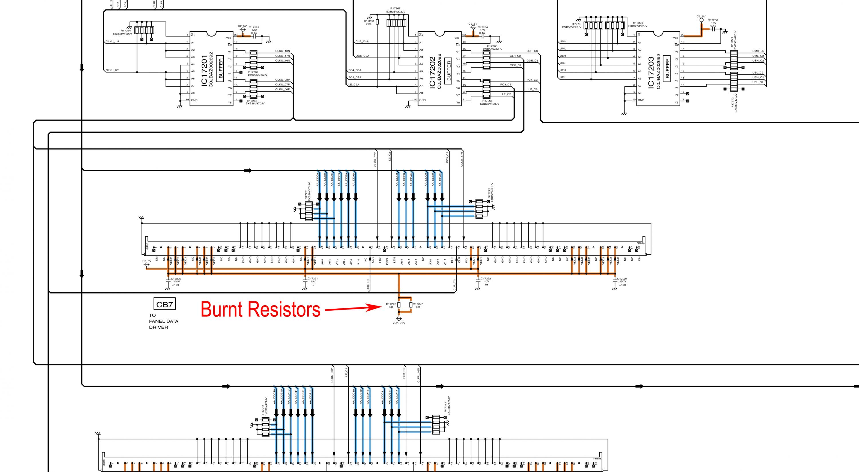

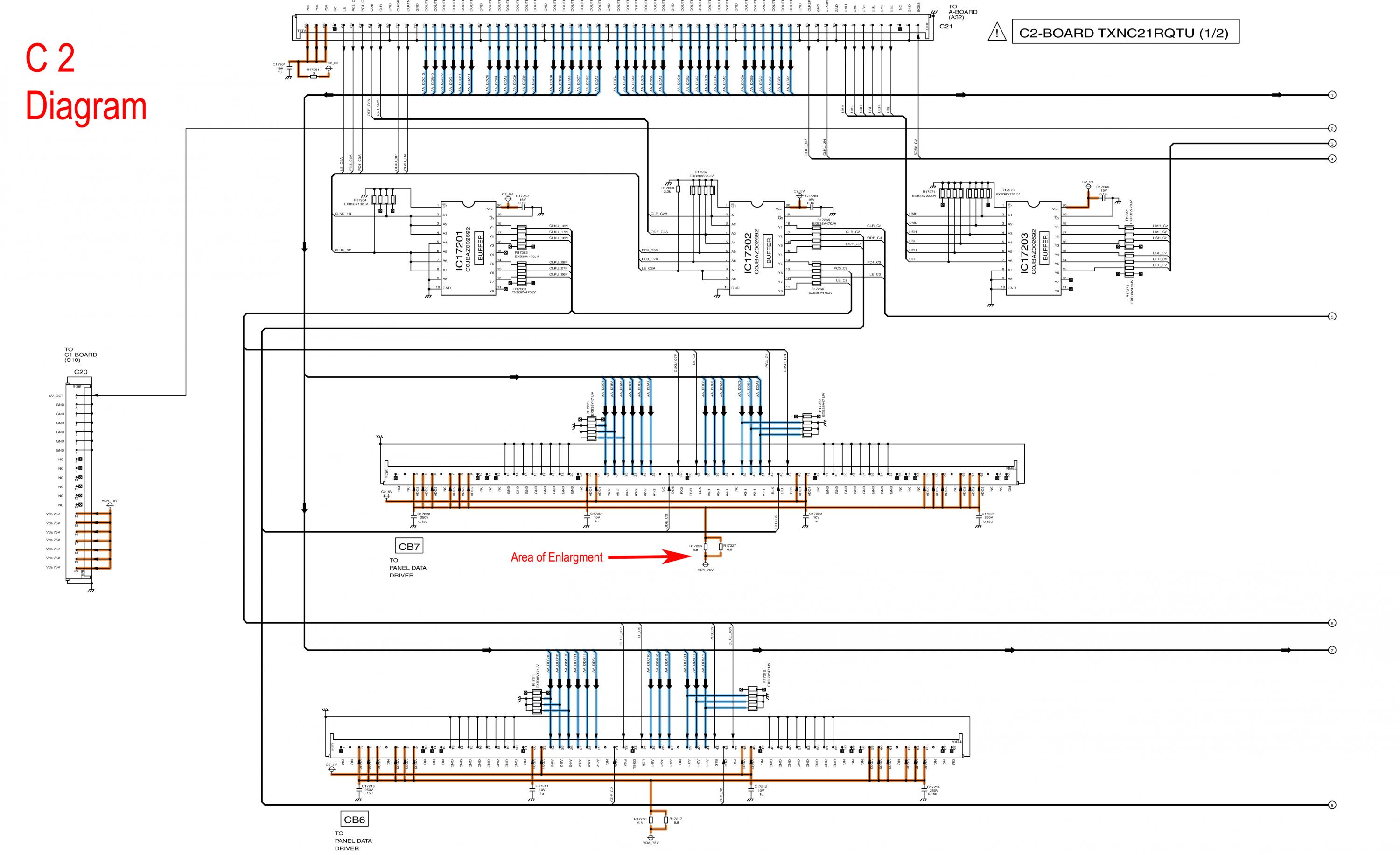

      Tom66; I think I really stepped in it this time. The C2 board arrived today. Installed it and within a millisecond, a puff of smoke after power button on. Burnt the same 2 resistors again. I'm posting 2 pics. If you will, please look at them and tell me where to check, and how, for this over voltage or short. I have Photoshop so I can break the .jpg into sections if you need it. Thanks
        #123
        Re: Vizio VP503 HDTV10a Black Screen
        The only way those resistors would burn a second time is if the panel is bad.
        Sorry.
        • MyHD120
          • Jan 2013
          • 79
          #124
          Thank you very much, Tom. I was afraid of that.
