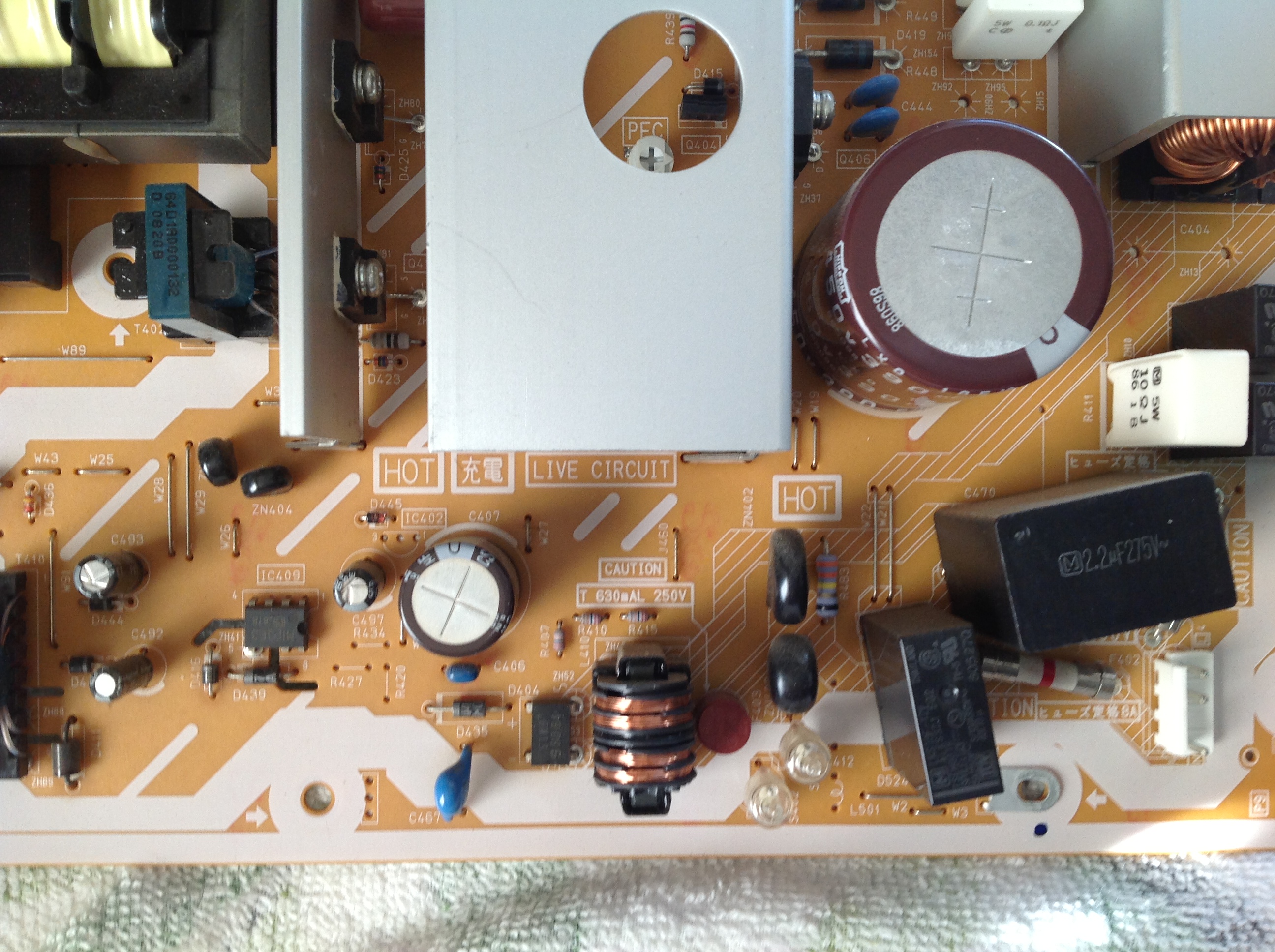

    When the screen went black there was no audible pop. Breakdown shows no visible bad caps. I've removed the PSU (LSJB1260-1), the main (3850-0182-0150), and replaced the SC (TNPA 4393AE) and still no picture. No visible burn marks on the foil side.
    Here's the dilemma; The VP503, from my research, is a Panasonic TH 50PX80UA, for all intent and purpose. I cannot find a service manual for the 503, so I've been studying the Panny manuals. Although there are some differences, page 16 of the service manual (see pdf) is telling me it's an A board problem. In 2009 Panasonic incorporated the D board into the A board. This set has the D board which is older Panasonic technology (pre 2008) On my SS and SC boards those LED indicators are marked D253 and D583. They only stay lit for a few seconds and then fade out.
    I have a DMM and a Blue ESR. The DMM has auto ranging. I am a real novice with electronics so be patient and precise when giving instructions. I have pictures but do not want to clutter your board. Ask for specific or all and I will load them.

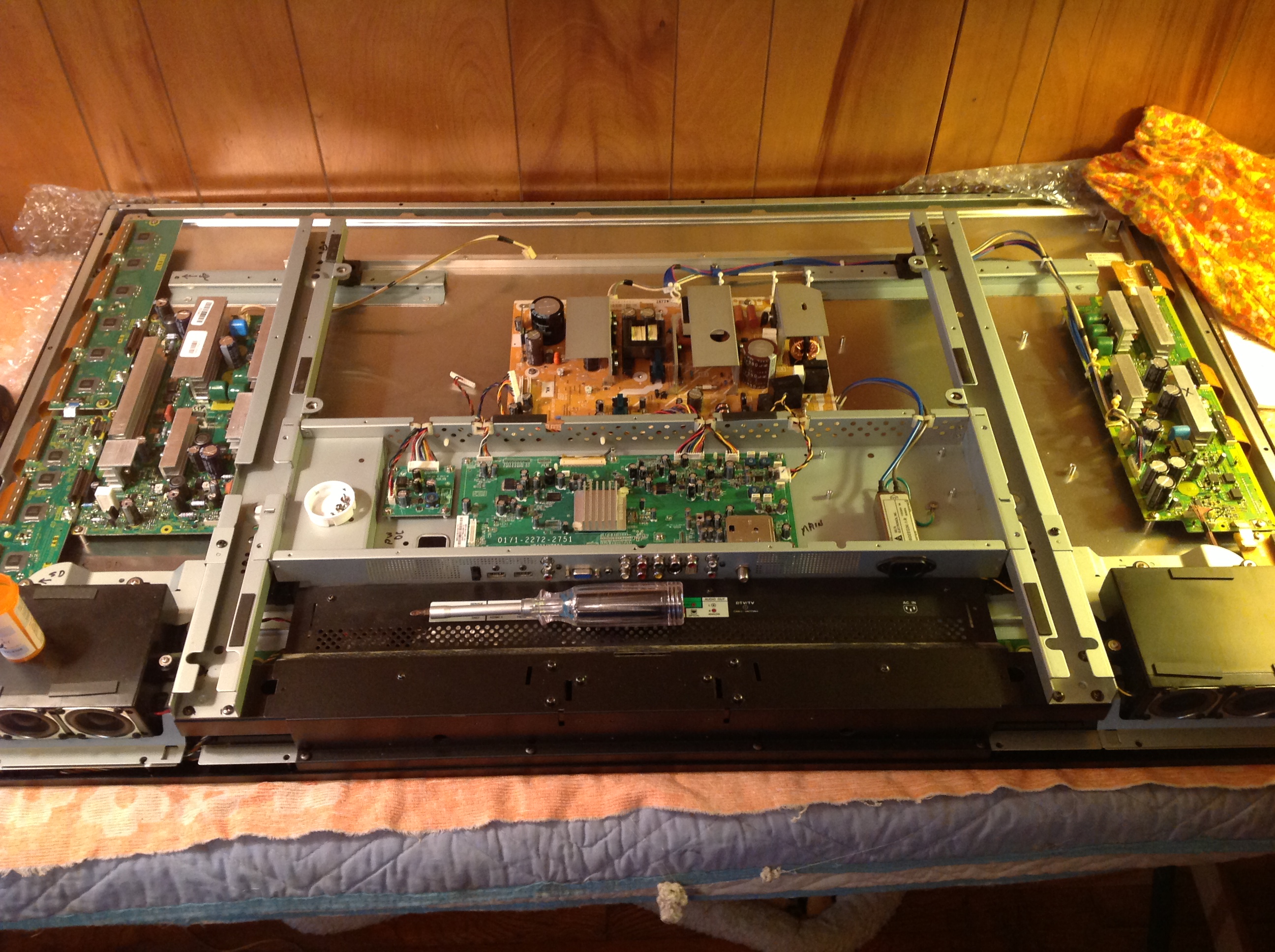

        I don't think Vizio has a blink code. If it does I never saw one. The on light starts amber and then goes to blue.
        Screen does not glow in a dark room.
        I have all your manuals plus many others (Panasonic, not Vizio)
        As you can see in the photo, I'm just putting the power board back in.

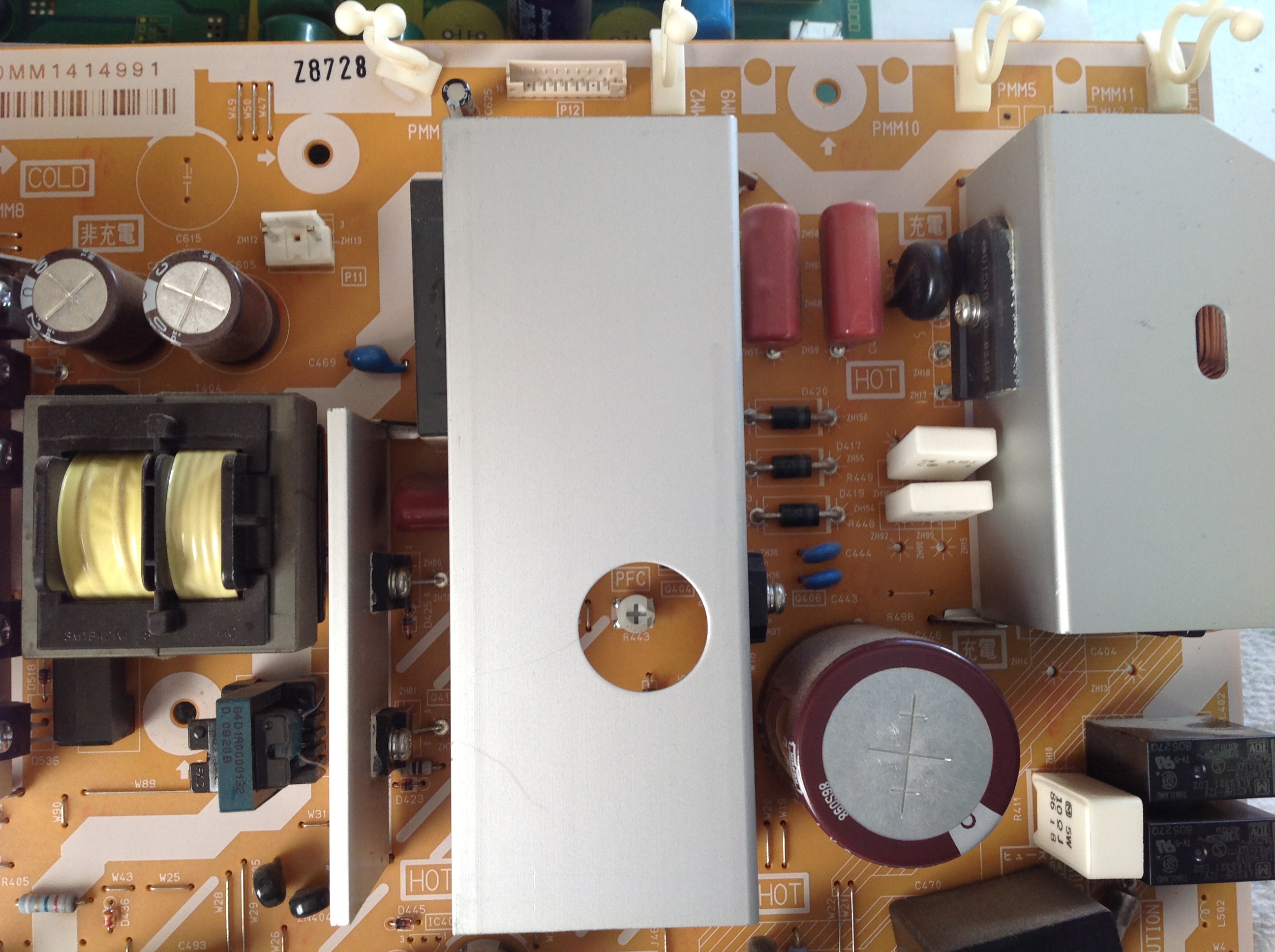

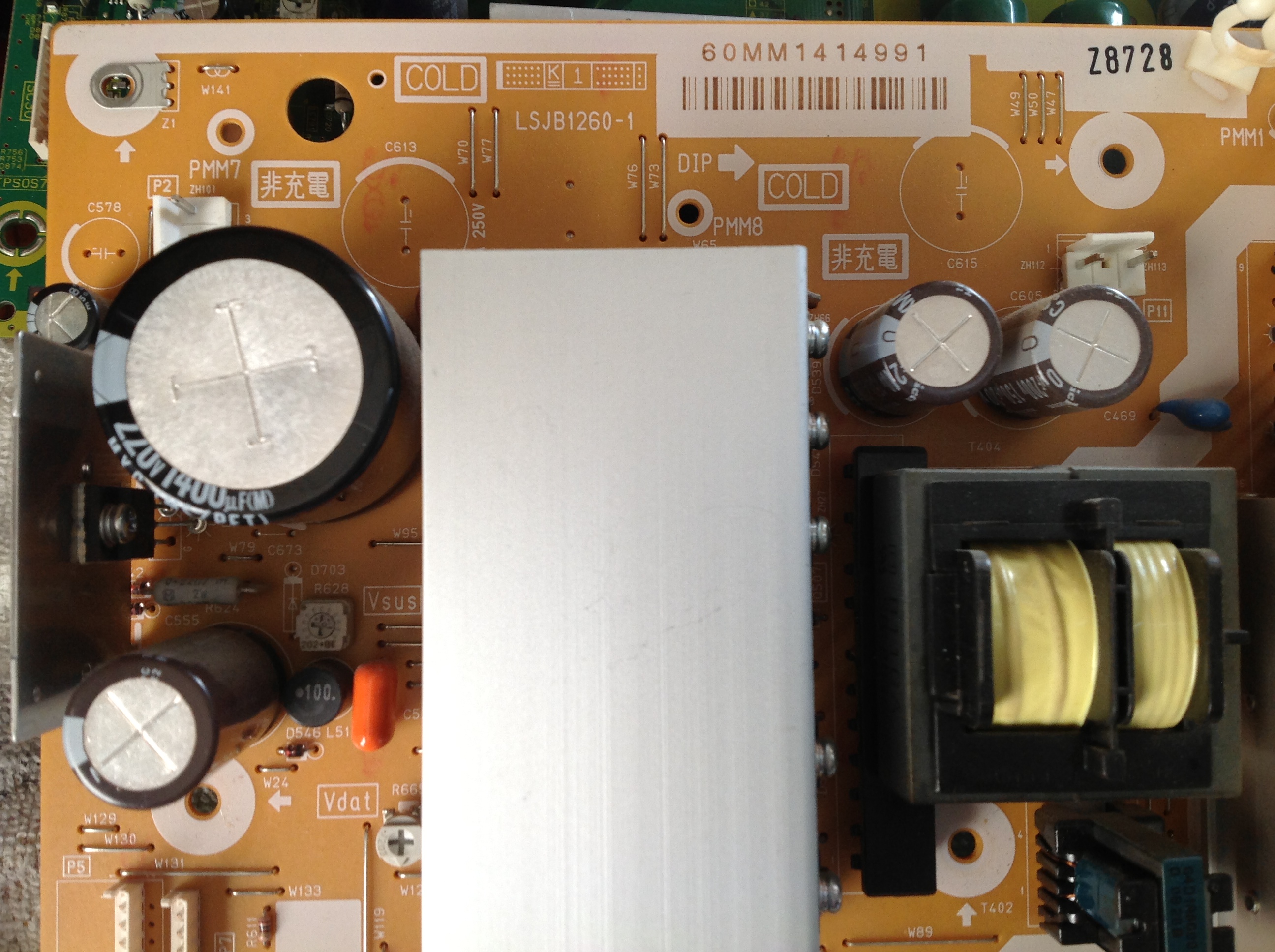

            No I haven't as I'm not sure how to do it. See photos for connection to power board. Do you test with the connector on? And how. Auto ranging? The Vsus sticker says 186v.
              Re: Vizio VP503 HDTV10a Black Screen
              186V on a Panny plasma module? That's pretty low. Normally around 200-215V.
              The voltage can be measured across PMM7 - careful high voltage.
                              Top left of this picture
