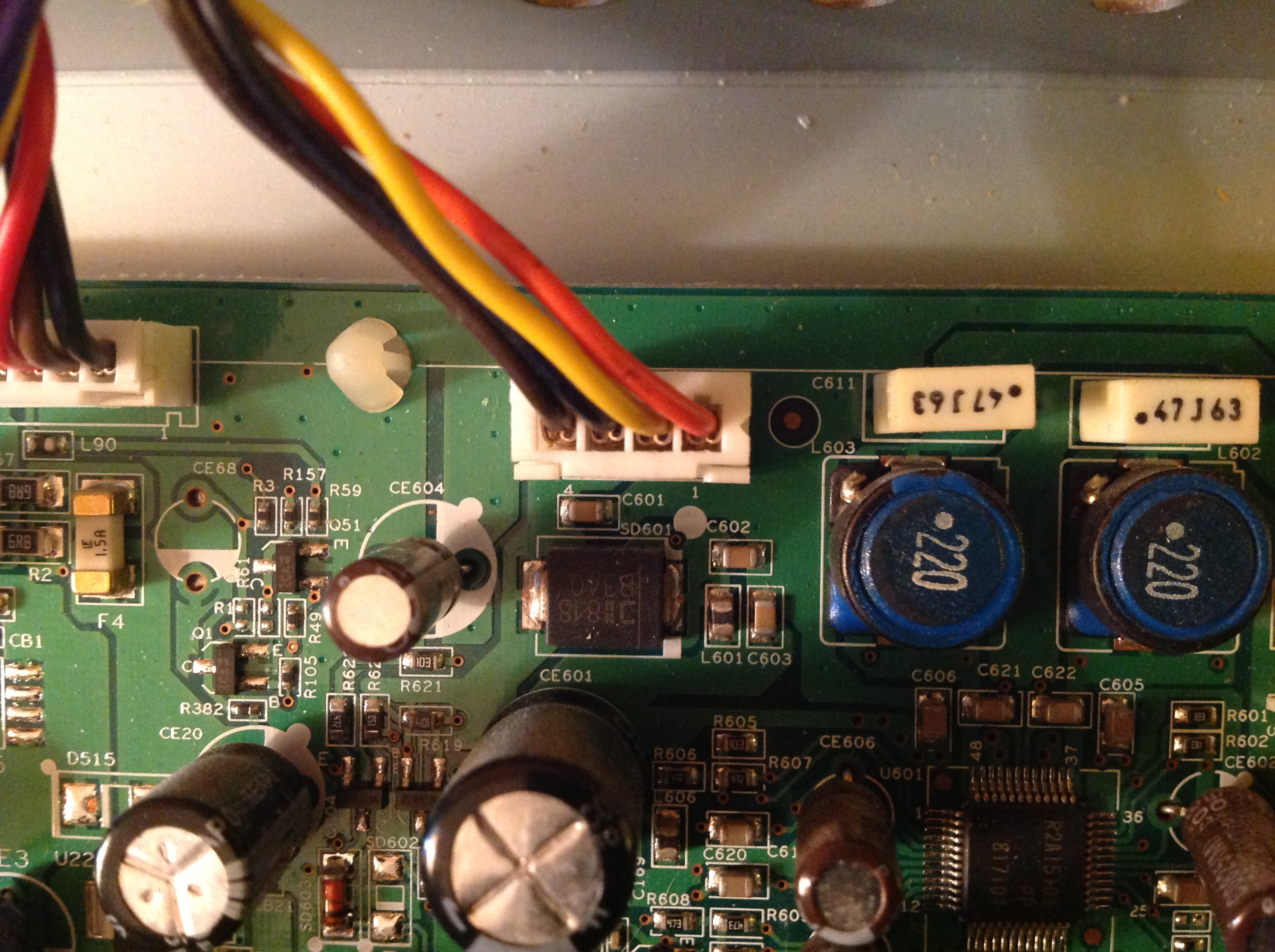

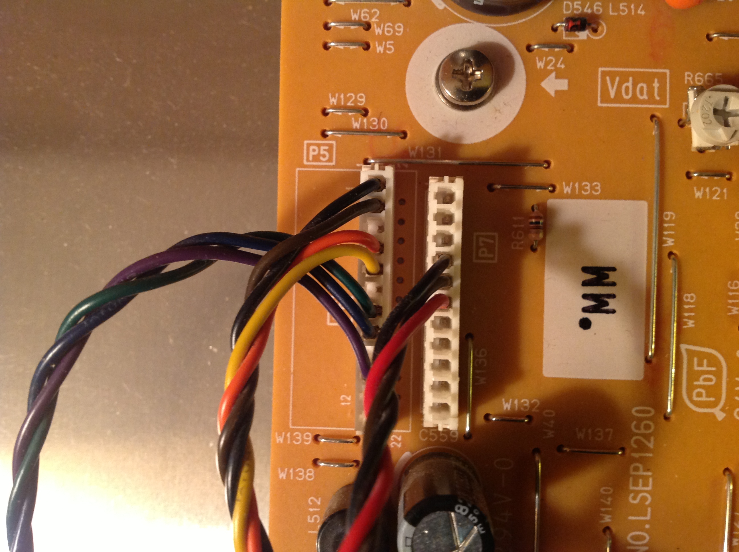

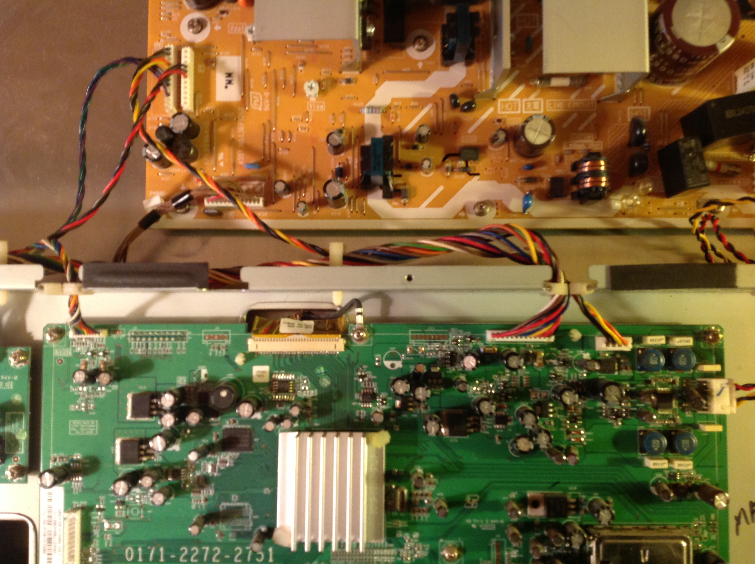

          Re: Vizio VP503 HDTV10a Black Screen
          Can I have a picture of the connectors going from the main board to PSU? I'm hoping they are labelled, if not, I may be able to use the labelling from the 50PX75U.
          • MyHD120
            • Jan 2013
            • 79
            There is only 1 connection from the main board to the PSU. In cn1 you have red, yellow, brown, black going to P5 on the end (cn2) Cn3 is an over all pic.

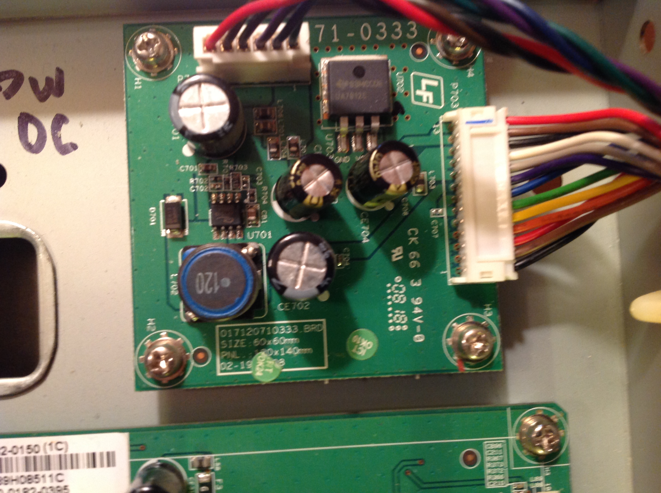

              Where does that large bundle, left of the red-yellow-brown-black connector go?
              • MyHD120
                • Jan 2013
                • 79
                It's called a Power DC board 0171-2071-0333. See Pic.
                • MyHD120
                  • Jan 2013
                  • 79
                  and at the top of the pic bundle goes to P5 and P7
