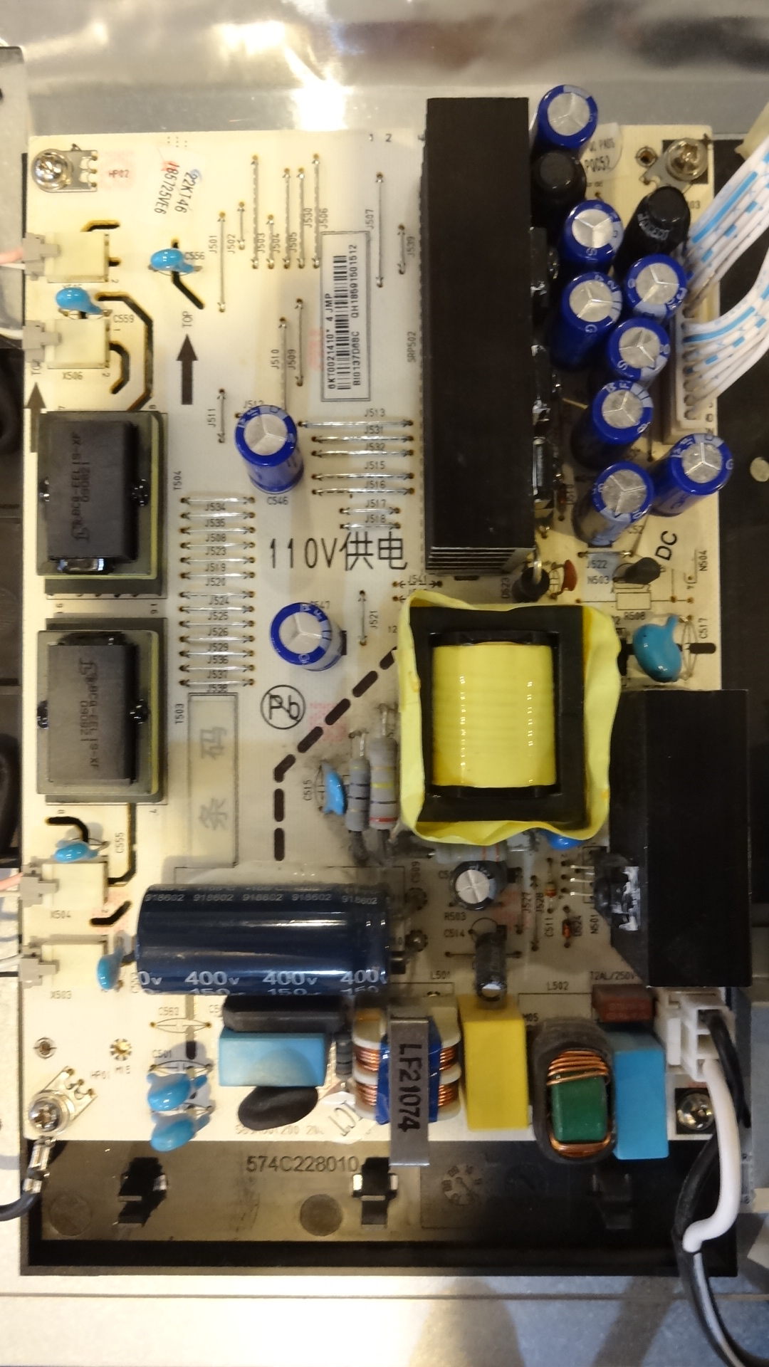

    The TV was completely dead at first, and when I opened it up there were several blown caps. In the picture you will see 10 blue capacitors, those are the new ones. After replacing those the TV now turns on and functions normally however the picture appears faded/washed out. Turning the brightness up or down seems to do nothing at all.

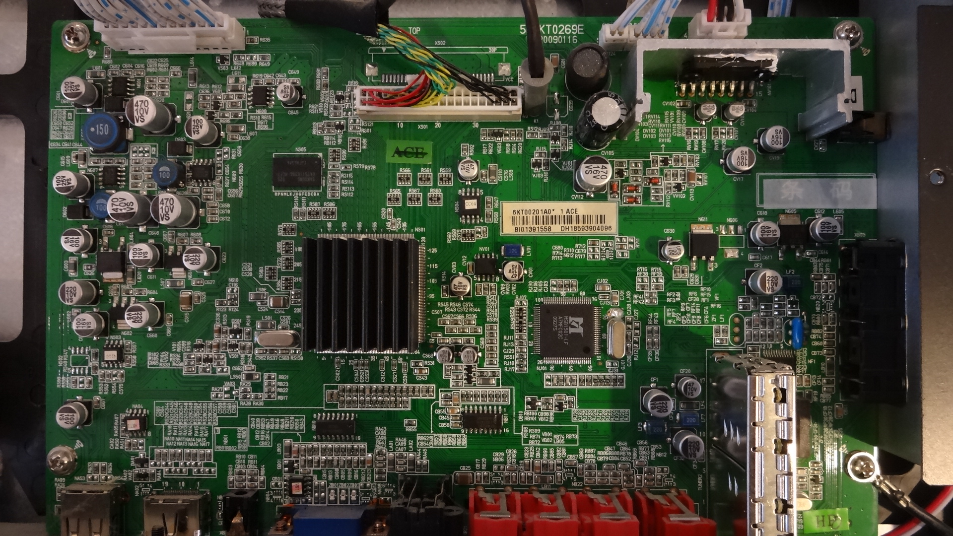

    I actually just now, while writing this and uploading pictures, noticed that there is a single cap on the main board that is the same as those that I replaced on the power board. I have one of these, which I learned after buying it apparently isn't very useful for testing capacitors. Would I be able to get an accurate measurment in this case? I set it on 2000uF (the cap is 25v 1000uf) and hooked it up, it started reading at just under 400 and slowly increased until it evened out around 530.

    Please list the brand and series of the capacitors used for replacement. Inadequate capacitors can cause a variety of symptoms.
    • PohTayToez
      • Jun 2010
      • 80
      Re: Dynex DX-L22-10A -- At First No Power, Now Picture is Washed Out
      Damn, didn't think about the new ones being bad.
      Here is a pic of one of the replacement capacitors.
        Ugh, wouldn't touch them with a ten-foot pole. Never heard of them, so I do not trust them.

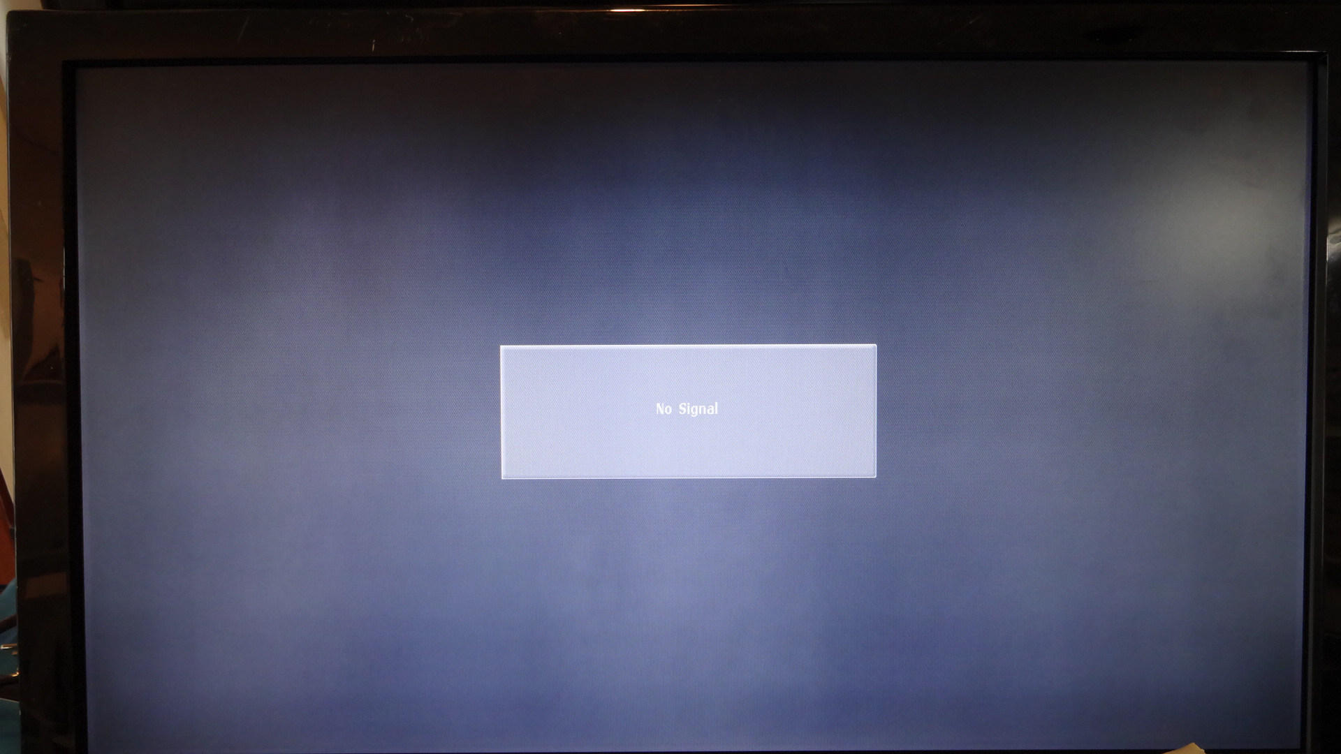

                        Alright I've replaced all of the cheapo caps with good ones and replaced two more caps on the power board along with one on the input board. It still does the exact same thing (color is washed out; with no video input the screen is more of a gray than a black like it would be normally).
                        I'll be testing voltage regulators next.
                          It sounds to me like it has Gamma problem due to bad power supply in the T-CON board.
                          Can we see the screen shot?
                          Does it look like this?
                          https://www.badcaps.net/forum/showth...mma#post304275
                          • PohTayToez
                            • Jun 2010
                            • 80

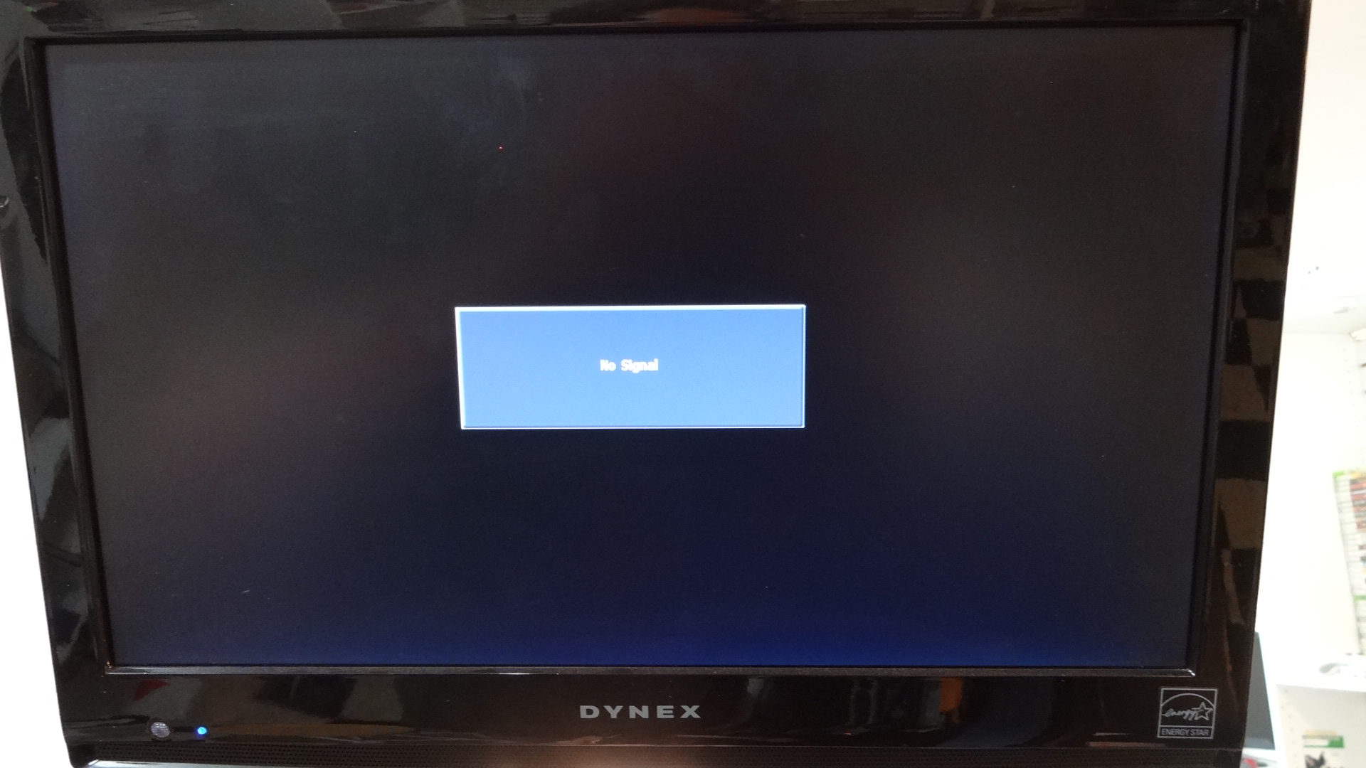

                            Alright, I attached too pictures. The first one is the TV in question. The second picture is of a smaller but similar model TV that is in good working condition, taken with the same camera in order to compare the coloration of the two.
