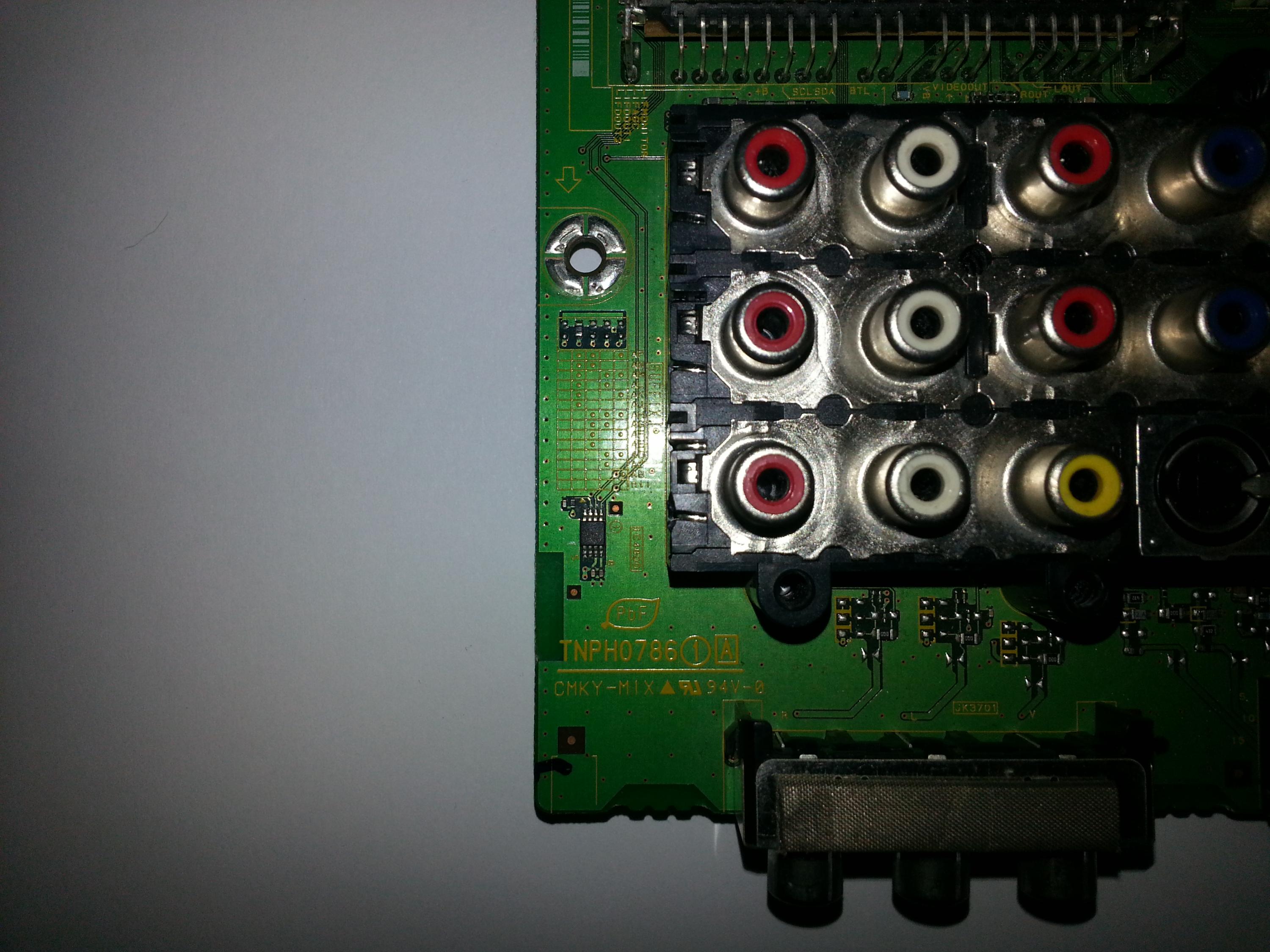

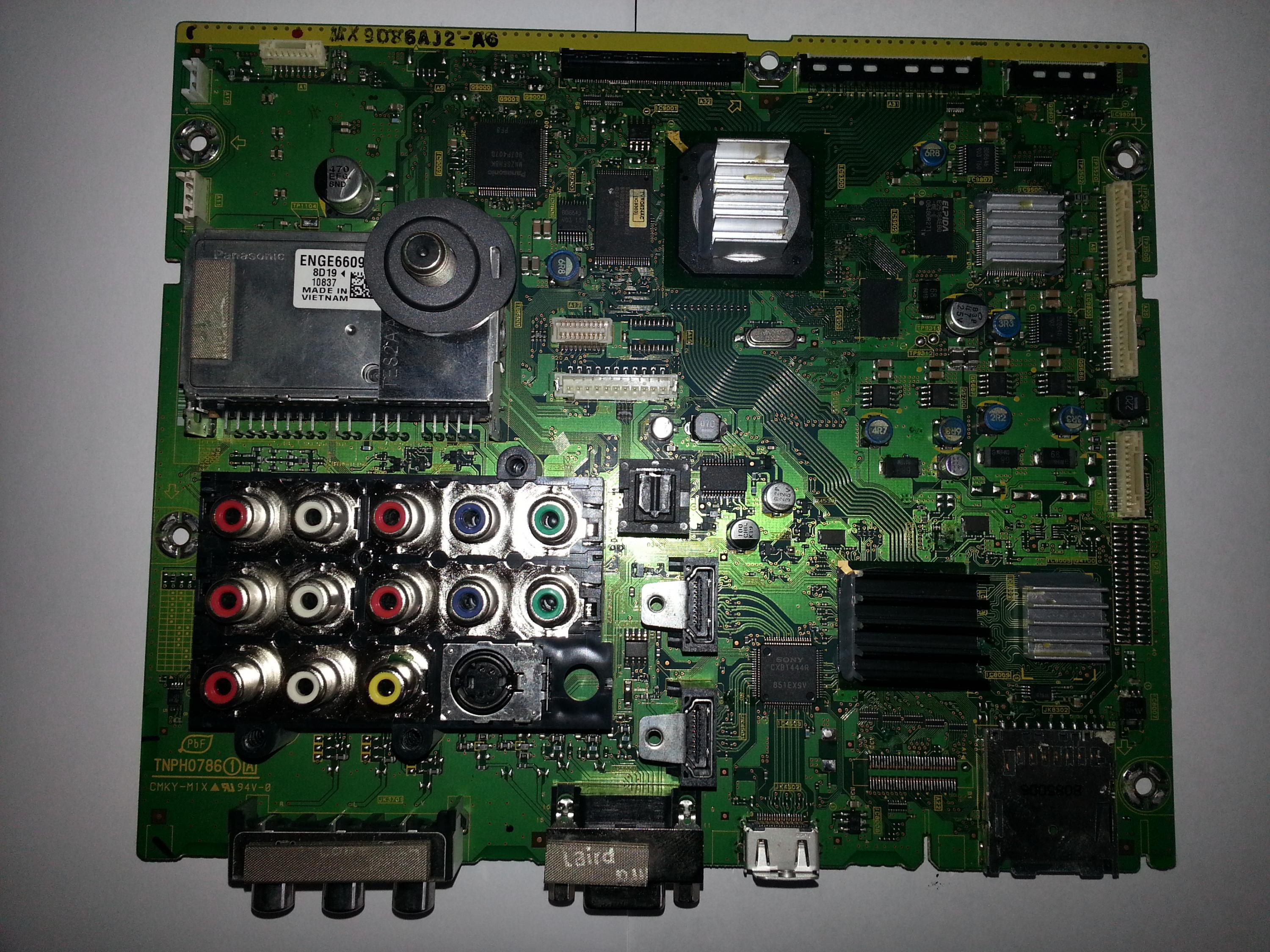

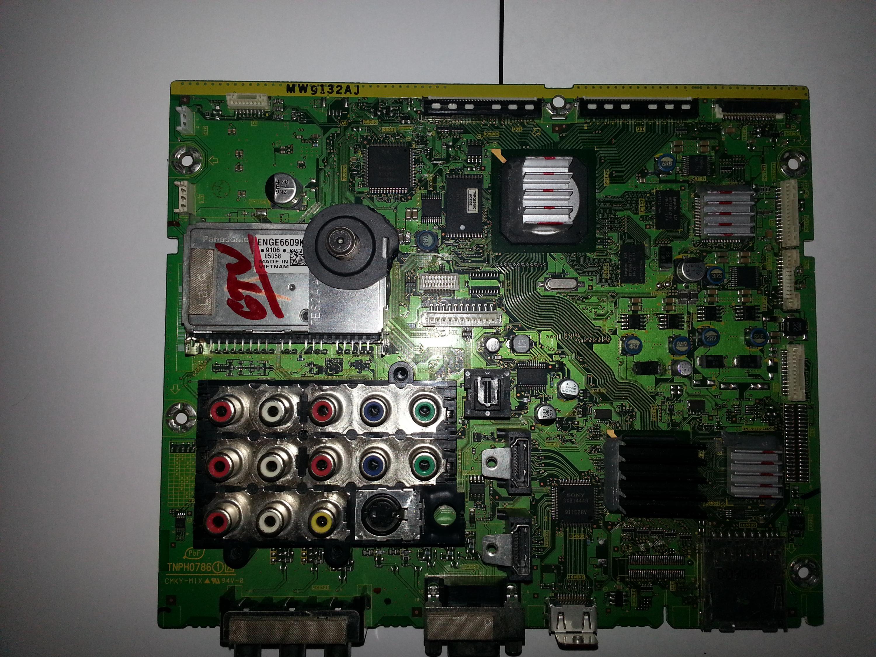

    hey guys......am i getting close...had a 11 blinks that was odd now after changing the A board...... got 1 non stopping blink
    thanks for any help dave

    This could happen if the A board you got is defective, or it is not programmed for the panel it is installed in (Panel SOS), check SUFFIX (e.g. AA) to see if it is the same as the one you replaced.

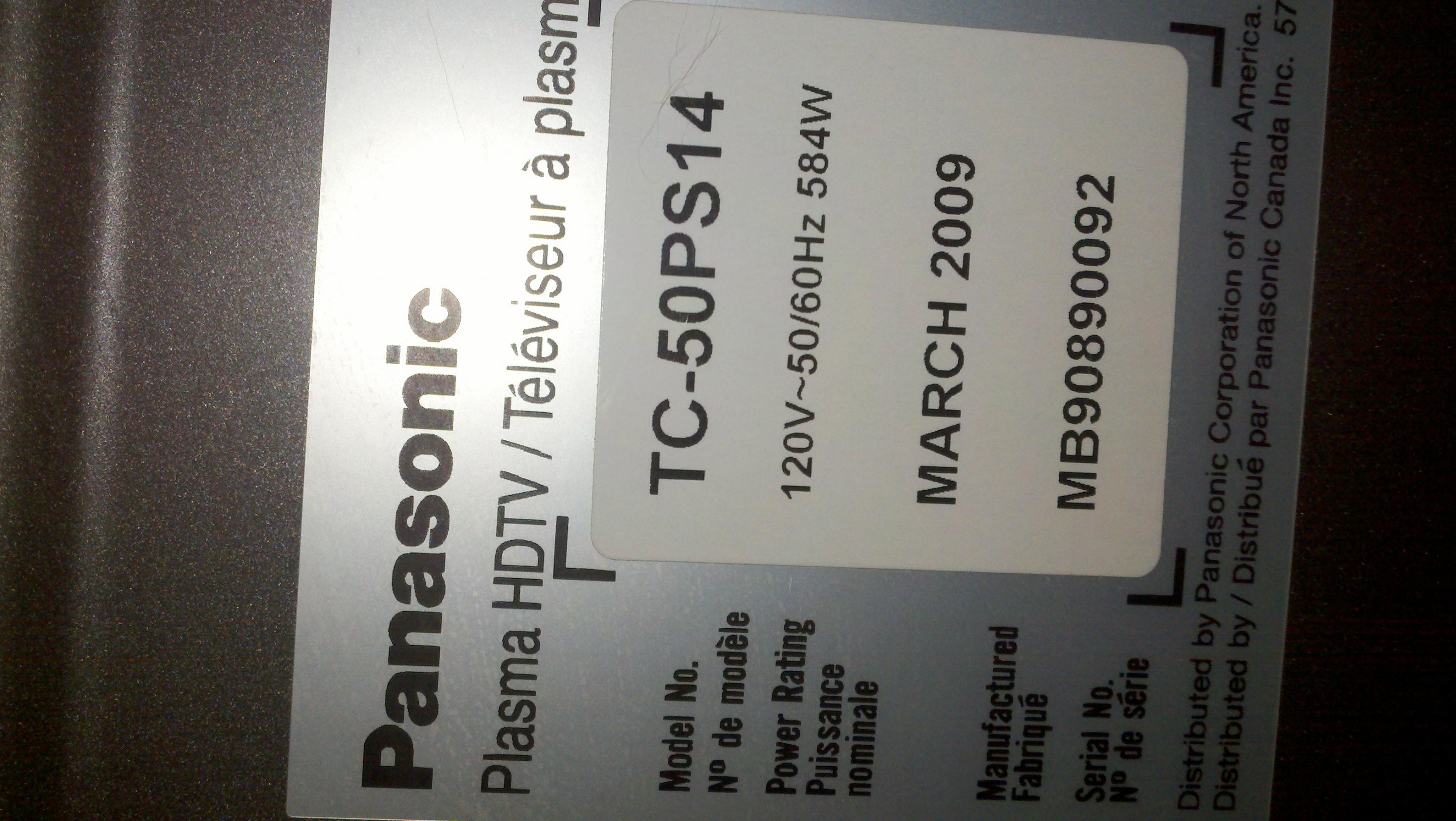

      What's the complete model number. For a TC50PS14 11 blink is a fan error.
      1 blink error 95% usually bad A board.

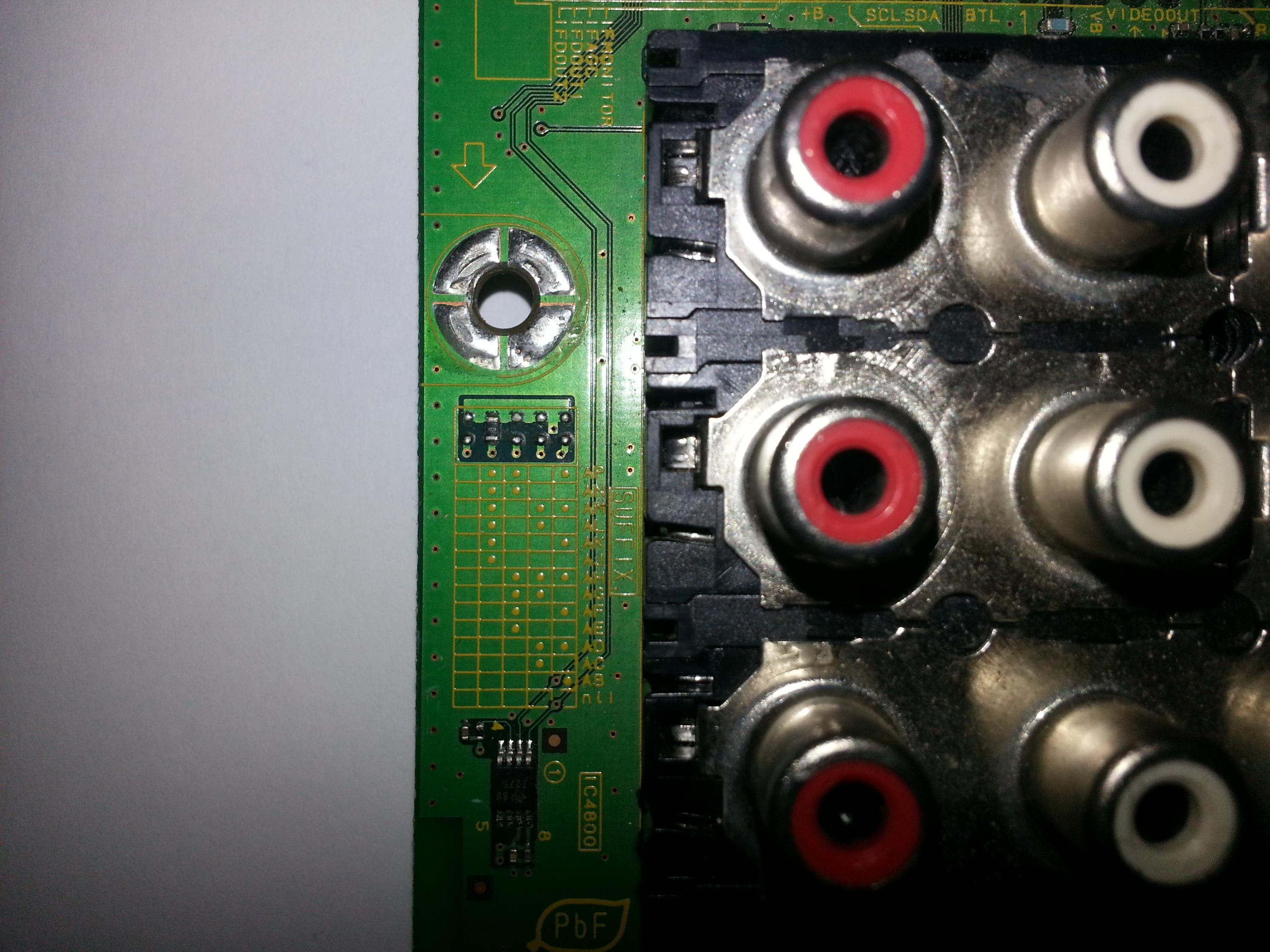

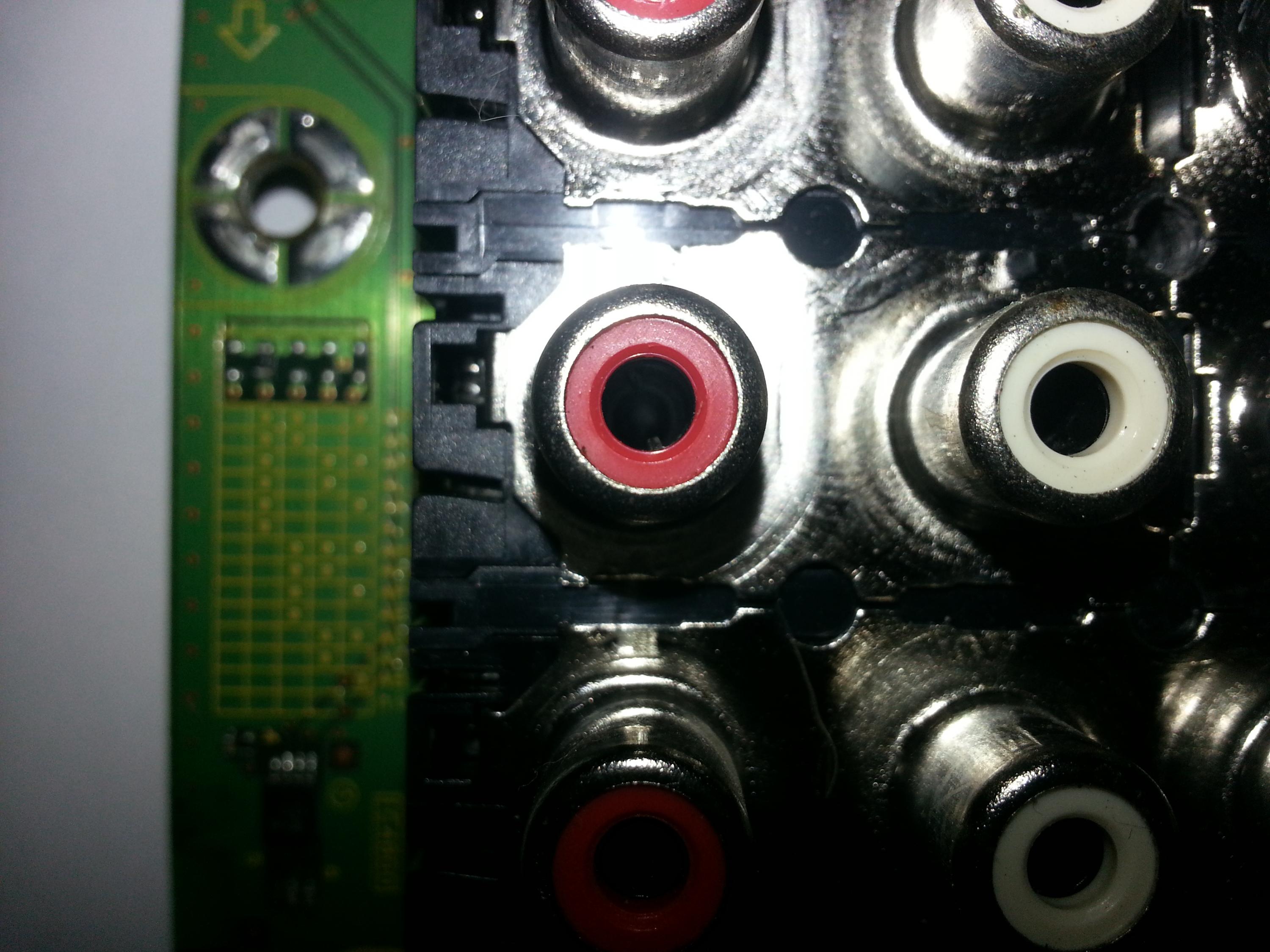

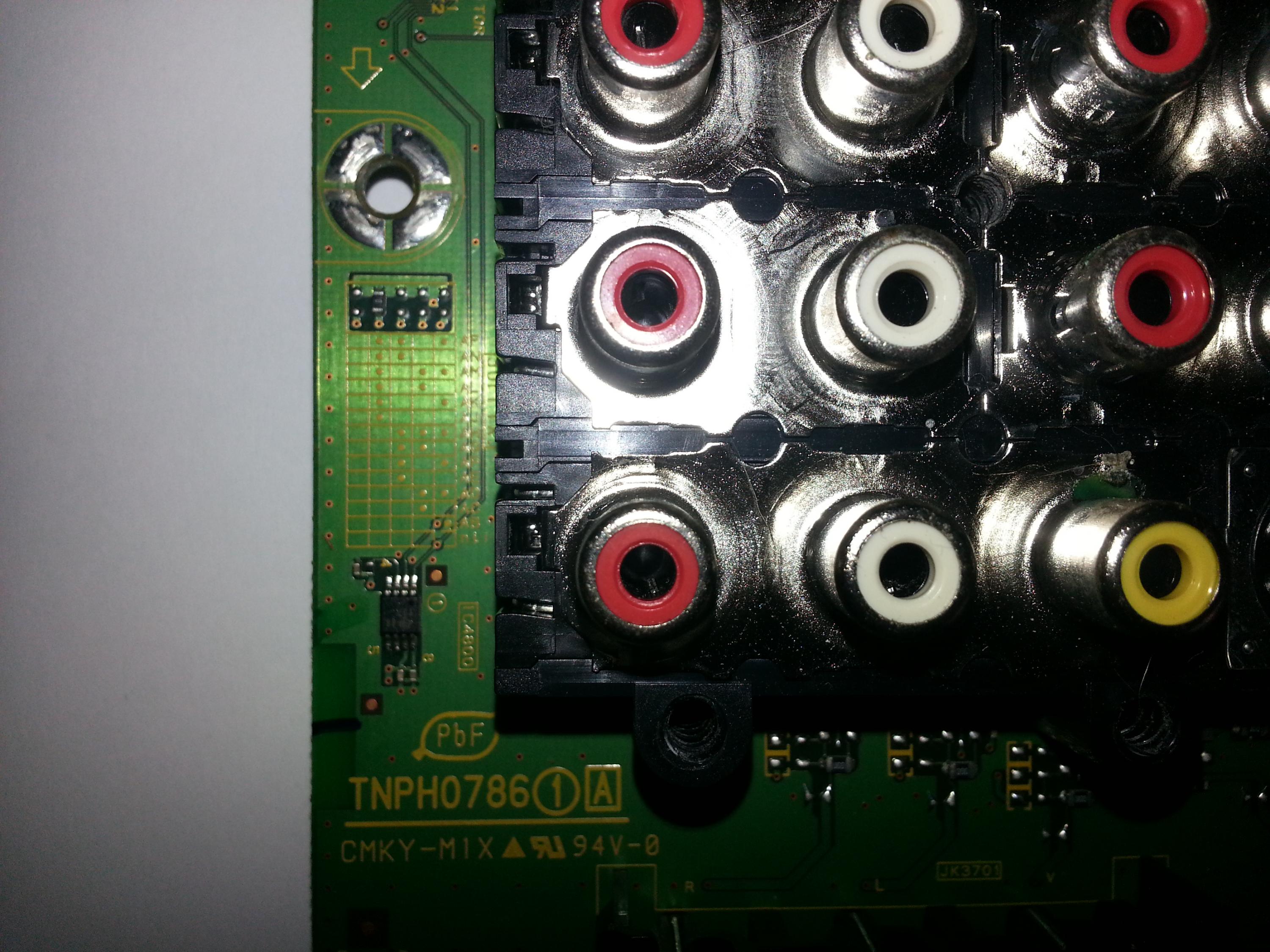

        Re: panasonic tc-50ps had 11 blinks changed A board now 1 blink
        suffix match ....11 blinks stopped after changing a board now only 1 blink over and over... could power board be the cause? no bad capasitors visual......maybe should change all the capasitors anyway on p board?....also metal cover on a board shows some rust spots and board seams to have some water stains on it...may be it got wet? or was on back of screen pourch....i'v heard of dogs peeing on tv's...guess i should send the a board back?....attached photos of both boards
          board that got wet was the original not the replacement
            I'd have a look at the original board. All fans spinning? Power to fans? Feedback signal from fans OK?

              fans never come on...unplug tv ...plug back in ....hit power on front....hear clicks....led stays on for a few ....then blinks 1 time over and over ,....no fans ever spin

                  i do have a meter...15v from p board is for the fans ?
                    Quite probably... Check if 15V goes to fans on red/black.

                      both boards never spin fans...both bad fans ...odd?

                          ok....fans ....first plug in turn on 0v on red wire..unplug ...plug in get 3.8v on yellow wire for 3-4 seconds then relay clicks and goes to 0v
                            Anything on red wire? Yellow wire is detect. You can run them briefly when unplugged from a 9V battery.

                              fans work fine ...never any power on the red wires...just the yellow...why is there a yellow wire...slower speed?
                                Yellow wire is error detect, tells main board if fans are running.
