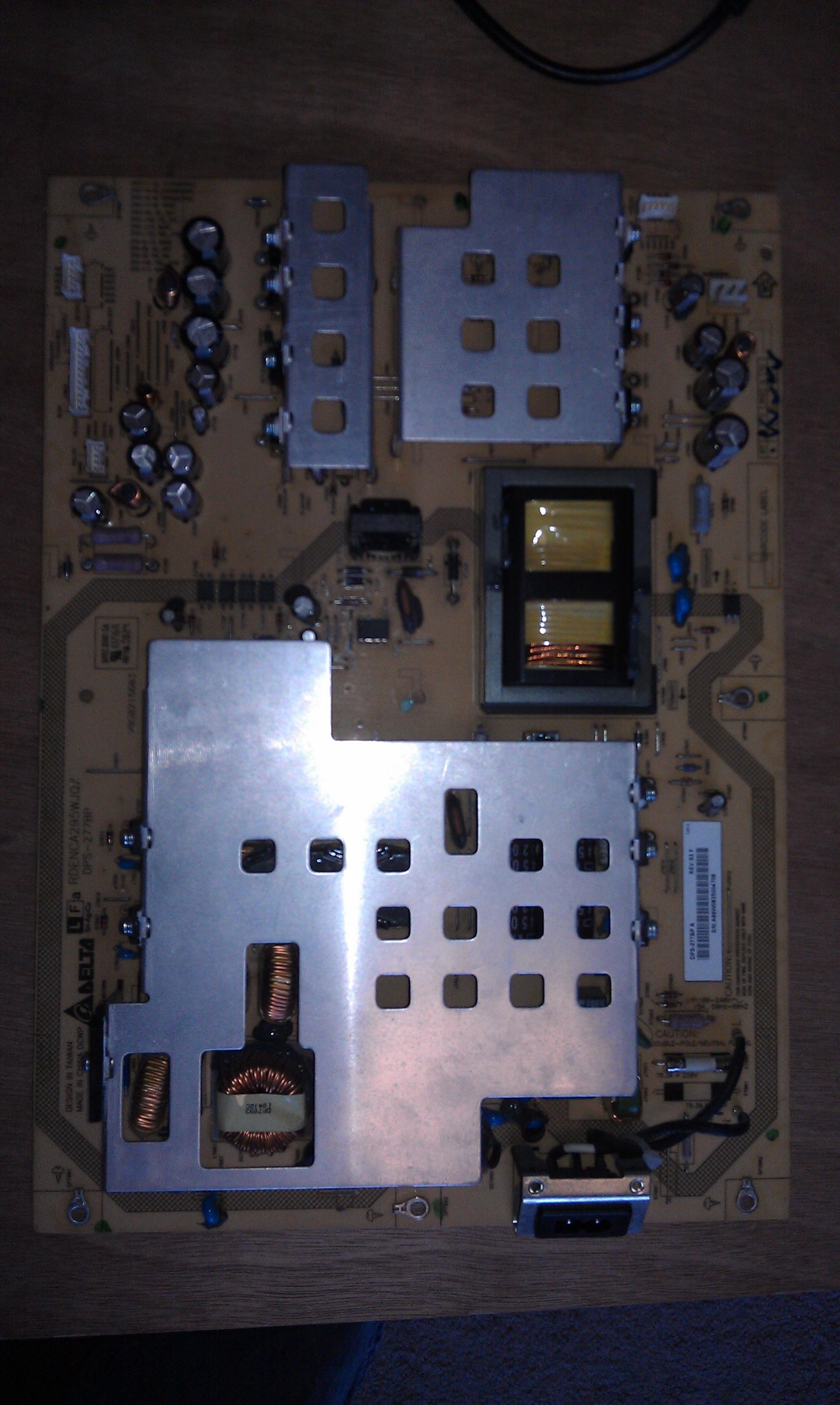

    I took the Power supply off so that I could examine it for burn marks, etc. After not seeing anything, I put it back on, turned on the TV and now I am getting the power light flashing three times and the OPC flashing once, which according to the service manual means:
    Initial communication from the main CPU is not received.
    (After canceling the reset, request for the monitor model No.
    is not received.)
    Communication line failure or main CPU start-up failure.
    If I unplug the inter boards I continue to get the same main CPU start-up failure.

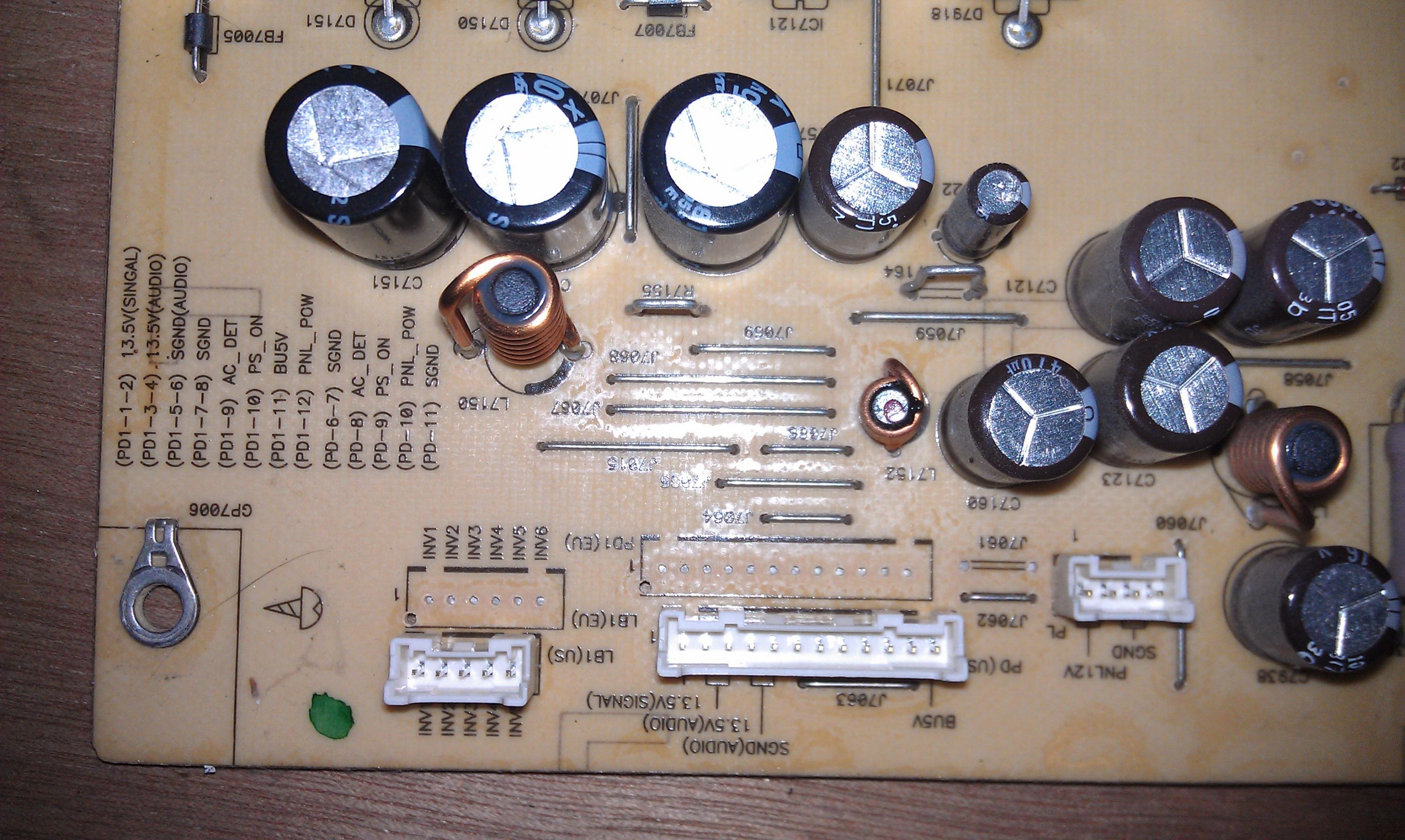

    I have attached a few photos of the power supply as a starting point, please let me know if any other photos would be helpful.

          I have a Delta power supply in my VIZIO. It's got bad caps. I tried the "hair dryer" trick and it temporarily got it up and running.
          Do you have a multimeter? Test all pins on the connector that has 12 pins and report the findings. Test once in while in stand by and then again while trying to power it on.

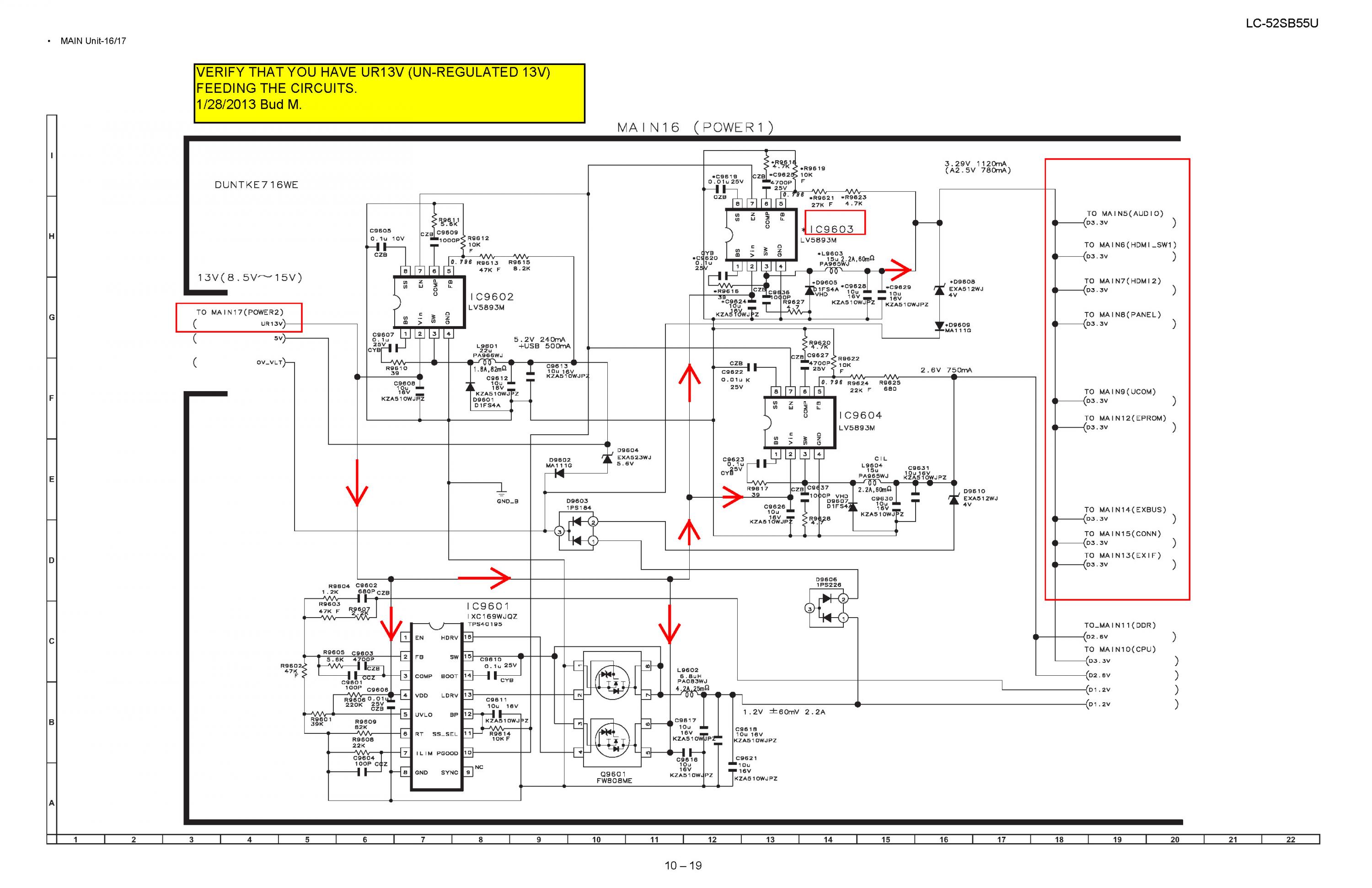

                      Here is the service manual: https://docs.google.com/file/d/0B3xF...JOMWhwYkU/edit
                        Re: LCC5255U going to error standby
                        OK, I studied the diagram, see the sch where the D3.3V is generated as I had redlined. Check and see if you do have UR13V feeding the ciruits or not, check the buck regulator switching circuit runs by IC9603 (LV5893).

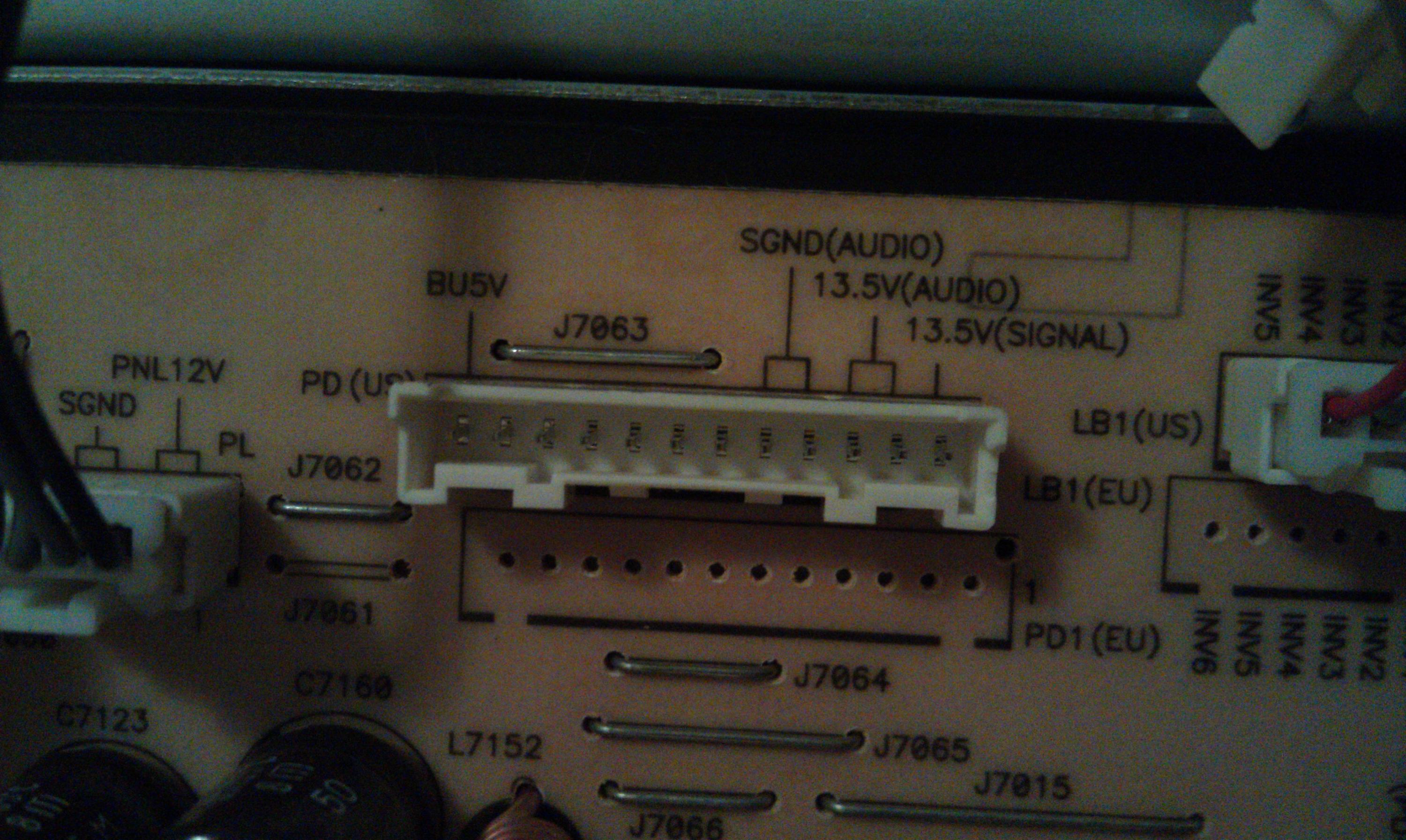

                          I have attached a photo of the 12 pin connector. Working from the photo, here are the measurements from left to right:
                          4.99
                          0
                          0
                          0
                          3.158
                          0
                          0
                          0
                          0
                          0
                          0
                          0

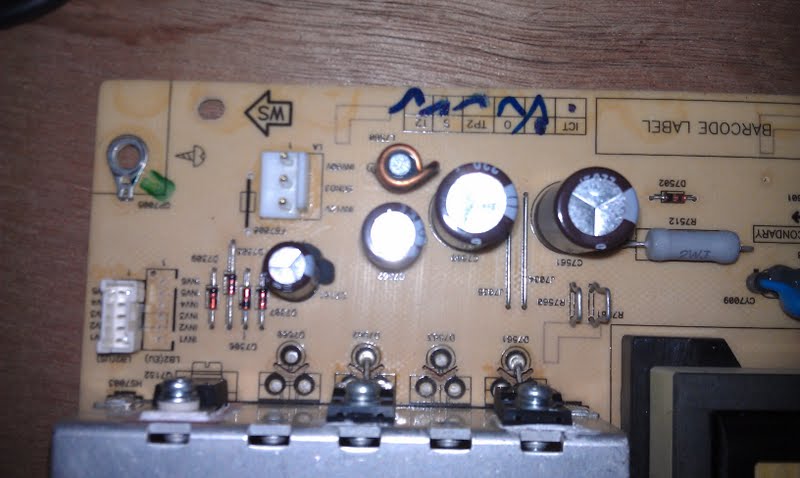

                            Can I get brighter pictures of the whole top side of the power supply board, and four 1/4 sections of the board as well, same for the bottom side of the board? I need to find out how the 13V is generated.

                                I appreciate Budm's time and am attempting to follow the schematic he provided. However, I am not experienced so please be patient while I figure this out.

                                  Ok, I understand now (to a degree) why I initially could not read 13v off of the 12 connector. I had unplugged the connector in order to access the pins which must have cut some sort of signal. While i do not understand more than this at the moment, at least i can now read power out of this connector by forcing the psu on and probing through the top of the connector without disconnecting it.
                                  I will now move onto the main board.

                                    I believe that I have verified at 13v is feeding the circuits. I checked the following pins and found almost exactly 13.06v on each one:
                                    IC9601 - pin4
                                    IC9602 - pin 2
                                    IC9603 - pin 2
                                    IC9604 - pin 2
                                    Q9601 - pins 5 & 6
                                    I am still looking into the MAIN5, MAIN6, etc. pins...
                                      If you look at the diagram I red lined, you will see the 3.3v output (on the right side of the L9603) at the IC96023, you can measure it across C9625. The circuits need that voltage.
                                      @RC-Thanks!

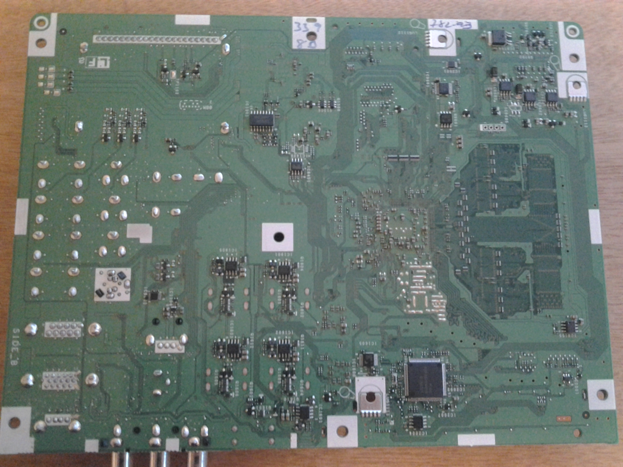

                                        I am having a difficult time finding C9628 or C9629 ( I am assuming that these are very small capacitors not labeled on the PCB); however, I did manage to test the leads for L9603. It appears that one lead measures around 1.990v while the other measures around 1.945v. Sorry, I cannot tell which lead is facing IC9603 at the moment.
                                        Either way, it appears that one of these leads should measure 3.3v according to the schematic. Is this correct?
                                        In case it is helpful, I have uploaded front and back photos of the main board.
