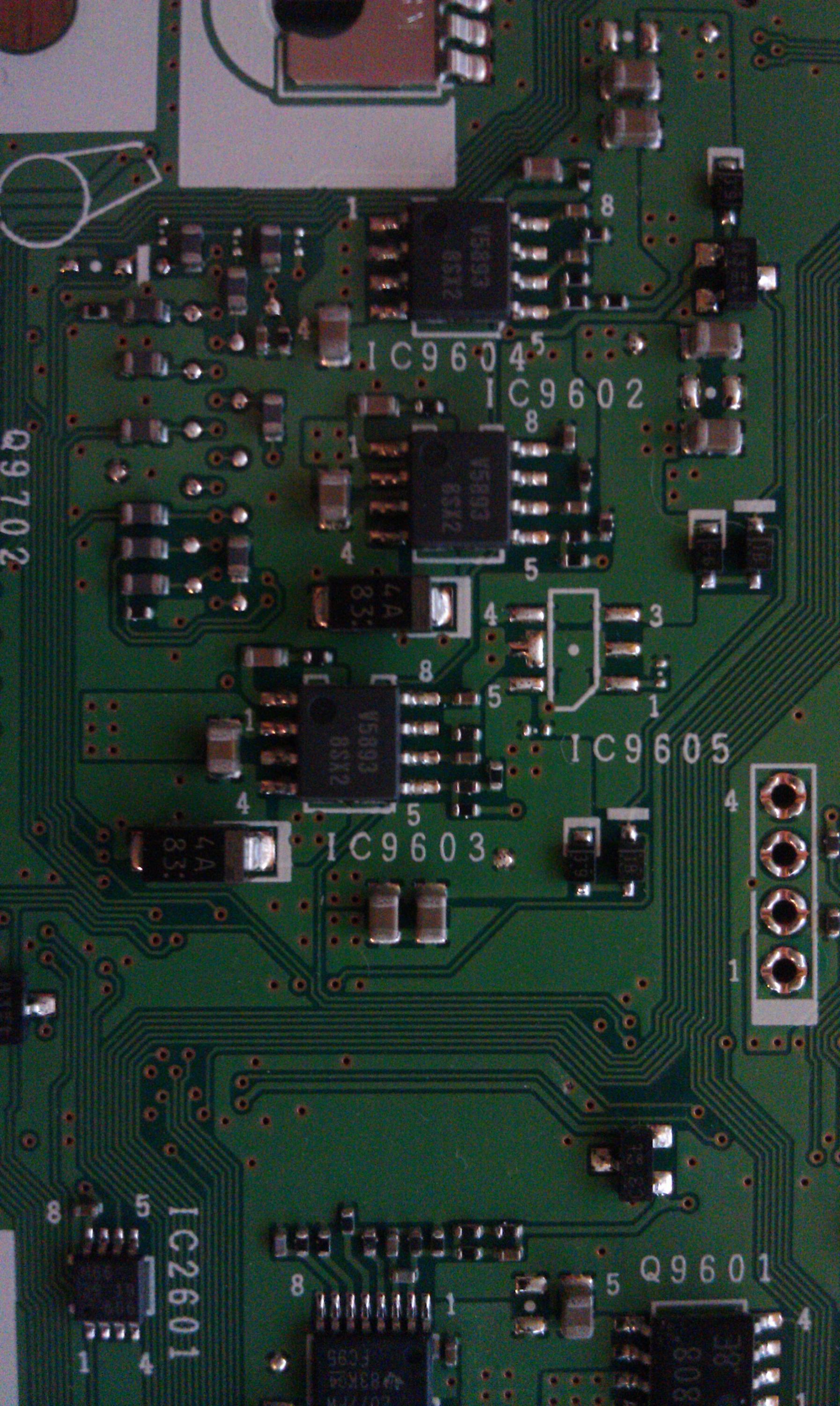

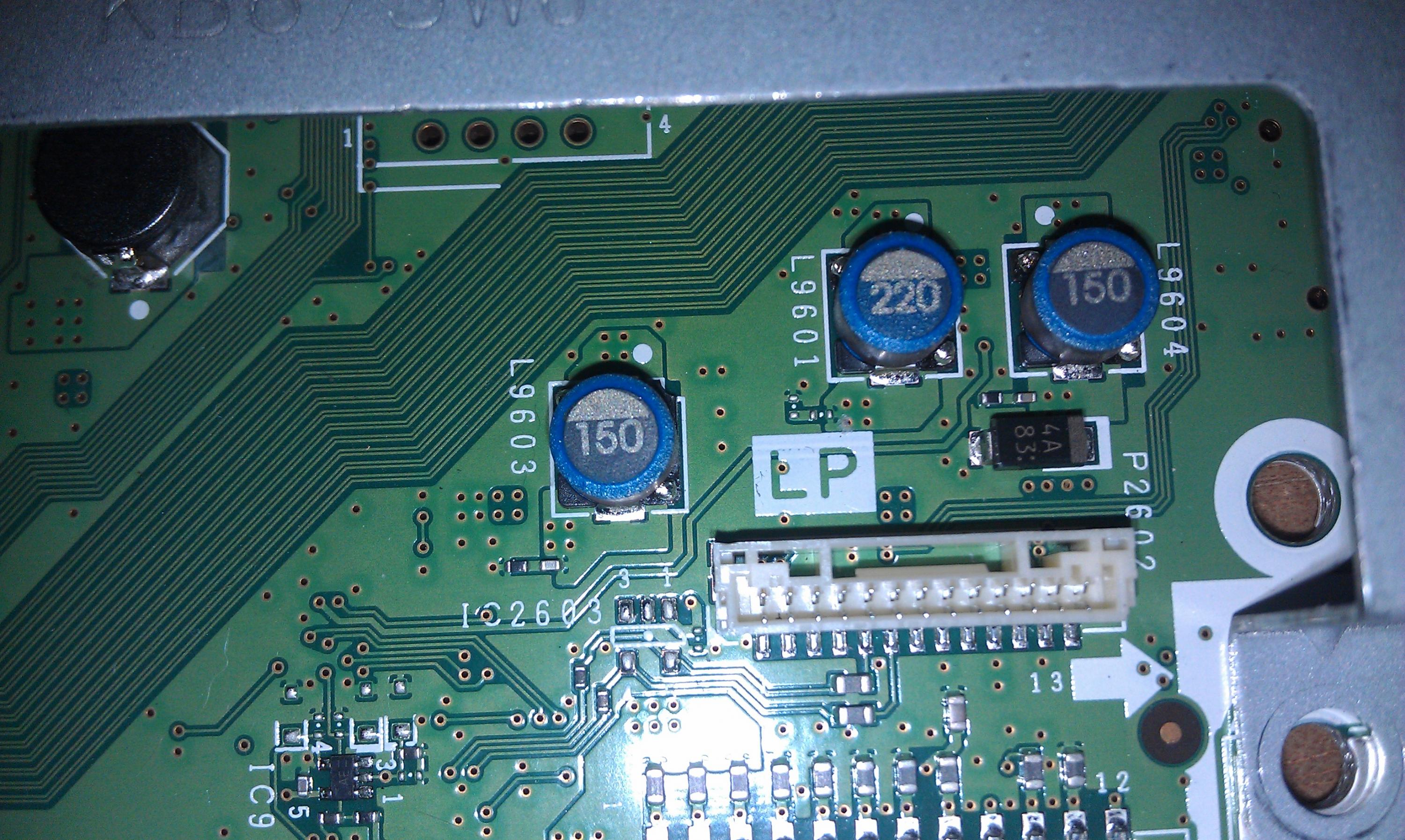

          Here are two photos of 9603, front and back. Sorry, I am still trying to wrap my head around your other requests. I will try to move faster, though I am clearly still learning here.
            Re: LCC5255U going to error standby
            OK, if you look at the PDF in post 12, you will see that the 13V is also used for other switching regulator circuits.
            You need to check the DC voltages on both ends of (Black probe of the meter to the chassis)
            L9601 which is for 5.2V power supply
            L9602 which is for 1.2V power supply
            L9604 which is for 2.6V power supply
            If the circuits match your TV, then you should see those voltages as listed above, then we know that we are using the correct diagram.

              Here are the voltages. It would appear to be the correct board:
              L9601 = 5.24v / 5.24v
              L9602 = 1.217v / 1.243v
              L9604 = 2.65v / 2.622v
                So that means you do have problem with 3.3v power supply IC or components around it. Other power supplies are putting out like they should.
