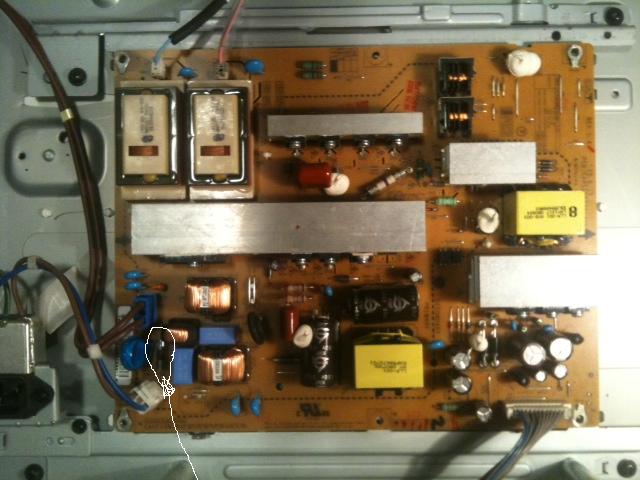

                  here is the pwr board with the blown 3a/250v fuse circled.

                      OK, the replacement board is about $42 on EBAY, by the time you have to replace what is/are shorted out (MOSFET's, rectifier, blown resistors, IC. etc.), you can easily spend $20 on the parts more or less if you want to troubleshoot it down to component level. Something for you to think about.

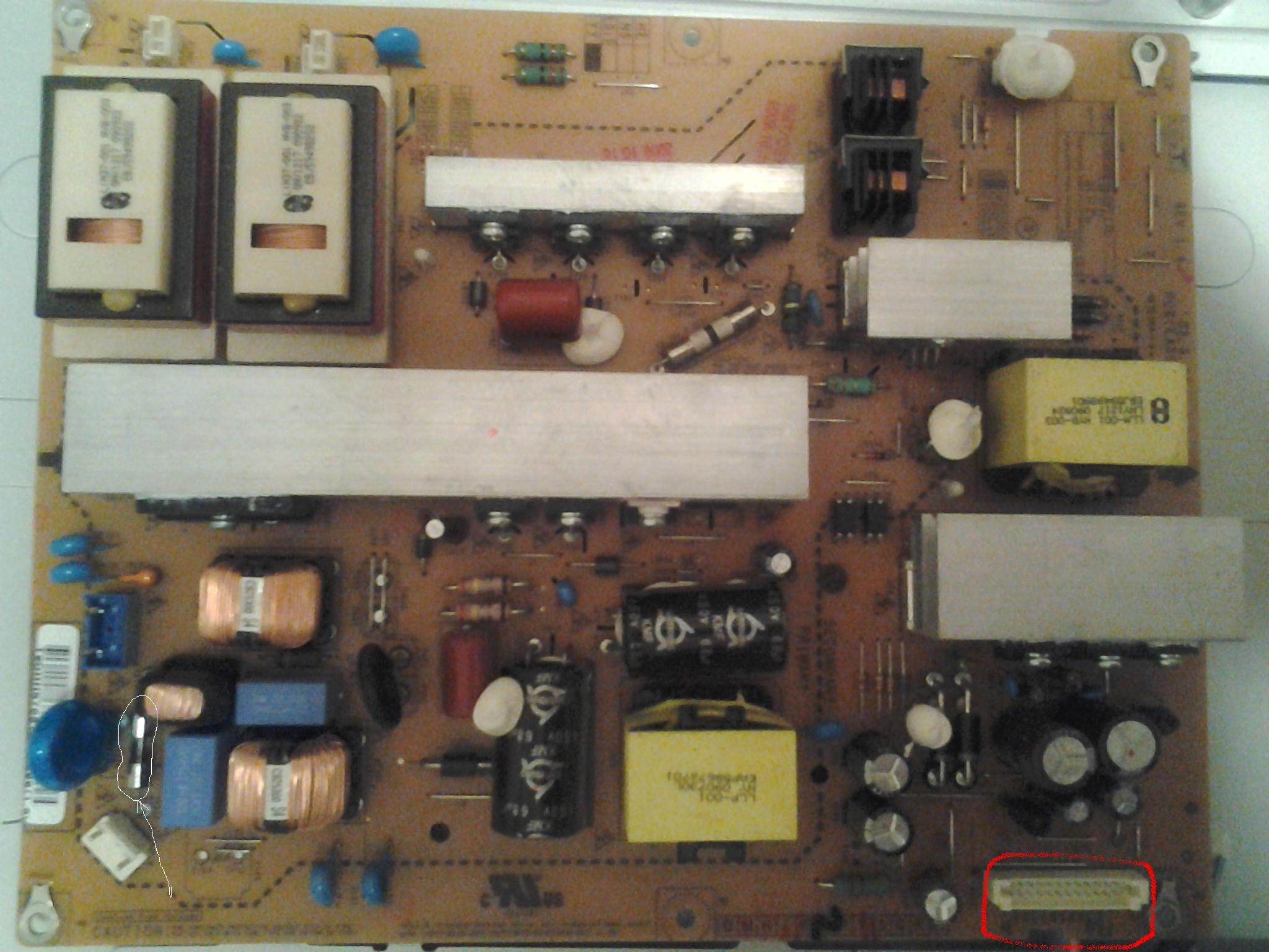

                        here is a larger hopefully clearer picture of the power board with the blown fuse I replaced and it blew as soon as powered up.
                          Re: 37lh20-ua lcd tv
                          Not clear pictures, cannot read the printing of the designators of the parts, labels of the connectors, also need CLEAR and FOCUS of the whole back side and four 1/4 section of the board so we can trace the connection to be able to give you the test points.
                            Here is a simple test.
                            I took your "clearer" picture and put a red box around. Without looking at your physical board and looking only at the picture I re-uploaded (with no changes in resolution), please list the writing inside that red box.
                            Now do you understand what we have to work with?
