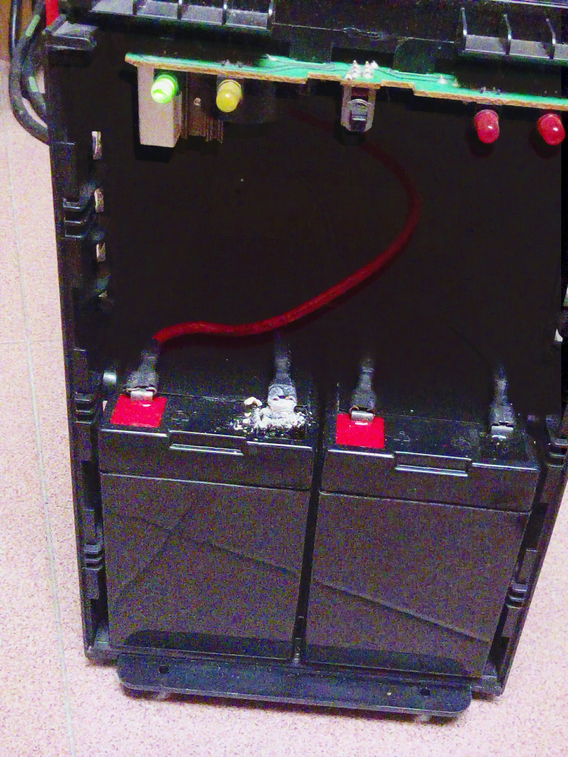

    Problem description:
    My UPS requires new batteries every ~3 months; in this time frame, an average of about 5 to 10 power flickers or short power interruptions (< 2 minutes) occur. After an average of 3 months, a new pair of batteries begins to fail to keep the UPS up during any flicker or power interruption. The load it powers is a single computer/workstation running 24/7 with a continuous consumption between 200W to 300W.
    UPS model:
    The Atlantis 1001 is a non-inexpensive (~120€ back then) home/office offline UPS, rated 1000VA, 600W, designed for two 7Ah 12V SLA batteries in series, as per its user's manual. The UPS doesn't run periodic battery tests, and just keeps a float charge while on standby.
    Troubleshooting:
    I opened the UPS while plugged to the mains, powered on, and powering the computer. The float voltage is 26.99V across both batteries, partitioned in 12.85V on the left battery (2.14V per cell), and 14.14V on the right battery (2.35 per cell, see picture). While I took the measures the UPS was not recharging the batteries, these are the float voltages.
    The left battery has a corroded negative terminal.
    The temperature inside the UPS case feels about 30°C (86°F), approximately. The case has a fan, but it is normally off and spins only while on battery power, so the inside remains always warm.
    Interpretations:
    The UPS is designed for 600W, or 600W / 24V = 25A on the batteries (~3.5C). Even with half the load (300W, 12A, ~1.7C) the current on the batteries is quite high. I always bought cheap batteries from eBay, so I imagine this is an overload regime. However, very few power losses occur during the 3 months that a new pair of batteries endures, so I imagine this doesn't justify the short lifespan.
    AFAIK, the float voltage of 26.99V across both batteries is a good value per se, but badly partitioned across the batteries, so that 12.85V causes sulfation on one battery, and 14.14V causes electrolysis on the other.
    The warm temperature also doesn't justify the extremely short lifespan of the batteries.

    Re: UPS ruins batteries every three months
    i could be overcharging them,
    or they could be shit batteries.
    those batteries come in different types.
    you have ones designed to be trickle-charged forever and only discharge ocasionally at reasonable current - for ups/ backup lights etc,
    and you have ones designed to be constantly charged and dumped at high current for use in electric vehicles and such.
    i think if you use the type intended for golf carts, wheelchairs etc, they wont like the constant charging.
      I also have a 1000W UPS that ate its batteries in a year.
      I didn't think to do battery tests when they were working, but need to make sure that the UPS does not charge the batteries past 20.7V, which would be 27.6V for your system. It is okay to go higher but only for a short period of time.
      But back to the reason why for doing battery tests - since you have more than one battery pack, the packs need to be identical and balanced. If one is weaker than the other, then the whole set is as weak as its weakest cell. Agreed that it's possible you have one poor quality pack that ruins it for both. Ideally there's a balancing circuit just like for lithium ion packs... but for lead acid, they don't explode as violently as lithium ion when they're abused...
        Further tests:
        I unplugged the two batteries from the UPS; in open circuit, the corroded battery (float-charged at 12.85V) reads 2.5V across its terminals, the other battery (float-charged at 14.14V) reads 12.8V. No doubt, the corroded one is broken.
        I pried open the good battery; looking thru the cell caps, there's a white sponge inside each cell (fiberglass?) so these are non-flooded SLA batteries, which require a slightly higher float voltage than the flooded ones. The sponge looked dry so I added ~80ml of tap water across all cells, or 13ml per cell.
        Now I'm charging the battery with a bench PSU at 18V, 0.6A to gassify the liquid; I read that forcing gassification can clean the lead plates and increase conductivity.
        So, these batteries dried up too quickly in just three months, with an apparently correct float voltage and an acceptable temperature inside the UPS case.
          I've had very poor luck dealing with these AGM/SLAs after they've failed. After watering them they last a little while longer but will fail again soon after, usually shorting out a cell.
          I gave up on my UPS for now after tossing the battery packs, and really need to think about
          a BMS for SLA packs as well...just for longevity.

            I'd also have to add corrosion at a terminal of a SLA is a bad sign...
