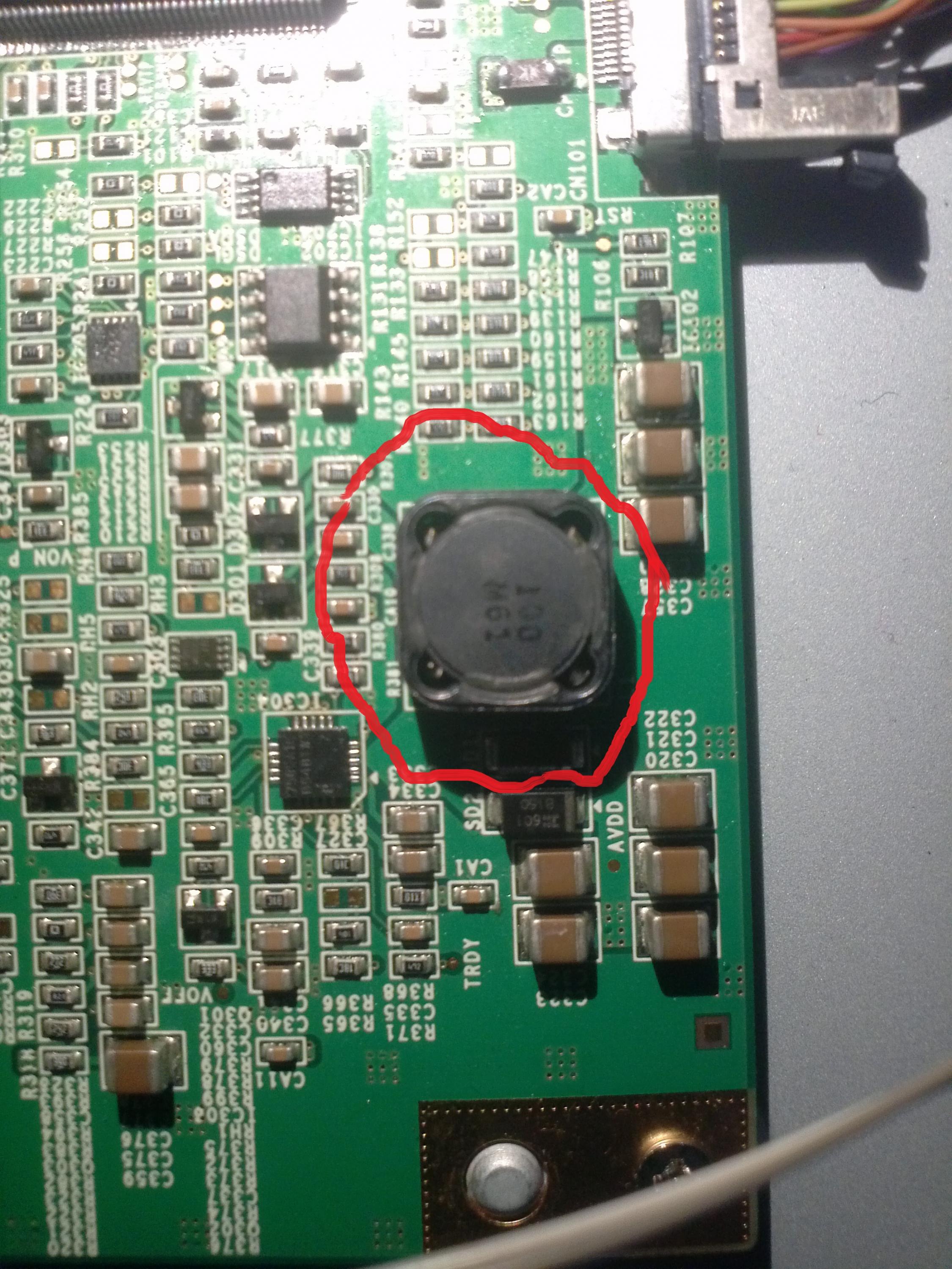

                    Using the ice-spray I found the bad components in my TCON board.
                    It's marked with L1 and it seems to be an inductor (rounded in red in the picture).
                    The mark on the body says "100 M61"..
                    I'd like to try to replace it but i really don't know wich is the specification (100uH?? or what??)
                    Could you please help me in identifying it?
                    p.s.: Are there specific instructions on how to desolder the old and solder the new inductor? I'm a newbie

                      I think you really need to pinpoint cooling to be sure, I have some doubt that the inductor is bad, you can check the resistance to see if it is open when it is bad. You may want to roll a tube card board around the inductor then spray other components close by to see if you get the change in the circuits.

                        I used a Q-tip (and put it in contact with the inductor) and found it is for sure the fault component.
                        Can yoo give me some advice in order to understand which is the right value of the inductor? Is there a way to know it by testing the component with a simple mulimeter ?
                          Re: Sony KDL40S2000 TCON board issue...
                          I know of no reliable inductance testing method using a multimeter. You will probably have a much easier time finding a new TCon board than identifying that inductor. I am pretty surprised that the inductor is the problem, as intermittent inductors, while not impossible, are EXTREMELY rare. If you are able to identify the value of the inductor, your next challenge will be to find a replacement that will fit in the alloted space. If you choose to replace the TCon board, the part # I show in my records is 1-789-499-11.

                            Is it possible that the cold transferred to a nearby part? Have you tried "not" touching the inductor, but nearby components?

                              Yes, I've tried to touch nearby components...No other components when get cold (using the freezed Q-tip) solve the display problem..

                                I've done a second check on the TCON and it seems to be the fuse.
                                It was the component that the tech assistance guy replaced on the TCON.
                                By freezing it the problem solved..Is it possible??
                                As far as I know, the fuse can work or not..it seems really strange to me that if if I freeze it the display problem disappear..
                                How can I find the fuse value (the TCON BOARD is marked 400WSC4LV0.4)??
                                  Fuse is either open or show less than 1 Ohm resistance. You can check the resistance when it is heated and when you cool it.
                                    If it was the fuse accidentally replaced with a auto-resetting fuse, I could see this happening.
                                      from the looks of it thats what happened.so too low value and its tripping or something bad(mlcc?) on that line?
                                        Just too low of a value, and it gets hot. As it gets hot it increases in resistance until the T-con doesn't work properly. Proper fix is to use a real SMD fuse.
