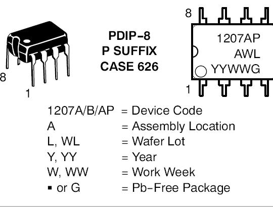

    Okay I see that one. It's right next to the cap I said was slightly swollen. I've found em for around $125 US
      #42
      Re: Philips 50PF9631D/37 - 6 Red Blinks on Front LED
      What's the part number on that IC?
      IMO, $125 is steep -- this board can be repaired for -much- less.
      • Scuse
        • Jan 2013
        • 50
        #43
        I agree it's very steep. The top of the IC read: 1207P CPEY 0605G

            No info on that chip . Are you certain about that part #?
              I think this is very close to what it may be.
              1207P
              CPEY
              0605G
                #47
                Great -- looks like it. I'll try and post back later, lectures now.
                  #48
                  The pin DRV should connect to a MOSFET on the heatsink -- does it?
