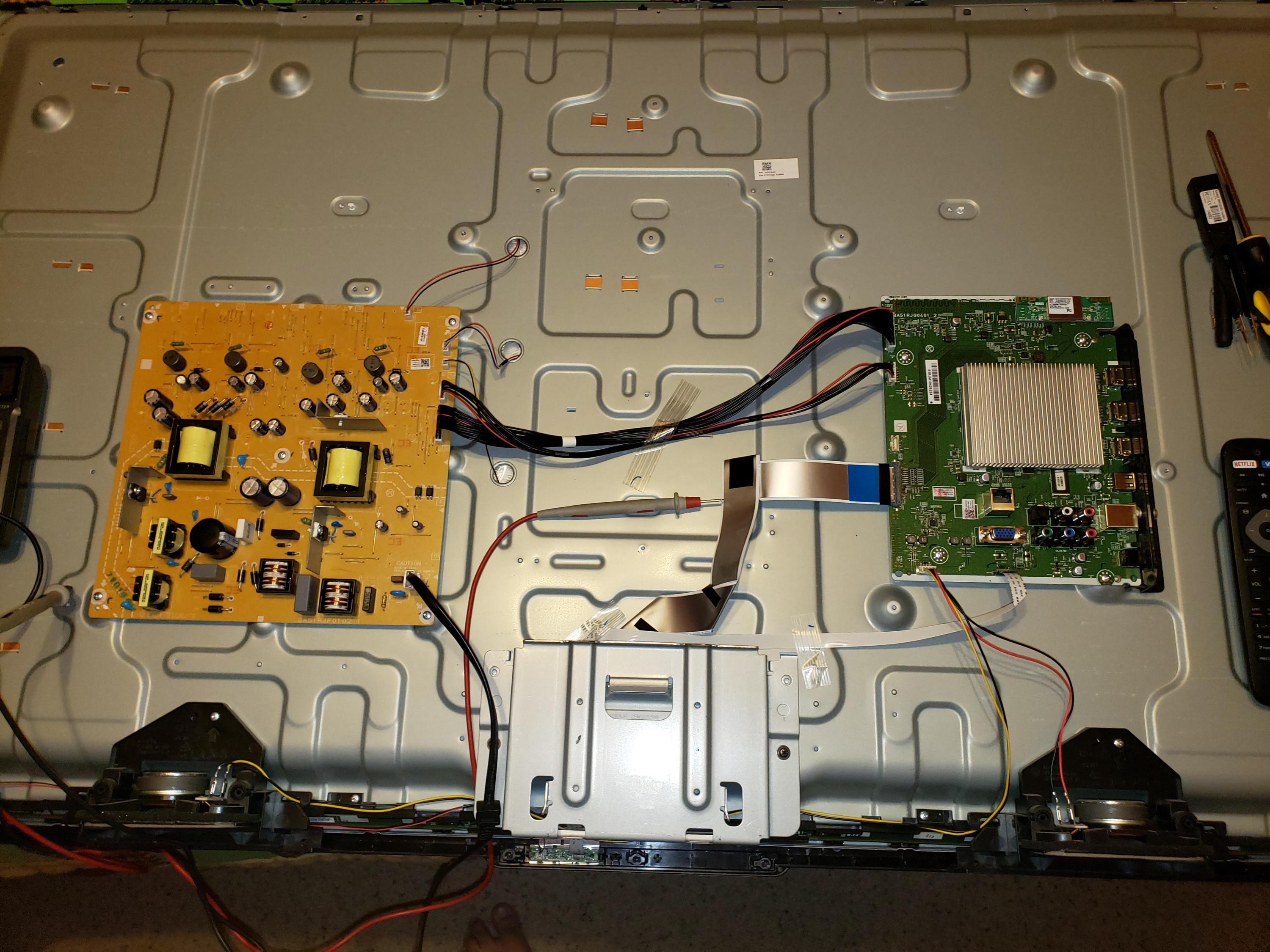

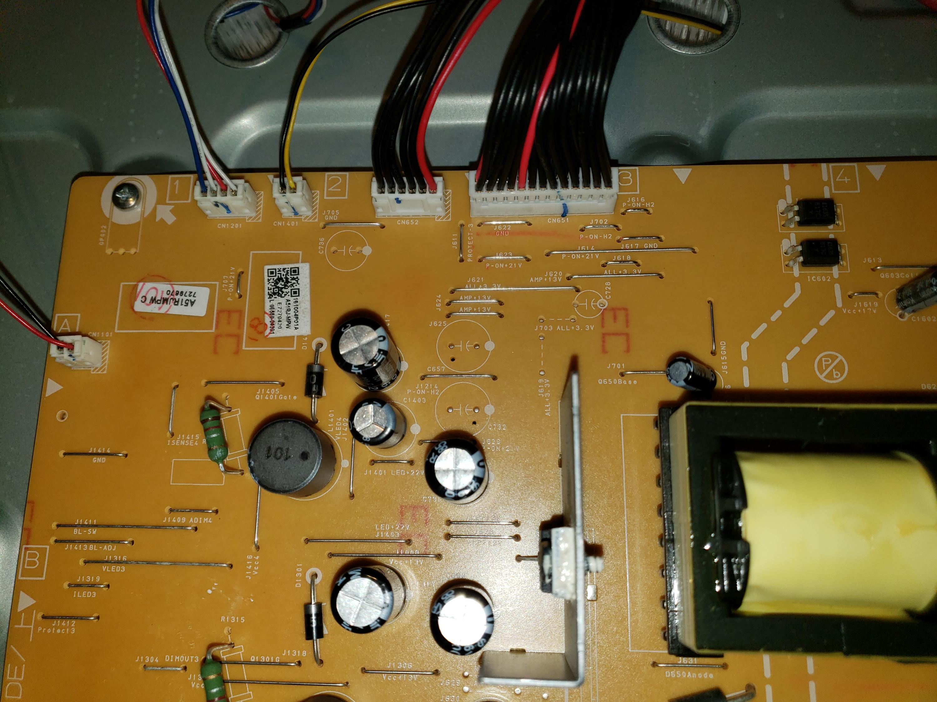

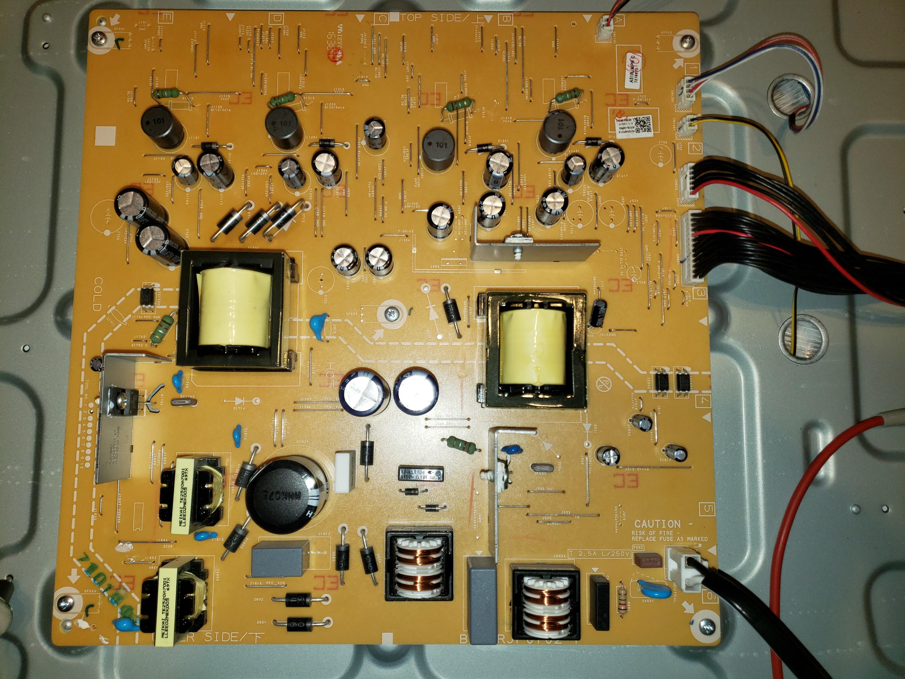

    Hi
    I have this Philips 55PFL5601/F7 TV, seems to have all the right voltages including the PS-ON+21V (20.967V) and P-ON=H2 (3.3V) but front LED is not lit, no response to remote and not turning on.
    The keypad connects to front IR board, then from IR board, there is a ribbon cable that goes to main board. Haven't tested that link. But, with PS-ON+21V high, TV should be on, right? I'm not getting picture, backlight or any activities.
    I read some posts about C3214 or so.. but doesn't seem applicable.
    Help!

    Re: Philips 55PFL5601/F7 Voltages ok, But not turning on - No front light
    check the led it might be faulty .

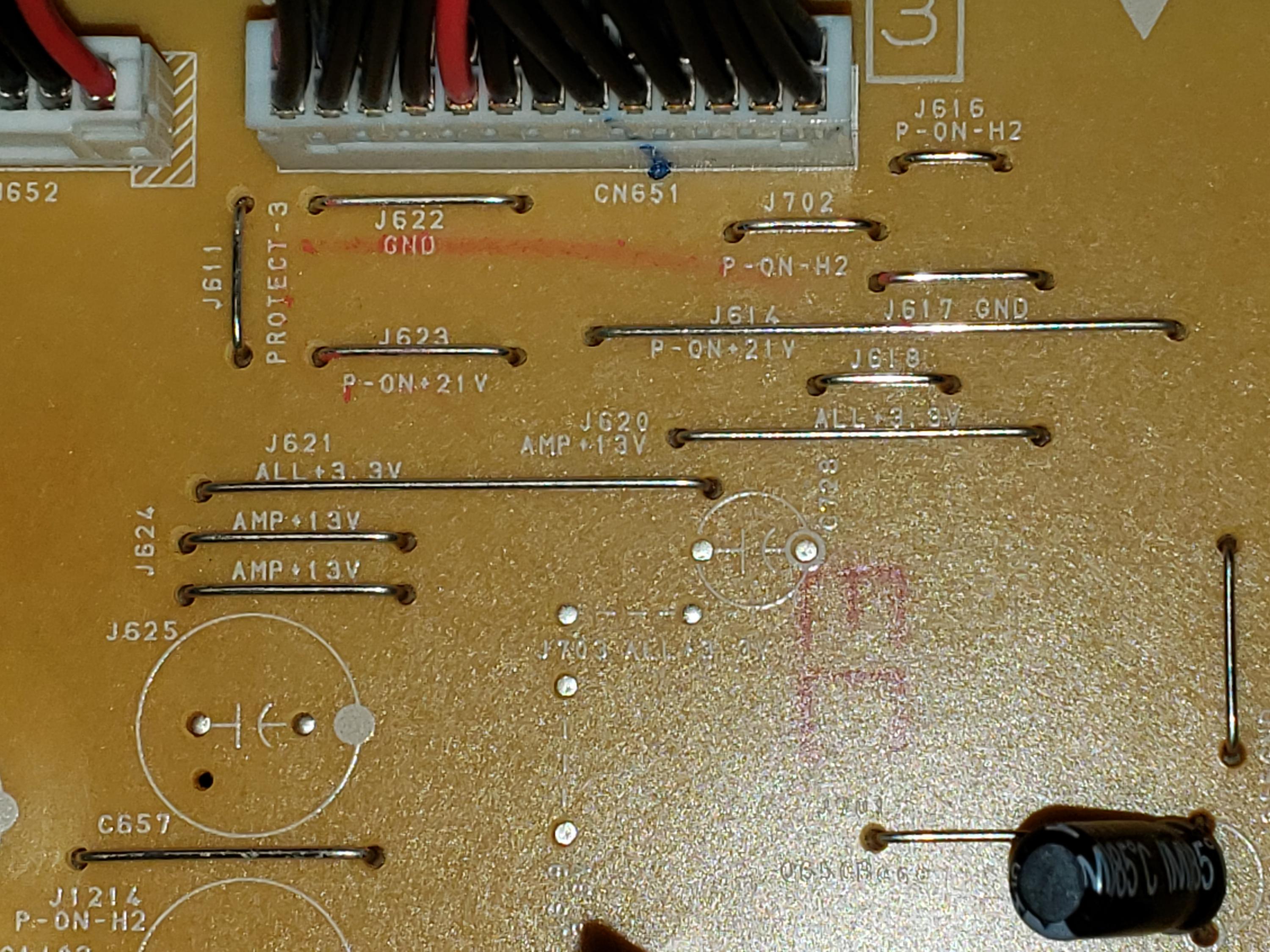

      If you have standby voltage and you have no standby light or the TV doesn't turn on, the main board is suspect. You can try freezing the flash/eeprom or heating it up but usually with no standby light, the processor is pretty dead and isn't even sending the logic control signal to turn on the LED.
      Do you have 13V at AMP+13V?
      Edit: Just noticed you mentioned P-ON goes high. Does it toggle when turned on and off?
          Yes, I have the 13V at AMP+13V. P-ON is always high, and doesn't toggle with remote or keypad.

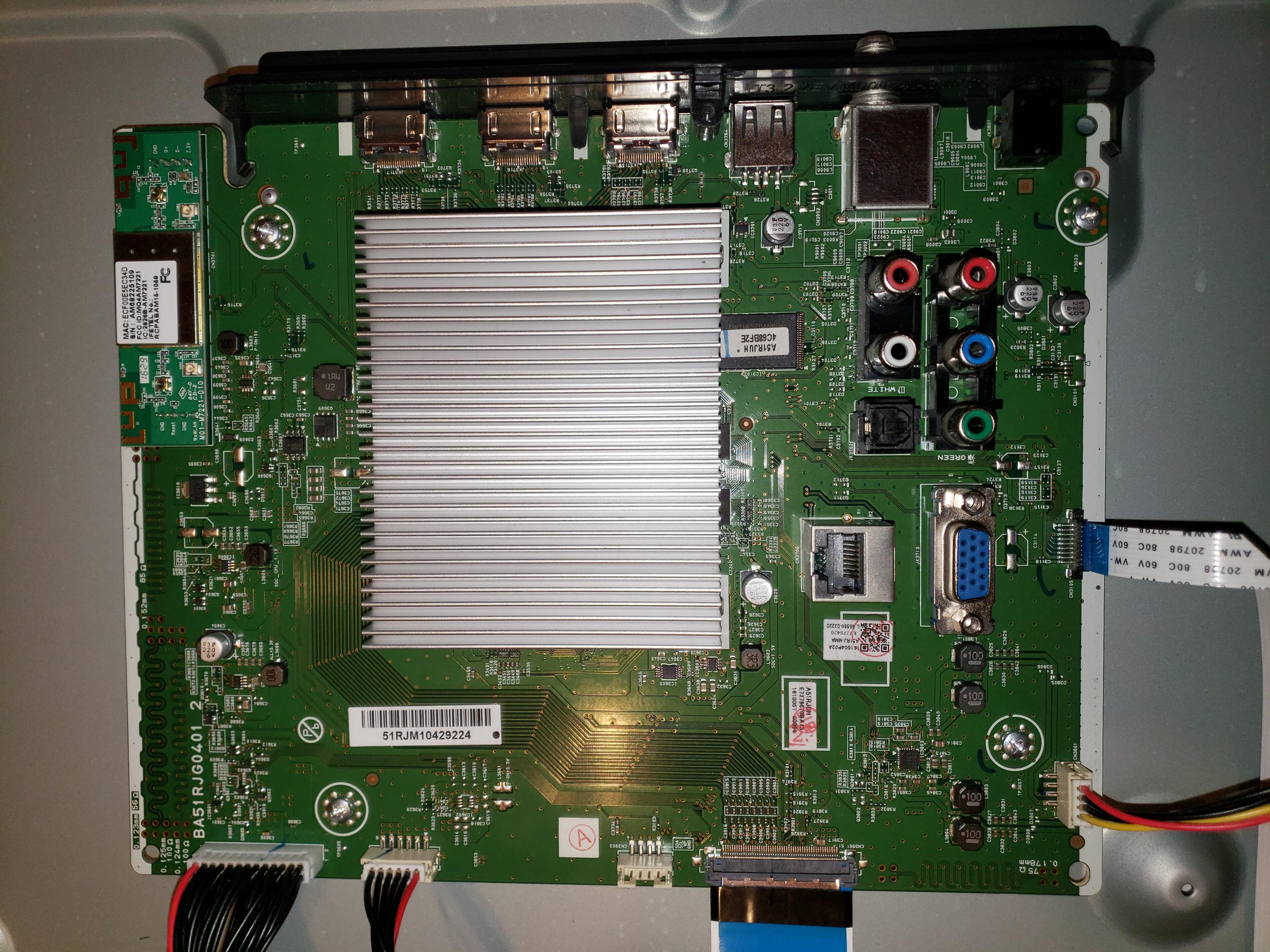

                check the 3.3V on main boards.. you have the test points of this line at the WLAN module.
                if its there 3.3V or not you need to take out the heat sink to have access to the rest under it..
                BTW can you write the label of the NAND its covered with firmware version label

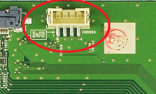

                        • jason123
                          • Oct 2015
                          • 1148
                          Originally posted by Diah
                          forget to mentioned did you check the Optical audio output if its led lids Red ?
                          this sign i used always as the set turning on.
                          Not activity on the optical audio - no red light at all
                          • jason123
                            • Oct 2015
                            • 1148
                            Originally posted by Davi.p
                            So is there an spi flash without that i download the service manual?
                            not SPI protocol, but Yes, this 2-wire serial port is on the edge of the board

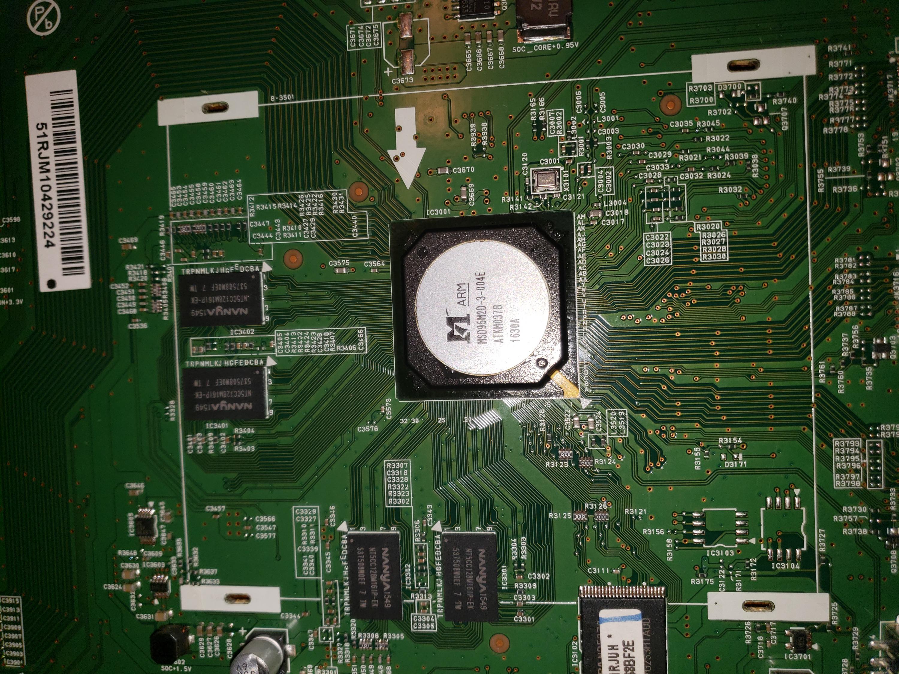

                                  -Test voltage on C3719
                                  -Test voltage on L3603
                                  -Test voltage on L3604
                                  -Test voltage on L3606
                                  -Test voltage on L3602
                                  -Read marking on IC3610 and test voltage on each pin.

                                    hi,
                                    i dont think its easy to repair this shit sandwich boards, i saw many BGA issue that under the main IC there was hole. so give try with hot air gun. if no fix then replace the boards.
                                    • jason123
                                      • Oct 2015
                                      • 1148
                                      C3719 4.92
                                      L3603 4.93
                                      L3604 1.043
                                      L3606 3.32
                                      L3602 1.47
                                      Marking on IC3610 GH16D
                                      5 V in, 3.32 V out
                                      • Davi.p
                                        Hobbist Tech
                                        • Sep 2009
                                        • 4540
                                        • Italy - Milan
                                        BAD PROCESSOR, make reflow or reballing much better reballing.
