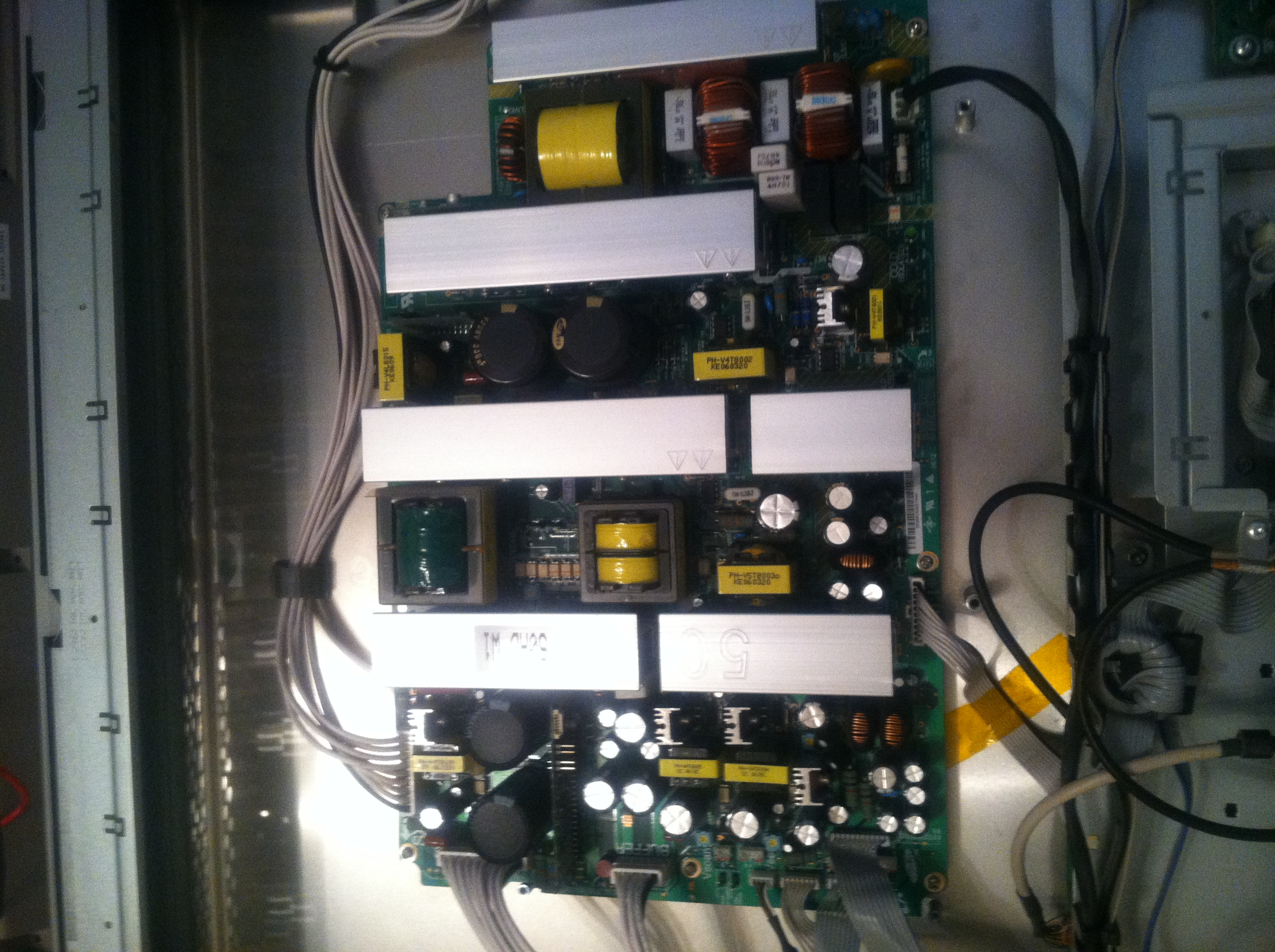

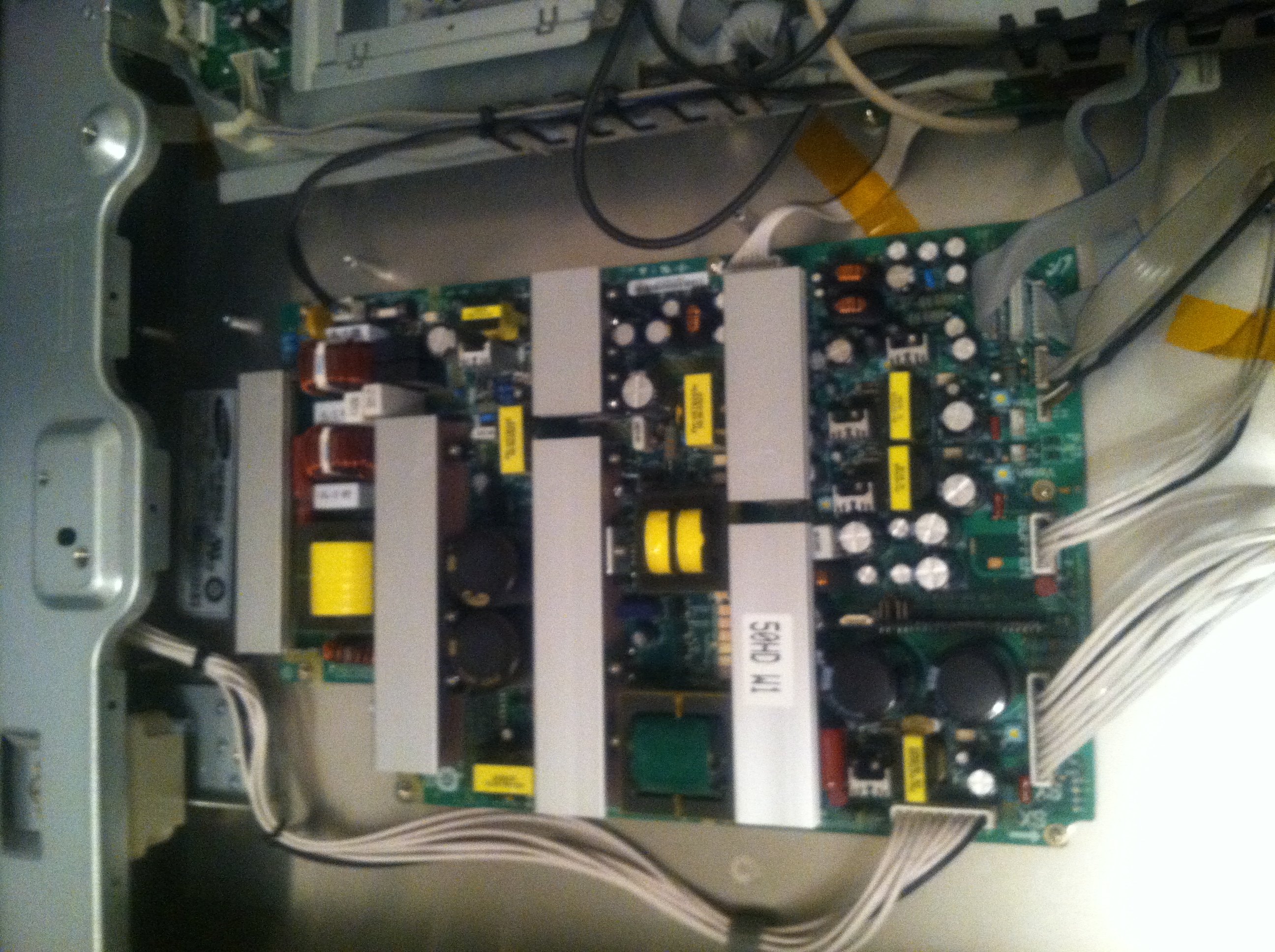

      We can help a lot more if you please post good clear pictures of the whole chassis, and then pictures of each board, front and back (in the same orientation) and close up of connectors, (max resolution 2000x2000 and 2MB) using the manage attachments button, which is found by clicking "go advanced" under quick reply.
      Examples of what is needed
      https://www.badcaps.net/forum/attach...7&d=1280167246
      https://www.badcaps.net/forum/attach...6&d=1280167246
      https://www.badcaps.net/forum/attach...4&d=1280167246
      It will be useful if you can say a bit about yourself - skills tools etc.

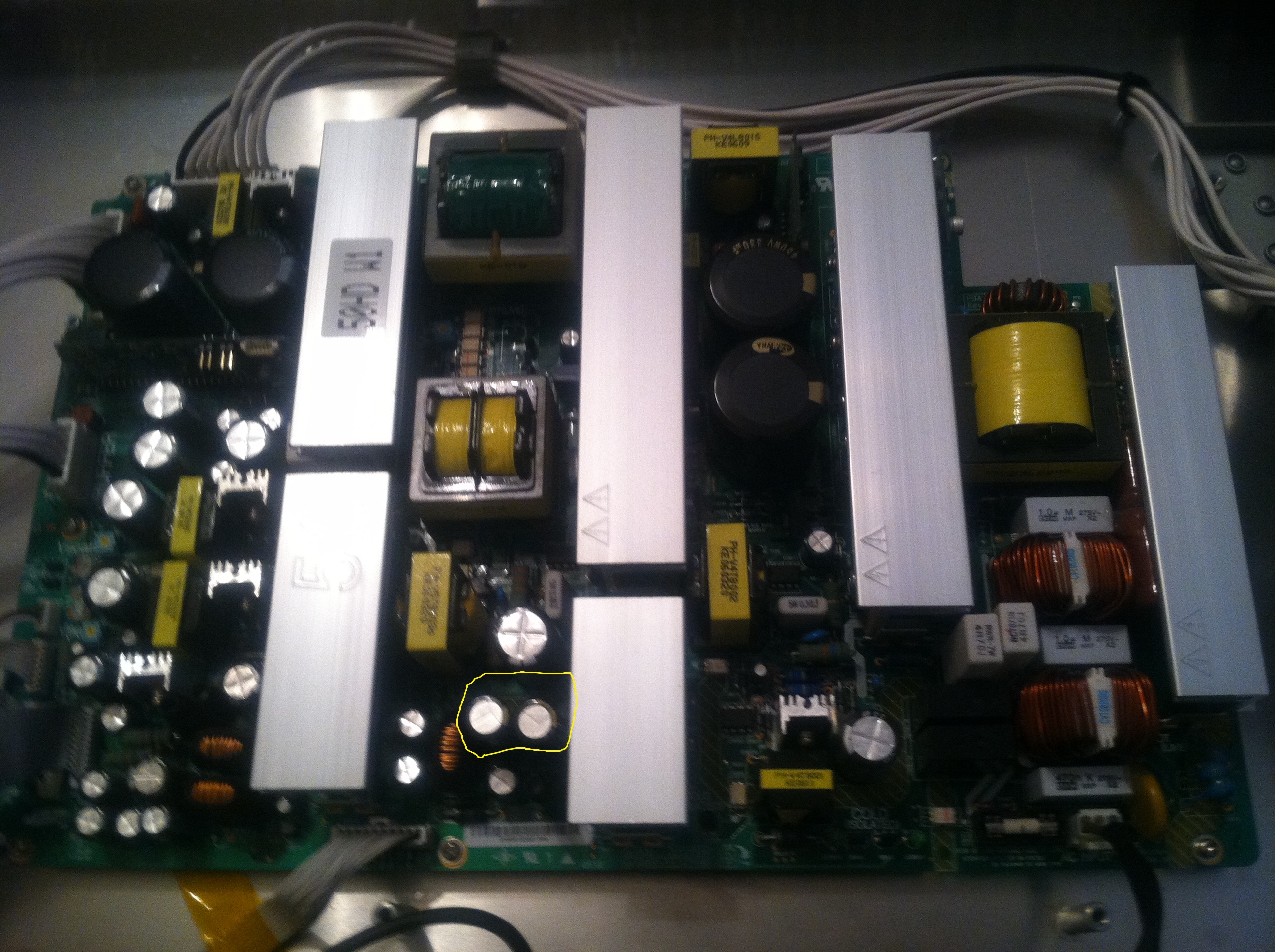

            Re: Philips 50PF9631D/37 - 6 Red Blinks on Front LED
            The fuse I changed that blew was F8005 and now a smaller cap on the other side of the heatsink looks slightly bulged. The cap is C8062.

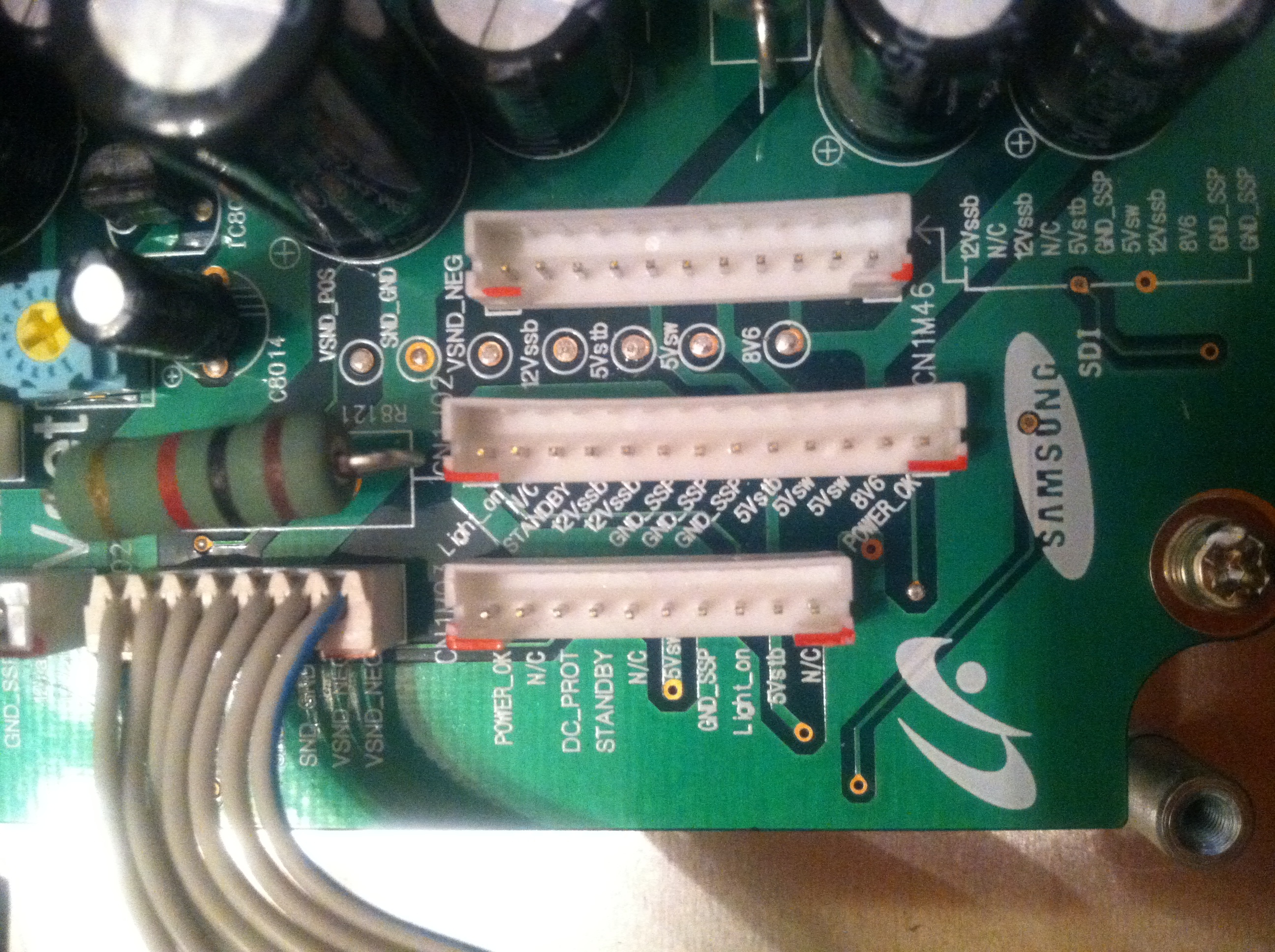

                            The two connectors that go to the ssb each have a pin that says 5Vstb but that is the closest thing I see and it doesn't give an exact voltage other than that on the board
                              Also the board says Samsung on it in the lower left corner
                                Try measuring the 5Vstby anyway but I would expect 5.2-5.4V. Maybe since it is used in a Philips TV it uses 5V instead.
                                    So there are two of the 5Vstb on connectors and one that is just on the board and all three gave the same reading. It read 1, but it was flashing fast on my meter. It didn't matter which of the sensitivity settings I had it in in voltage it gave me a 1 then a few blank space and then a decimal. Not even how it would usually show the number 1. Strange! Any ideas?
                                    • Scuse
                                      • Jan 2013
                                      • 50
                                      Scratch that. I tried it again and I thin I may have had a bad ground because I tried it again and got 5.2V I also attached a picture of where I'm taking the readings
                                        5.2V is good, so what do you measure on 12Vsw?
                                        Meter common can be attached to the back of the plasma panel while making measurements.
