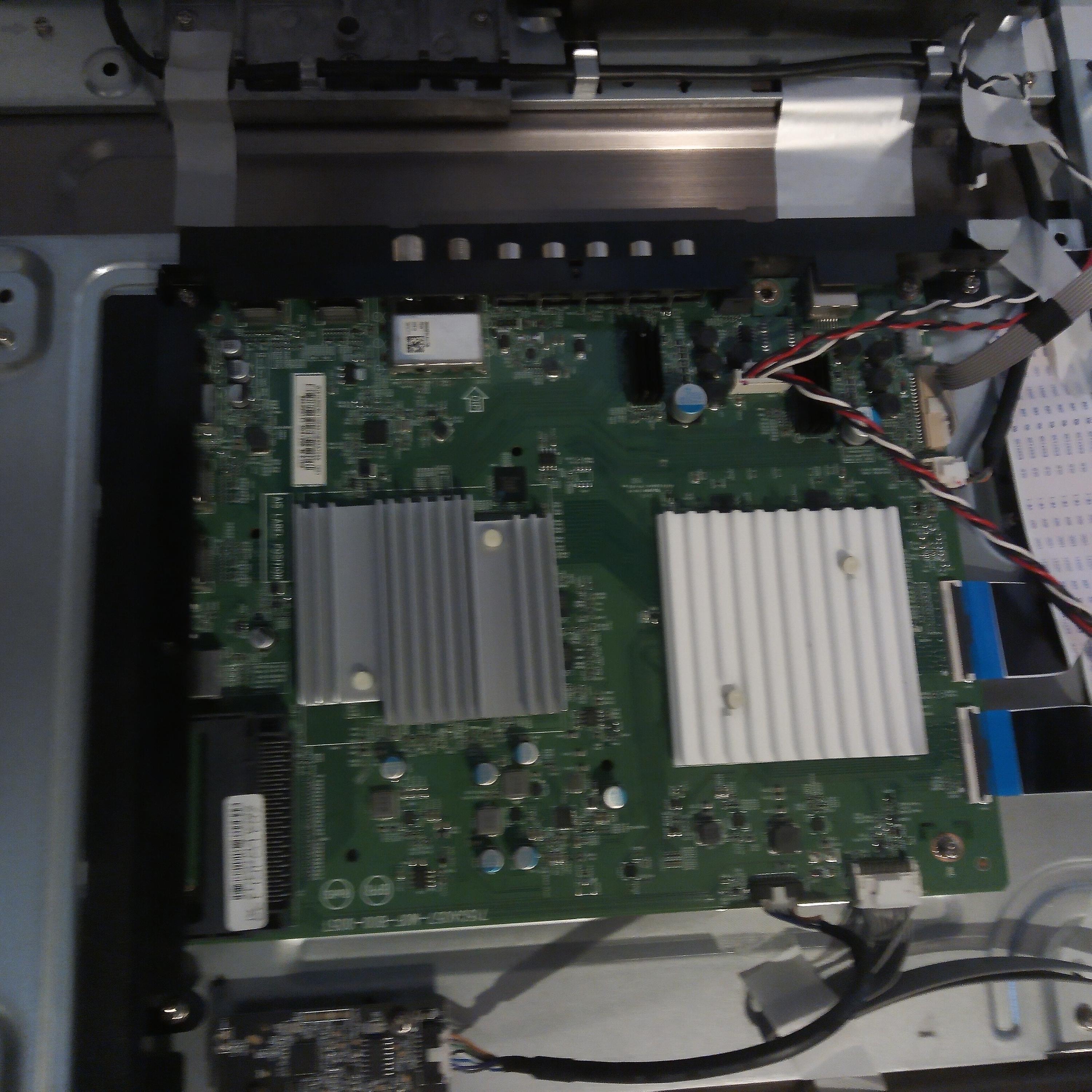

    i read on the net that the micro on some later philips may need a reflow ,removed psu checked all caps with esr meter all ok
    removed main board
    and heatsink on micro
    heated to 300 deg for 2 mins with solder station ,
    let it cool and no change

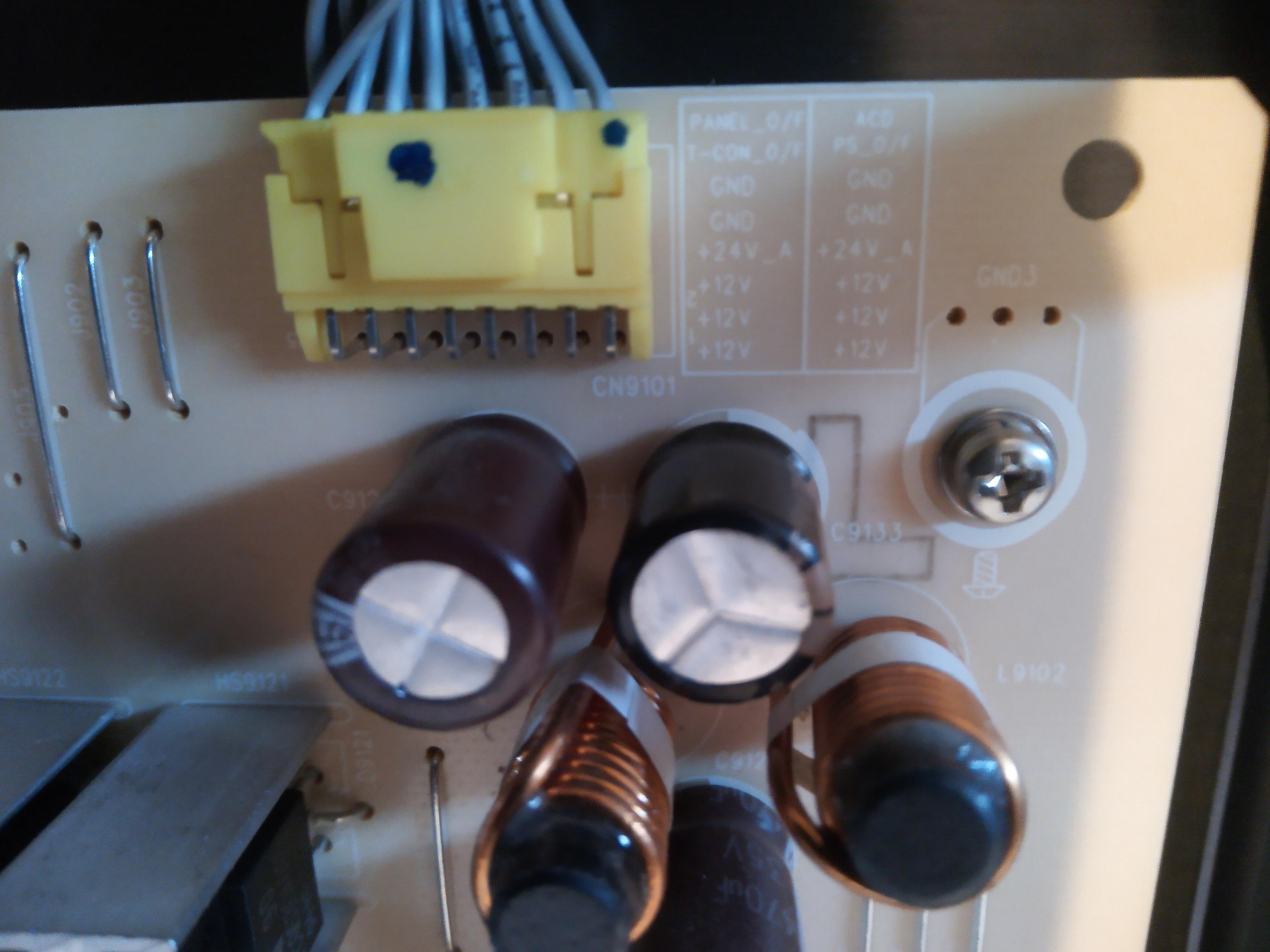

        • jimbofz
          • Apr 2013
          • 539
          • uk

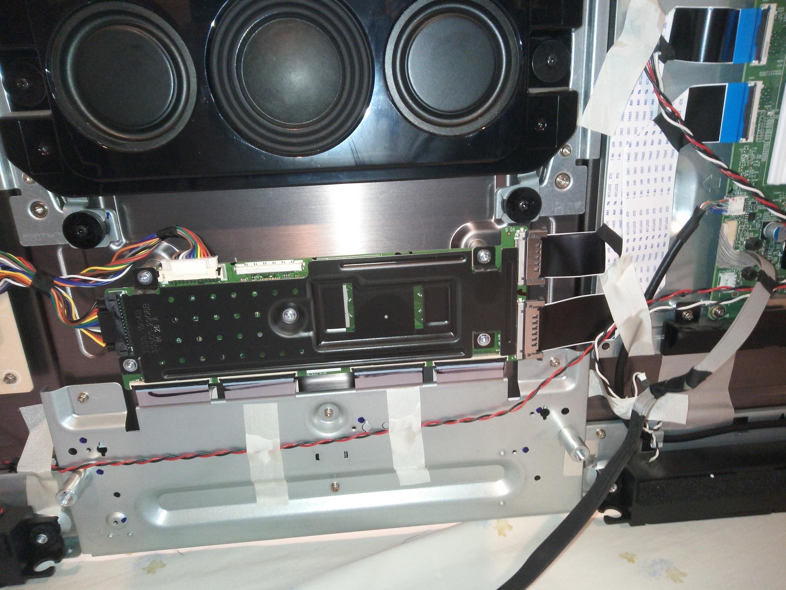

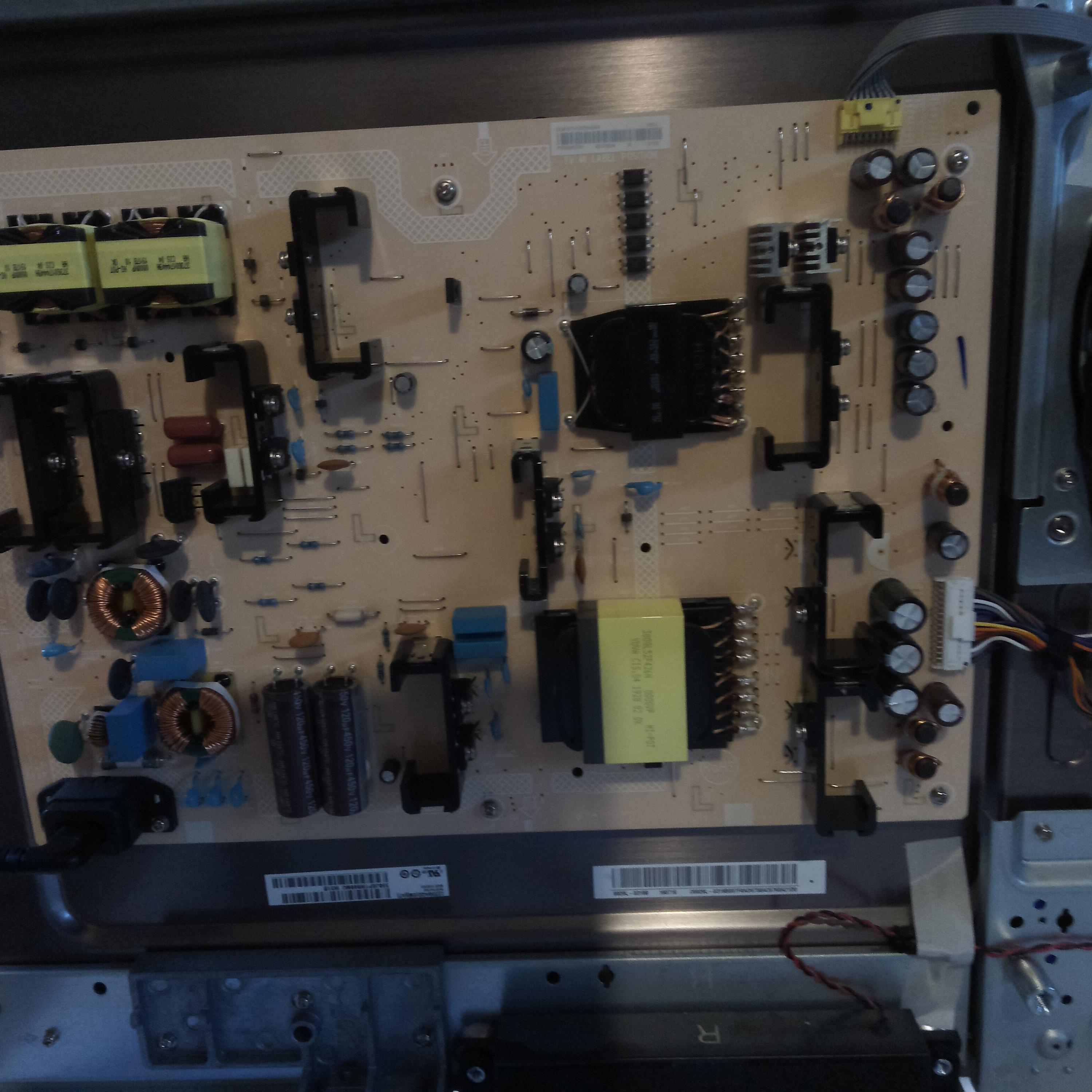

          Re: philips 55 oled 745 /12 3 blinks
          heres the pics
          • Diah
            • Feb 2013
            • 6552
            remove the 24V socket between the PSU & T-con by unplug it from the T-CON side then test to turn on. give attention to the display if there will be horizontal line move from top to down

                  as i mentioned in my first post someone posted main board problem
                  that for him it was fixed with a reflow using solder station .
                  i will remove main board and check all caps with esr meter
                  then i will try a reflow again
                  • Diah
                    • Feb 2013
                    • 6552
                    Originally posted by jimbofz
                    thankyou .
                    but before go to mainboards .. you need first to test the PSU first to turn it on with out mainboards ( stand alone ) to see if all 12 & 24V stable and remain stable
                    • jimbofz
                      • Apr 2013
                      • 539
                      • uk
                      thanks normally i would find the sby 3.3v supply
                      and link it to p/s on off
                      and panel on/off
                      via 100 ohm resistor
                      but theres only voltage in sby on 12v pin
                      can you advise best way to test psu (stand alone)
                      • Diah
                        • Feb 2013
                        • 6552
                        and panel on/off
                        hold on. i am little confused with yours V reading
                        9.5V STB goes High to 12V when the mainboards send 3.1V to PSU (on pin PS/ON) this is Okay.
                        24V = 12V after PSU ON as you write its 12V at STB !!!!!??? some things wrong.
                        Panel ON =5V .. did you check the other socket which it goes to T-CON if there 24V ????
                        T-CON ON = 0 so no signal from MB to turn on the 12V to T-CON ( at same socket of 24V to panel )
                        i think there are error at measurements.. or Typo
                        • jimbofz
                          • Apr 2013
                          • 539
                          • uk
                          i know its confusing
                          but there are two plugs on psu
                          on one plug should be 24v and 12v supplies ,
                          now when in sby theres no volts at all on these pins so no 12v or 24v on this plug
                          now the top plug has two rows of 8 connections
                          six (which are marked on board as 12v )they provide 9.5v in sby mode
                          the two pins marked 24v on board produce 12v when in sby
                          Now when using remote ,you get 3 blinks ,when its blinking these voltages change
                          as shown in pic .
                          the panel on/off pin only produces volts when its blinking
                          this is what i dont understand,as normally the sby volts is present in sby
                          • Diah
                            • Feb 2013
                            • 6552
                            as shown in pic .
                            my question still with out answer... this pin i remarked with bold did the 24 line provide 24V when power on?? if not then you have issue on PSU
                            • Diah
                              • Feb 2013
                              • 6552
                              to clear it for you in simple words
                              9.5V are STB V. when main boards turn on this 9.5V will boost high to 12V and the 24V line on same socket will boost 24V-
                              then mainboards will send T-con ON ( now the 12V on the other socket ) you have no signal as 0 now
                              then main boards will send signal to panel on ( this will boost 24V on the other sockets.
                              you can slide out the 2 cable t-con/ON and panel/ ON from the socket at the PSU. and make 2 jumper between PS/ON ( 3.1V) to pins t-con/on and panel/on. turn on and see if you have 24V & 12V on the other socket.

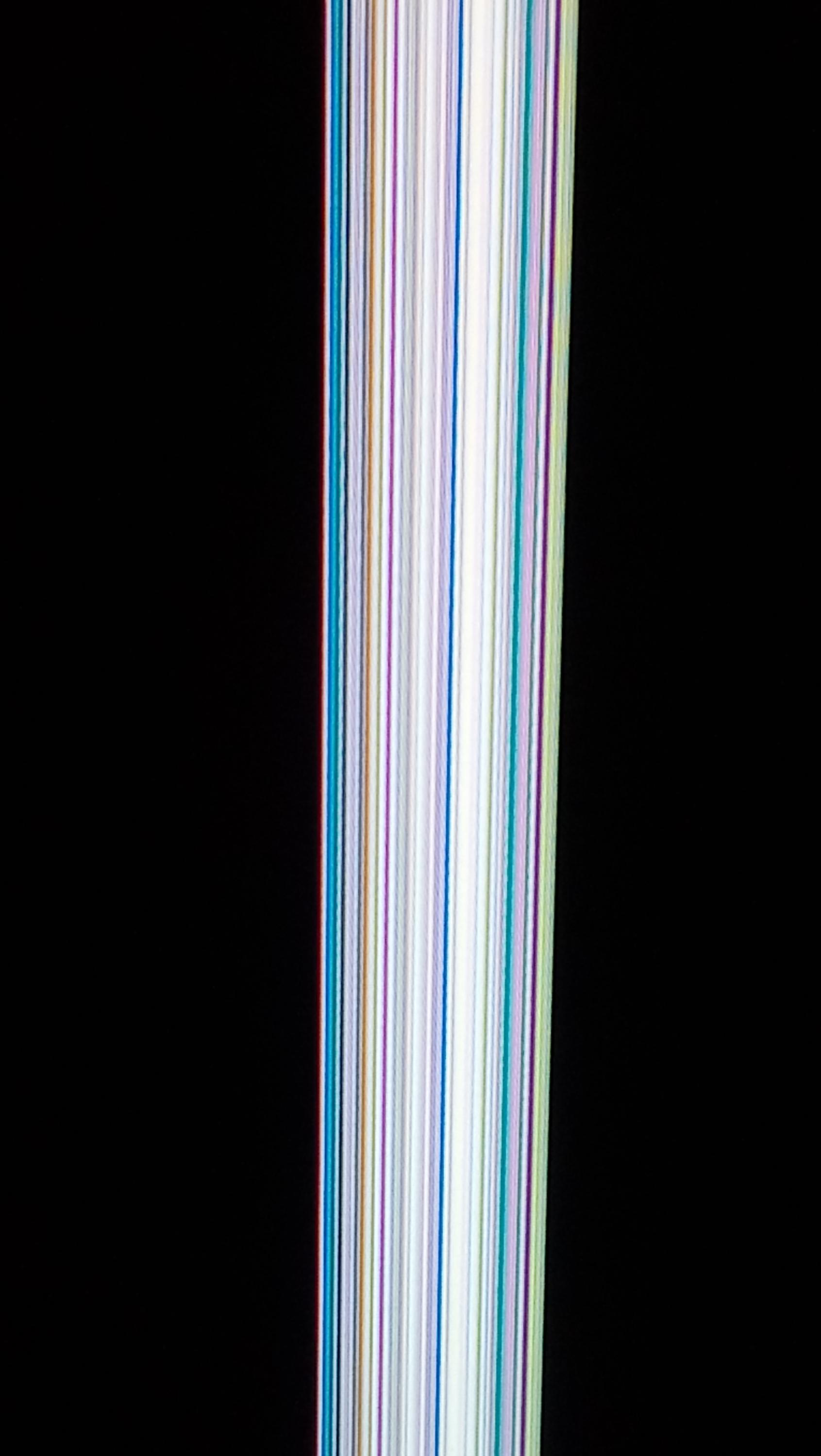

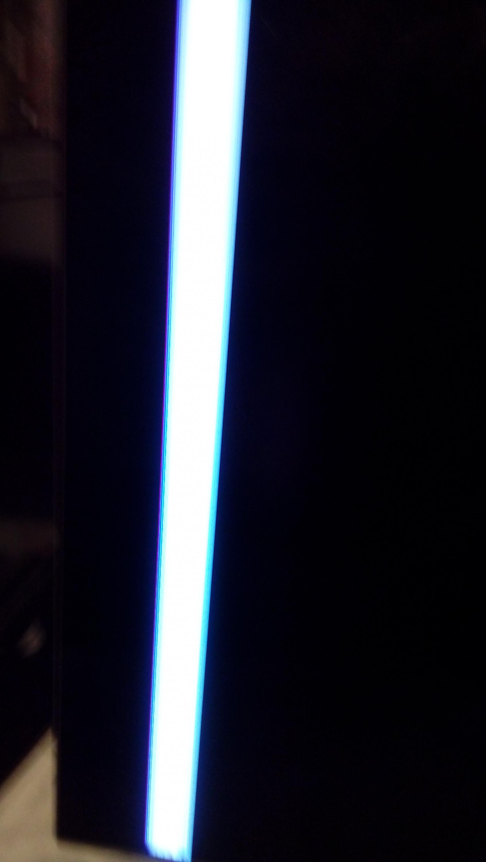

                                  well the 12v and 24v supplies came up thats the good news
                                  the bad news
                                  is it looks to me to be a damaged panel
                                  ,i get a vertical white stripe with coloured lines on left side of screen approx 4cm wide and about 6cm from edge of panel,
                                  the rest of panel stays dark
                                  ive posted pics
                                  i only have a few seconds to focus camera before tv shuts down
                                  but its the coloured lines that make me think its the panel
