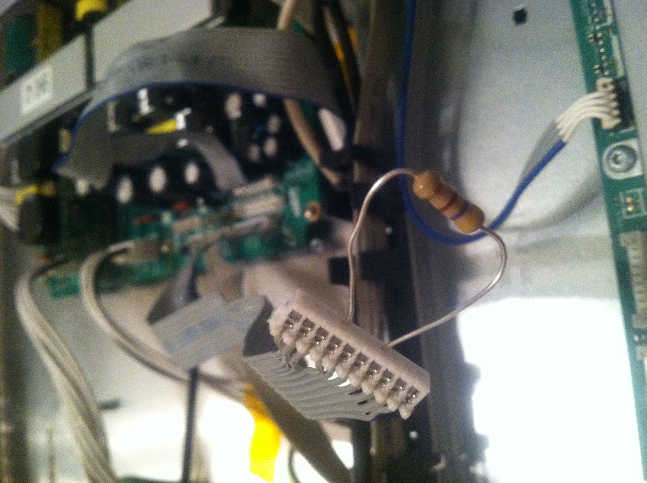

                  Just did it and attached a picture to check if its right. The only readings I got the first way was 5.2V on the 5Vstby and on STANDBY as well as running accross the resistor. The second time I got 5.2V on 5Vstby and -.02V on VSND_NEG. Not sure what that means
                    #29
                    Re: Philips 50PF9631D/37 - 6 Red Blinks on Front LED
                    Basically you get 0V no matter what you do. 0.02V positive or negative doesn't matter either way. During this time what voltage do you measure on STANDBY?
                      5Vstby to STANDBY I get 5.2V on STANDBY, but Ground to STANDBY I get nothing.
                        #31
                        Makes sense. Does the relay click when you do this?
                        • Scuse
                          • Jan 2013
                          • 50
                          #32
                          It does the first way but not the second
                            #33
                            OK, so it is receiving power signal and doing something with that. The next step is to check all of the fuses on the power board. If they are OK check the diodes on the secondary of the power supply... If you need help with either of these post back.

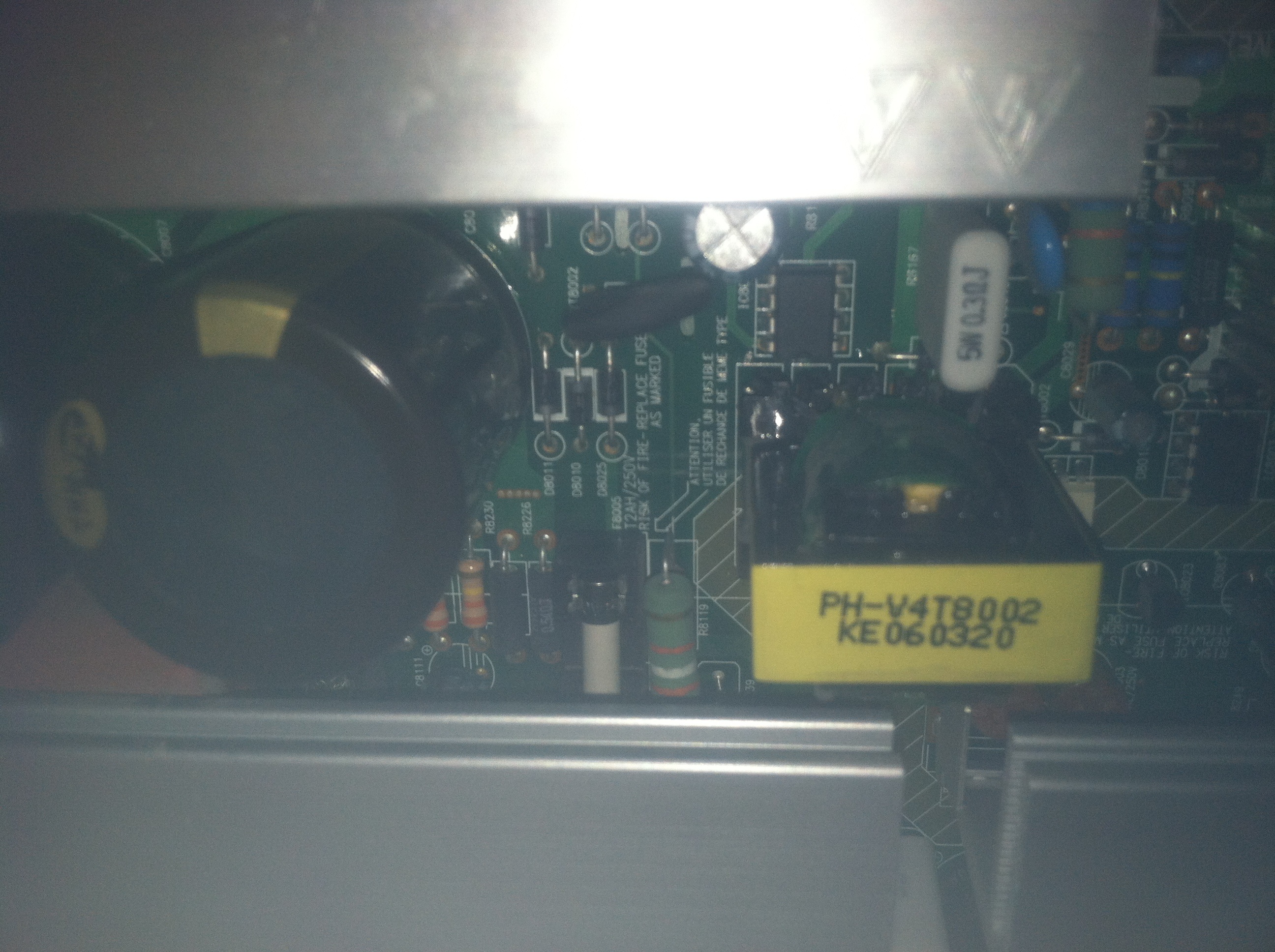

                              All if the fuses are good except for the one I mentioned earlier in the thread that I ordered and immediately blew up on me when I plugged the TV in.

                                #35
                                might be wort posting a picture of the fuse location thats blown so we can see the other parts around it also a pic of the other item you say is bulged thanks.

                                  #36
                                  The fuse is on the left hand side of the first picture under the heatsink and the cap that is slightly swollen is on the right hand side of the second picture next to the heatsink. This is the same heatsink, just different sides.

                                    #37
                                    Sorry first picture didn't upload so I will try it again here. The cap in the above picture is the small one at the top.
                                      #38
                                      I would suspect IC80(14?) the 8 pin onthe primary.
                                        I can't seem to find that one. I see IC80xx for every number but that one. Fml is there anything else you would recommend doing before ordering a new power board and do you think that would fix it or would I need to get anything else? I may order one soon. Looking at prices now
                                          #40
                                          How much is a power board?
                                          I think it's IC8016.
