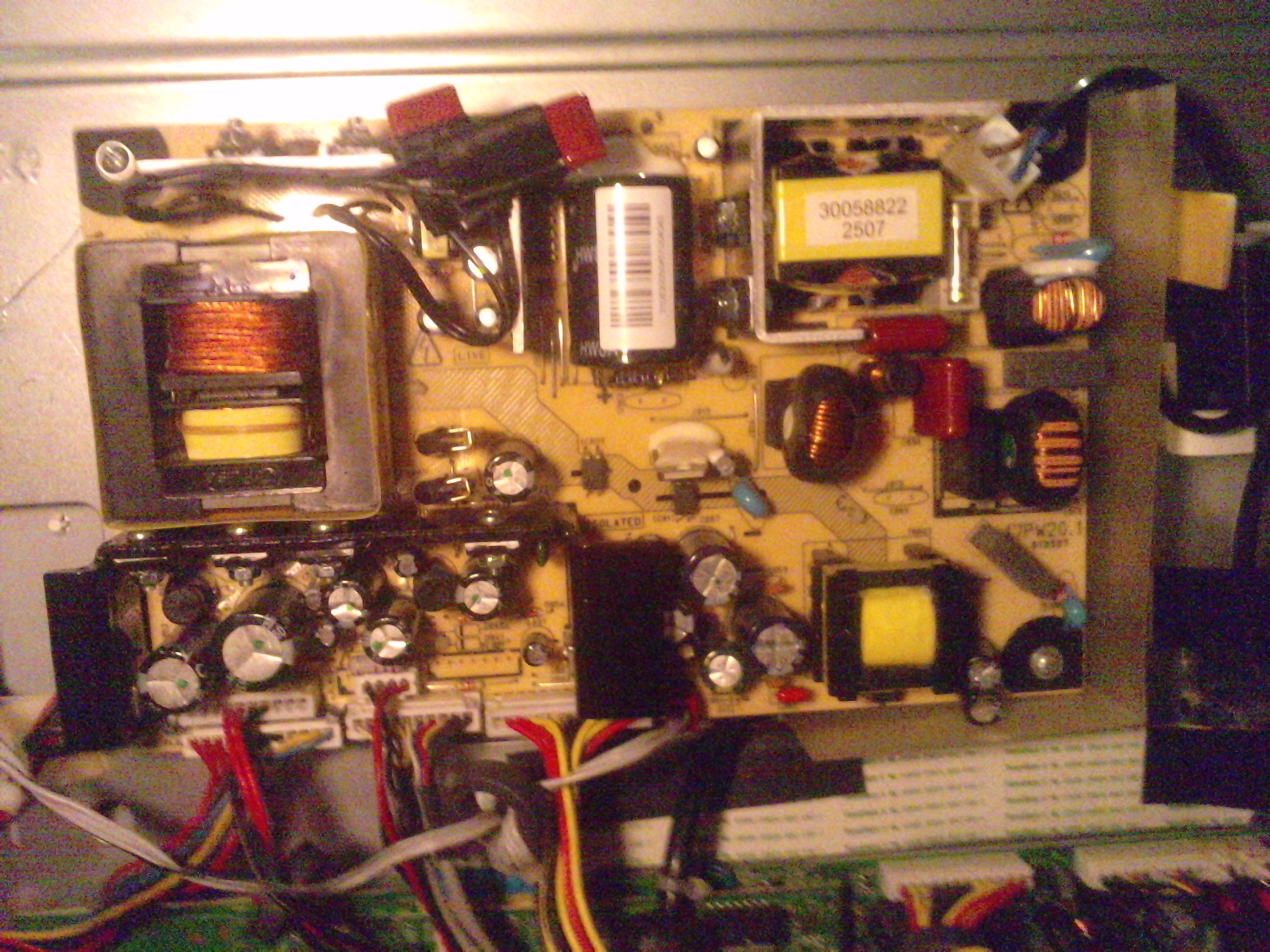

    Hey there fellas. First time poster here but a bigtime lurker since a week ago when I got this tv from my uncle.
    First I want to describe the problems, which are somewhat random.
    In the beginning the tv works fine, but the sounds starts to crackle when it heats up which led me to unplug the speaker wires and use an external audio amp, but just a little while after that I notice the screen flickers terribly when there's too much white in the picture, eventually if I don't lower contrast and brightness the whole screen turns white and stays like that until I turn off and on the tv.
    A while after that I started having problems getting it to turn on again, the blue led was lit constantly and it tried to start up when I pressed the remote, but went back to standby. Eventually it would turn on and work fine for a while until I had to start it by remote again.
    Then came the flashing led problem, where it got stuck until a random time had passed. I could try starting with the remote or powerbutton but nothing helped.
    At this time, I came to the forums here to search for help and found many and interesting answers and ideas. My own ghetto solution was to unsolder the 15nf1000v polypropylene caps (correct me if I'm wrong somewhere) then solder some long wires there, so I could glue the caps to heatsinks to keep them cool. This has helped quite a bit with both the white flickering and the stuck in flashing led problem, but it still turns off to standby mode occassionaly.
    If I let it sit for a little bit I can start it again no problems, but the fault is persistant.
    I know I need to swap some parts inside, definitely the 15nf1000v ones, but I wanted to ask here first if there's any more perticular parts needed as I'm on a very very very tight budget, so buying a new PSU isn't optional (I'm looking at you tom66 )
    I don't have the gear to check if the 330v at supposed 390v problem exists in my tv, but I wouldn't be surprised if it does.
    Thanks for reading all this, I hope it can help you to help me, anything from ideas to concrete evidence is helpful, I'll keep my soldering iron warm until then.

    Yeah, you really need to replace those capacitors. The symptom you're seeing is very typical when those capacitors fail.
    I usually replace the PSU board because in many cases it ends up being cheaper and easier (I value my time, too) it's only about £20 on eBay, the caps are about £4 including delivery but I've had far too many other issues on these boards to do that any more.
    You can use any 500V rated DMM to test that capacitor. I've only encountered that issue once; the most common is those poly caps failing.
    7 out of 8 of those Vestel I have repaired have all had symptoms similar to this. But usually powering on and shutting down after 5 minutes, or getting stuck in standby, or a blinking power LED.

          I've changed the 15nF 800v caps, went smooth as expected.
          However, my problem still remains.
          When I listen closely to the PSU I can hear an electrical buzzing, kind of like "beep, beep, beep" as I presume it's trying to charge up but fails, and then retries. The blue LED in front was blinking at the same speed as the sound, and no tv came on.
          I also noticed that if I turn on power, sometimes the LED stays on as it should, and sometimes if I keep holding down a channel button on the side it actually comes on, so right now my tv is on. I can live with it being hard to turn on, but I fear the problem with the screen turning all white if the brightness and contrast is set too high after a while isn't gone.
          Any more ideas as to what I can do, besides ordering a new PSU? The thoughts I've had myself so far is transistors or MOSFETs, perhaps even the really big cap?
          Thoughs and speculations are welcome, I hope I can get it back to working standards.
          Thanks, Pierre.

            Can you check the voltage across the big cap? Care high voltage - expect around 325V in standby, and 390V when powered on.
            This is why I always replace the PSU on these models... far too many different faults to say it's "just those caps..."

                                  I suggest you buy, beg, borrow, steal or find a DMM, measure the voltage across the capacitor, and see if it's nearly 390V or not. Then test the outputs of the SMPS: in particular the 5V and 12V are important, though the 12V is most often used for both audio & T-con.
                                  T-con handles the conversion of main board signal into drive signal for TFT LCD panel.
                                  Main board handles conversion of analog TV & digital TV signal, plus HDMI, component, composite, SCART etc. into signals for T-con.

                                      SMPS is the 17PW20.v1 unit.
                                      If you post a picture of your PSU, I will highlight checks to make.

                                        Alright, finally managed to get a decent picture!
                                        Please don't judge my shoddy repair of the pp caps, I was to eager to test the tv to replace the wirings I had made earlier.
                                        I can guarantee they do not short circuit or come in contact with anything harmful, it's just not very beautiful is all.
