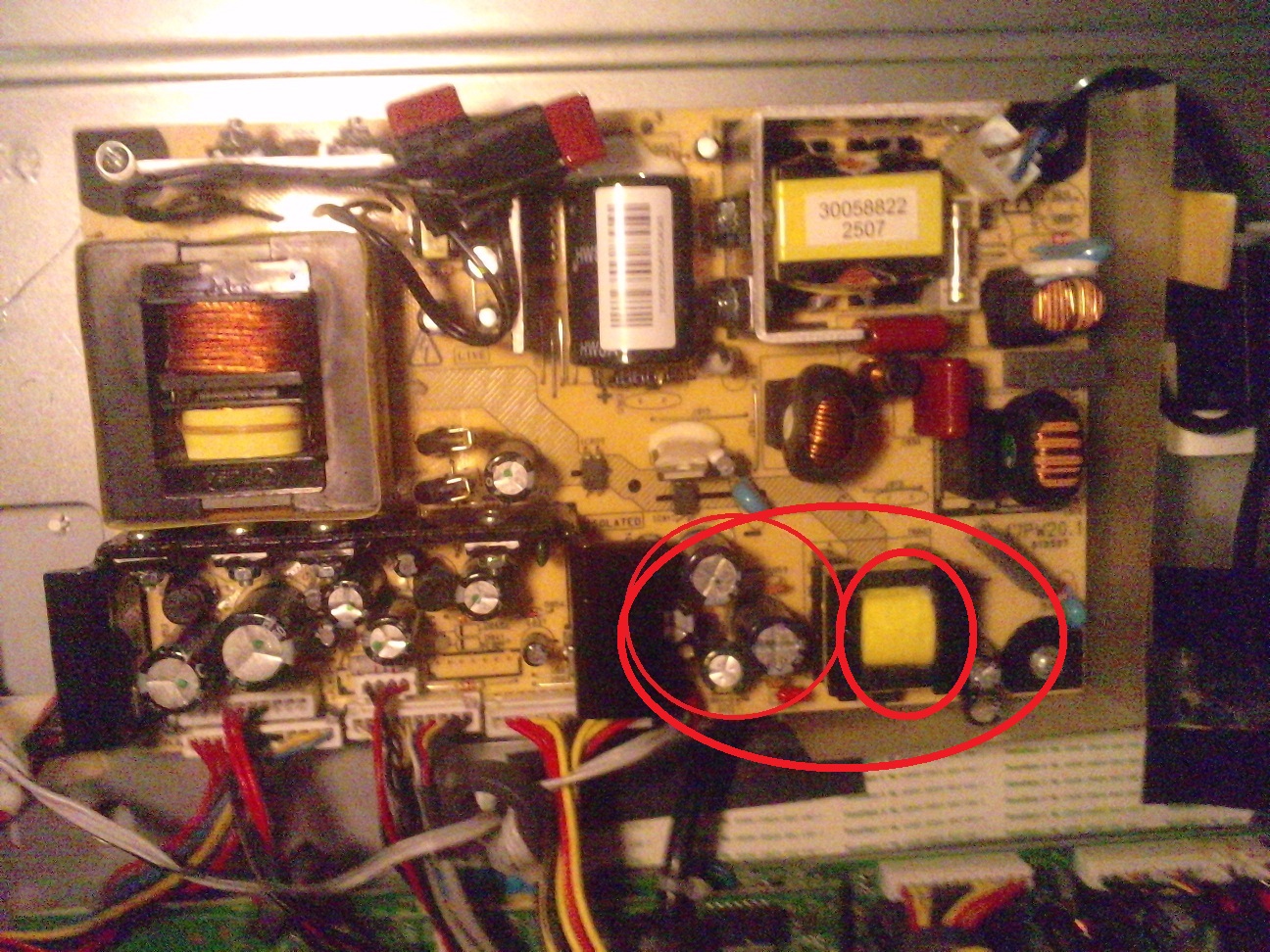

          #44
          Re: Finlux 32FLD760P with Vestel 17PW20.v1
          Heating the caps in the red circle causes the tv to start flickering and the sound to crackle more!
          I know it's located around there because, well, I heated the caps with a warm lightbulb. Yes, it's not professional, but hey I'm unconventional!
          Atleast now I think the faulty are is located? I'm guessing those caps are bad, but not bulging.
          Edit. Forgot to mention that the second I removed the lightbulb the tv went back to normal, some small crackling noise but no flickering.
          2nd Edit. When that area is heated the tv flickers, but when I put a tablefan to blow on the tv it works fine again. Definitely something with the heat going on. I'll keep on testing, carefully. I won't blow anything up, promise.

            #45
            does sound like a capacitor issue to me this is where a esr meter may help but for the cost of the caps you have circled i would replace them also under the black lip covering the capacitors are there any more capacitors under there we cant see? i would also resolder that area under the caps you are heating up just to rule out a bad solder joint the eye may not see the heat maybe expanding a bad joint and when it cold contracting? hence why it works then but i still think it may be a capacitor issue.

              #46
              So earlier I managed to snatch my girlfriends hairdrier and start testing to heat the board. I get a heavy flickering reaction when heating inside the big red circle. Since the hot air does get around alot, I'm not sure exactly which part, but when I hold it over that yellow big... thing, I does flicker the most and almost instantly when heat comes.
              However, as I said, it's not a focused beam of heat coming there, might as well be the original place I found but anything that can help you help me right?
              Vinceroger69: Yes, there's 2 small caps and one hourglass shaped on under the lip which is not seen in the picture, none has bulging or visible faults, but one can never know.
                  The two caps near the right bottom screw can sometimes fail and cause loss of PFC on this set..

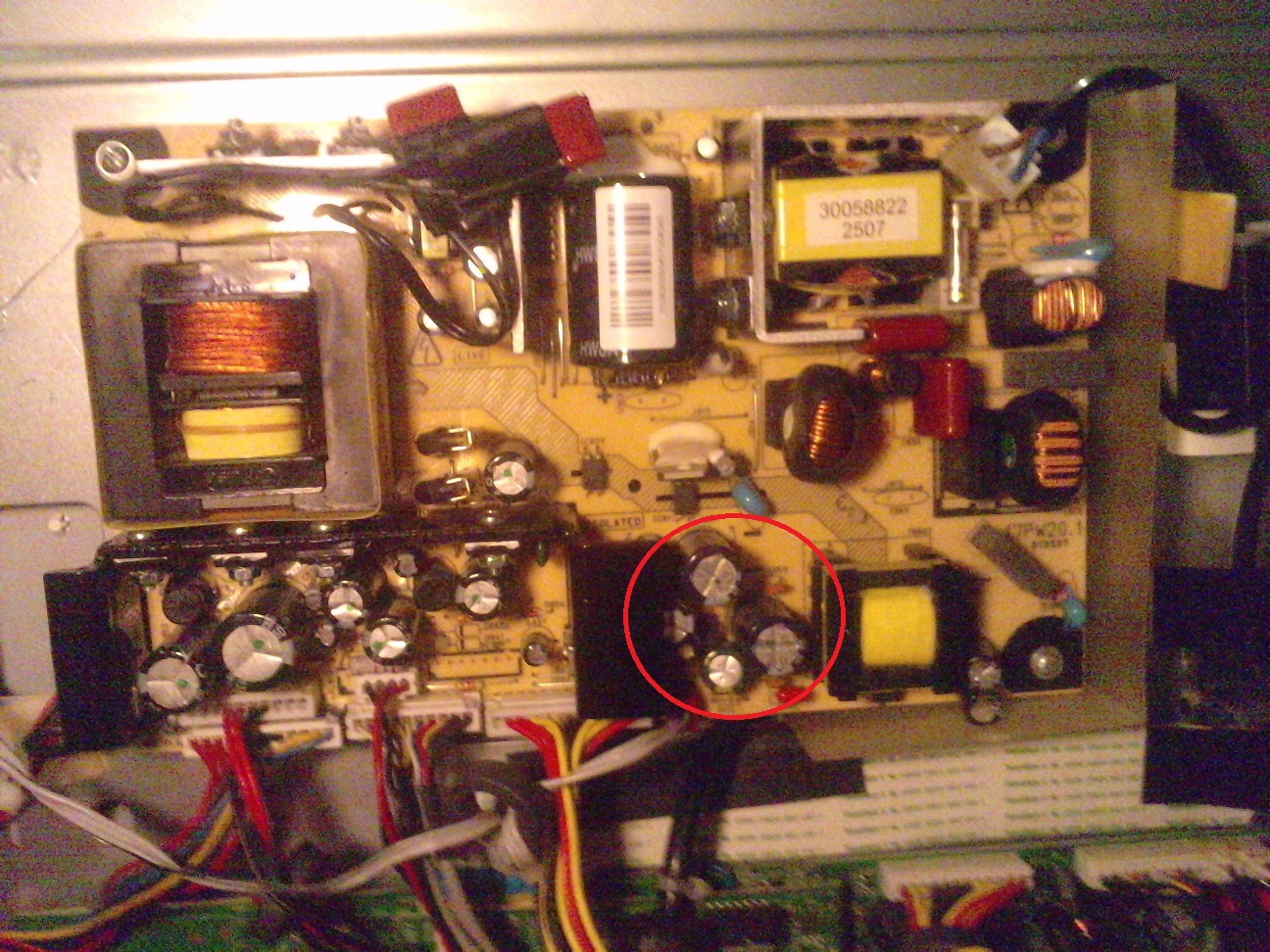

                    #49
                    Bah, using a hairdries probably isn't accurate enough. This time I heated first in the bottom right corner and nothing happened, then I heated evenly on the board and nothing happened, and at the end I focused on the bottom left, at the other caps and connectors there and boom, almost straight to white.
                    Not sure if it's the caps, or the fact that the heatsinks gets warm? Faulty fets? I've seen some included in some of the repair kits available so I'm guessing they're not the best?

                        #51
                        That's exactly what I've been thinking about! I haven't done it yet only because I figured the heat would spread at the end when it hits the board anyway, but I can always try.
                        Right now I have the psu on my table, going to resolder some points in hope of cold joint problem.
                        Tom! The two caps at bottom right are both 100uF 63v and 33uF 63v, they look fine but I don't trust that. However, I only have 100uF 50v and 33uF 50v caps at home, would that work or is it too big risk it'll blow?

                          #52
                          Both of those caps will work fine. Voltage on the capacitor is a rating, not actually what the capacitor has across it, working voltage should be the same or higher as original. Make sure they are from a good manufacturer if you want it to last.

                                #55
                                Changing those 63v caps to 50v didn't work, now it doesn't show any signs of life at all, not even the electronic beeping noise that usualy comes on as soon as I plug it into the wall.
                                I checked to make sure there's no solder where it shouldn't be but it looks fine.
                                This confuses me, haha.
                                Edit. By the way, the caps I soldered on were brand new, so I don't think that's the problem.
                                Edit 2. I'll put the old caps back and see what happens. Wish me luck!
