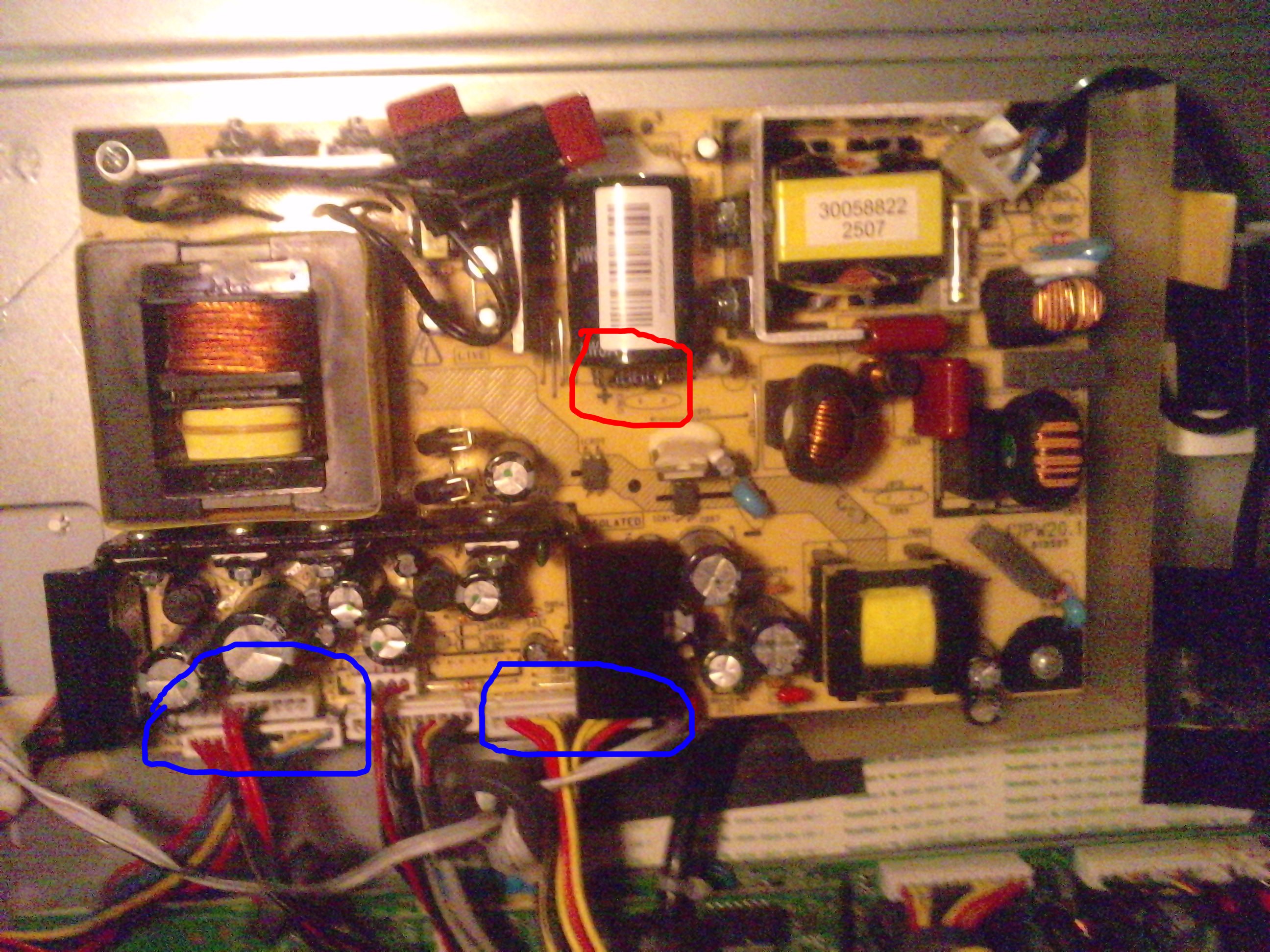

      Guess that sets the verdict, alright I'll go ahead and do that!
      I hope the picture was ok for marking where to check?
        Re: Finlux 32FLD760P with Vestel 17PW20.v1
        Fix that first & see if it sorts your issue, if not we shall check other things. Pic is fine for basic checks.

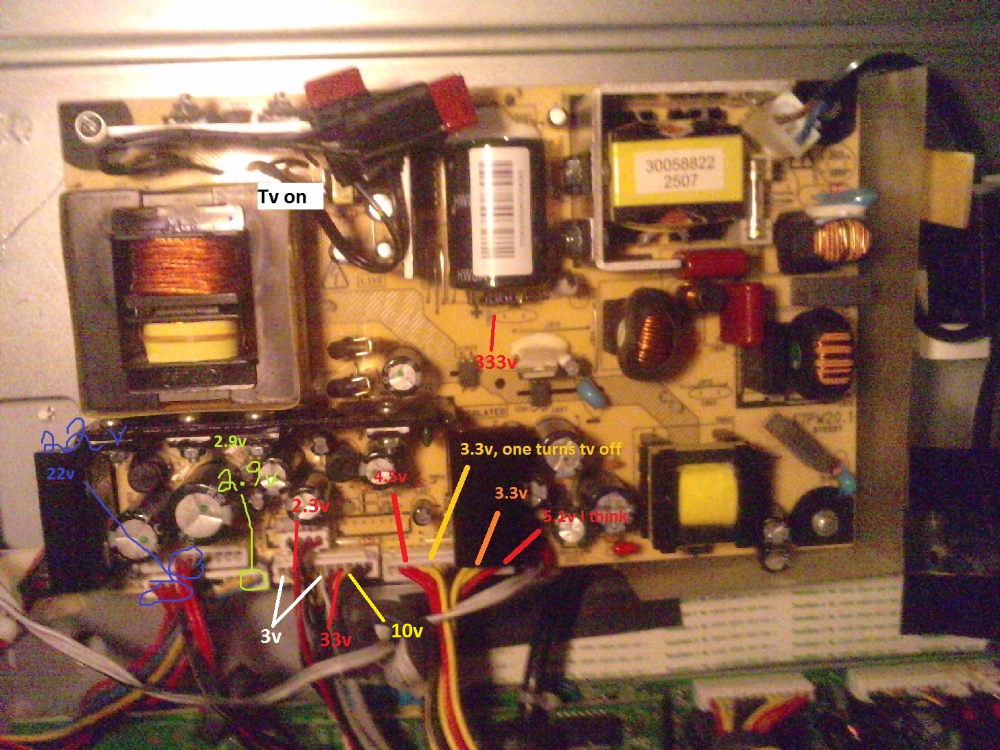

              Mkay.
              Red circled device: Measure voltage across. Care high voltage, nearly 400V.
              Blue circled connector: While functioning and malfunctioning, voltage on each pin relative to the chassis. Use DC 200V.
                Not sure if it makes a difference, but all the problems started occuring more after I put the back cover back on in hopes of being done with the repairs?
                Also, the one in red circles, measure voltage across means from the plus to minus on the cap? Sorry might be a little lost in translations sometimes.
                  Yes, measure voltage from positive to negative side.

                    #29
                    Okay. I just did that, standby is 319~320v, and when tv is on it's ~330v. Going about to check the pins now. Tv is hot as hell on the backside, probably heat sensitive.
                    When the tv screen gets stuck all bright and weird, it measures ~335v.
                    I'm not sure the DMM is completely accurate, but I did change battery in it to a brand new one and tested it on smaller batteries to check which was fine.
                    Edit. Corrected values after another check, must've held the pins badly.
                      #30
                      385V is fine for PFC. Check that it's stable as the TV starts encountering more issues.
                      You clearly have 220VAC instead of 240VAC in UK -- that can make a big difference if PFC fails...

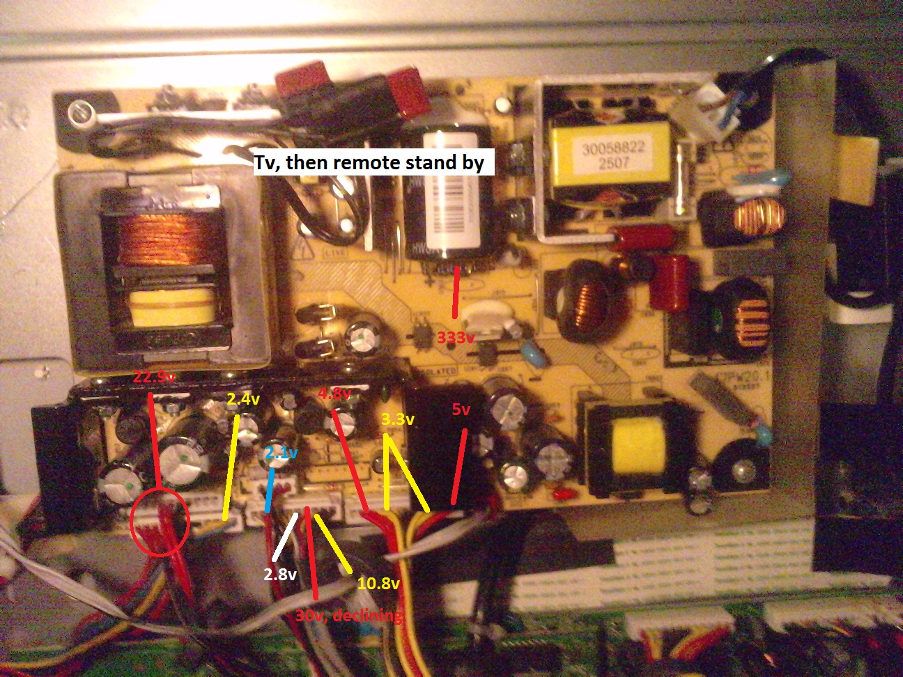

                        Here's the values, measured as good as I can so I hope I didn't miss anything.
                        These are unplugged tv being plugged then power on, but not starting it completely. Next is tv on, watch some, then standby on remote. And last is tv on while being watchable, except when it went all weird once.
                        If I haven't written any values then I either missed the pin or I couldn't measure anything else than 0 on it.
                          #32
                          22V should measure 24V and it's important for audio and backlight on this chassis. 10.8V should be 12V and that is used for t-con power and some other audio functionality. Check PFC voltage again. Otherwise, I'd just swap the PSU to be honest...

                                #35
                                Now that it's been on a while it's down to 21.3v, pretty sure of it. Would that even work? I get picture, but it's on the verge of flickering.
                                Main cap is still 333v when on and working.
                                  #36
                                  Main cap at 333V is too low. You said 385V before? 21V is not enough to run a backlight well. 23V to 26V rated.
