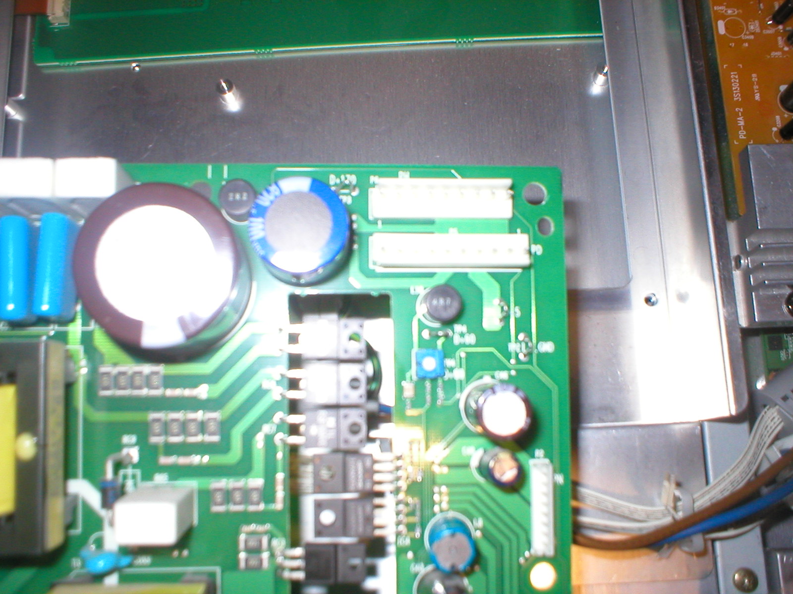

NEC Px42VM3A lost all display
    Re: NEC Px42VM3A lost all display
    Can I see a picture?
      if you lookup towards PH and PD connectors in slot L10 these are what I see
        They are inductors not fuses, should test shorted.
        What about that white ceramic resistor, how does it test & what does it say? Hard to see with focus, remember I do not have this board in front of me.
          G5W 47 OHM J micro 1DT
            Does it test at 47 ohm or nearabouts.
              46.8 ohms

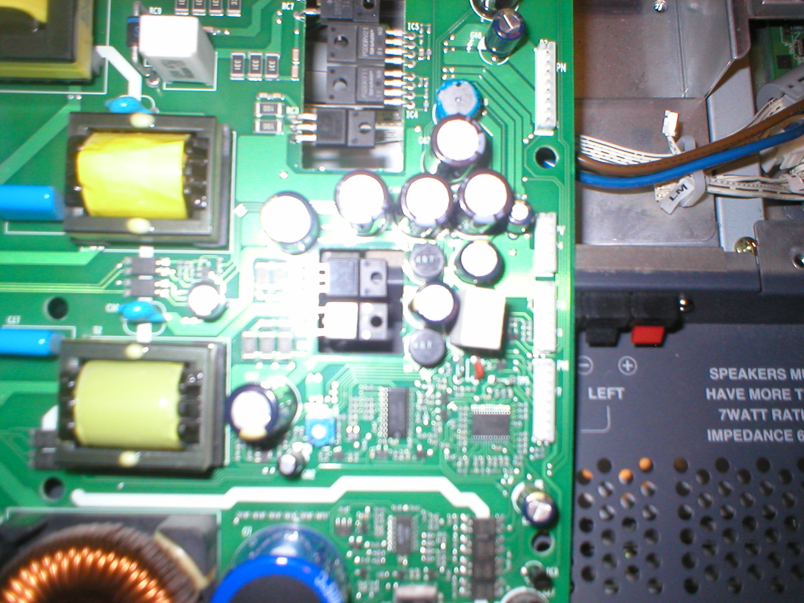

                  the 4 white resistors that show G5W 4.7 ohm Micro 1DT are reading only 3.6
                  these are up by the 1500uf 200V cap
