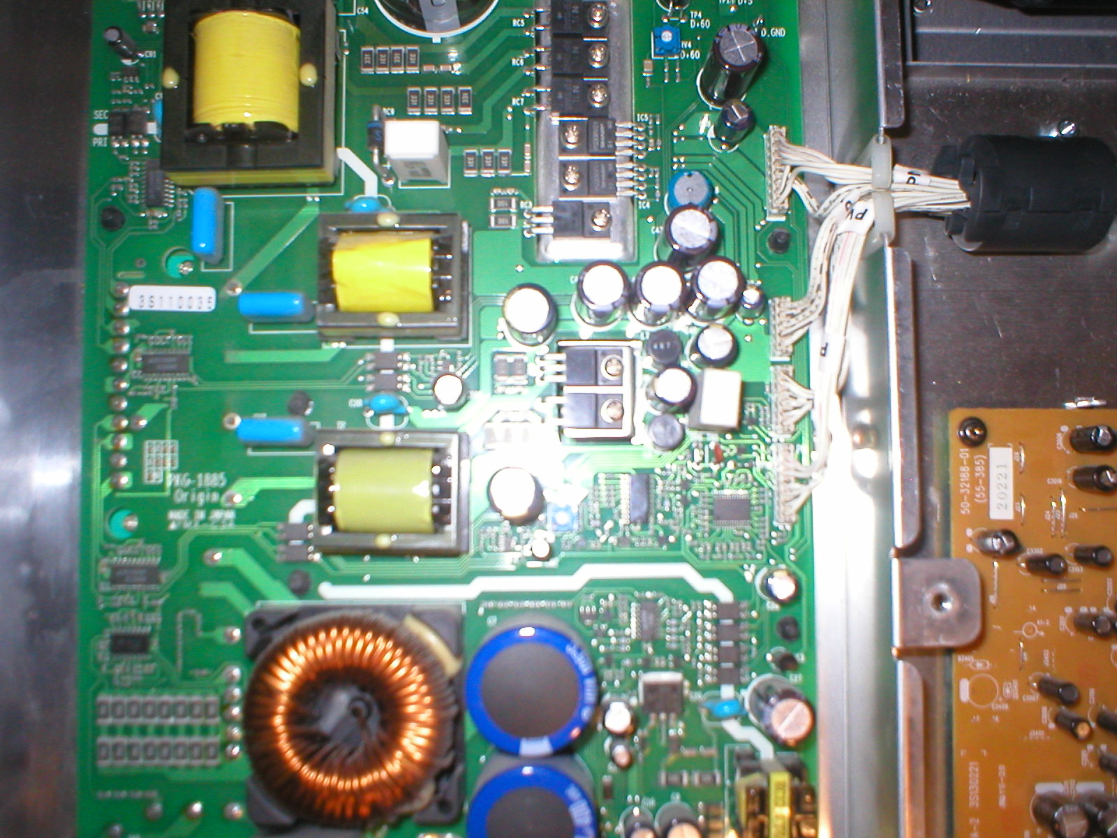

                      Re: NEC Px42VM3A lost all display
                      It'd be on the power supply connectors going to the X and Y-drive. Can you post a close-up shot of that connector, on the power supply end?
                          X and Y boards are on the right & left hand side of the plasma panel... It's those brown/white wires. Top of this pic.
                          https://www.badcaps.net/forum/attach...9&d=1358192926

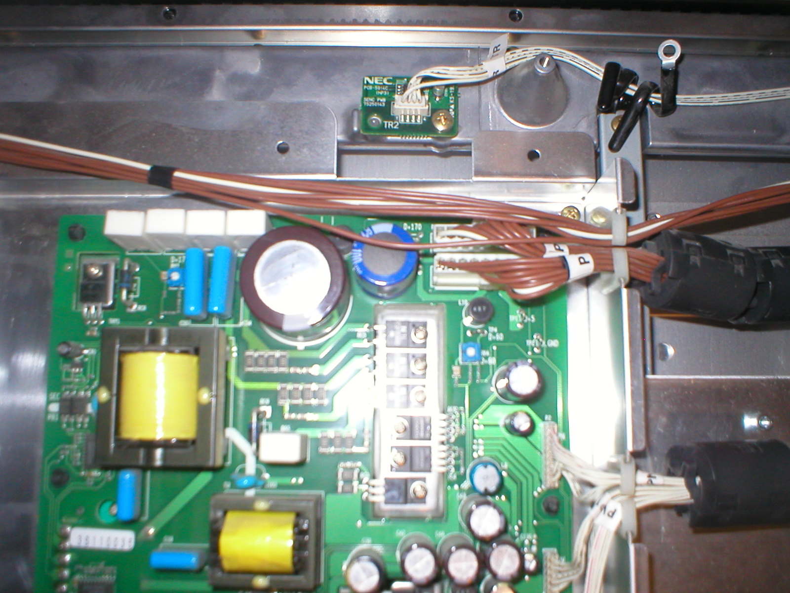

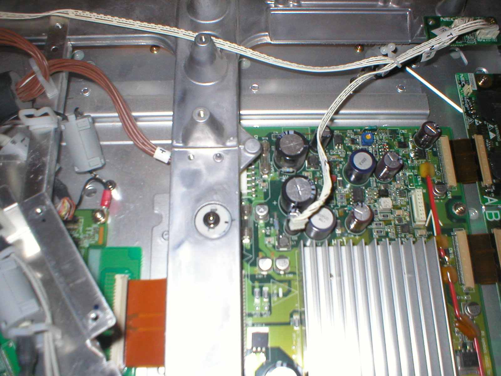

                            #33
                            is this what you need
                            • Dblueman
                              • Nov 2012
                              • 84
                              #34
                              try these, I see what you are asking
                                #35
                                3rd pic. Any labels next to the connectors?

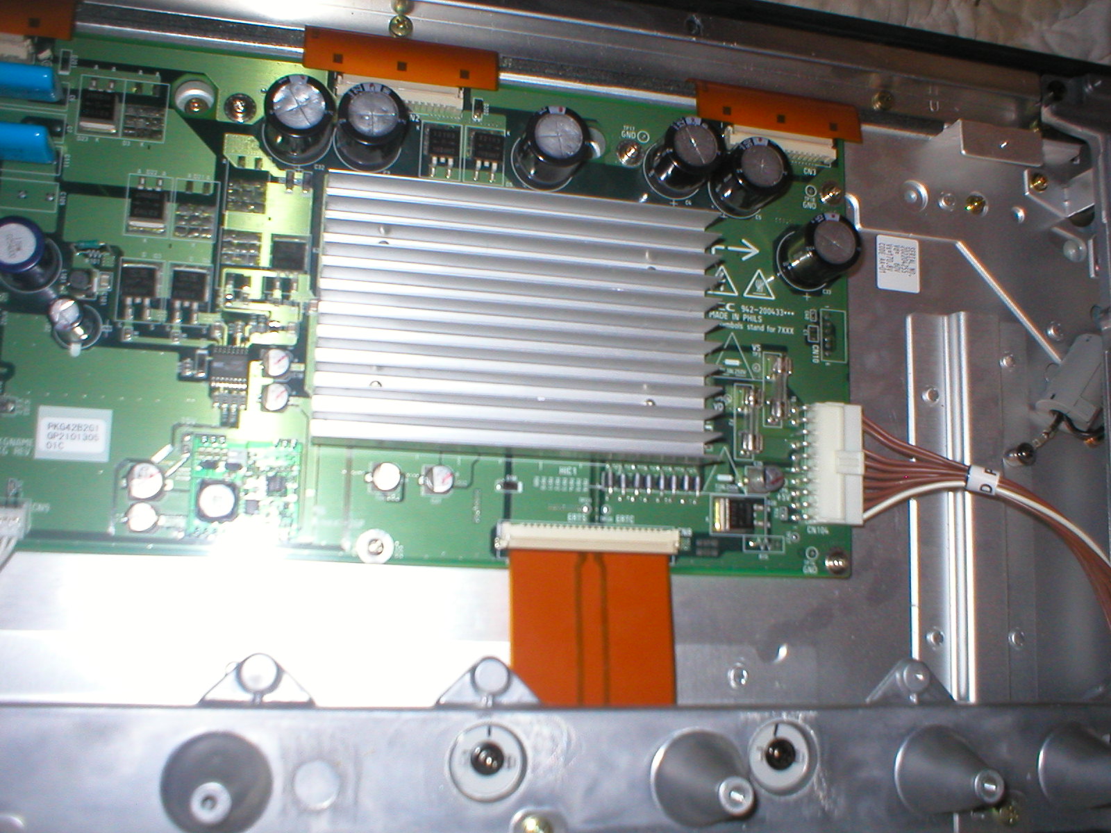

                                        OK, so you have good Vs, but I don't see Vd. Vd goes to the vertical driver boards from the sustain boards, and it's generated on the PSU in most cases.
                                        The plasma panel requires Vd to make the display work though you should still see a faint glow. It is possible it derives the other voltages for the sustain board from Vd instead of Vs.
                                        CN7 is on one of the drivers. Next to it there is a label. What does this label show?
