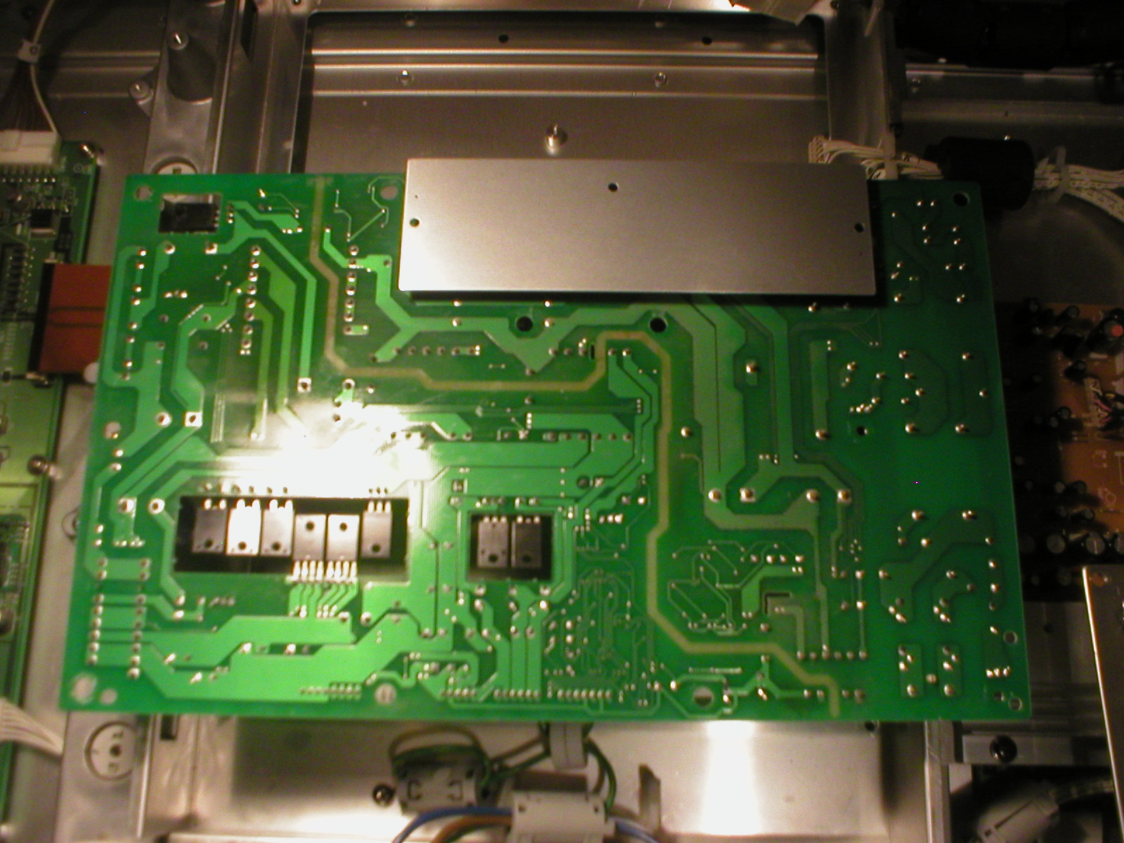

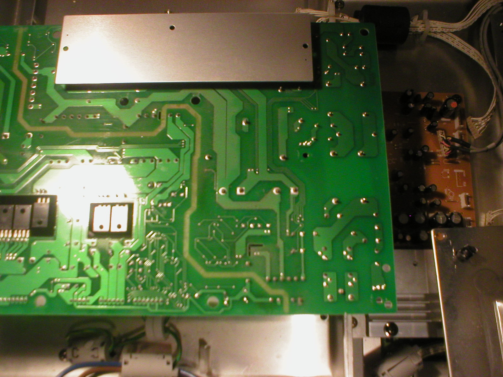

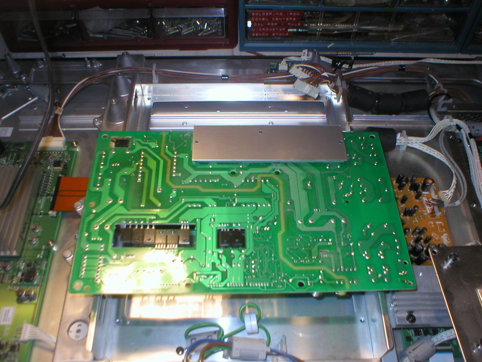

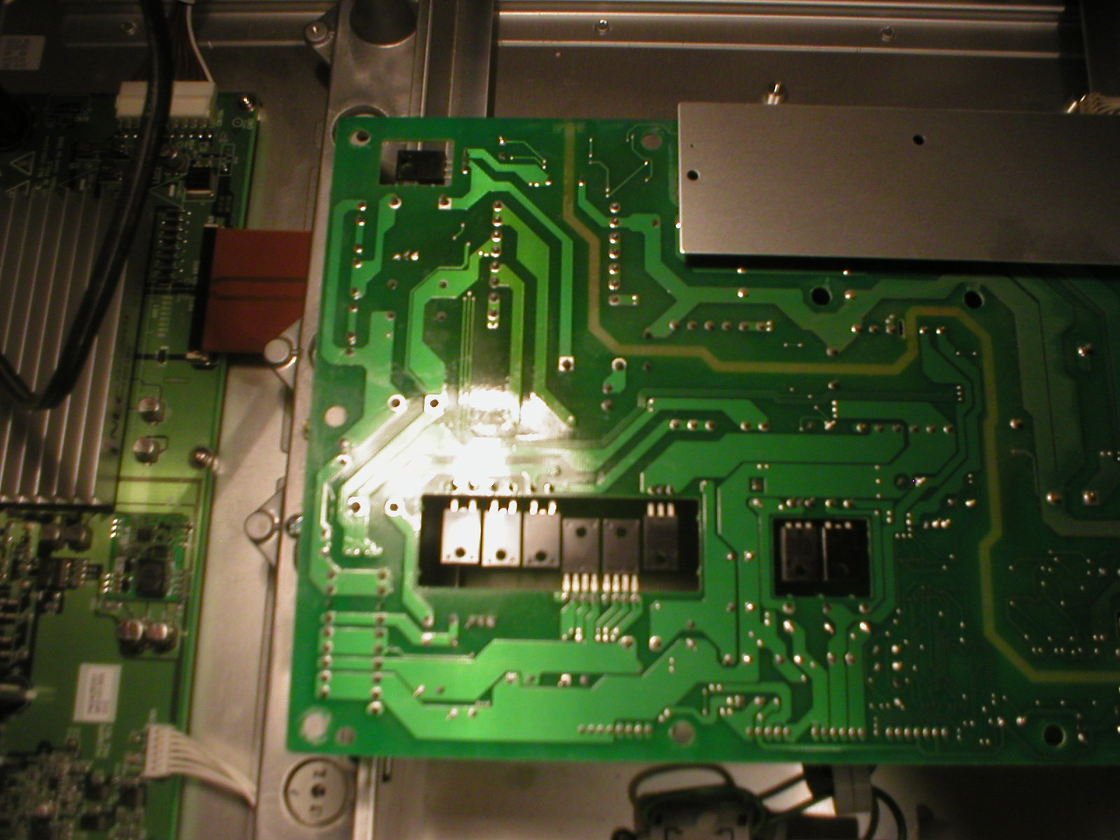

      So the PSU should supply 60V but it isn't, 60V is one of the voltages we need. Can you get a pic of underneath the PSU so I can trace where it might come from?
      • Dblueman
        • Nov 2012
        • 84
        #83
        Re: NEC Px42VM3A lost all display
        hope these will help. Let me know what I can do to assisit.
          #84
          I'm going to take a stab that the last two rows are VA, because it makes sense based on the connector layout.
          Those two black diodes -- check those. With TV unplugged & board removed, test on diode mode between pins 1-2 and 2-3, both ways. (Pins labelled arbitrarily from left to right, order unimportant.)

              If I am correct the diodes are as follows 1 is behind the 4 white lets call them blocksnext to the heat sink and the other one is by a lone hwite box to the right of the 1500 uf 200V cap. Each of these reads 755 and 770
                #87
                I mean the two lone black devices in this pic.
                https://www.badcaps.net/forum/attach...7&d=1359412997
