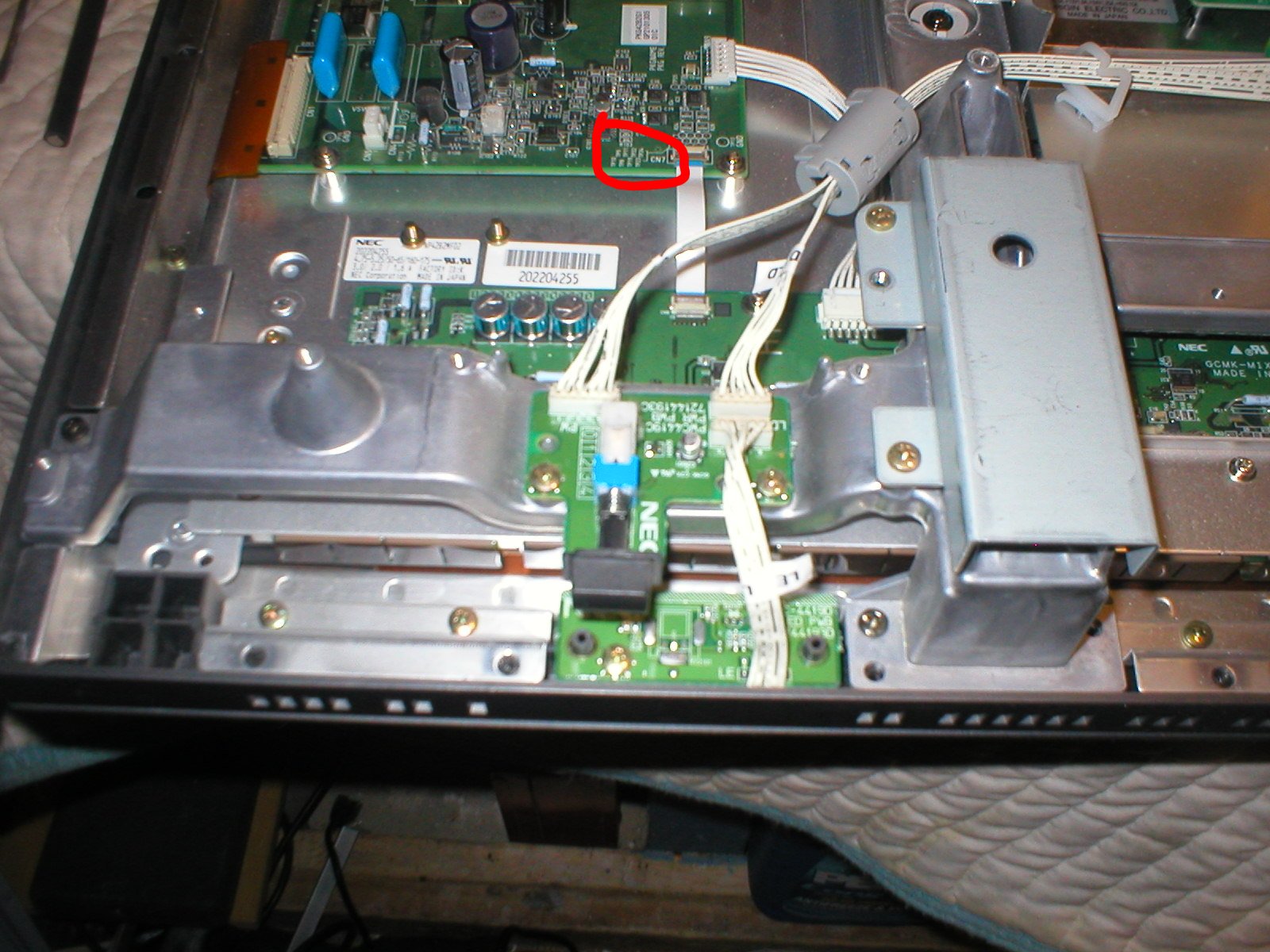

      Re: NEC Px42VM3A lost all display
      Top of this pic. White, blue cable.

          #44
          I don't know what that is but it has nothing to do with CN7.

              #46
              I can see, right next to CN7, there is a line going over to a box with labels. What are these labels?

                  #48
                  I mean this one.

                      #50
                      I got ya
                      TP10 TP9
                      TP8 TP11
                      TP19 TP22
                      TP23 TP24
                        #51
                        Huh, I had hoped for Vd etc.

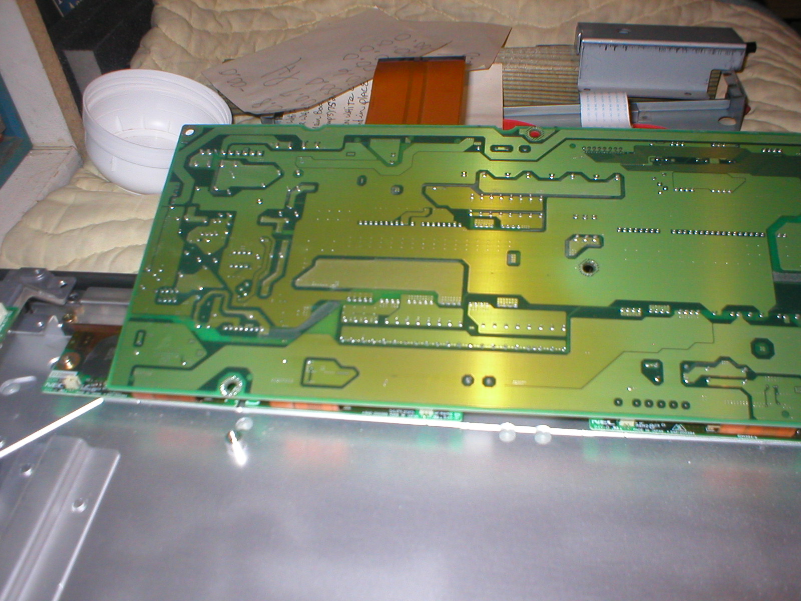

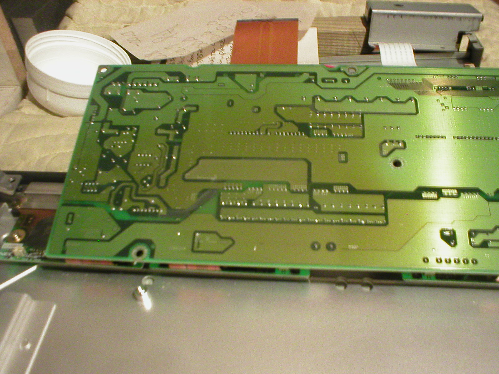

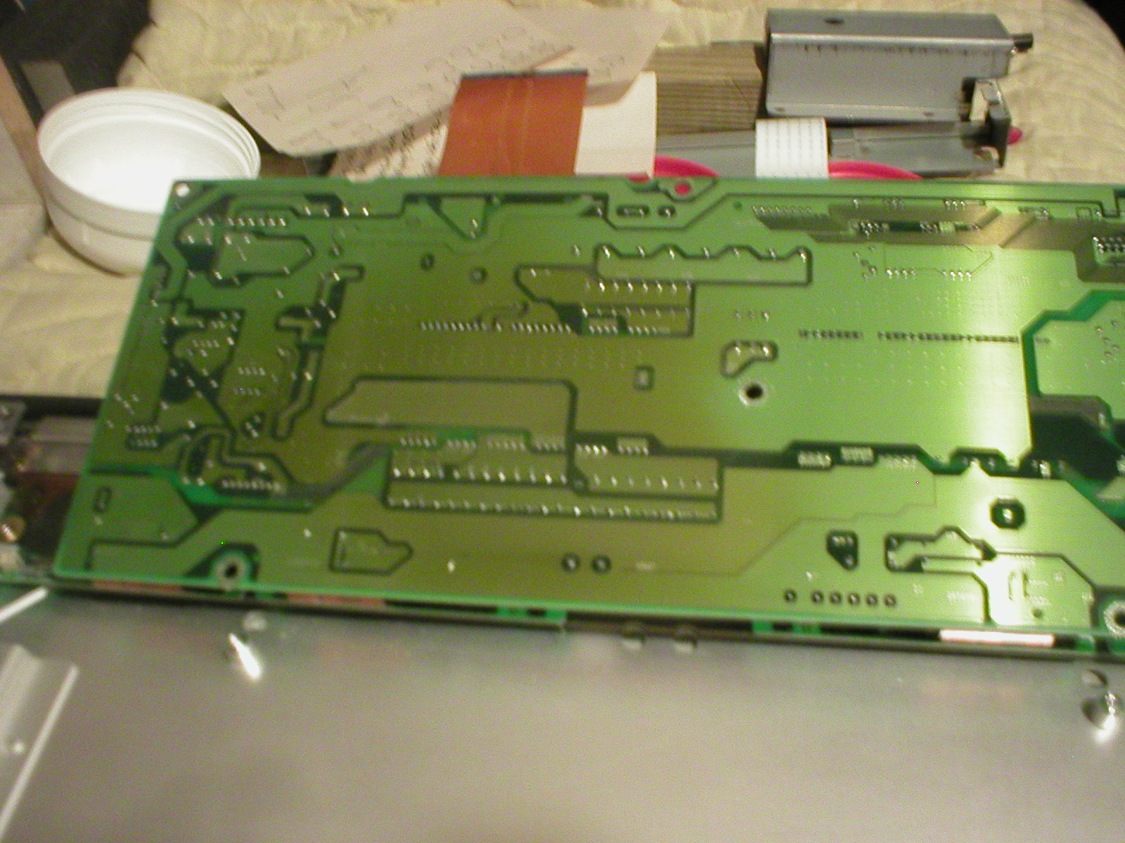

                            #53
                            thought I would add some more photos.
                            These are the bottom side of the circuit board # NEC 942- 200432.
                            as you can see this circuit board has gotten pretty warm. this is on the right side when unit is lying face down, This circuit board is connected to PH cable connection. This circuit board is found underneath the main input circuit board.

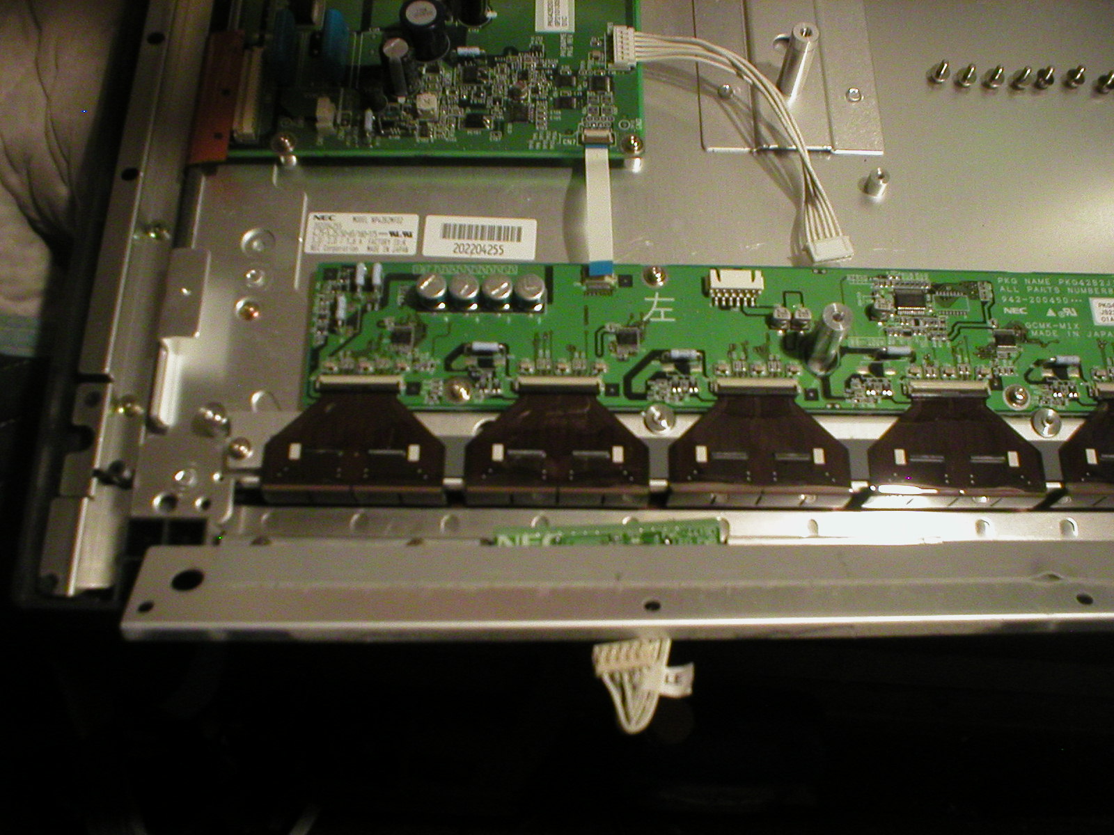

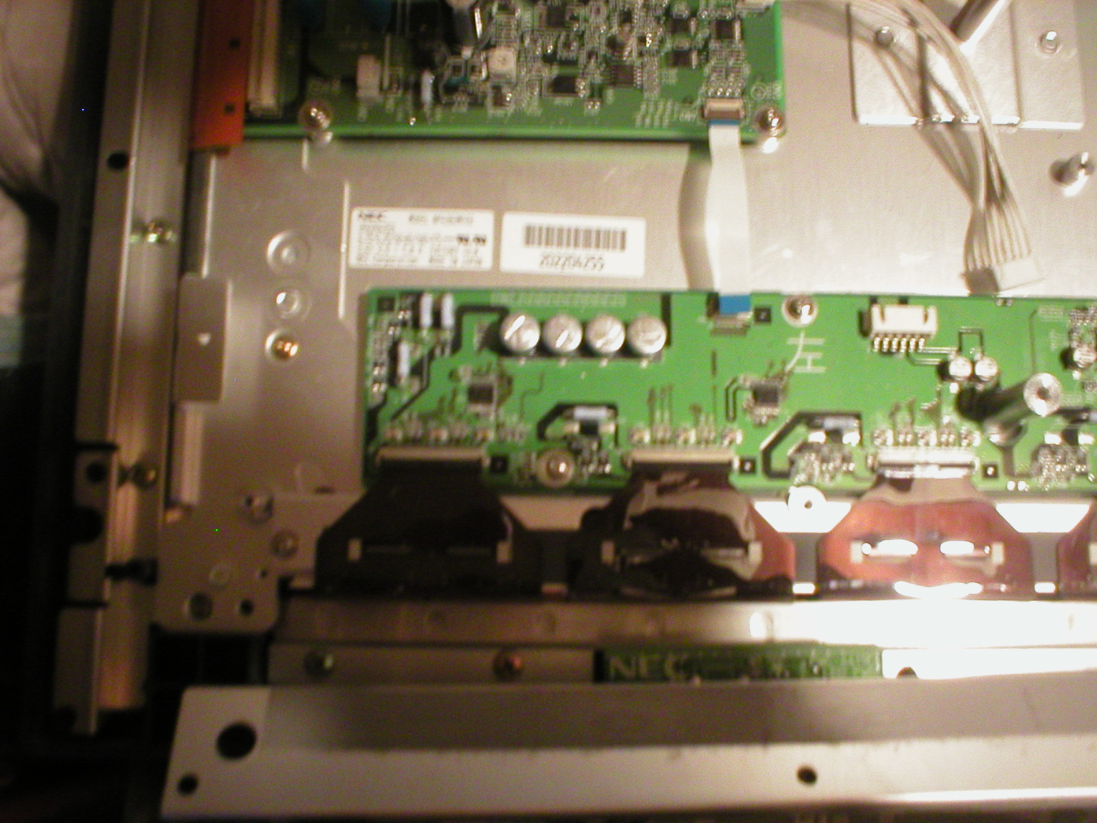

                                #55
                                Good Morning,
                                Are these the ones you speak of ? just below CN7 see the pictures I included
                                These are labeled as C62,C63,C64,C65. Circuit board # 942 200 450
                                Do I need to remove the caps from the board to get measurment?
                                  #56
                                  Yep those.
                                  Measure them in circuit...
                                  • Dblueman
                                    • Nov 2012
                                    • 84

                                      #58
                                      Measure volts DC across them while the set is running.
                                      The leads on either side can be probed, no need to remove it.

                                        #59
                                        From left to right
                                        C65 00.7
                                        C64 00.7
                                        C63 00.7
                                        C62 00.7 This was set on 200 DCV
                                          #60
                                          OK; this indicates a lack of Vda. Which will cause no picture.
                                          Can you isolate all but the one long board going along the bottom of the panel. This means disconnecting all connectors. Leave the heatsinks on.
