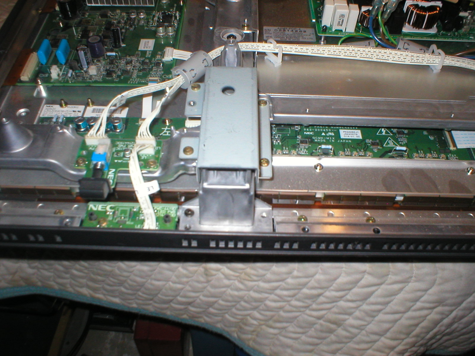

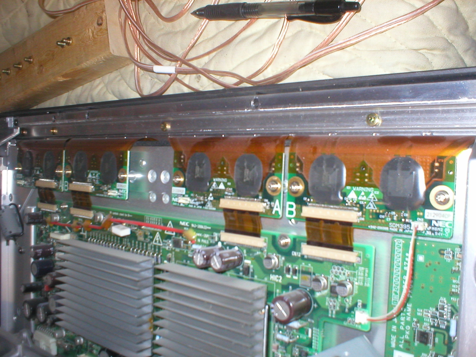

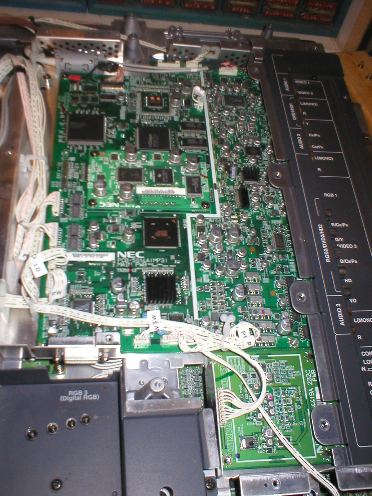

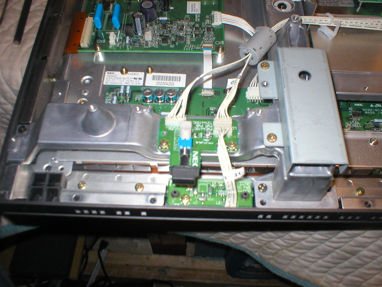

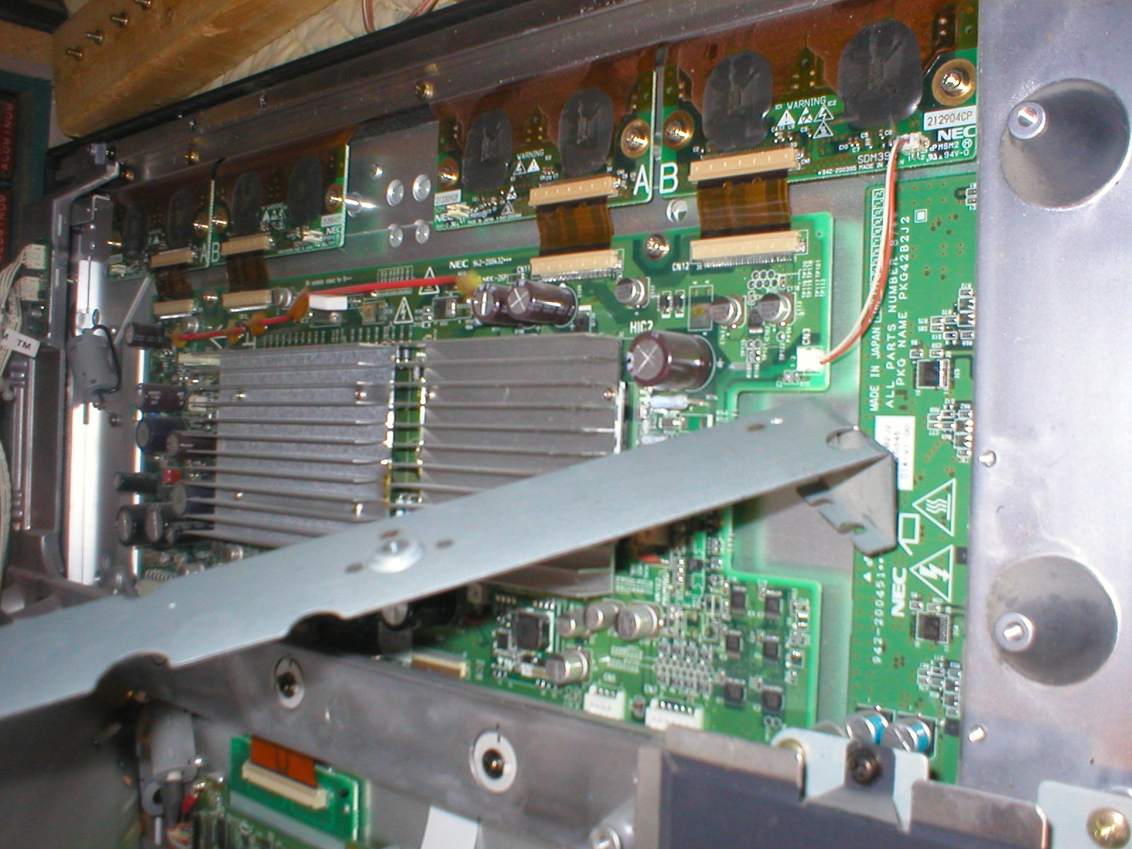

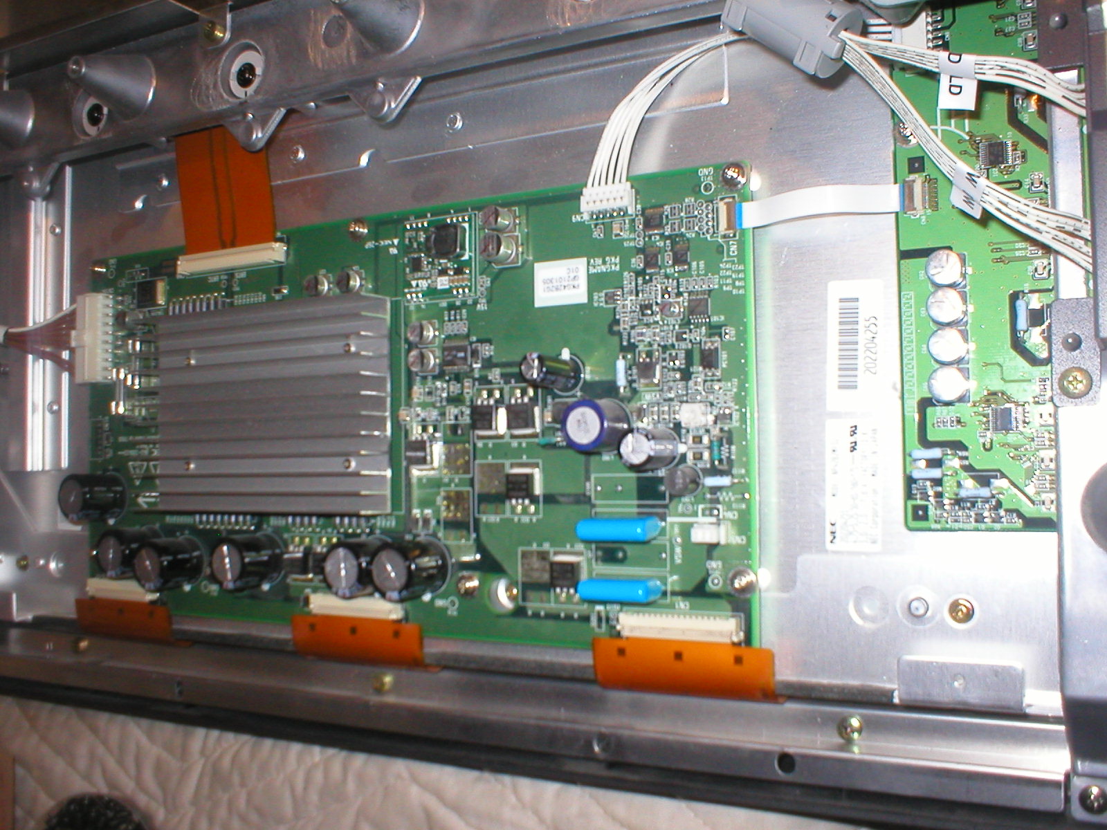

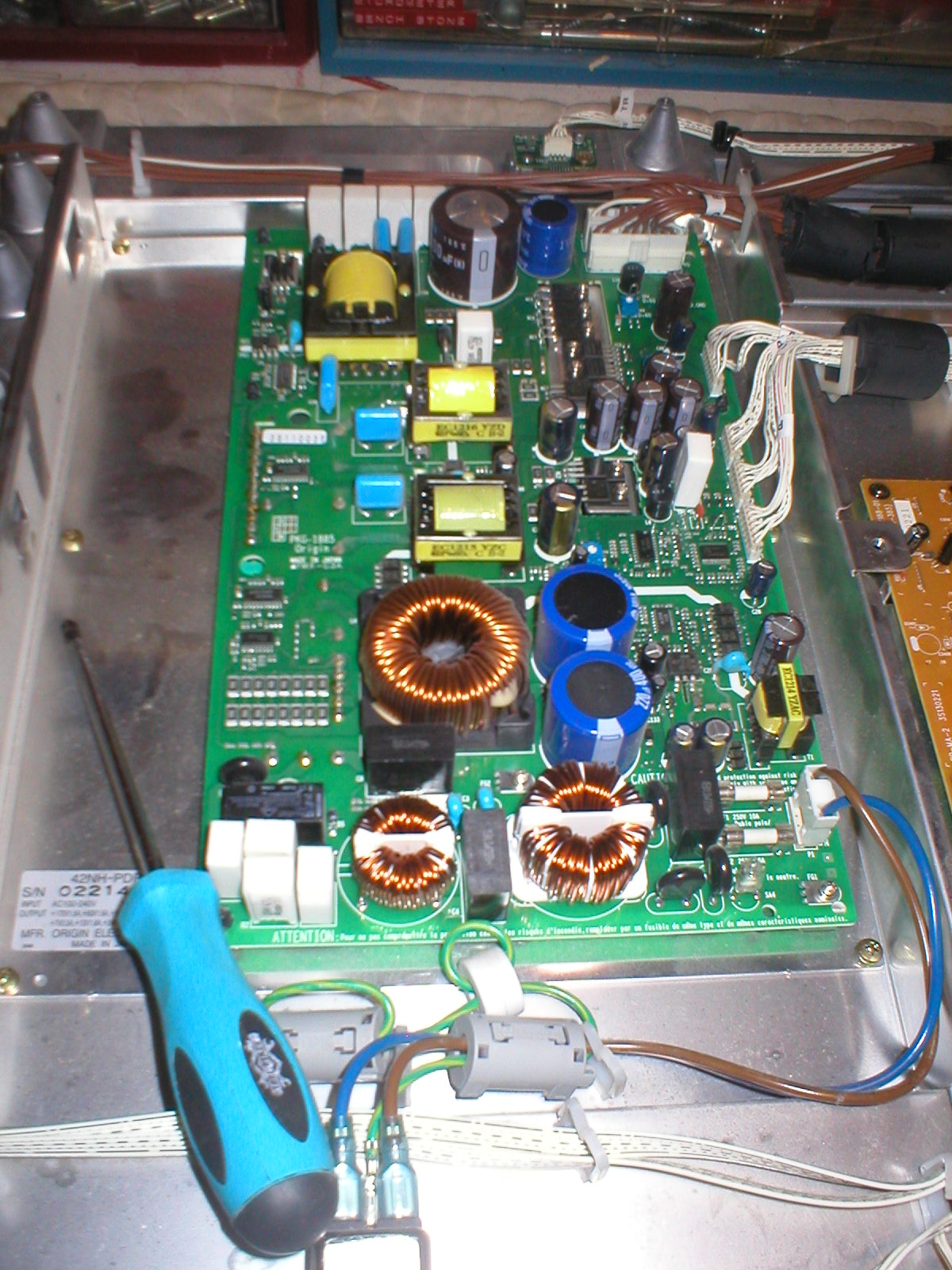

    Hey folks,
    I was given this NEC PX42VM3A Plasma t.v. Powers up fine. It's the display that I am trying to trouble shoot. At first I had a video display for about 10 minutes or so. And after reading some of the other post, I can say I did see the sparkleys when I first turned in on and then they went away. I was told I would need a new T- con Board but, I am not sure which part # board that is. Those of you familliar with this set will agree with me when I say this set has at least a 100 screws to take out to get to things. Anyone that can tell me which one I need and how much it would be that would be great.

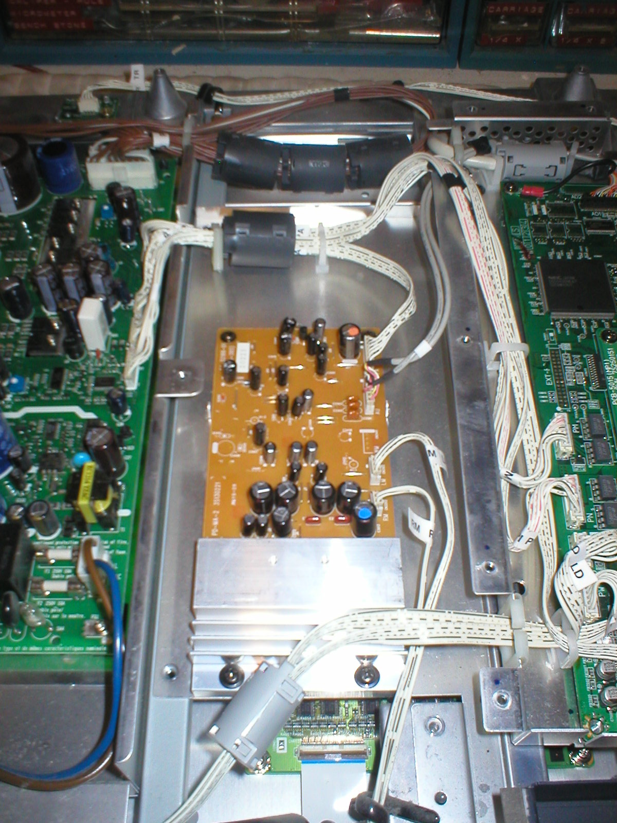

    I can include these images if anyone needs pictures. I know most of these pictures are not the T-con board but I wanted to show what the inner workings looked like for this set, Should any one else need questions answered. Thanks everyone!

    I've worked on the NEC PX-50XR5G, and it's one of the best plasma displays I've worked on. A common issue with this chassis is the audio amplifier failing, this causes an error signal which shuts off the TV.

      What I experience is the T,v. powers up fine. But what I see is a flash of colors and then no screen image. Once I had a picture for 30 minutes and then powered down the set, turned it back on and lost the display again. I was told to switch out the T-con Board once but that Did not solve the problem. Tom66 gave me some great advice on how to check the audio amp board which I did and I have aliminated that as an issue.

                                    Re: NEC Px42VM3A lost all display
                                    Wow, that is very odd. I have never seen that happen before. Is that a good sign?
                                    I'd check if the Vs (or Vsus) voltage is good. I think on this generation of NEC Plasma it'll measure around 165~175V, though the exact voltage will be indicated on the plasma panel.
