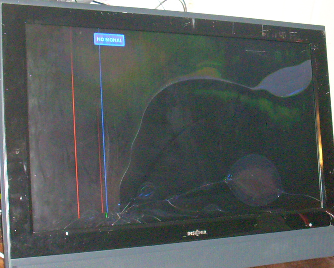

    ok just found a insignia ns-lcd32 lcd tv that was thrown away.
    After plugging in I see the screen is cracked.
    Was wondering if anyone has a part number for the screen or can provide me with a link to where I can get one.

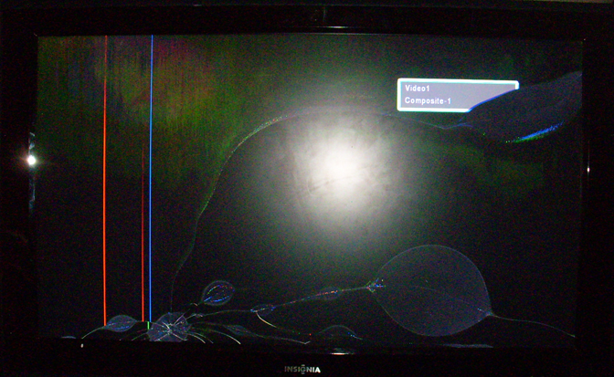

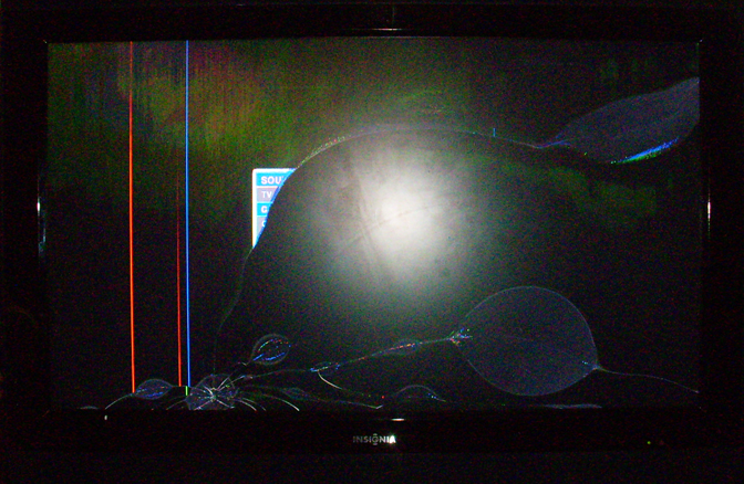

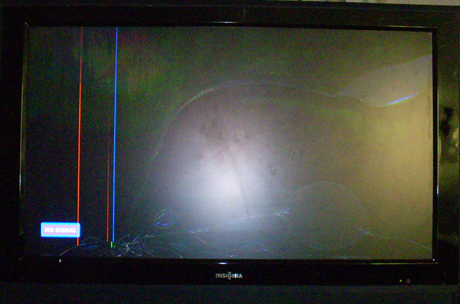

                        Re: Just found an insignia ns-lcd32
                        Here are some pics
