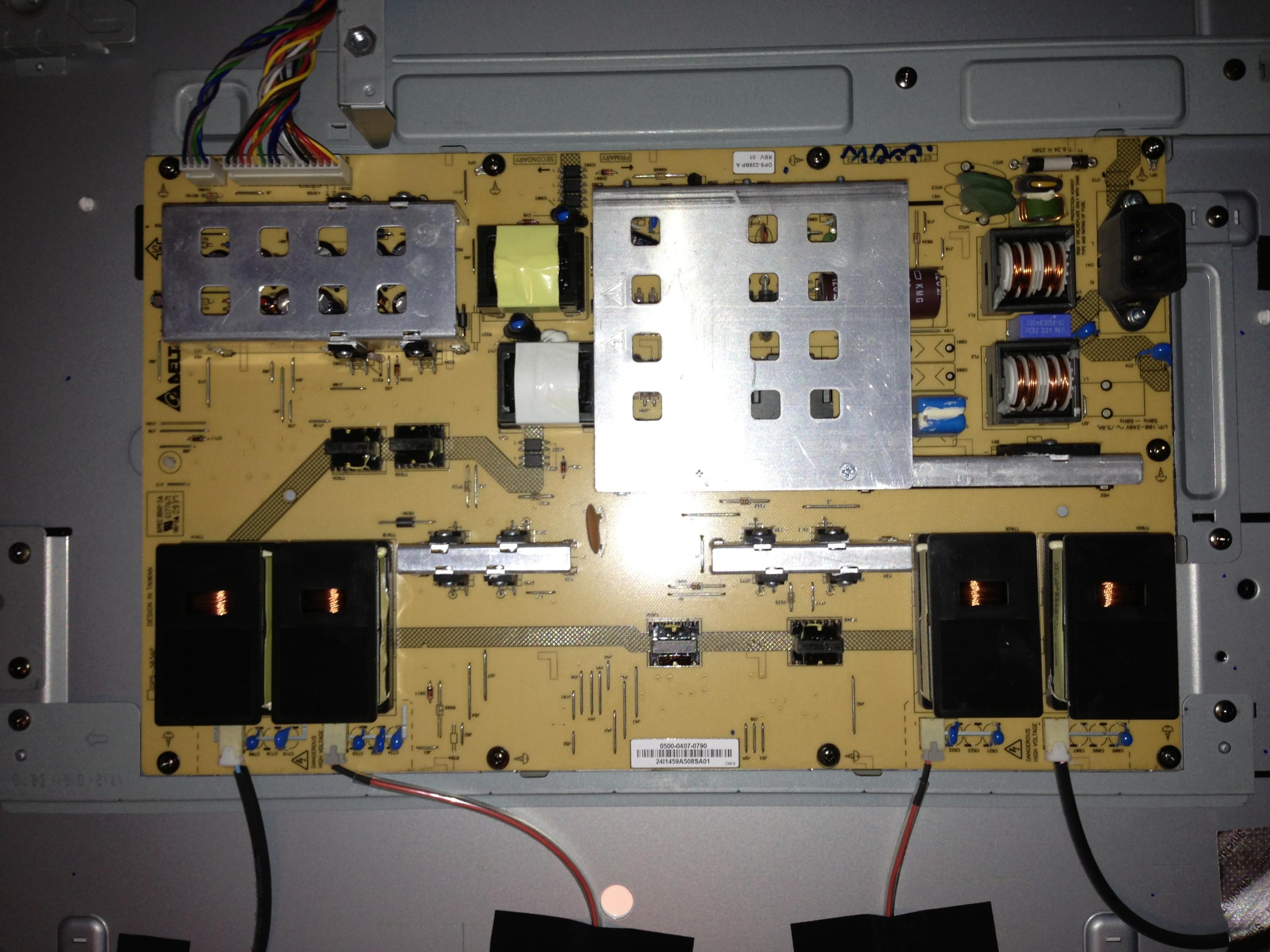

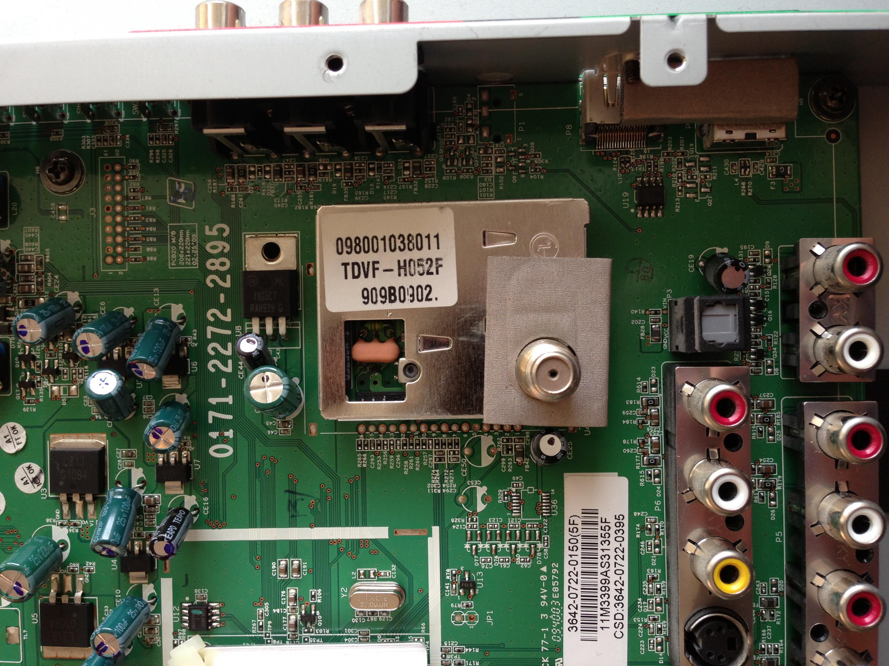

    My TV died the other night. The vizio text on the front illuminates orange when I plug the TV in but pressing the power button (on the remote and tv) does not turn the TV on. I don't hear the "click" which I assume is a relay.
    I'm doing the DC-DC Converter troubleshooting from the service manual:
    J1-10 05.14v
    J1-11 05.14v
    J1-12 05.14v
    J1-02 12.00v (power switch on and off)
    J1-03 12.00v (power switch on and off)
    J1-04 -04.10 mv (power switch on and off)

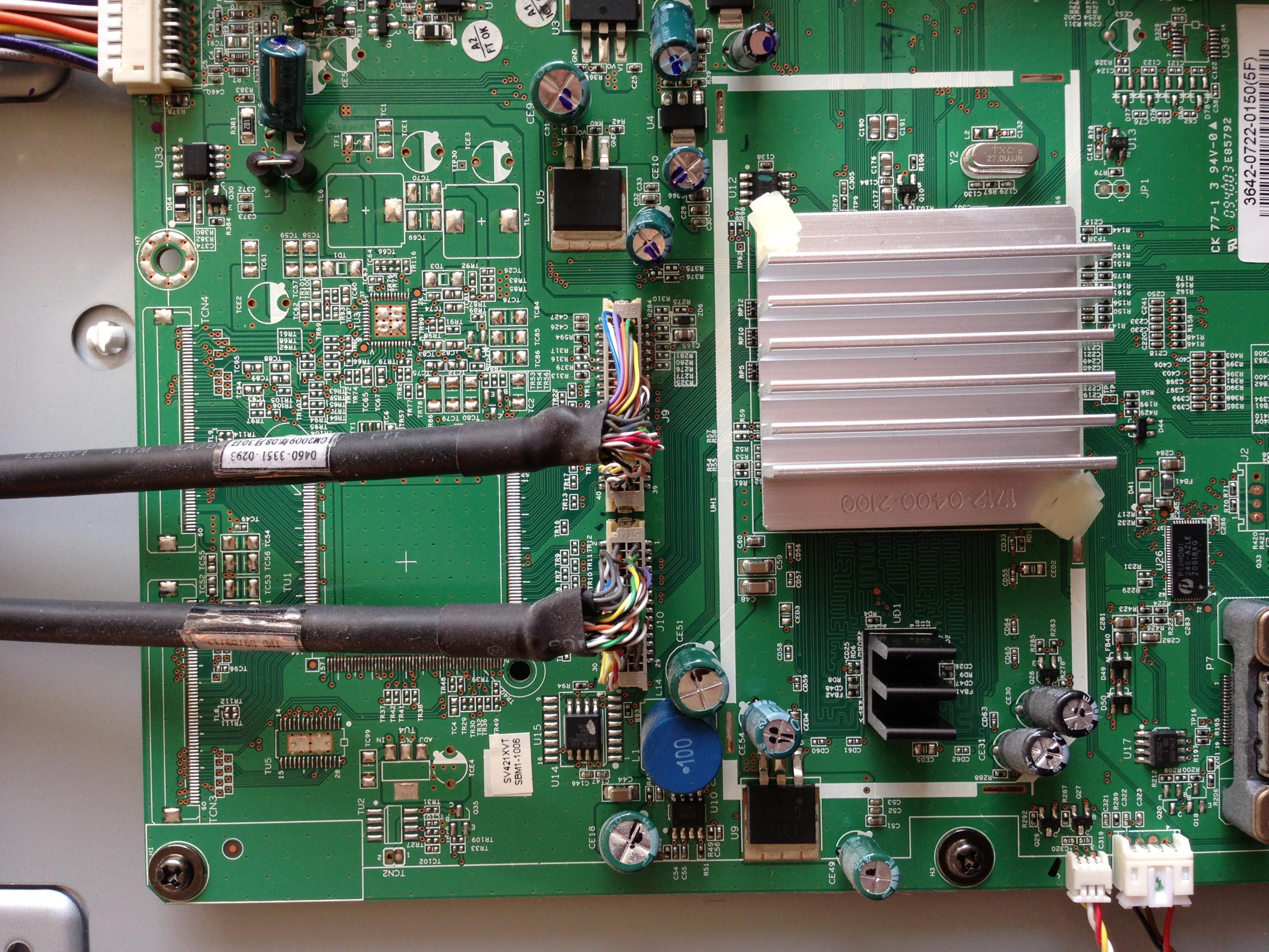

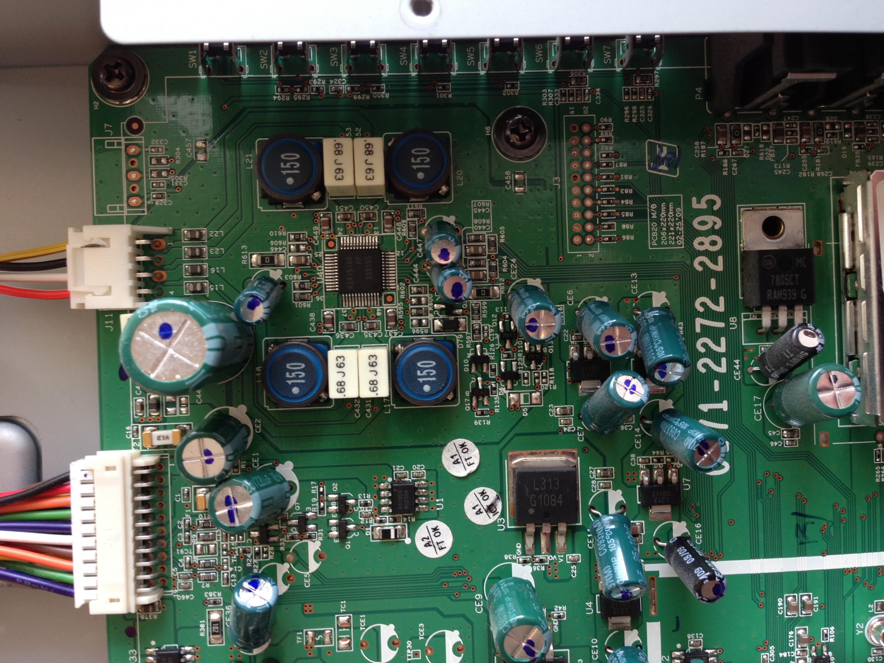

    Not sure if I stop here because J1-04 didn't measure correctly? If I don't stop, I'm unsure how to measure U1 (seen in IMG_0119.JPG lower left quadrant).

    Here's the rest of the measurements from the service manual

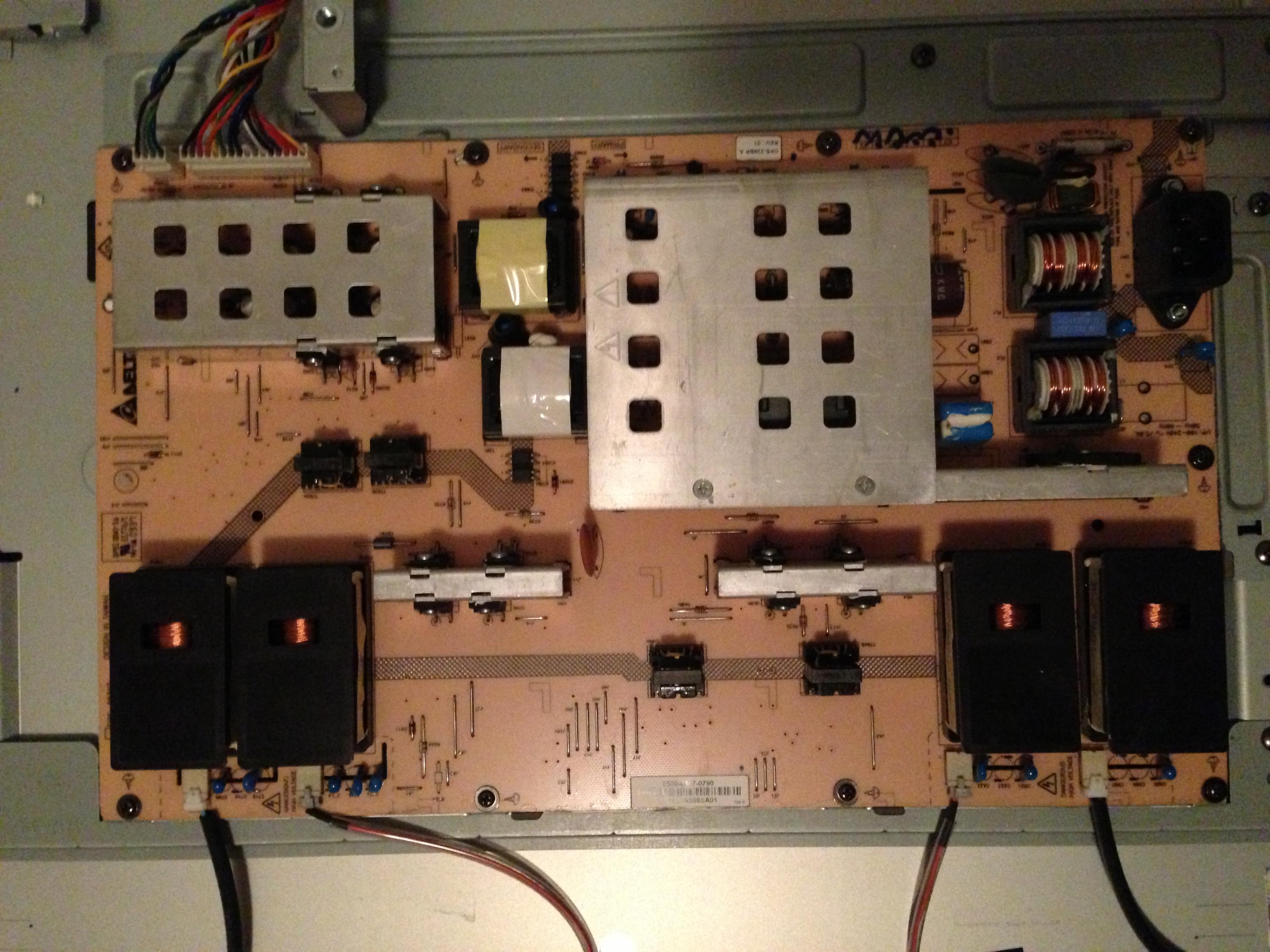

      Re: Vizio SV421XVT Standby On but no power on (don't hear "click")
      The very bottom left cap in pic 2 looks like its bulging,may just be on my screen though.
        Just a bad angle. I can't find any evidence of bulging/leaking on the sides/top/bottom for any of the caps on the power board or main board.

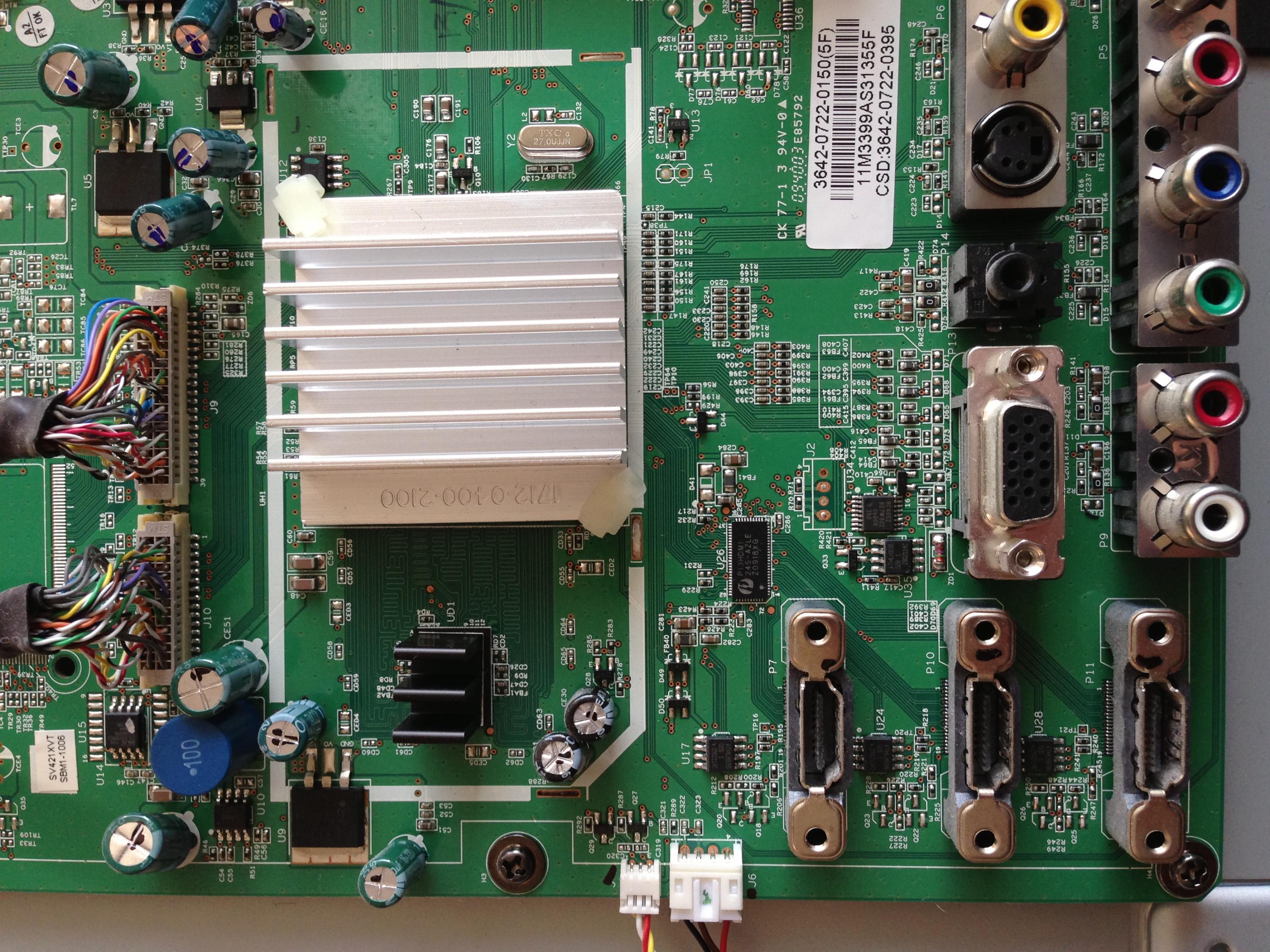

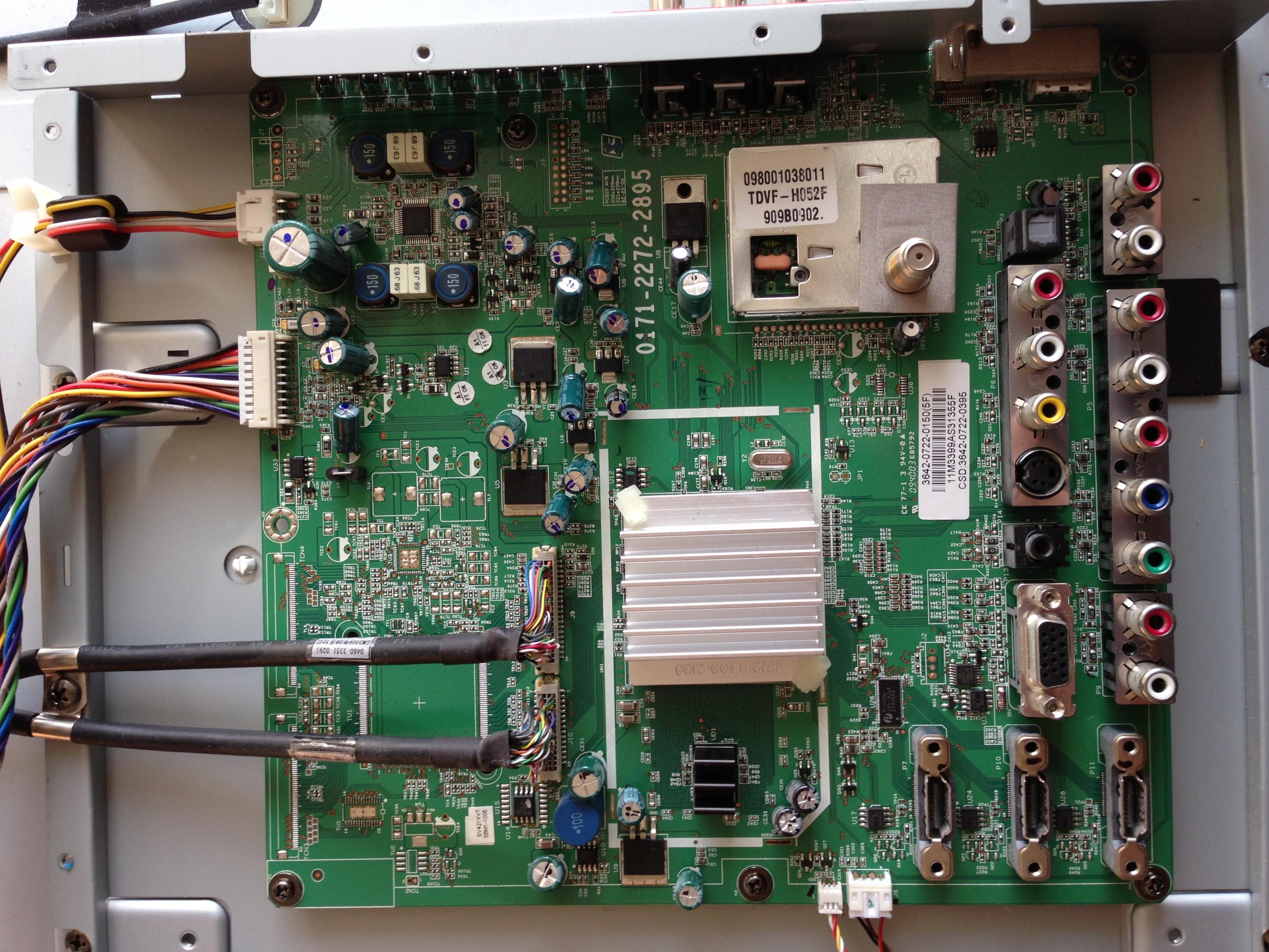

              For anyone else with the same problem.
              I measured PS_ON at 1.12v and INV_ON/OFF at 0v. Since the power board was outputting all the correct voltages, I guessed the mainboard was broken.
              I replaced the mainboard and my TV works again. PS_ON now reads 2.89v and INV_ON/OFF 3.32v.
                Thanks for the repair feedback, you did the right thing by checking the PS_ON line and the INV_ON/OFF LINE to see what condition they are and pointed the problem to be the Main board.
